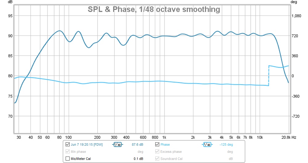

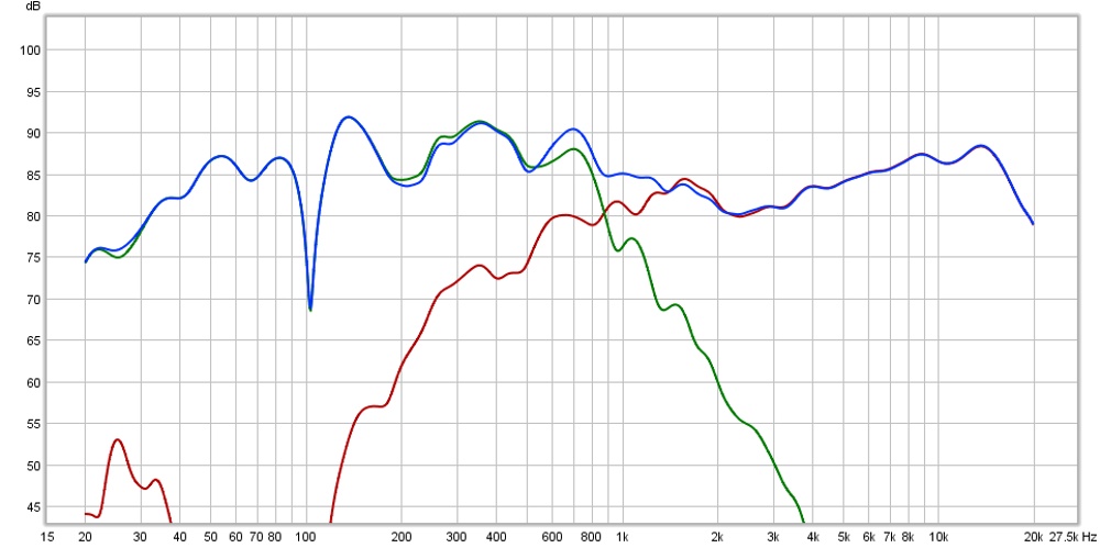

Thanks , it looks better in pic than person, since i m not a patient guy,after building the box i went with vinyl instead of my first choice of veneering the whole thing. but i can always change it if ever.

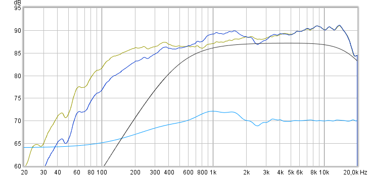

anyhow, yes the reason it looks so flat is because of scaling of course, but overall the 2 drivers looks like a good combination since it relatively has almost flat respond without much tweaking.

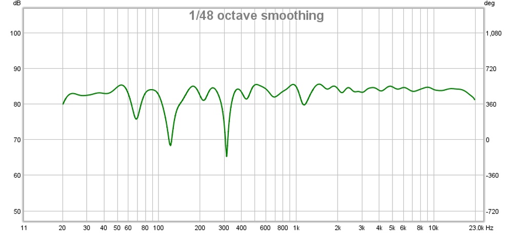

I did try the Harsch XO, brought down the XO point to 500Hz, and with a few EQ I got this :
above is XO at 500Hz with Bessel for HF and Butterworth for LF with about 0.7ms delay for HF. Five Sweeps at 1m from speaker.

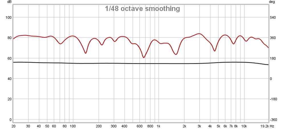

But as soon as i changed the Mic to listening position the FR was all over the place, nothing like 1m measurement, i m living in a relatively small flat but it was worse than i expected . but with importing REW settings to miniDSP and some tweaking around i got this :
I think the dip before 300Hz is perhaps baffle diffraction, and peak before 30Hz is probably the room.

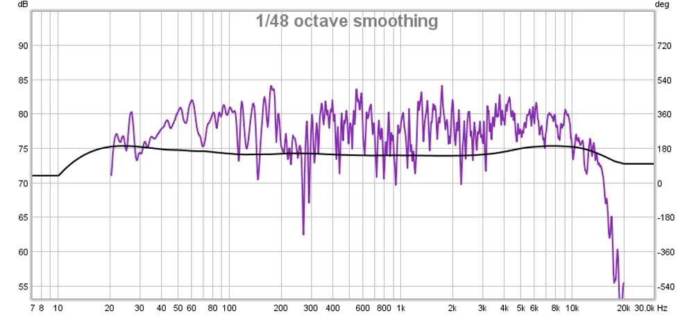

haha, looks like it, your designs make sense and well documented. Thank you.xrk971 said:Looks like you have an all-XRK system going there with Alpha 20 and FH9
Of course, measuring at 30cm is usually to set up the crossover, then you start playing with speaker positions, with the mic at the listening spot.
Once you find the right spot and the right XO curves and points, Look up on how to use biquads import in the miniDSP if using software like Sim, or FIR filters, if using RePhase.
Both will elevate your listening experience one more step from the built-in curves in the miniDSP.

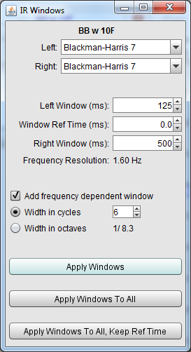

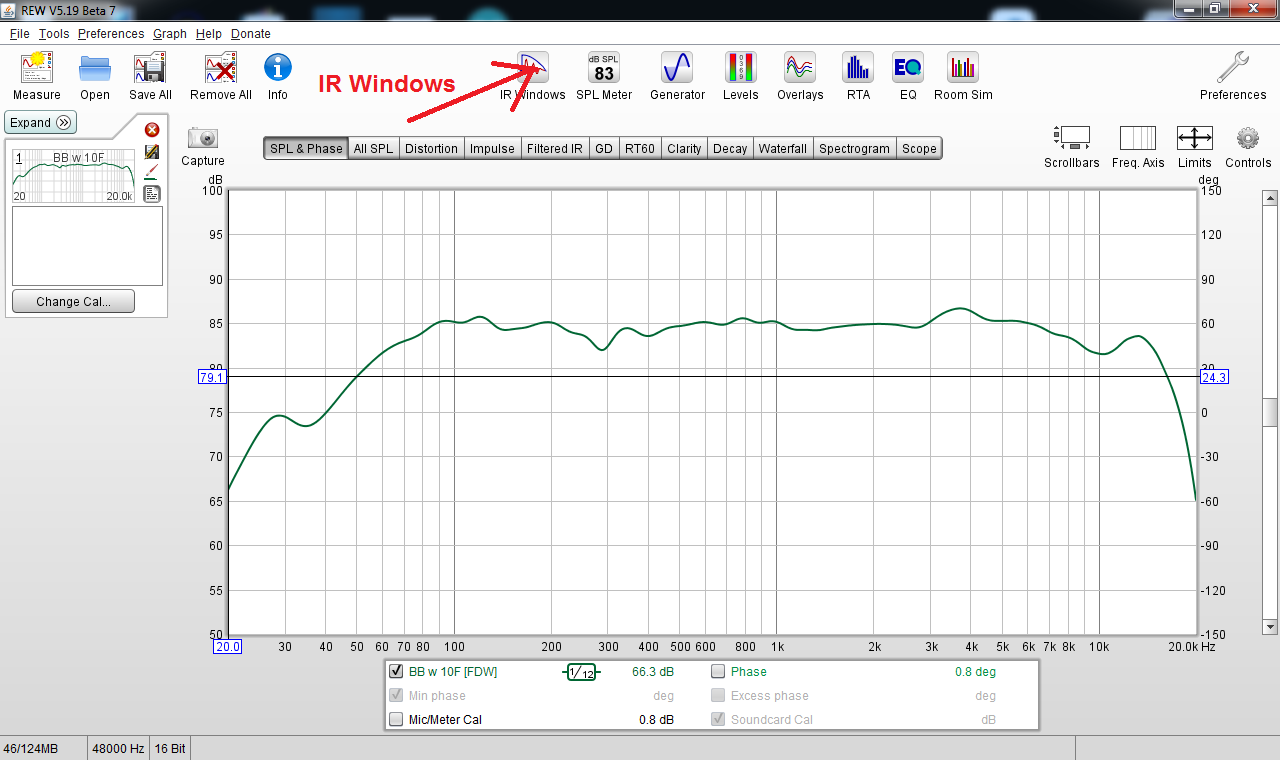

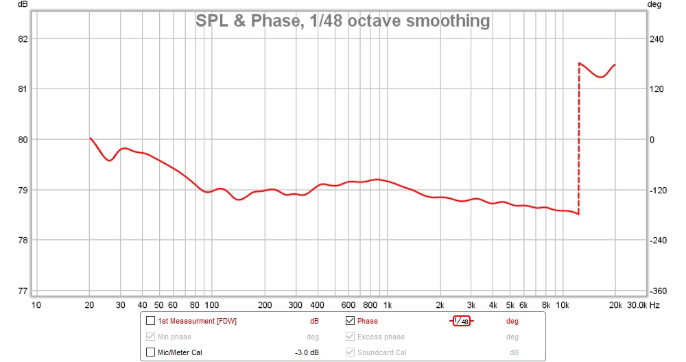

You need to set the smoothing and windowing to FDW 6 cycles (this essentially allows you to look at the intrinsic speaker response independent of room reflections). Measure at 0.5m with mic on 10F/8424 axis. You are already elevated >0.5m so that will prevent any floor bounce from affecting measurement.
Here is where FDW is located:
Here is the dialog and click check box for FDW and set to 6:

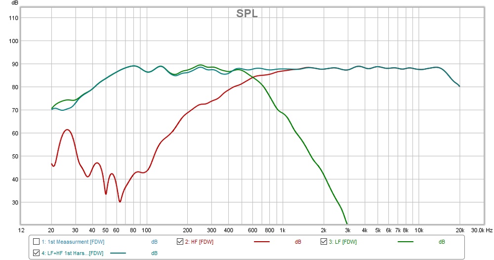

Then measure the 10F only and SB23 only and the combined curves and plot on same graph. The phase should have a characteristic 55 deg rise bump at the XO freq if you did it right. It is tricky because you need to first EQ your woofer responses to fit the textbook 4th order low pass curve, then EQ the midtweet to fit the Bessel response high pass, then delay the midtweet by 1/2 the time of one period of the XO frequency. For 500Hz that is 1ms (plus any physical offset that the drivers have as woofer voice coil is typically 3in or so behind the tweeter, so tweeter needs about additional 3in of time of flight delay (220usec) or total delay of 1.22ms.

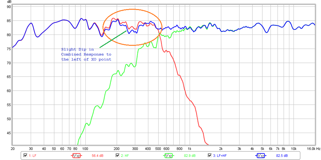

The curves should look like this with characteristic slight rise of woofer (or dip in combined response) to the left of the XO freq, and small 0.5dB wiggle as it goes through the XO like this:
The proof that it works is when your step response looks like it has the tweeter peak aligned with the leading edge of the woofer bump like this:

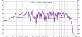

Lets start from beginning, based on datasheet FR of SS and SBA I chose 700Hz as the XO frequency, I set the mic 1m pointing at SS and start measuring HF and LF separately based on 700Hz and after some tweaking around I came of with this as my first setting w 0.7ms delay on HF:
This is the original XO from my first post.
After reading a little on Harsch XO, I brought down the XO point to 500Hz and this was the results of my impression of Harsch :
2nd Attempt, I started from scratch, measured drivers individually and tried to match it to Harsch, after hours of tweaking, i came up with this :

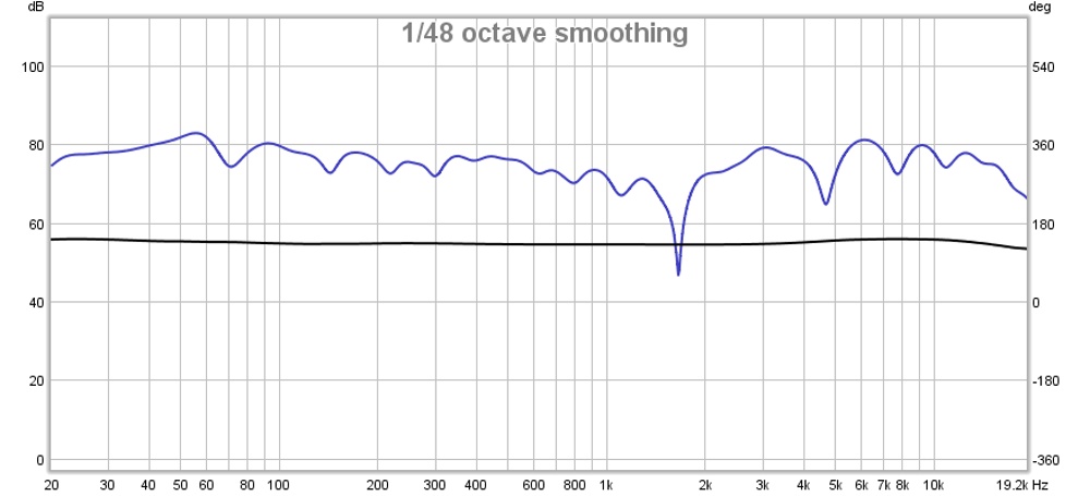

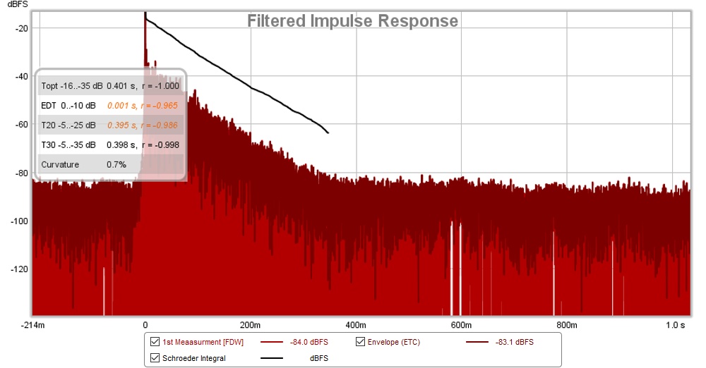

Your last plot shows a series of dips, starting at ~1650 Hz, meaning something is causing this wobbly frequency response.
The plot has 20 dB division between the lines, which is a huge difference to the 5 dB scale that XRK used. While on this scale it may look relatively flat, it isn't within the plus/minus 2.5 dB of XRK's measurements. You're plus/minus 10 dB or more between 1500 and 5 KHz.

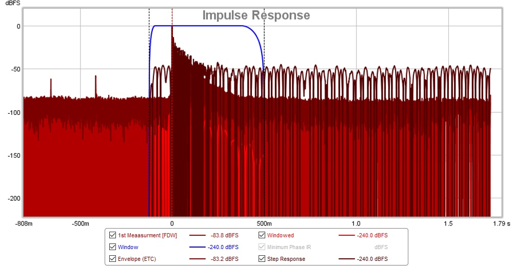

Look at your IR, that will show if there are any big reflections in your measurement that create that series of dips. It almost looks like a stereo measurement measured just outside the sweet spot.

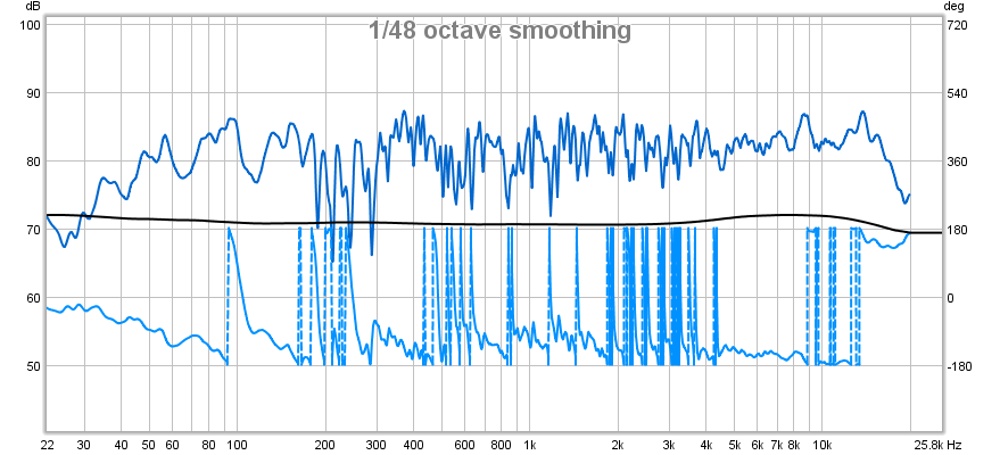

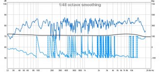

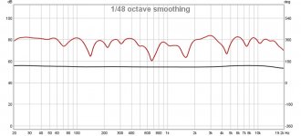

I followed X instruction here and got good results. did get rid of dips after 1.6KHz, but i got series of dips at my LF FR now, not sure what causes such deep dips, any ideas ?
Getting IR is a good idea, i noticed the louder i do the sweeps more dips i get !
This is listening spot by the way.
150Hz is classic floor bounce cancellation. Did you move mic to 0.5m and make sure mic is about 1m above floor? Then use 6 cycle FDW (which it looks like you might be doing already). Don't worry, it takes time to master this - not an easy concept actually to see that the individual driver responses must match the textbook profiles before you try to use them in the XO.

I was all happy before seeing the FR from listening spot, lol.
mic is about a meter above the floor, and this FR is from 8-10Ft away, at 0.5 to 1m i almost get flat respond.

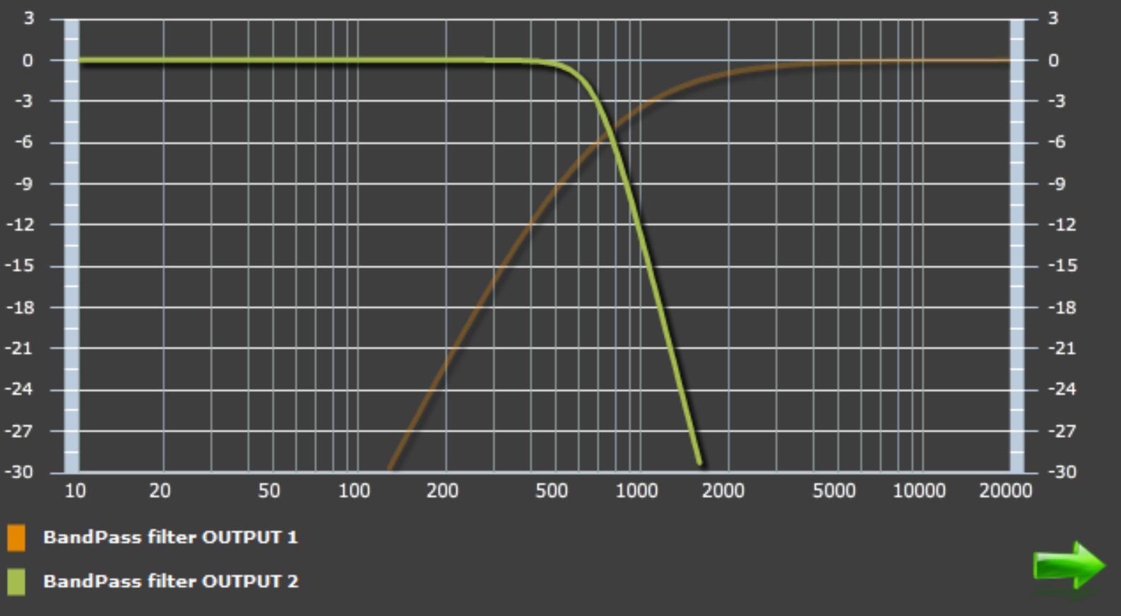

One thing tho, how do I get 12db Bessel slob in minidsp ? or is it only doable in HD version.

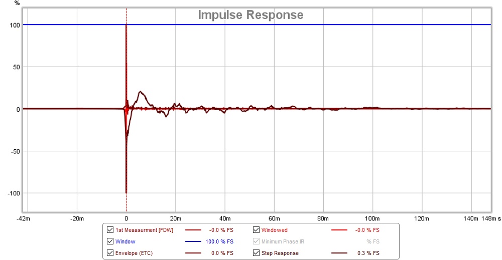

I think you have it there. For step response choose %FS rather than dB. But the tell tale is the mild dip in combined below the woofer to the left of XO and your curves look like the right shape of 4th order and 2nd order Bessel. Good job.
How does it sound?
Listen to acoustic guitar, drums (rim shot), stand up bass etc. - crisp attack is the signature.
How does it sound?
How does it sound?
thanks, and it sounds "right" ! very pleasing
