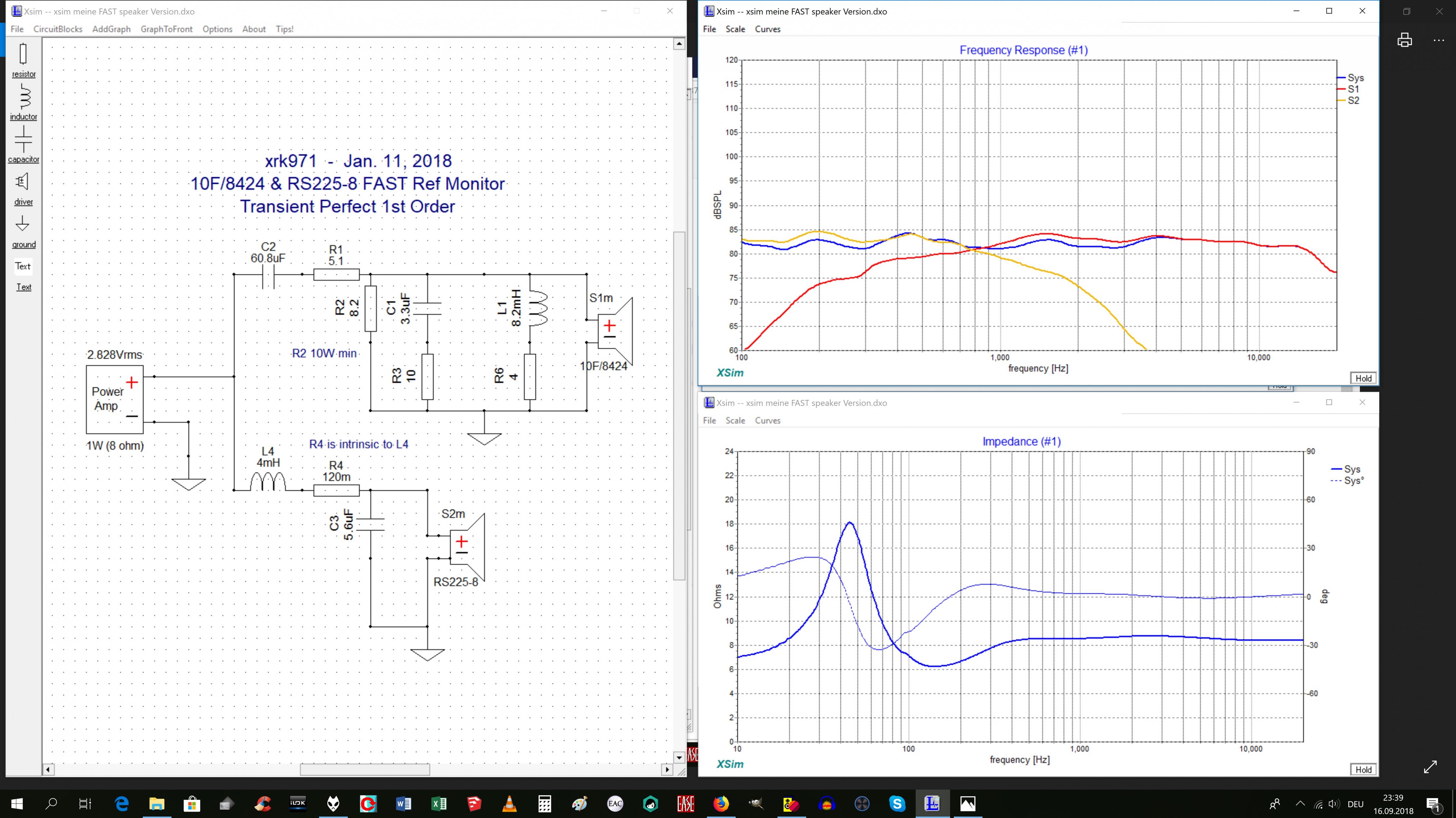

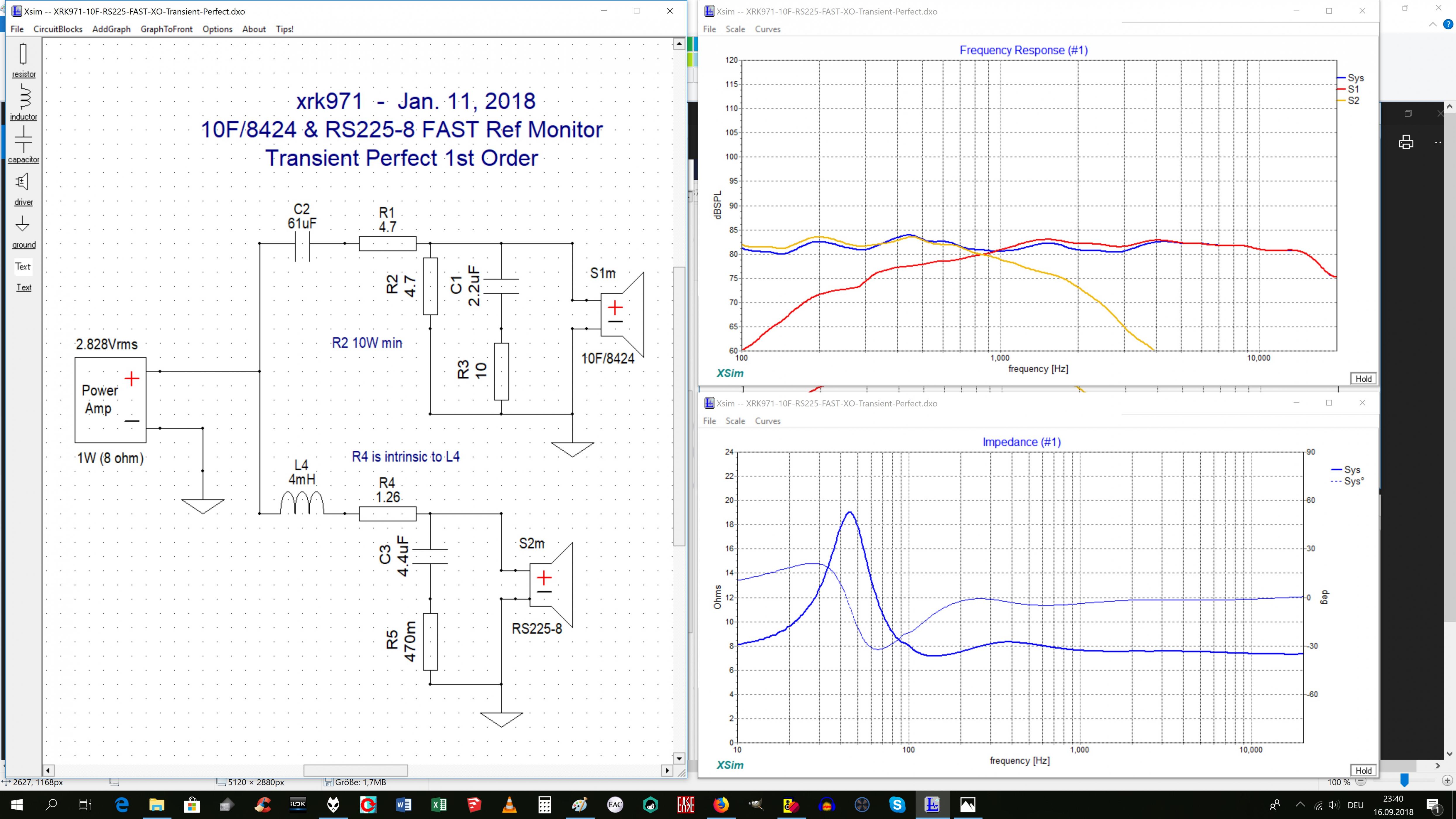

Dear all!
I am planning to build the FAST speaker, but I thought that a 1,21 Ohm coil for the woofer is too big value, I wanted to go lower. I found some company, who could produce some custom made coil for me, with a DCR of 0,12 Ohm, it is 5mm thick wire...
Introducing such a coil to crossover made the frequency at 100-200 Hz go up more than 1dB. So I had to alter things a bit. I started with the padding of the Scan Speak, I had to raise it in gain, but just reducing the padding was not enough, above all it was necessary to bring the mid frequencies up, I kind of rotated the frequency response a bit (bring the mids up, high down - and bring it all up). In order to get the low frequencies below the XO of the scan speak down, I introduced another coil in parallel.
See attached two pictures. If you download them, and open it with your installed picture viewer, and toggle between them, you will easily catch the differences. In my altered crossover version, the whole sensitivity is like 1dB up, and I think I quite successfully managed to bring it as flat as it was.
But there is one thing I noticed, and I would like to ask you, what you think about it: The frequency plot especially of the woofer, and the frequency plot of the whole system - they are separated from each other more. So the gap between the blue graph and (each) driver graph next below and above the XO is bigger. Can anyone tell me what this means in terms of sound quality?
I got so far: The sum of the drivers (blue) = speaker, is the sum of each driver. And actually the two drivers do sum to a bigger gain. For example if one skips the second coil in parallel to the Scan Speak (it brings the plot even more down below 200Hz), the Scan Speak will have more response in the bass, and there the sum will be higher - as one will expect. But: Why is the sum still below the woofer's response alone? If the Scan Speak substracts from the woofer, and I bring up the volume of the Scan Speak - the sum should acutally go down even more, no? Is this because of an absolute phase difference between the two drivers? What does this mean to the sound?
Yes, the coils will be quite expensive...I dont have an offer yet, but I could imagine 500 Euro for both. I have already found a 3mm wire for 260 Euro both, this is DCR = 0,2.
A great, that did not come to my mind.... I just had to make the box a bit bigger, right? When I adjusted the box, and the frequency plot is flat again - will then there be a noticeable difference in sound (e.g. dynamics) due to the lower DCR?

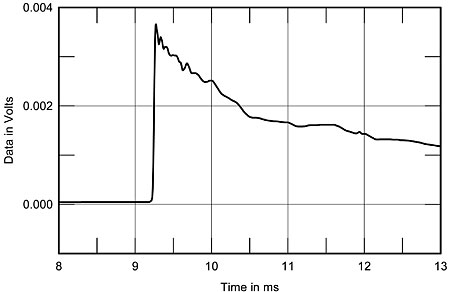

The truth is that 99.5% of all commercial multiway speakers are not transient perfect. And most people don't know what it really should sound like.
Here is a step response of perhaps one of a handful of commercial speakers measured by Stereophile that is transisent perfect (Dunlavey SC-IV):
The ideal shape is a right triangle.

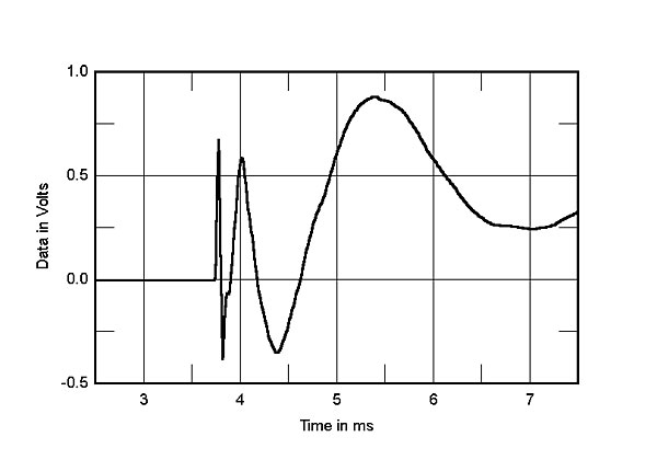

Here is the measured step response for a very highly regarded $22k/pair speaker by B&W (820D3) also by Stereophile:
Note that all the peaks seem to arrive at different times. What do you think that does to the sound of a percussive pluck, rim shot, snare drum, piano strike, etc?
That's why I am using a 1st order XO.
Here is the measured step response for the 10F/RS225 with 1st order XO:
Some of you will point out that this is only true for one spot in the room as the speakers are not coaxial point source. True, but it is not far off if you wander off the sweet spot by 3 feet either. It certainly doesn't look anything like what a Linkwitz-Riley 2nd order looks like.
