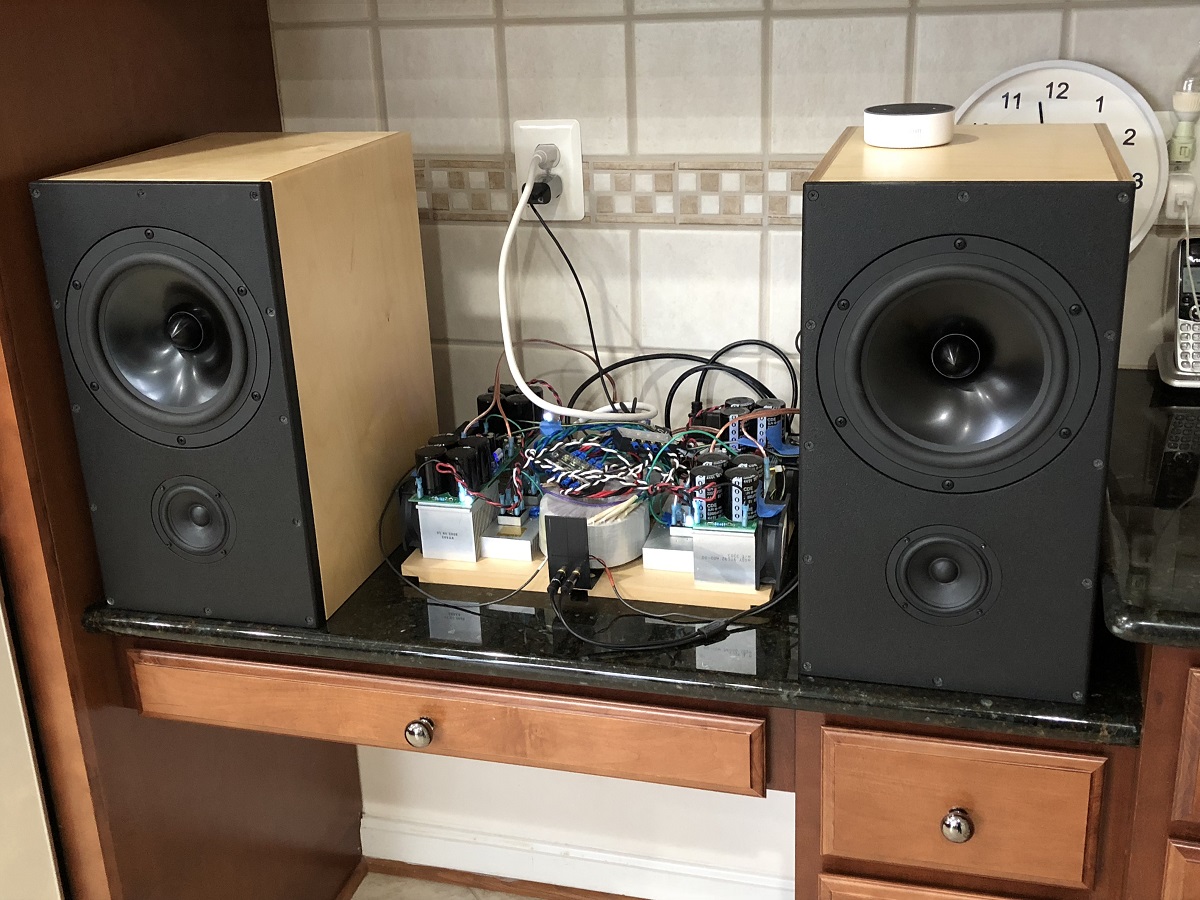

Possibly the finest "kitchen radio" I have ever heard? My basement repairs are still not done and my main system has been sitting there unused in storage upstairs for 2 months now. So I decided to dust it off and put it in my kitchen. Here are the 10F/RS225 FAST speakers with one of Hugh's new 35w Class A amps (cooled with 4 silent PWM fan cooled CPU heatsinks) and all fed by an Amazon Dot for source. Extremely easy to use and great sounding.

Not bad for a kitchen system! Hugh's new 35 watt Class A amps? Please tell us more. Did I somehow miss this thread or are they a commercial product he's selling?

I can’t give technical specifics since it’s a commercial design, but the sound, as you might expect from Hugh, is superb. It does everything just right. The amp has a lots of caps right on board for the built in power supply. The distance from power supply to outputs is very short and as you might expect, the impedance is very low for deep impactful bass.

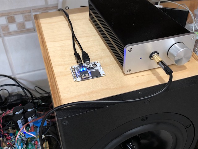

I changed the Dot to a dedicated Sanwu Bluetooth streamer device followed by my OPA1688 dual parallel headphone amp as a preamp, and I have to admit, the sound is much better than the Dot by itself. Although most of it may just be the preamp. The volume of course, can be turned up past clipping now if desired and this amp holds up very well. Still playing super clean at loud levels. Very clear yet loud. I even put some hip hop on and the bass kick was very good.

Ahem, I decided to develop a more efficient version of the ALPHA, which clips on negative half cycle at -17V, a long way off 24V.
The technique is unusual but works very well. With 28V volts, only 4V more than the ALPHA rails, gives it 35W into 8R and around 60W into 4R.
When X built and auditioned we decided to develop it further to a commercial product which will be sold for dollars.
Now I'm absorbed in the case issues, having spent two months poring over the pcb design, which includes SS relay protection for the speakers.
It will be announced in three months, for Xmas, as a new product. I hope, that is, if my metal spinners are happy to deliver.......
According to X, it might be Aspen's best amplifier yet, who knows? I am still waiting on the 350x150mm heatsinks, each channel dissipates 98W, so while a CPU cooler is a great idea, I believe a very large heatsink will be just sufficient.

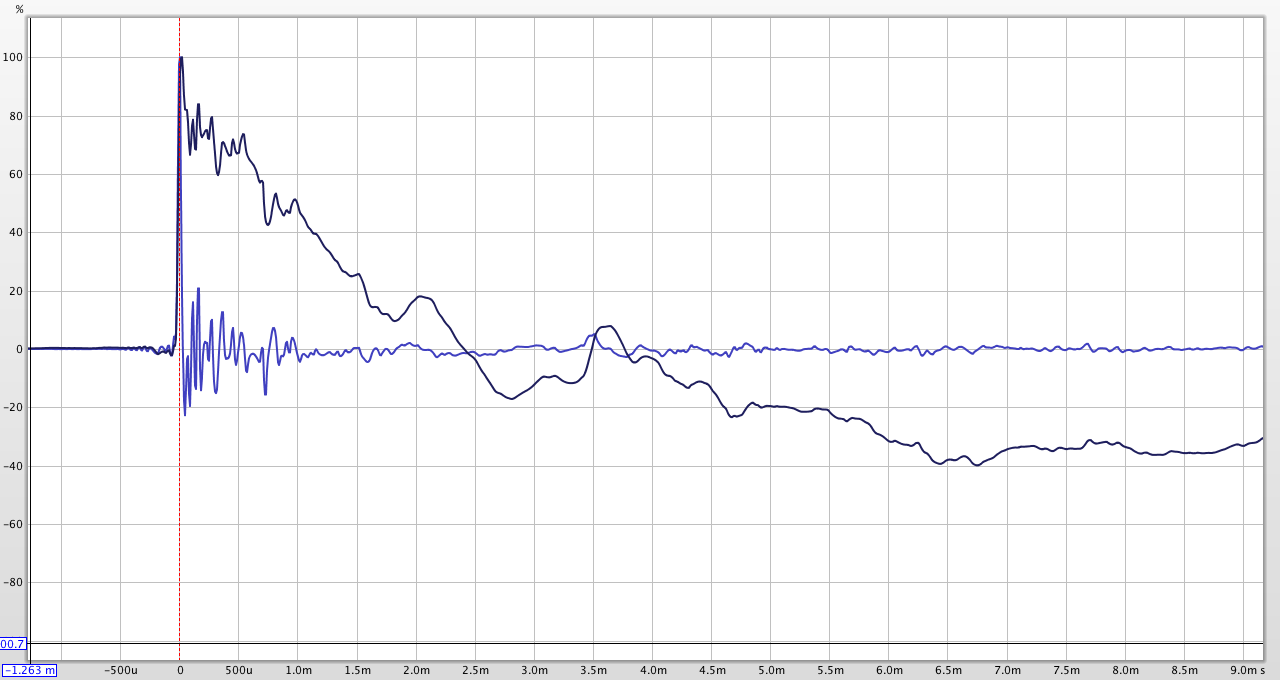

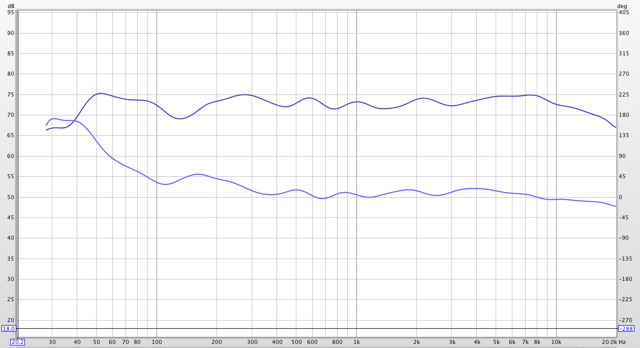

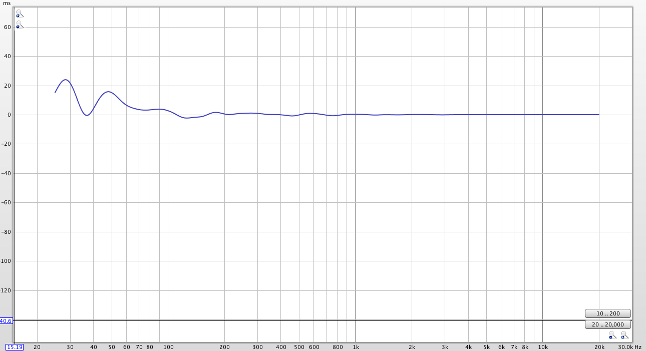

Woke up this morning and patched up a kit I had hopes for. It was a TB W8-1363sbf subwoofer in a sealed enclosure with a 4.8mH inductor, the Visaton B80 running free in a too small sealed enclosure that I had, and that was not bad. I decided to add a ribbon on top of that with a single 2.2uF cap and a resistor to pad it down to add some air and horizontal dispersion.
Ran REW, and was a bit surprised at what I got. So, I made a second setup to have stereo and played some music.
X, now I get it when you say a transient perfect setup sounds incredible. And all that running 1st order XOs... I couldn't believe it! And there's still room for improvement! I can't imagine it being better than this, but I see it would be possible to correct a few things and improve even more.
The transients... on snappy sounds, they are drilling in the middle of both my ears.
The imaging is simply scary! Pin point accuracy.
After that, I spent close to 4 hours listening to my music library. Mesmerized. Crazy amount of detail, enough low end reach, and the transients...
I guess this is not full range forum stuff anymore... but it started out that way. And the B80 does most of the coverage. 🙂
Here's the FR, impulse and group delay. Still room for improvements. I'll be working on that to see how far I can take this. But, I'll be listening some more, getting stoked for a while!
All this to basically say thank you, XRK971, for showing us your experiments and steering us into good designs, and a shout out to wesayso, whose perseverance is a motivator in itself!
