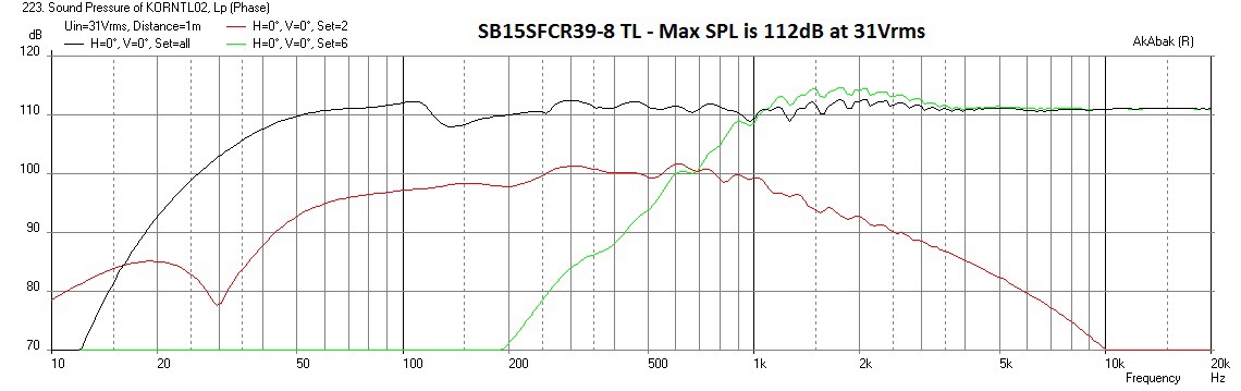

The narrow 5in wide dimension on the minor axis, and TS parameters reminiscent of the RS225-8 were what got me interested. Instead of two drivers as mid woofers and two as bass woofers with a tweeter on top like the Elsinore 3 way, this is a much simpler design in keeping with the FAST concept with all four woofers in series-parallel for enhanced sensitivity and running them wide band with a first order XO that’s very much like the 10F/RS225 speaker of this thread. Being a solid 90dB after a 5dB baffle step loss, the 10F did not have the sensitivity or power reserve to keep up. So I decided to use the PRV 5MR450NDY-8. It’s about 94dB sensitive andbhs a great wide bandwidth. Perfect for a passive 1st order XO. Initial simulations are with driver TS parameters assuming perfect piston behavior, breakup peaks have to be dealt with using notch filters.
My initial sims assumes a rather wide 11in (ext) cabinet as I had RS225’s in there. Not shown here, but reducing cabinet width by 1in allowed max power to go up a bit as cone motion was more controlled. It’s a tapered TL with about 100in length. Drivers arranged as WWMWW where M is PRV 5MR450NDY in a 2 liter Dagger that hopefully will not obstruct the TL too much. Here is max SPL assuming 11 in wide cabinet. At 10in it went up to 113dB at 33Vrms.

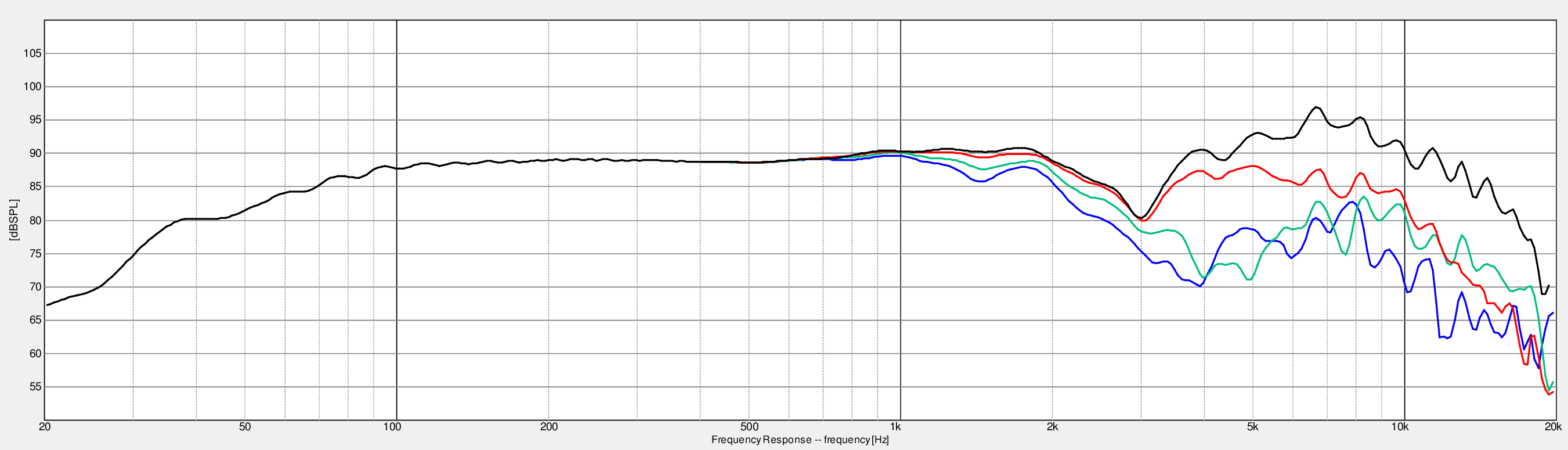

Notice the nice XO at about 800Hz and good transition over the baffle step region (red curve is only output from one of four drivers):

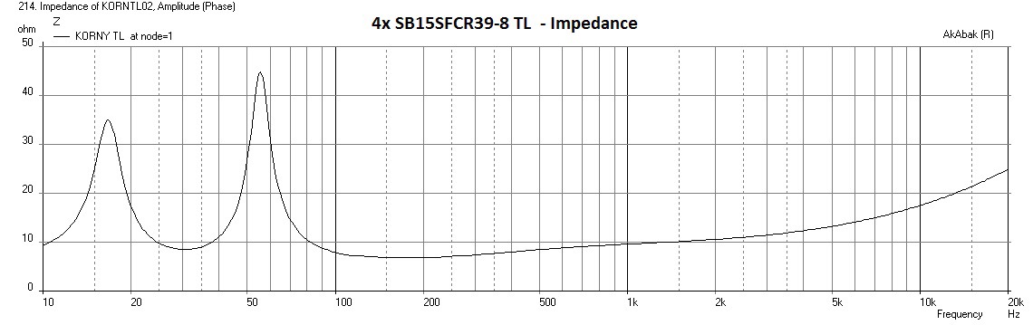

Here is the predicted impedance for the woofers:
Probably some more damping inside the TL is needed flatten those peaks.
