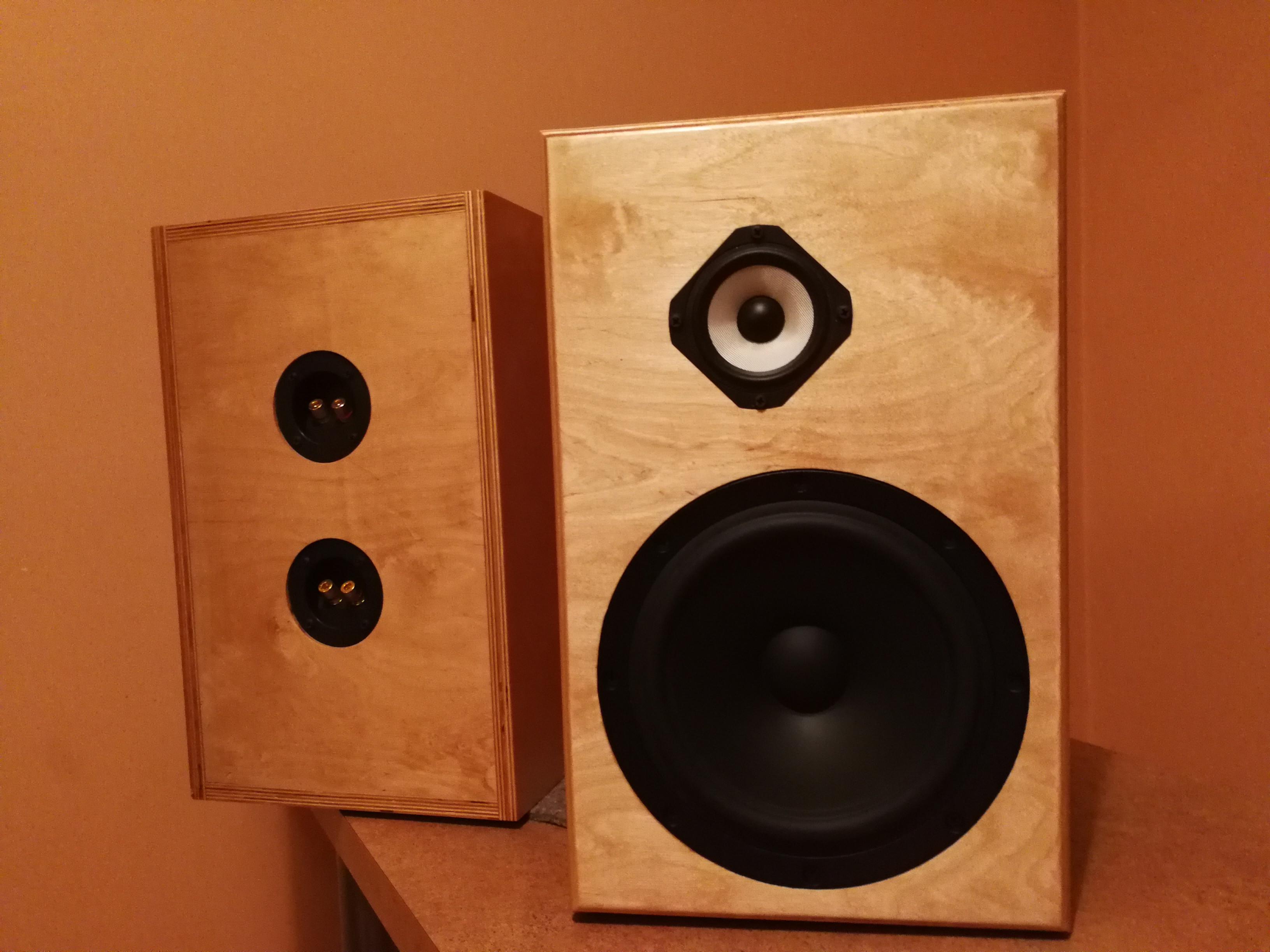

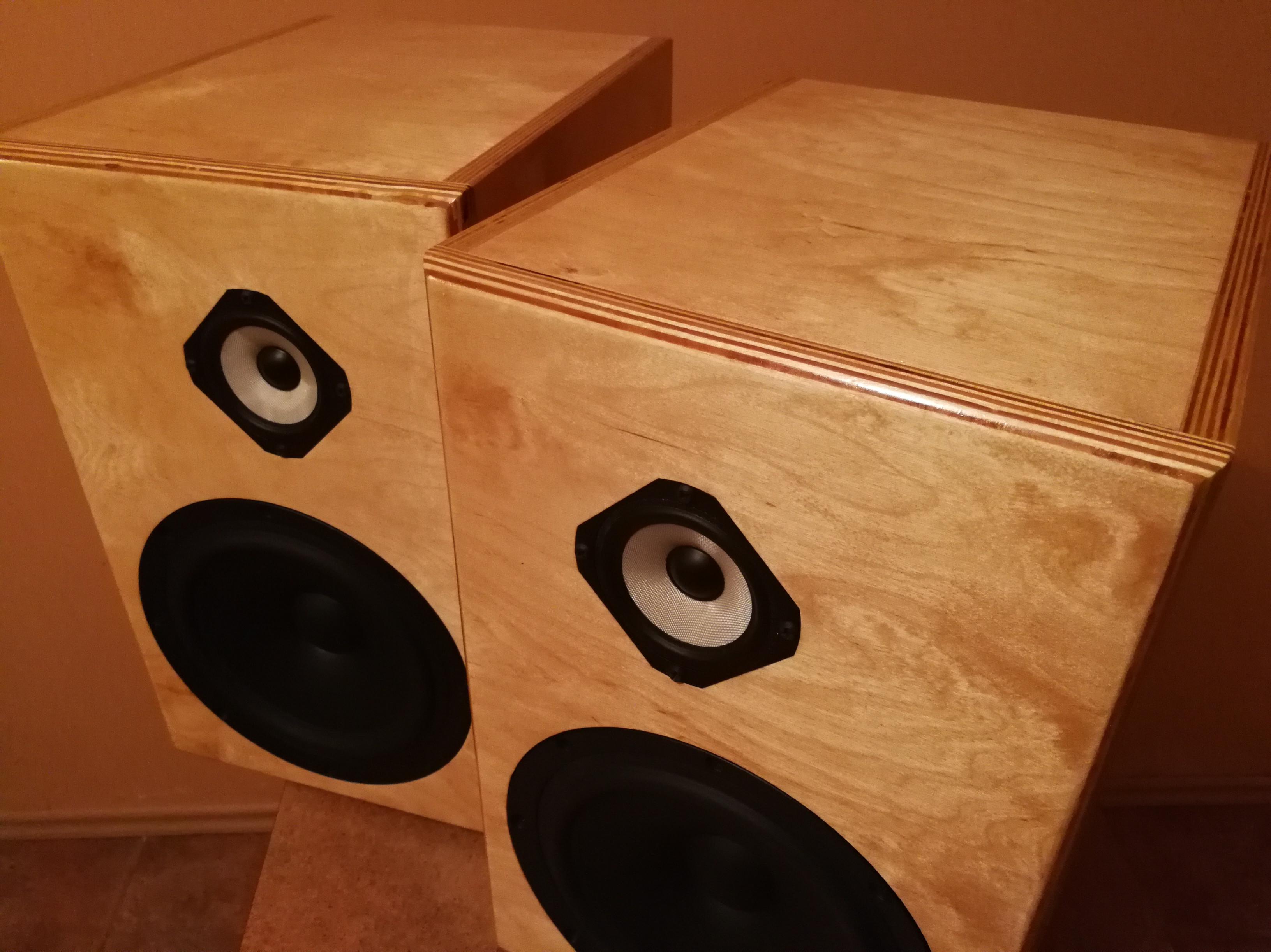

The easy part is officially over, now all that's left is hundreds of measurements, xo adjustments and constant questioning of everything
I do love the look of varnished birch...
very nice build

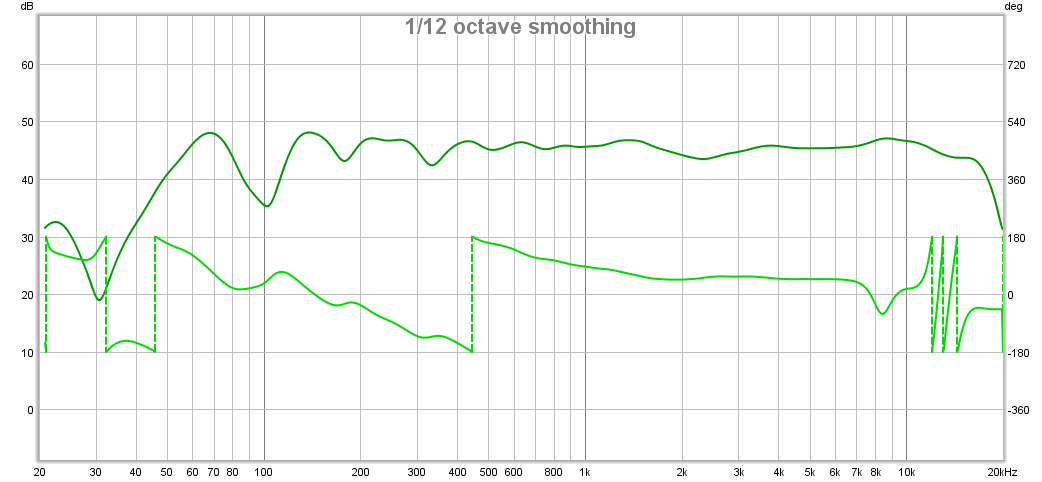

I am very very happy with these speakers, mainly due to very low distortion and clarity. So far I've settled on LR12 at 400Hz. LR12 at 300Hz sounded very clear but somewhat strained, 500Hz muffled (I suppose I don't like SB23's mids), LR24 muted at any frequency and I couldn't get a proper Harsch in several hours so put that aside for the future.

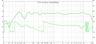

Also noticed that my TG9FDs have a shelving droop of about 2dB from 2kHz and the SB23s have a rising midrange, so solved both of those with a global eq (Q 0.5, -2.5dB, fc 1kHz). Result attached, measured at ~1m, gated at 6 cycles.

So are you using a Harsch Xo? The woofer needs to have a Bw4 lowpass snd mid tweet a Bessel 2 (all acoustic) so electrically might be any number of different filters. If you get a chance, please post the XO plots and step response. But most importantly, is that you like the sound whatever the XO may be. The Harsch XO gives the best presentation of percussion like guitar piano bass and drums.

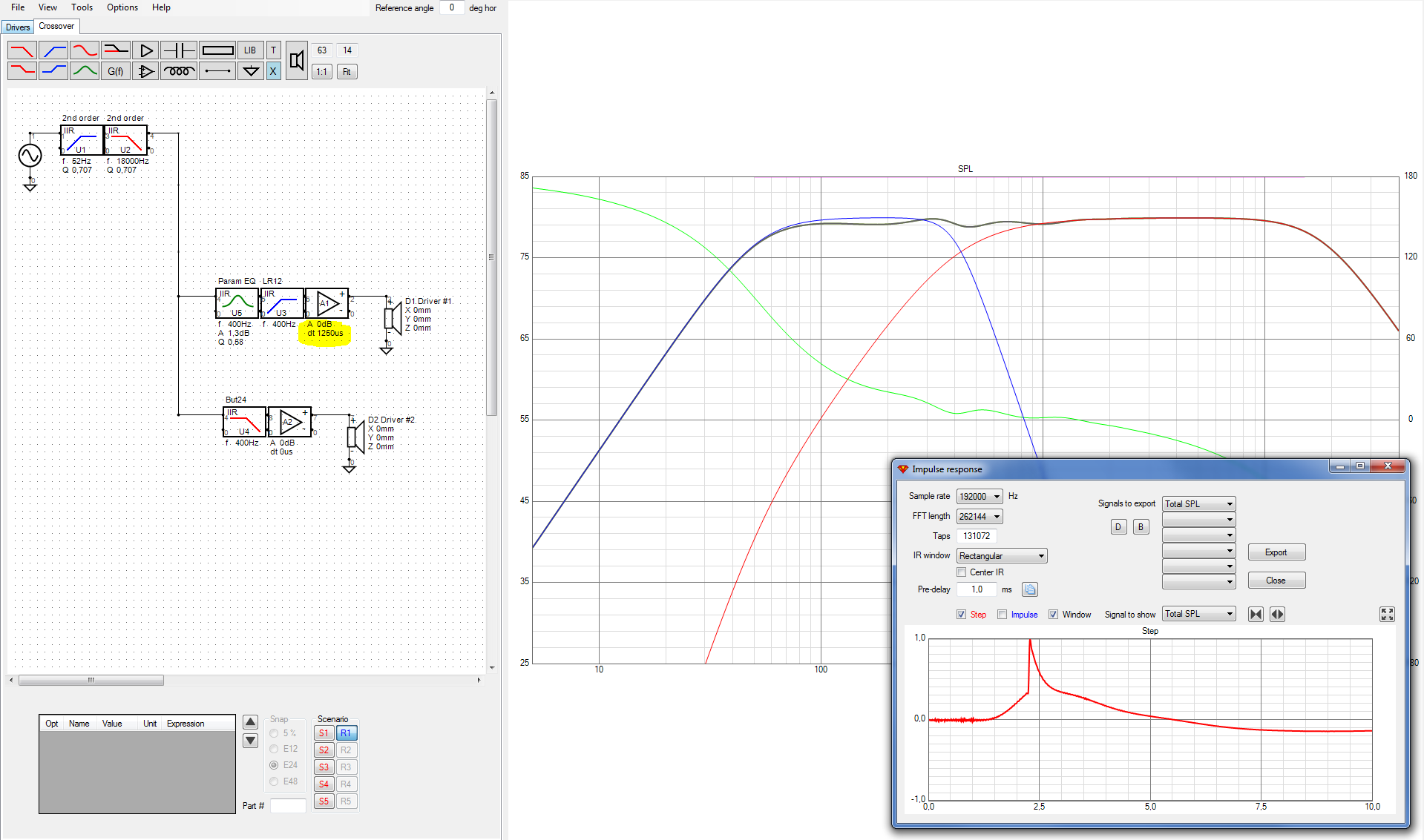

For Harsch at 400Hz remember delay acoustic center for midtweeter relative to woofer 1/400=1.25mS, that said real world the two acousitc centers are not alligned so probably a little less. Also not shure if one can select a Bessel textbook filter into DSP engine at 400Hz, at least into VirtuixCAD the build in Bessel textbook filter would not work and have too muck overlap, it begins to work using 450-500Hz numbers. Alternative that works perfect is form a Bessel slope at 400Hz for Harsch is use 2nd order LR at 400Hz plus a PEQ at 400Hz +1,3dB/Q0,58, as seen below.
