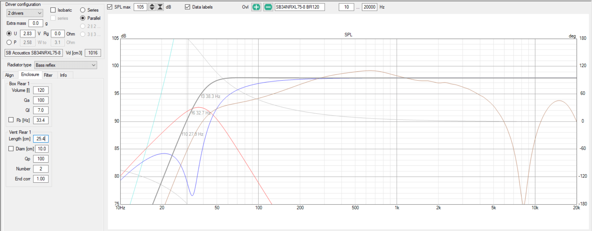

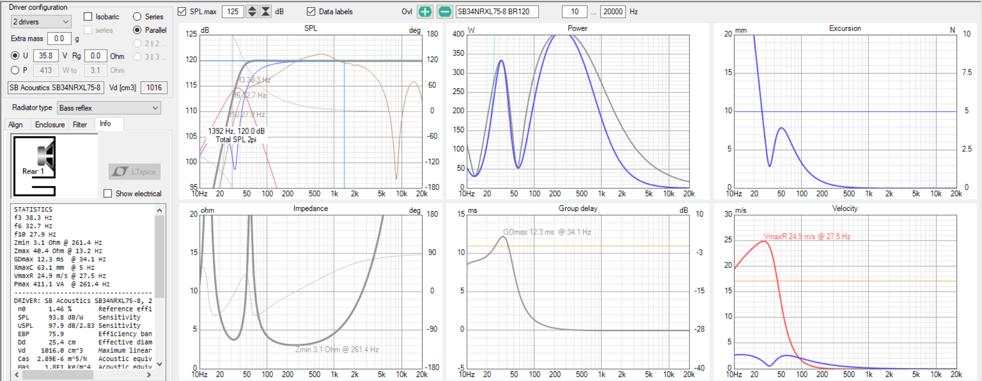

Exhibit A:
Twin SB Acoustics SB34NXRL-8 in 4.25 cu ft BR cabinet.
Anechoic sensitivity of 98 dB/2.83V (black line)
After typical baffle step loss ((a cabinet of 13 3/4" width) sensitivity is 94dB/2.83V
With only 400W in 4 ohms- the maximum SPL is 120dB in 2pi.
Use twin 4" x 10" ports for an F3/F6/F10 of 38/33/28Hz:
I'd love to see a single 15" woofer in comparable cabinet size of similar performance...

That's a very good design, that's hard to dispute but I'd increase the box volume to 6 cubic feet, 170ltrs and lower tuning as appropriate. However, an AE TD15H, X or S might have lower distortion below 60hz. For $200 more a BMS 18 might beat all.For woofers, Vd matters.
