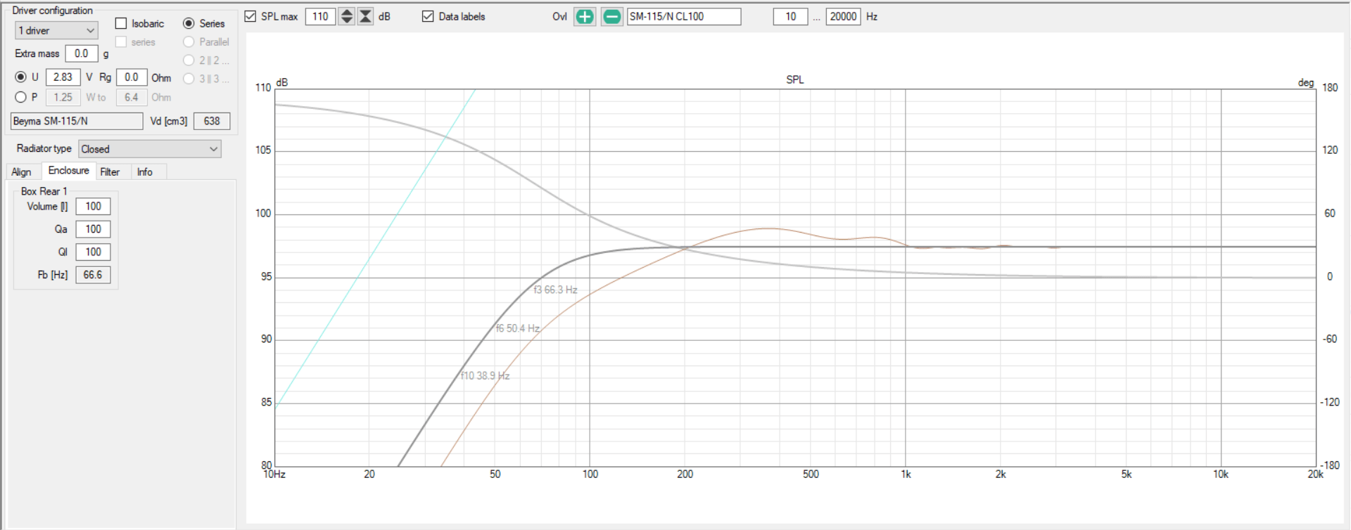

What you're after is a bit the holy grail for many, but hard to do physically. Closed to what you want, and only with dsp or an custom analog active crossover, is the Beyma SM-115N woofer in a 100L sealed. It rolls off fast without eq, but you got all the headroom and xmax to eq it flat to 30Hz untill very high volume (116dB or so).
Winner winner chicken dinner!

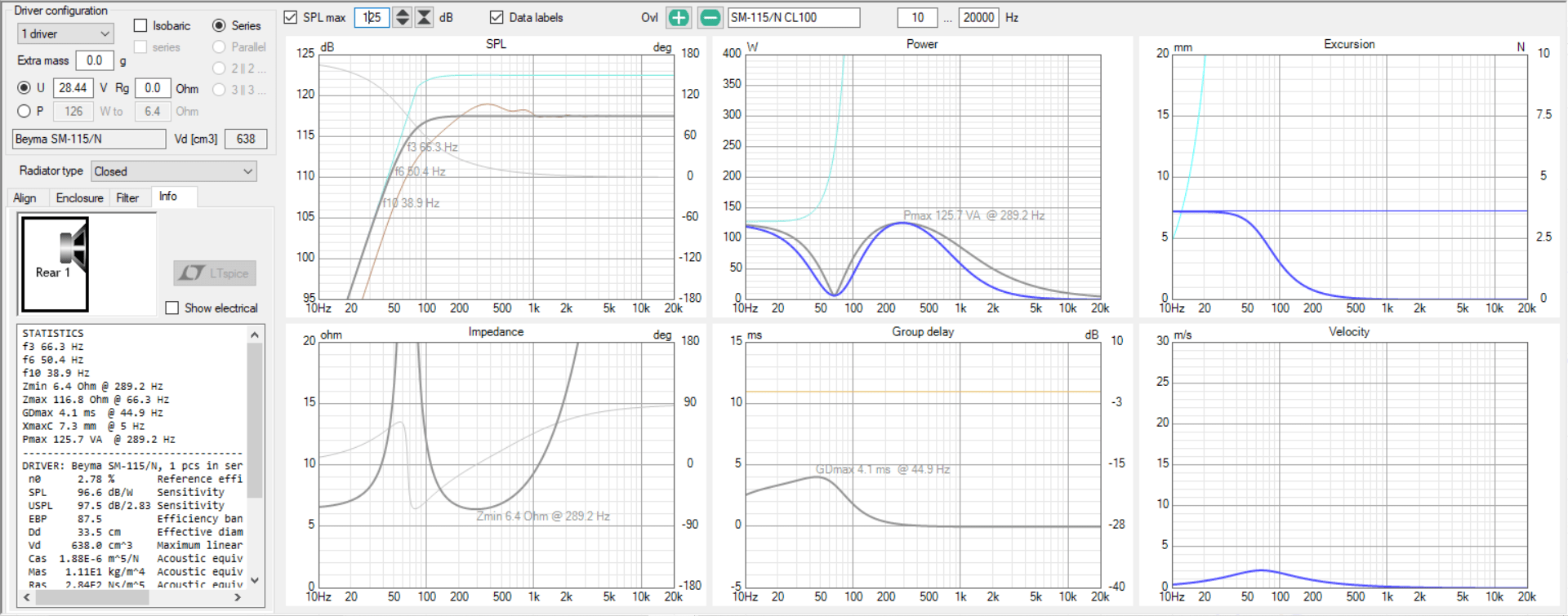

Single Beyma SM-115/N in 100L sealed cabinet.
Anechoic sensitivity of 97 dB/2.83V (black line)
After typical baffle step loss (modelled by a cabinet of 17" width) 100Hz output with 2.83V input is just over 93dB (brown line)
Excursion limited SPL coincides with 100W in 8 ohms:
Worried it doesn't go deep enough?
Then add a Linkwitz Transform- you sacrifice some maximum SPL but get to deep enough to not need a subwoofer:
Ding ding ding! TKO!
Thanks @waxx
Meets all of OP's desired attributes.
