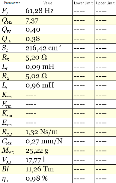

Thanks Jim! I looked this driver more times but in my situation I would trade the very low Fs and high Xmax of this woofer for higher sensitivity/efficiency and lower Mms, that's why I asked for 25-30 Hz Fs. I haven't found this driver yet. On paper, Faital's new 12RS430 looks like what I'm thinking, but it's a 12-inch driver.I think the SB42FHCL75-6 may get overlooked sometimes because it comes from a company heavily associated with home hifi rather than pro-audio. If this same driver were offered by Failtal-Pro, JBL, Beyma, Eighteen-sounds... it might get more attention.
View attachment 1206972 View attachment 1206973

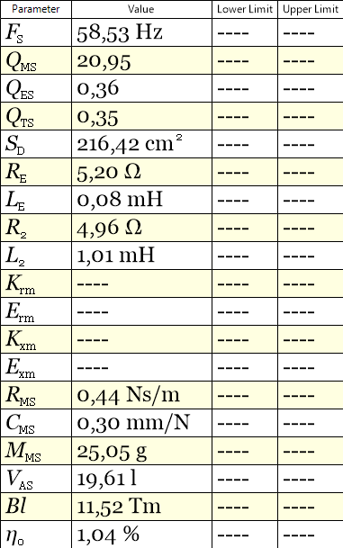

Voice coil test Bench February 2012 has the BMS 18N862 with klippel data etc.

Qms of >20 stands for a very low loss mechanical construction. (Beyma can do this, I measured one of their 8" with also crazy high Qms. Sounded also very good).

That's not easy. As you say these values are by far no constants as TSP may delude. (btw Thiele and Small where totally aware of that. In fact everybody who measures TSPs knows that these are no precision values - more a linearisation at one point of the behaviour of a driver)@IamJF

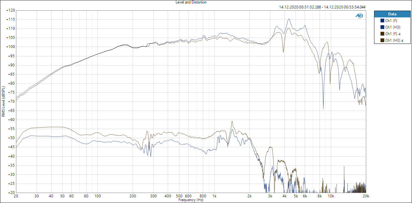

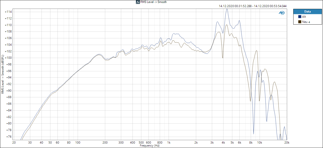

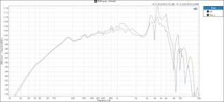

Little story - I wanted to settle with Beyma 8P300, did listening tests and was happy. Had an older chassis from an other project to do these tests, ordered a few new ones and did the listening test again - and was not happy. Did all my measurements and detected they changed the rubber surround (it was Covid times) as their supplier couldn't provide or was closing doors. It was stiffer now. The chassis actually measured better around the resonance but THD goes up in the midrange. Still good. But Qms goes down and my impression was midrange was less "open" with less details. So I'm searching for low loss chassis now for my projects.
Here some measurements old vs new 8P300. Sorry for off topic but probably fits the High End theme in this thread? Old in Blue:
Easy to spot difference - that's just the rubber surround (distributor confirmed my suspicion after talking to Beyma)
Btw - I also asked a reputable monitor speaker company what they do about this cause they use this chassis in important models of their lineaup. They told me they use DSP anyways and calibrate each monitor ...
