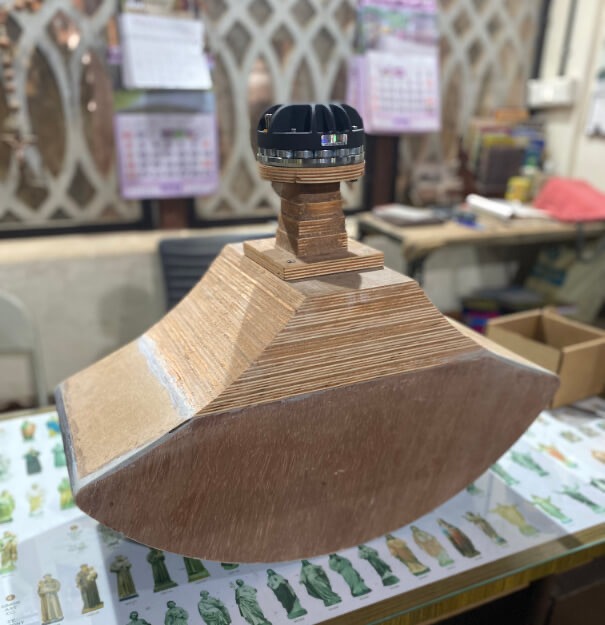

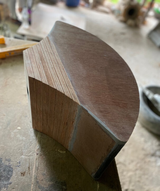

2-way horn system based on the MK3B2

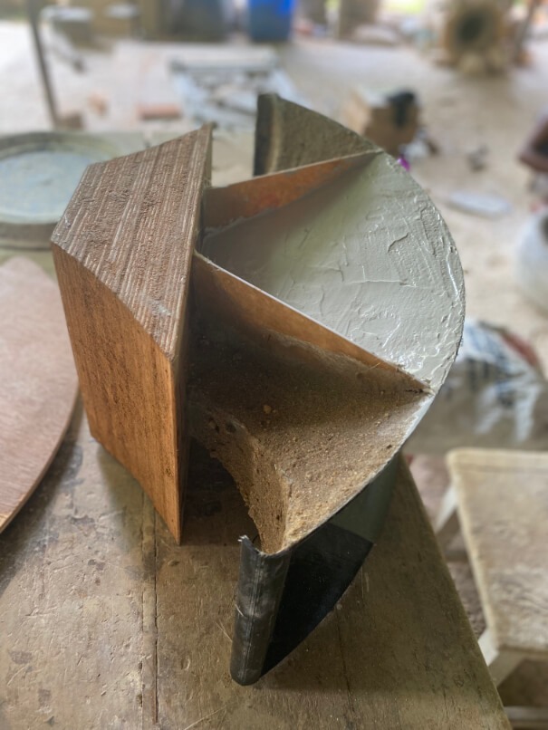

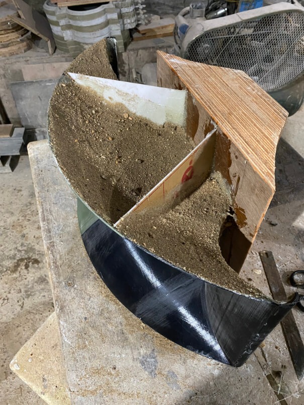

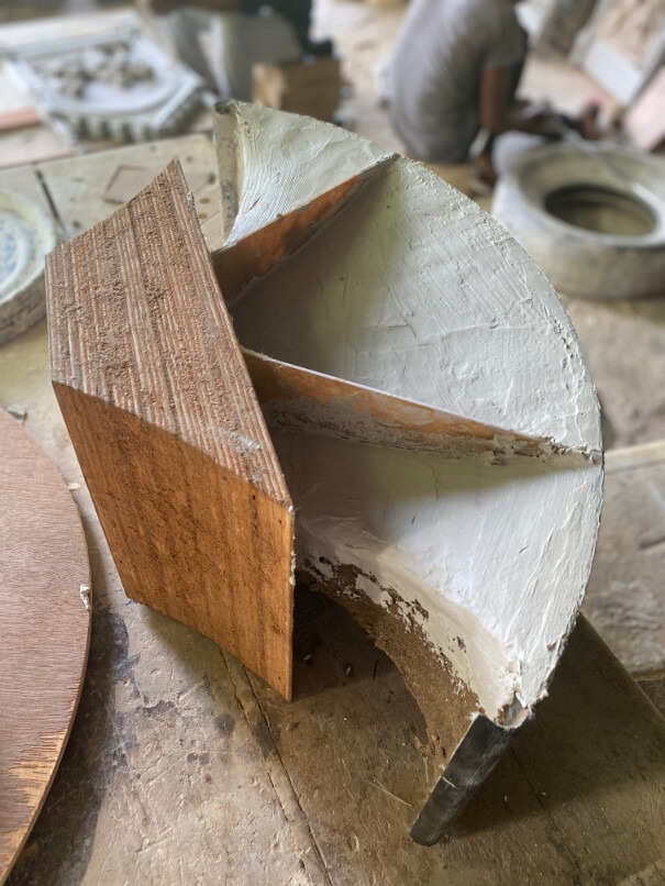

It's definitely looking more solid now. How well did the fiberglass bond? was it PLA?

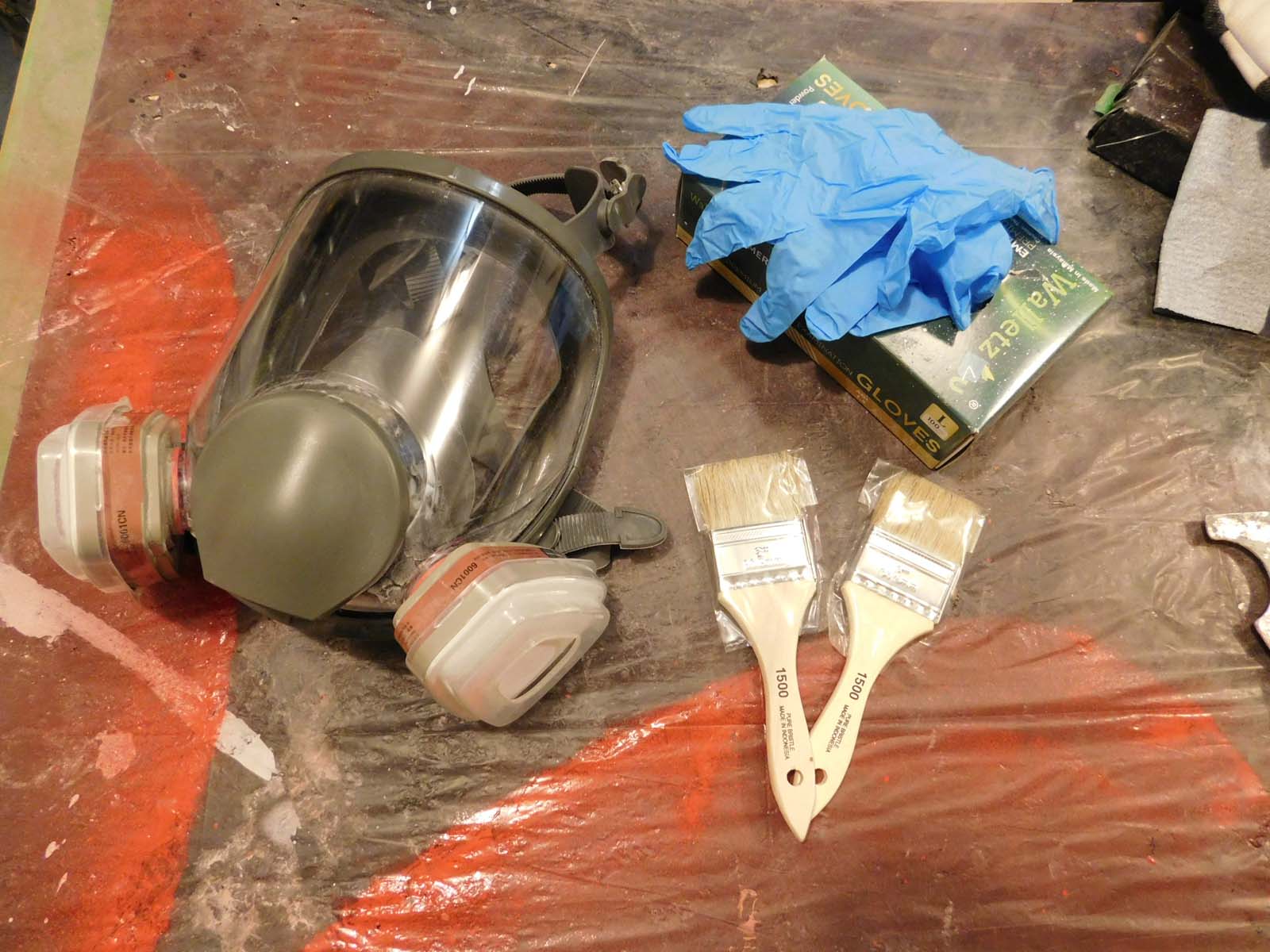

Hopefully you have some of this equipment. The fiberglass fibers and polyester resin are hazardous.

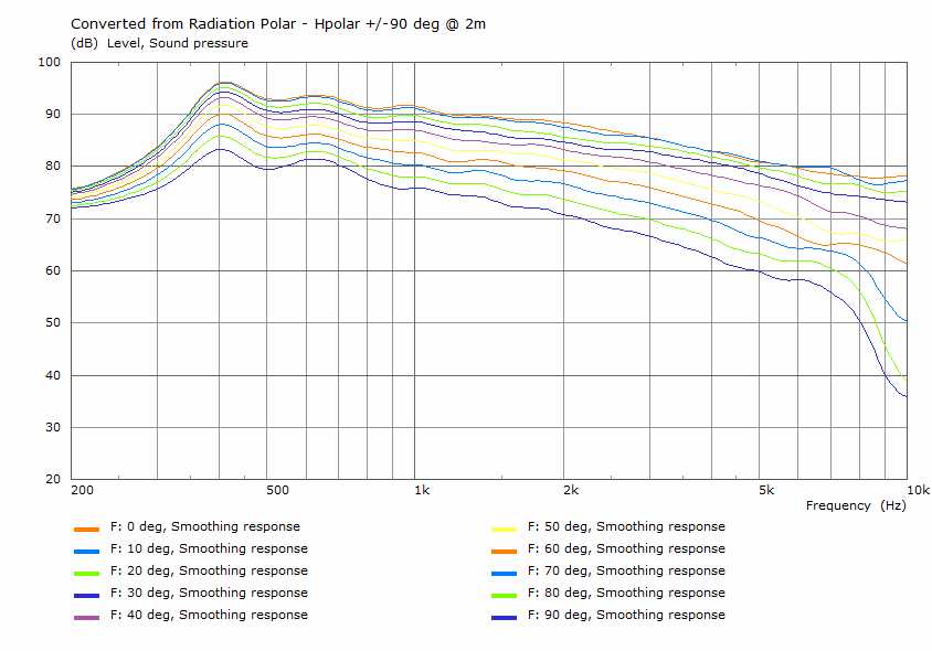

That also looks normalized, to get non normalized polar curves is a little tricky as the model was solved with constant velocity not constant acceleration, I think that needs a resolve for that change rather than a different observation script like Don used above.
Yes, it was constant velocity drive, an resolve not required for constant acceleration drive. The plots show the required distance is the same as your rule of thumb.
I would need the adapter and compression driver for the sim model to produce a good non-normalized graph.

You are right. My plot above is also normalized. I didn't have access to an unnormalized plot.
I was trying to say that if possible can we also look at the discrete frequency response curves corresponding to different angles (unnormalized if that is doable) instead of the polar plot. If it involves more simulation time and effort, I think we need not look at it since the general trends are already visible in Don's plots.

Horizontal polar curves non-normalized, constant acceleration drive, at 2m.

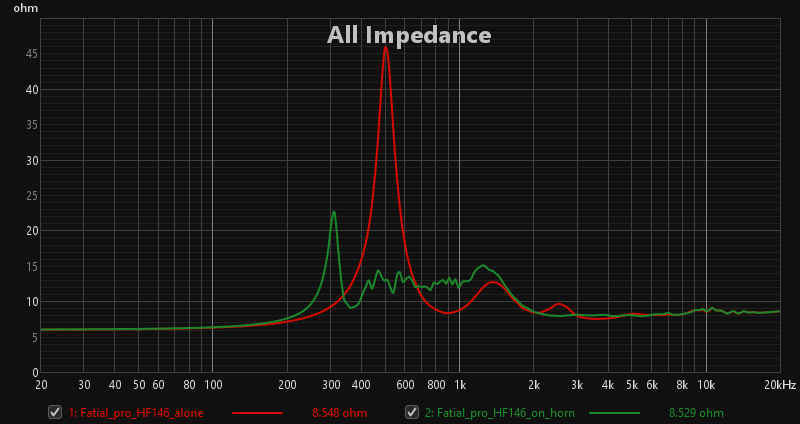

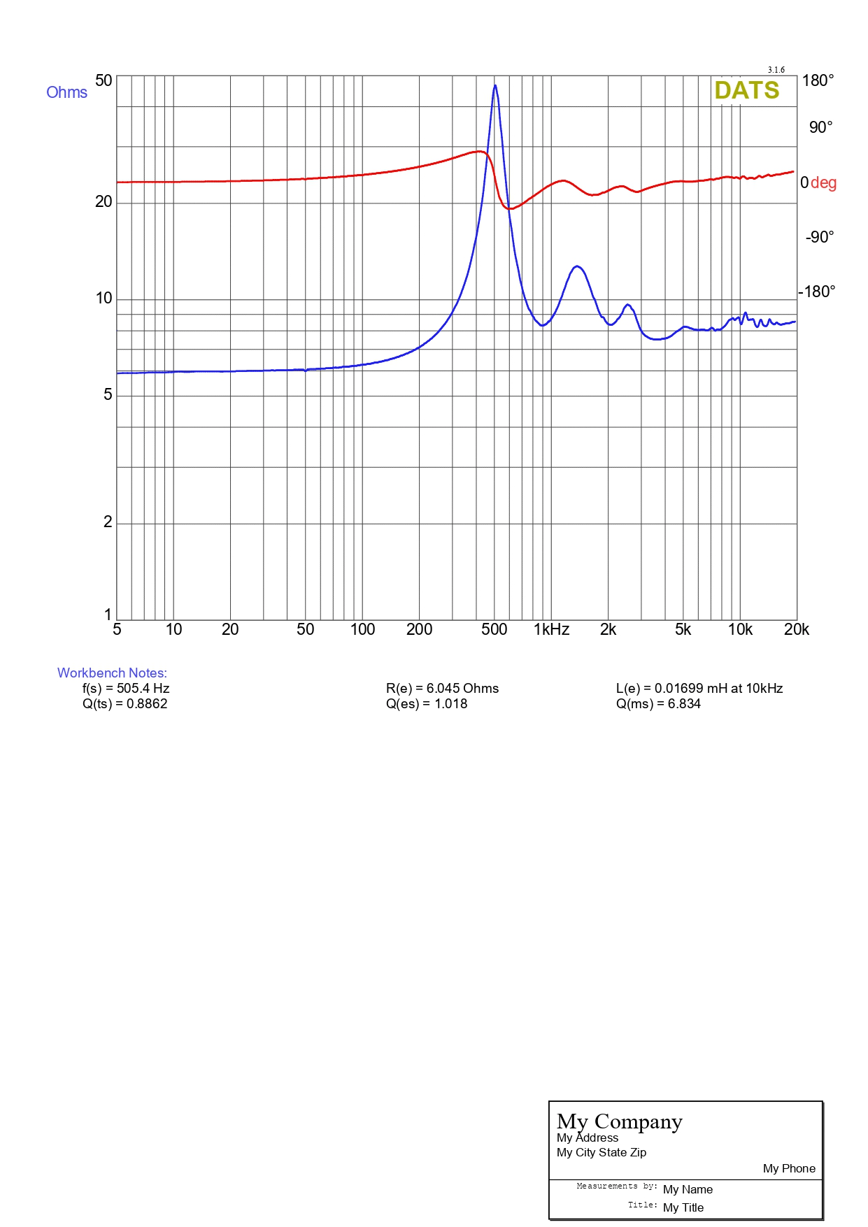

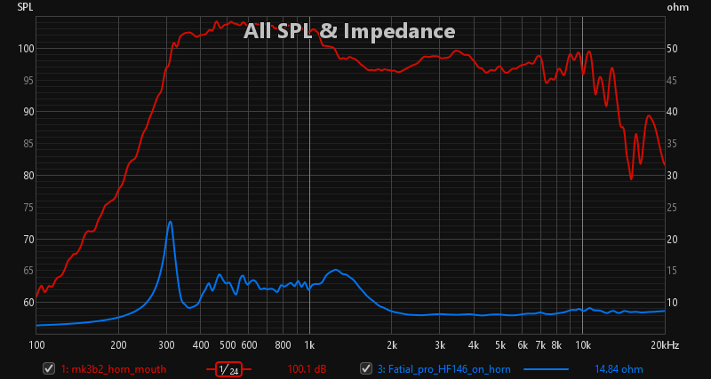

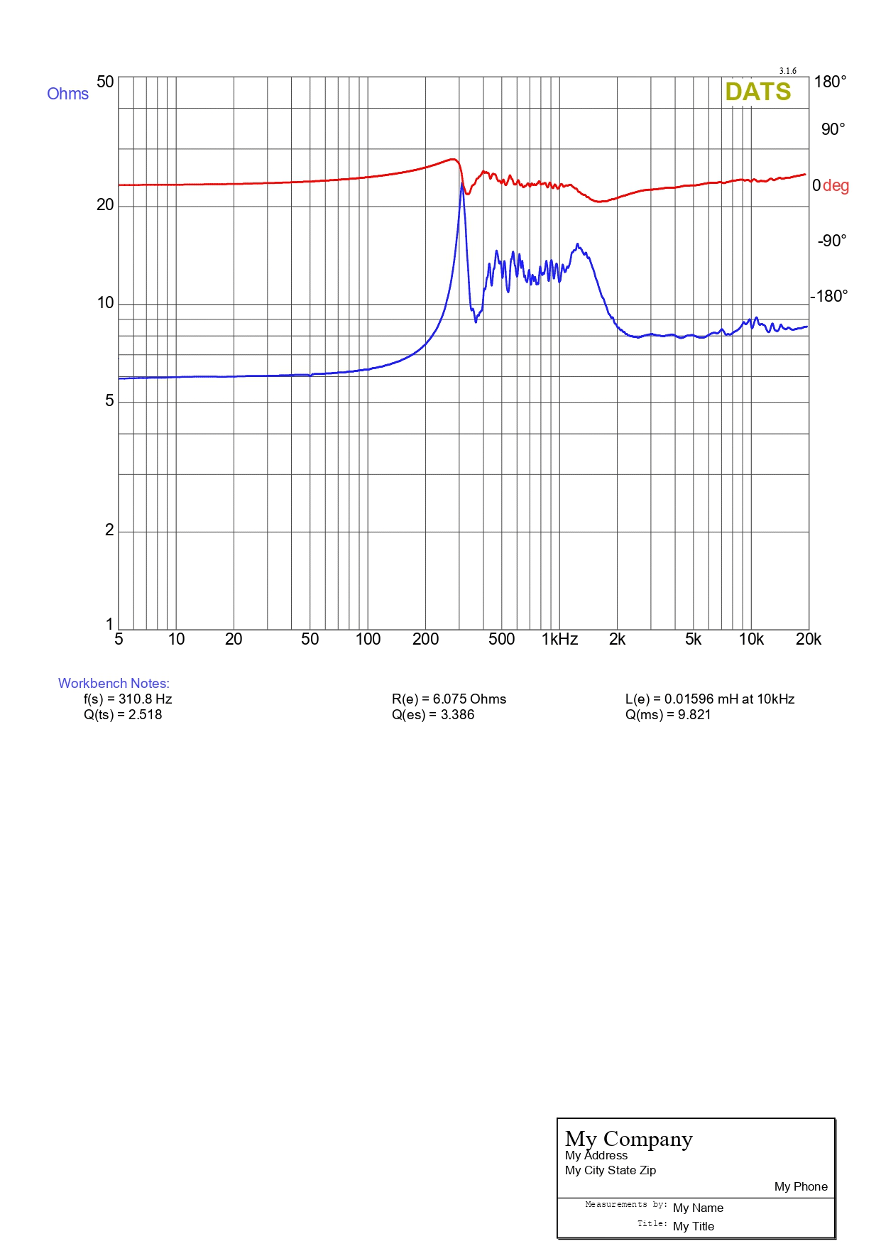

First is the set of impedance measurements.
Impedance measurement of the Faital pro HF146 driver alone
Impedance measurement of the Faital pro HF146 driver on MK3B2 horn
Comparison of Impedance magnitude responses without and with the horn

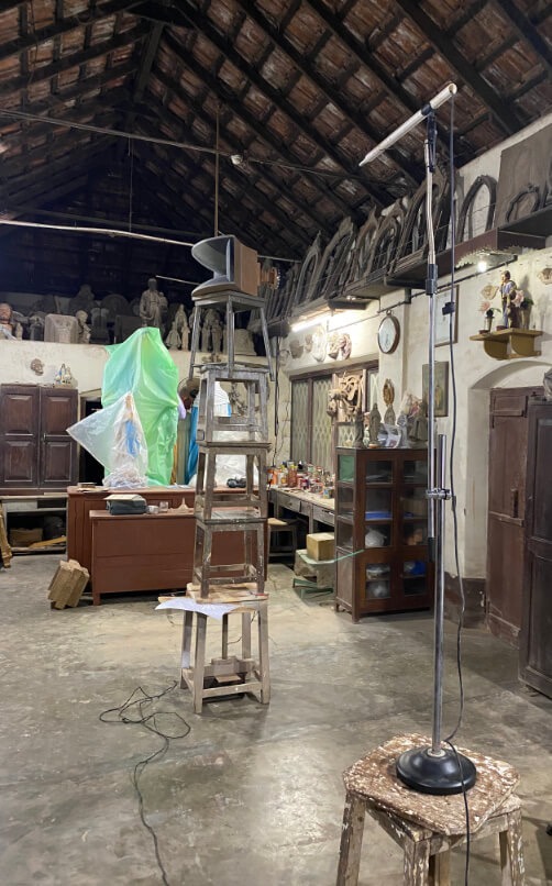

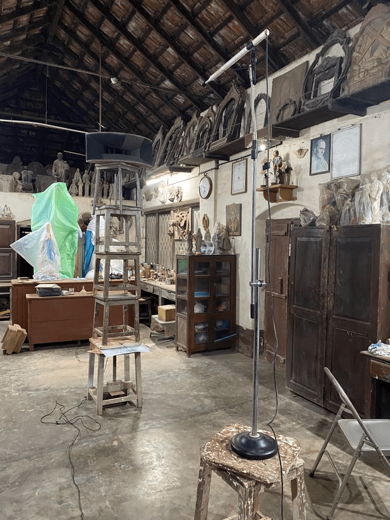

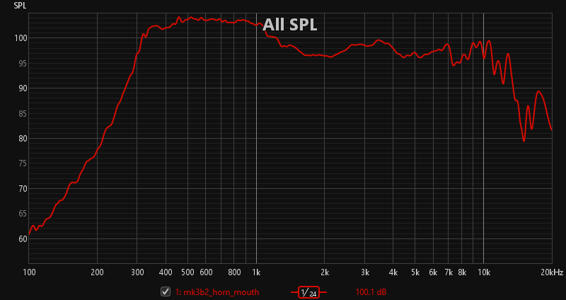

Here is the first frequency response measurement that @WetFartz took with a minidsp umik-1 (mic tip at horn mouth).

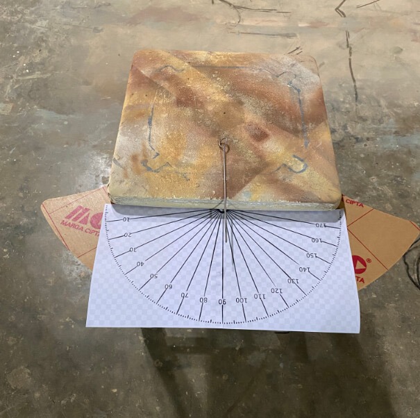

XLR mic with audio interface & horn rotating set up is being set up for angular frequency response measurements.. 🙂

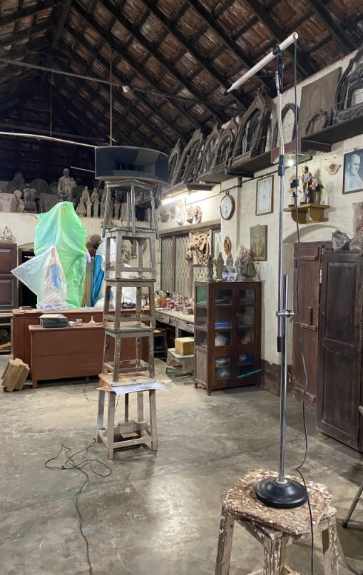

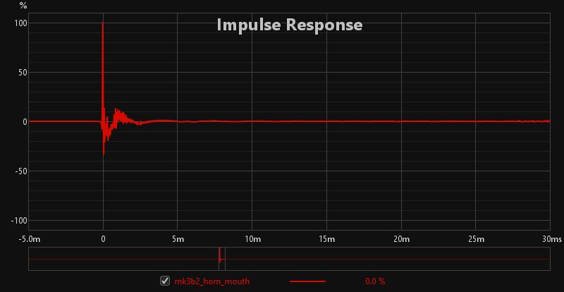

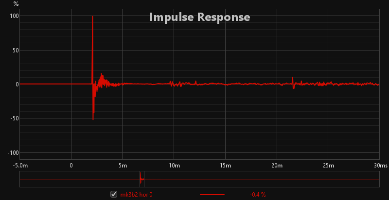

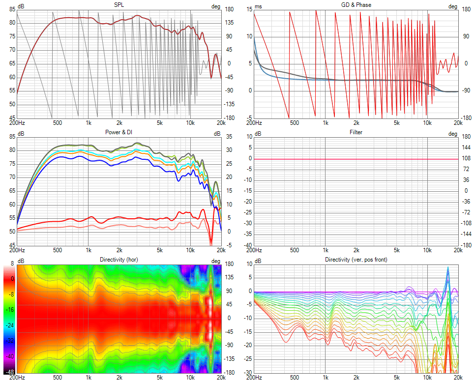

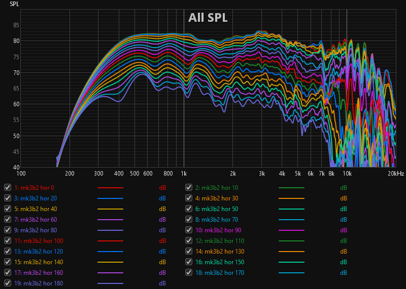

So here is the result of horizontal polar measurements (measurements captured from 0 degrees on axis to 180 degrees off axis).. 🙂

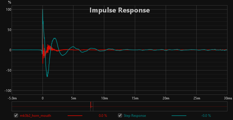

The measurements are gated at 6ms (could have extended it till 9ms in REW I think).
Measurement set up
Impulse response showing relative absence of reflections within gate window
Frequency response curves
Visualization in VituixCAD for normalized polar map
It looks like something happend around 7kHz. Not sure if it is due to driver break up resonances. Don't know what is happening around 1.5kHz as well.
Please share your comments regarding these measurements and whether the horn with this driver is good to fit into a 2-way system (or do we need to make it a 3way with a super tweeter up top)
Vineeth

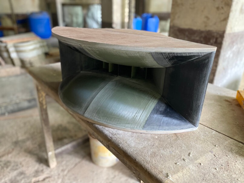

If you used a voltage source amplifier then the hole around 1k5 is related to the driver. Look at the combined impedance. Otherwise you have many sources of possible resonances in your 3d printed horn. An ultimate solution would be to mill it out of a solid block of plywood and the fins made from metal or very hard wood ;-)

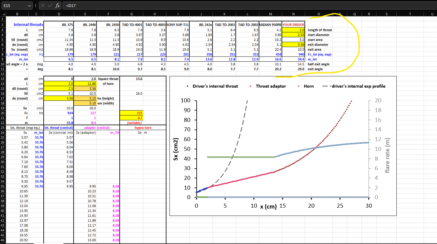

@docali: Thanks a lot for sharing the adaptor step file. 🙂
Can it be used with any 1.4inch compression driver or is it specific to some driver?
Based on the above Excel sheet, we used a conical adaptor and not an exponential one like the one you gave. We couldn't find the adaptor you gave anywhere on the website. Thanks again for sharing it.
The adaptor that we used could probably be the source of some of the issues, I guess.

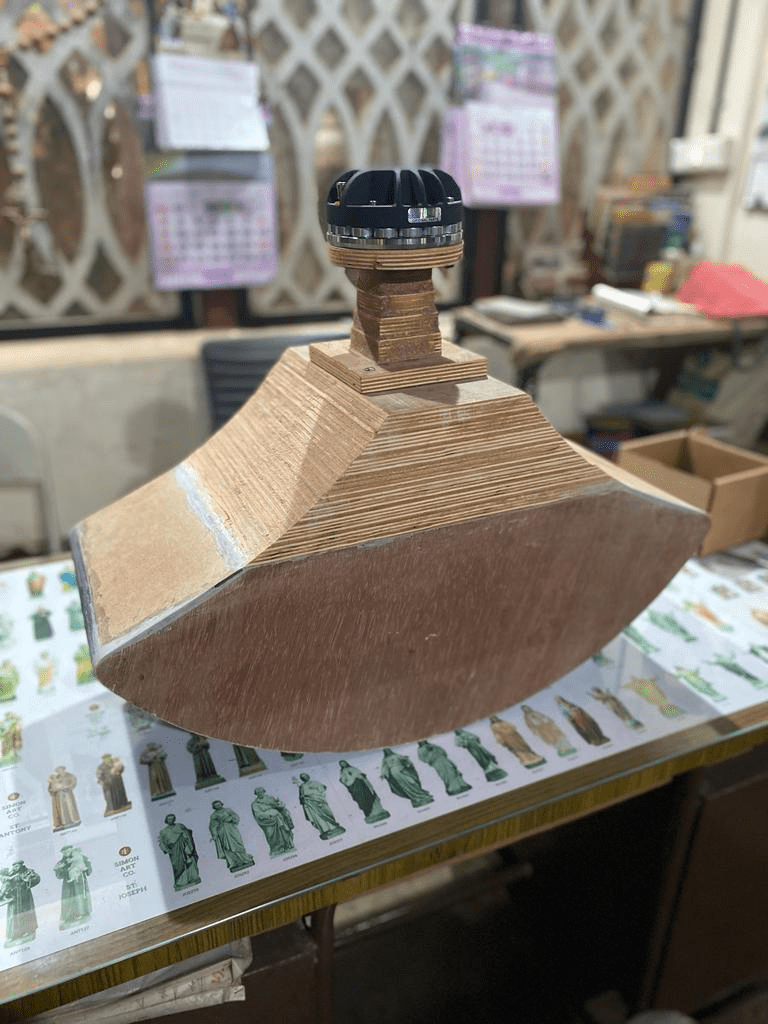

I think @WetFartz has plans to make the horn in wood eventually and this one was meant for prototype use,
My adapter only takes into account the surface area expansion so it is independent of any specific driver. You would have to choose best a driver of the "old school" design with zero or low exit angle. Anyway, there seem to be even new design with the pp ending up directly at driver exit.
I don't expect too much difference with the exponential adapter but I would appreciate if you could make a comparison. But take care to make the adapter almost resonance free. I don't like pure PLA. There is PLA/wood available and even with metal fill. Otherwise take care to damp the adapter very well.
