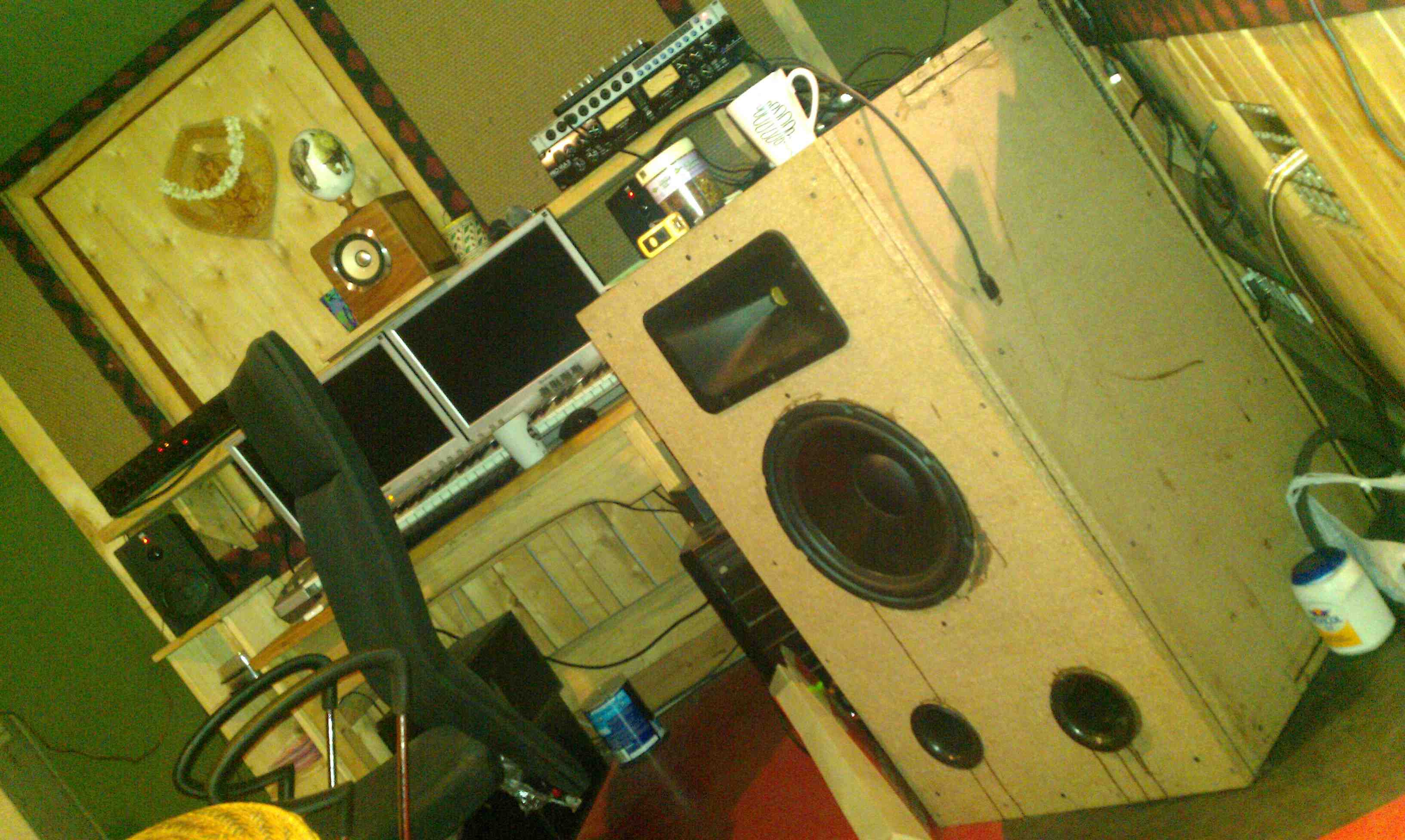

Thank you. That is an interesting speaker! But I am looking at something more like this...
Also attached is a pic of my humble first effort... obviously not finished/ready yet...
attachment.php
Jay,
Thank you. I like the symmetry in many of the models my search brought up... but as above, I'm looking at a different design approach...

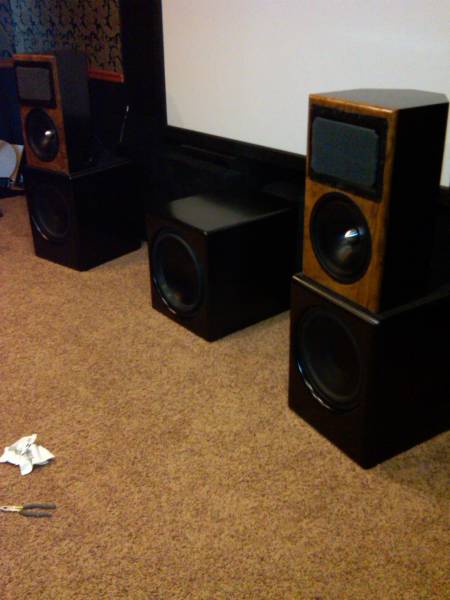

I would recommend adding a subwoofer below the Econowave. I run 3-way waveguide designs myself. with a 15" subwoofer (AV15X). Wimpy 8" drivers and smaller need not apply for the job...they are minor leagues for real clean SPL in the HT room. Do not let the regular full range crowd confuse you with the idea that a small driver does 20Hz, remember they sit about 3 feet from their speakers 😉 There is really no way of getting around the laws of physics and to have the best 20Hz to 20KHz you need multiple drivers that handle their specific ranges the best.
Here is my waveguide + subwoofer.
