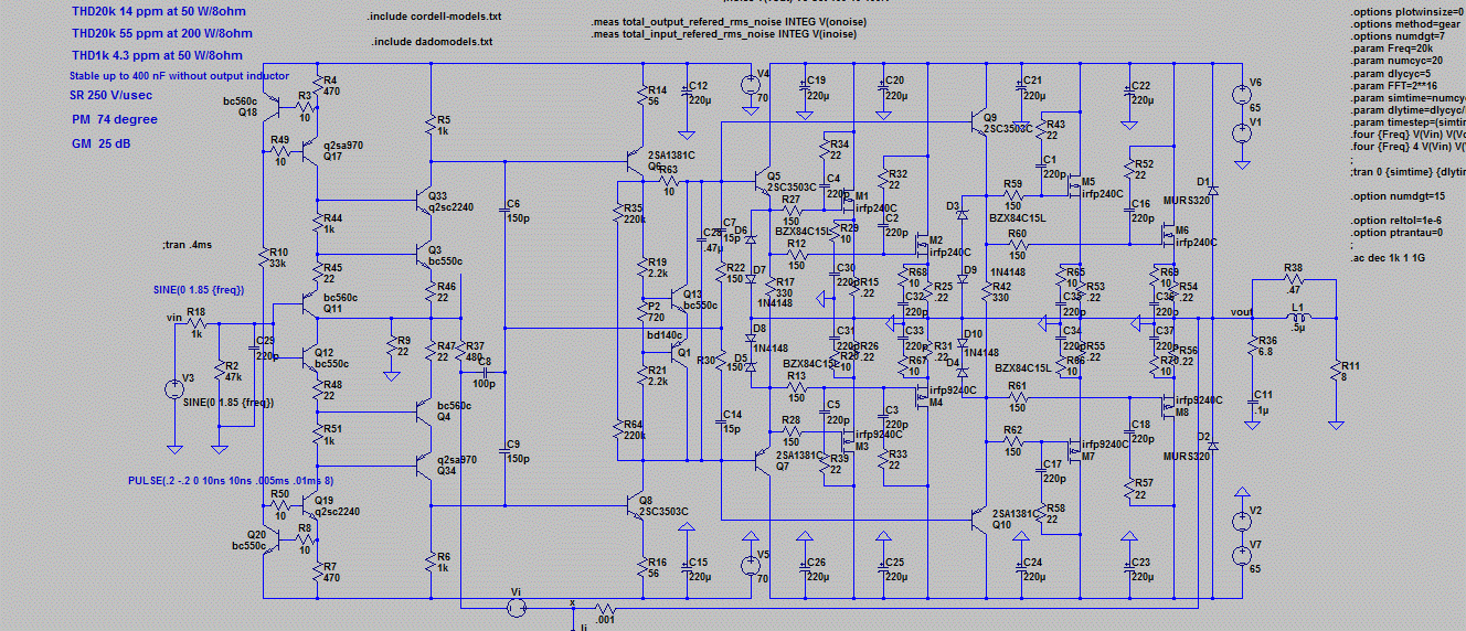

This similar CFA amp with simplified compensation, but now with vertical MOSFET OPS. It simulates a bit lower distortion and less sensitive on capacitive load.
Damir

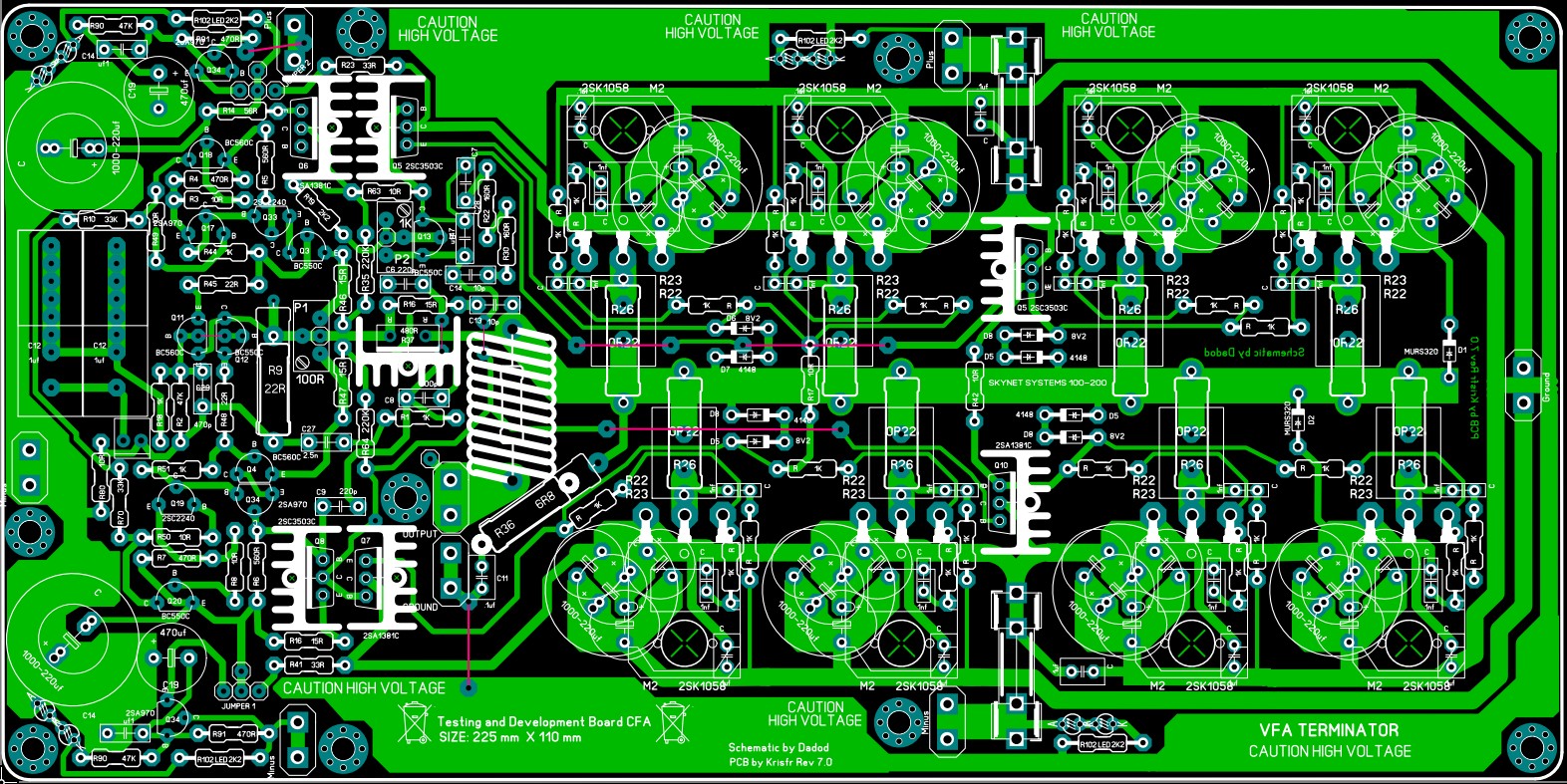

I am glad the 100W version wasn't overlooked, congratulations on your layout Krisfr, it looks good on brief inspection! Appears to be several duplicate component designators on the silkscreen though, all of the capacitance multiplier parts and R10. I would go in for a group buy on this design and I expect there are others who would do too. Is the design that of post 136 ?

Speaking of building, I am going to etch this puppy sometime soon and fire up the old lead tin melter. Please advise of any mistakes... the silk screen is not good for the OPS, I wish I could print it on this Single Sided Board. Anyone know of some trick to print in any light color ? Maybe I could get Staples to print a reverse in White on a laser printer...Ummmm🙄

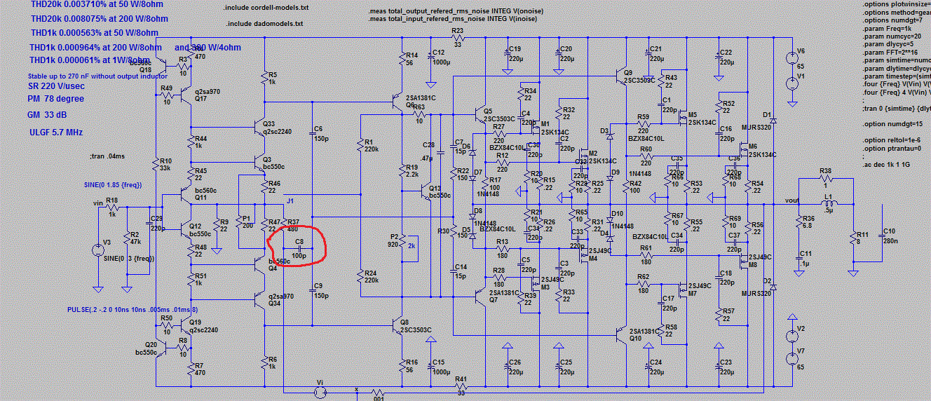

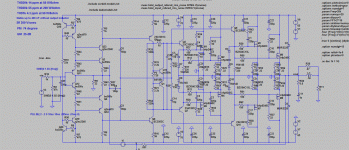

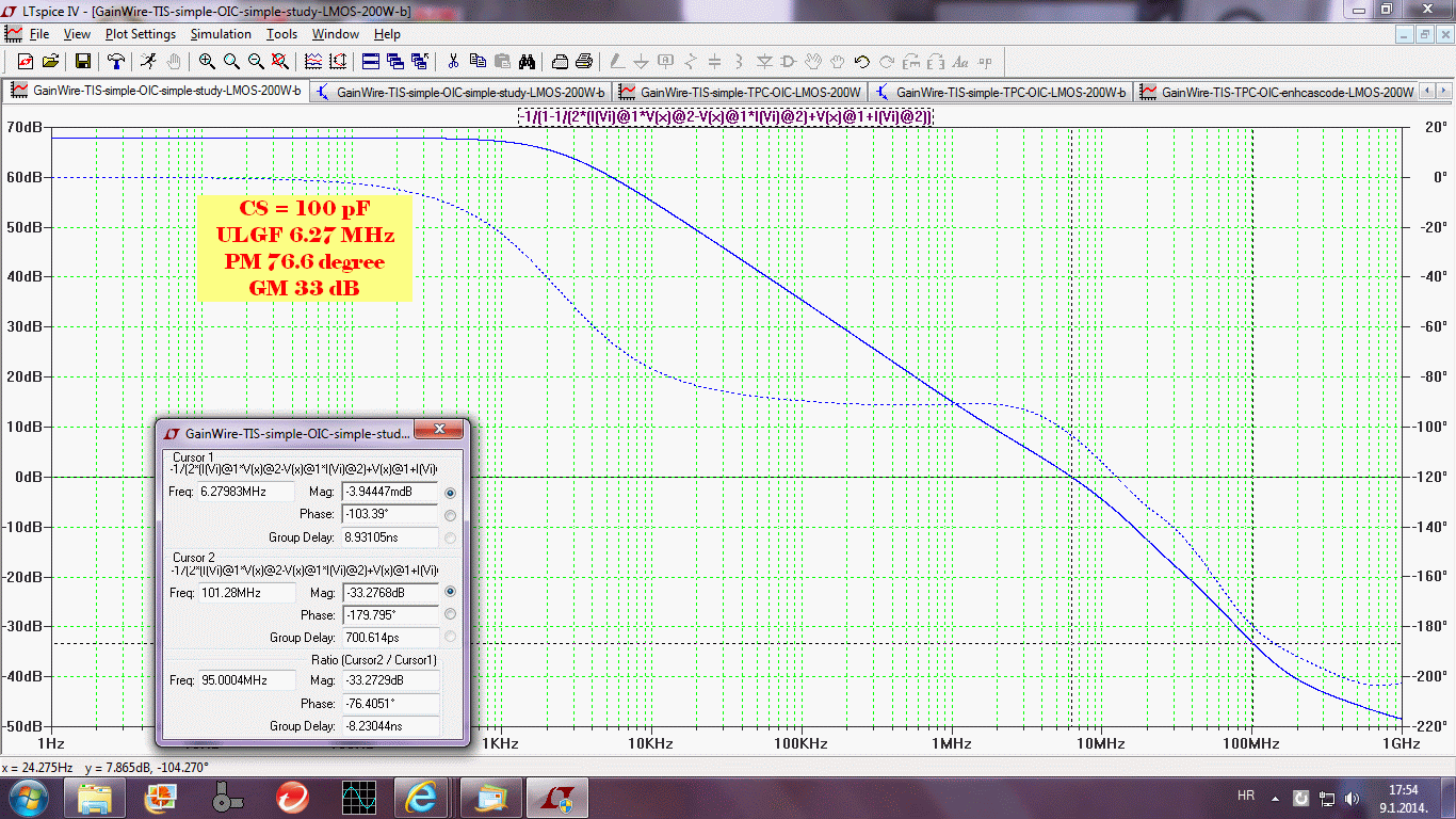

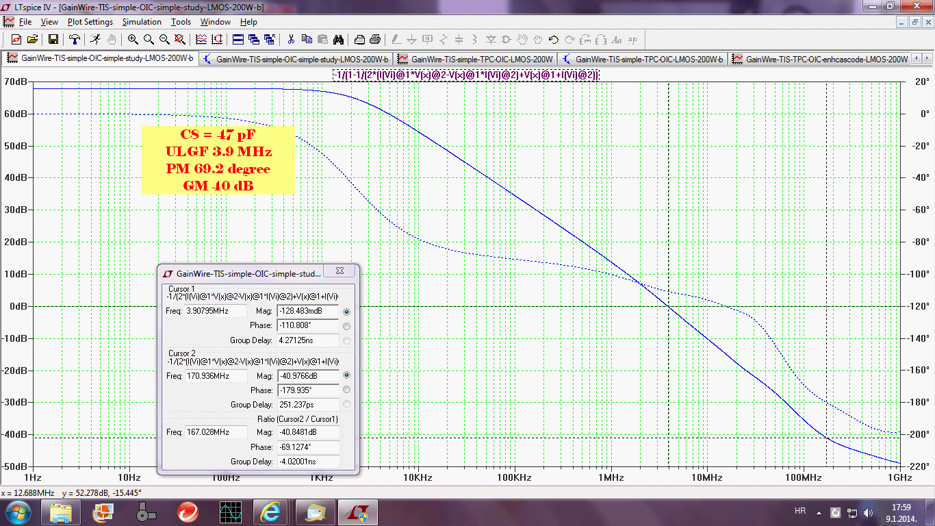

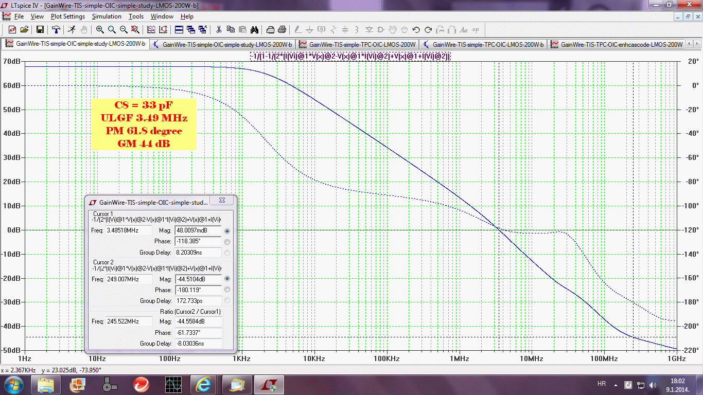

This amp use OIC(output inclusive compensation) and in smaller part Miller compensation(15p//150ohm x 2). As in other thread ongoing discussion about ULGF points that Unity Loop Gain Frequency(ULGF) should not be above OPS pole, I simulated the Loop Gain(LG) with different value for the OIC capacitor and have found something what looks contra intuitive. When I started with this amp my goal was to have good THD figures, and excellent Phase Margin(PM) and Gain Margin(GM), and from simulation it came the best value for OIC capacitor, C8 in the schematic, of 100 pF. Because of quite high ULGF (6.4 MHz) I tried to lower it. What surprised me that lower C8 value lowers the ULGF, I expected just opposite. Here LG were simulated with three C8 values. Distortion stays almost the same, ULGF was almas halved, PH a bit lower and GM improved.
I am quite confident that this amp even with C8 of 100 pF is stable, I simulated it at full power, end clipping, with different capacitive load and it shows no hint instability( with no output inductor it is stable up to 270 nF), and C8 of 47 pF is the best choice.
BR Damir

Hi Dadod,
I could be wrong, but are we looking at the global loop response by putting the Tian Probe there? Perhaps we are in fact looking at one of the "inner loops"?
I found in my simulation (of a slightly different version schematic) that by having the Cherry cap take up feed back straight from the output node instead of the left side of the Tian Probe, which I thought to be the way to examine an "outer loop" response, it makes a huge difference to the loop response result. The loop would then close at about ULGF = 1.73MHz and GM sit at about 16dB. And by increasing the value of the Cherry cap the ULGF would go lower.
Perhaps simulation gurus could chime in and offer some hint?

Hi Nattawa,
I did the simulation both way, and I think that "outer loop" response does not say enough about stability. I used similar approuch to simulate VFA amps with TMC and never had any problem when I built that amp.
I you are correct, even better, then ULGF is not above OPS pole.
David promised to do some more dip simulation(I am not that good in spice) and we will see more clearly what is going on.
Hi Nattawa,
I did the simulation both way, and I think that "outer loop" response does not say enough about stability. ........
You're right about that, Dadod. I too found it necessary to check all loops for instability, just like all the gurus have pointed out. In a VFA amp with TMC I'm currently putting together I found a phase dip dangerously approching -170 degrees while loop gain is high up at 50+ dB in an inner loop, yet the outer loop plot shows no signs of such danger at all.
You don't need to wary about that phase dip with TMC, it could come close to -180 degree without stability problem. To meliorate that dip add capacitor in serie with TMC resistor, or bridge the TMC caps with small one, but in this case you are losing some gain at 20 kHZ.
