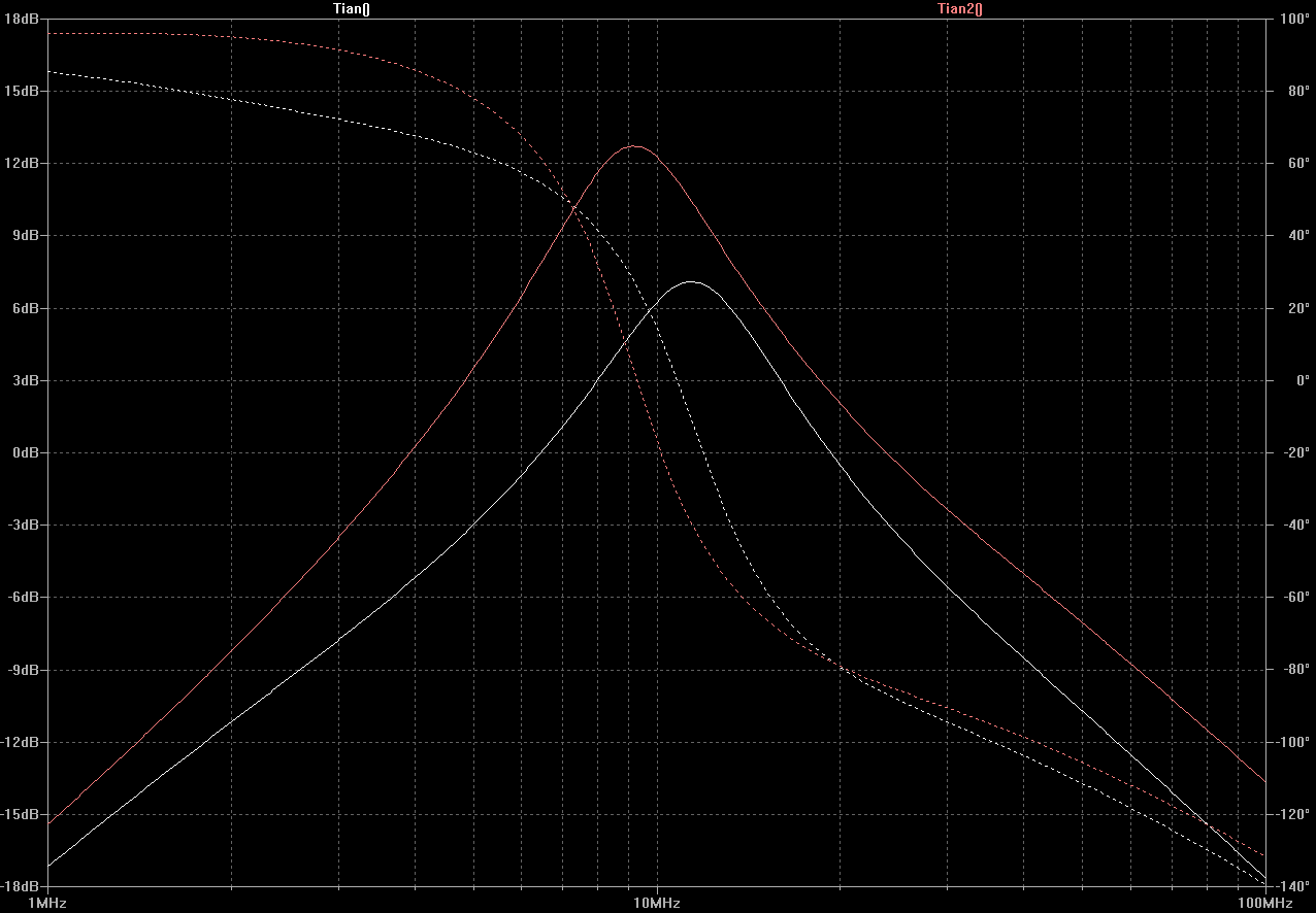

Miller loop. Tian is with 100pF C8 Cherry capacitor. Tian2 is with 47 pF. Circuit is Damir's OIC version but with simplified, one bank OPS to save space.
Hi Damir
The overall loop gain has contributions from the Cherry loop that you showed earlier and from this Miller one.
It is not yet clear to me how the contributions combine.
A bit complicated because there is feed-forward and other non-ideal effects.
It is educational to look at the Miller Loop, as you have, and then alter the Cherry capacitor (C8) as you did in post #456.
The altered Cherry capacitor has a major impact on the Miller loop.
A smaller Cherry capacitor pushes more gain into the inner Miller loop.
This probably explains your results, but we want to understand this interaction better.
I think Middlebrook's Extra Element Theorem shows how to work out the interaction in a way that is understandable.

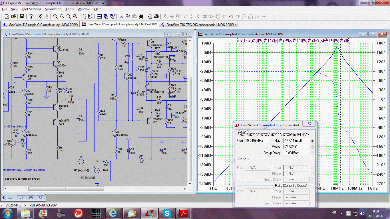

Hi David,
I will try to understand the compensations interaction better from the Middlebrook's Extra Element Theorem, but that could be over my head, to rusty after so long years from University.
But I think I started to better understand that interaction looking at Bode plot of internal compensation loops. You help a lot and thank you for your time.

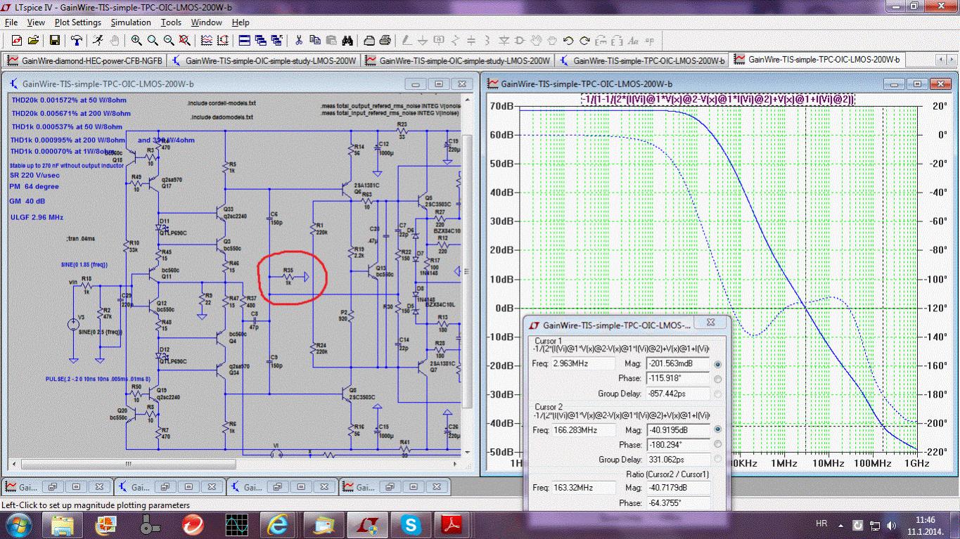

I used a kind of TCP on this amp and now I am back. Adding just a resistor(R35) to the ground and creating combination of OIC and TPC(how to call that – OITPC) and Miller compensation(no shunt compensation here, Waly should be satisfied) THD20k decreased for 8 dB.

...I used a kind of TCP on this amp and now I am back. Adding just a resistor(R35) to the ground and creating combination of OIC and TPC(how to call that – OITPC) and Miller compensation(no shunt compensation here, Waly should be satisfied) THD20k decreased for 8 dB.
Yes, I think TPC works well for OIC as well as Miller.
This is in accordance with Bode and is one of the central ideas of my article in Linear Audio.
I include TMC as a type of TPC.
And I also think you and Waly are correct, shunt is usually sub-optimal.
Nice to have the ideas in the article confirmed, I would be worried if your results did not match my theory
But the AD797 uses some shunt compensation and seems to be OK.
So need to quantify the trade-offs better.

Guru Zan, I think this effect is similar to what I observed with 'pure Cherry'. ie Smaller Cherry caps initially give better 'inner' (your Bode Return Ratio) stability while making the 'outer' main loop more wonky. But as the system nears instability (with smaller Cherry caps), both 'inner' & 'outer' loops become worse.The altered Cherry capacitor has a major impact on the Miller loop.
I'd like to do more work on this and also investigate the real significance of decoupling the VAS emitter resistor but need to get several beach bum issues out of the way.
May we beg you to use a white background on your plots?Miller loop. Tian is with 100pF C8 Cherry capacitor. Tian2 is with 47 pF. Circuit is Damir's OIC version but with simplified, one bank OPS to save space.
Also, where is the probe for these curves? Did you post a pic with it's position earlier?

...I think this effect is similar to what I observed with 'pure Cherry'...
Yes, but a bit less clear at the moment whereas I actually do understand how the two loops in Cherry interact.
Hence my confidence that you only need to probe at the one point for Cherry.

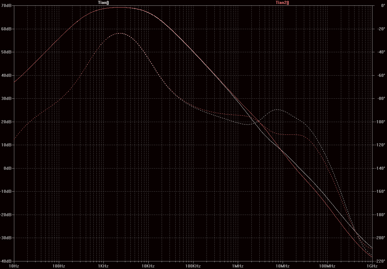

Finally finished the test fixture to see the total loop gain at the VAS.
This combines the Cherry loop and the Miller loop.
Shown is the result for 47pF and 100pF Cherry capacitor C8, in white and pink respectively.
I hope the black is not too much of a problem, it looks the best on my monitor and I am reluctant to alter it.
Just wanted to show the initial results for comment while I think about it more.
The interactions mean that a smaller capacitor does not alter the response in just one direction.
Best wishes
David

I don't know how you've got it, but it looks stable to me.

...it looks stable to me.
To me too.
I need to study why low frequency roll off, but the upper frequency area looks believable.
I did a sim with your added 1k shunt resistor and it does show an improvement in stability.
Probably more improvement possible because 1k looks not quite optimal.
Best wishes
David
Need to alter other time constants, I can't place the phase peak from the resistor where I want it.
It hardly moves in frequency as the resistor is altered, Amplifiers are never simple.
I will post more details once I am sure it's correct
To me too.
Best wishes
David
Change what ever you need to get the best compensation.
BR Damir
The low frequency roll-off is due to the power rail RC decouple to the IPS and the 1k load in the IPS cascode.
At low frequency they act as a divider for the Tian probe injection.
Need to think about what that means for loop gain but it seems my differential Tian probe implementation works fine.
Now I can accurately test whatever Damir, Richard Lee (or anyone else) comes up with.
Next step is a full Middlebrook2006 probe on the differential fixture and see if it makes any difference.
Best wishes
David
