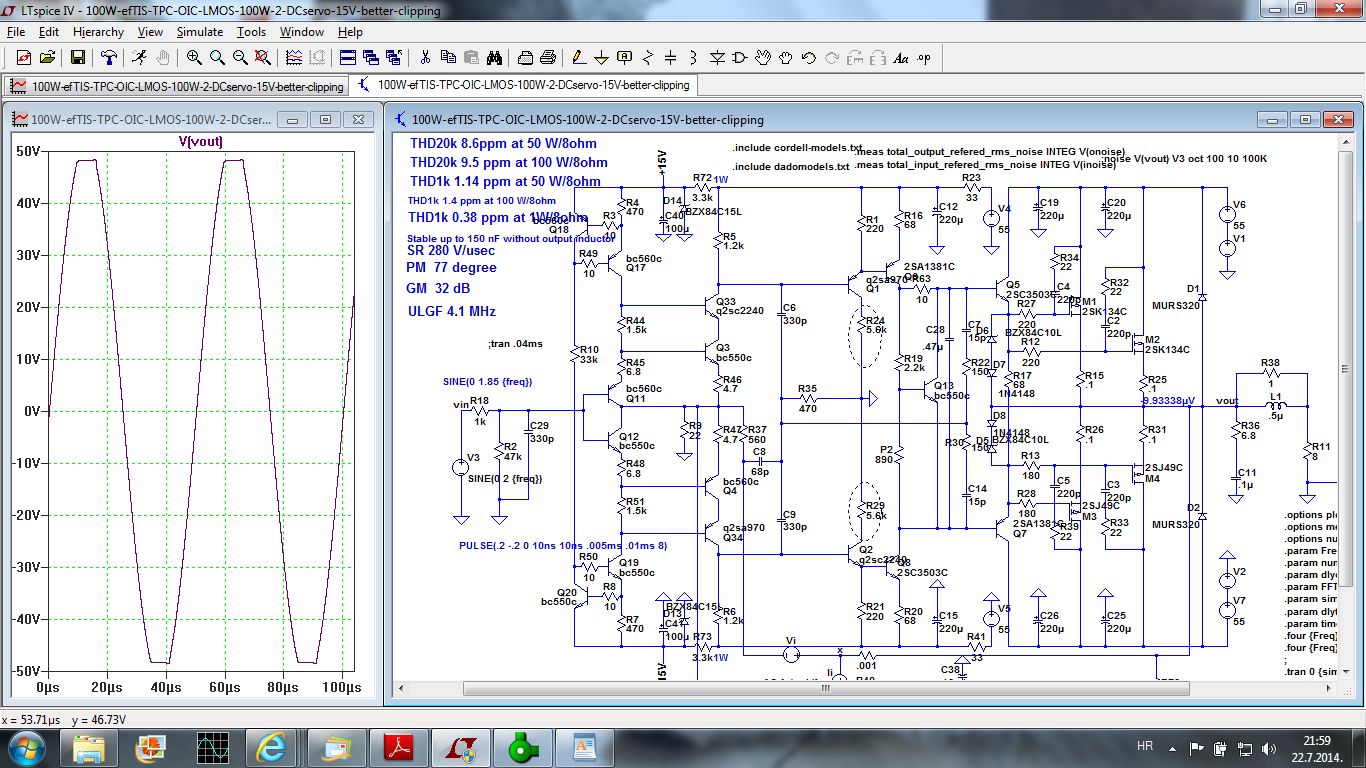

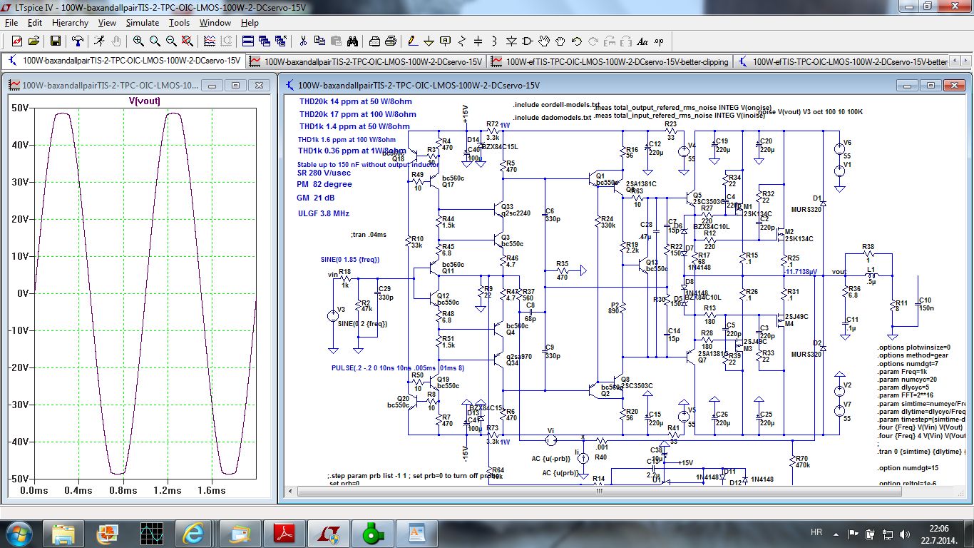

Still in the process to build low power version, decided to improve the clipping behavior.
I simulated two VAS types, EF enhanced, and Baxandall supper pair. Baxandall super pair produced a bit higher THD20k, but clipped very gracefully. To improve clipping of the EF enhaced VAS I increased EF transistor protecting resistors from 1k to 5k6 (R24, R29) and here is result. It shows that to get better clipping behavior that protection resistor should be of quite high value. This is valid for a single VAS in VFA amps, specially with TMC, or TPC.

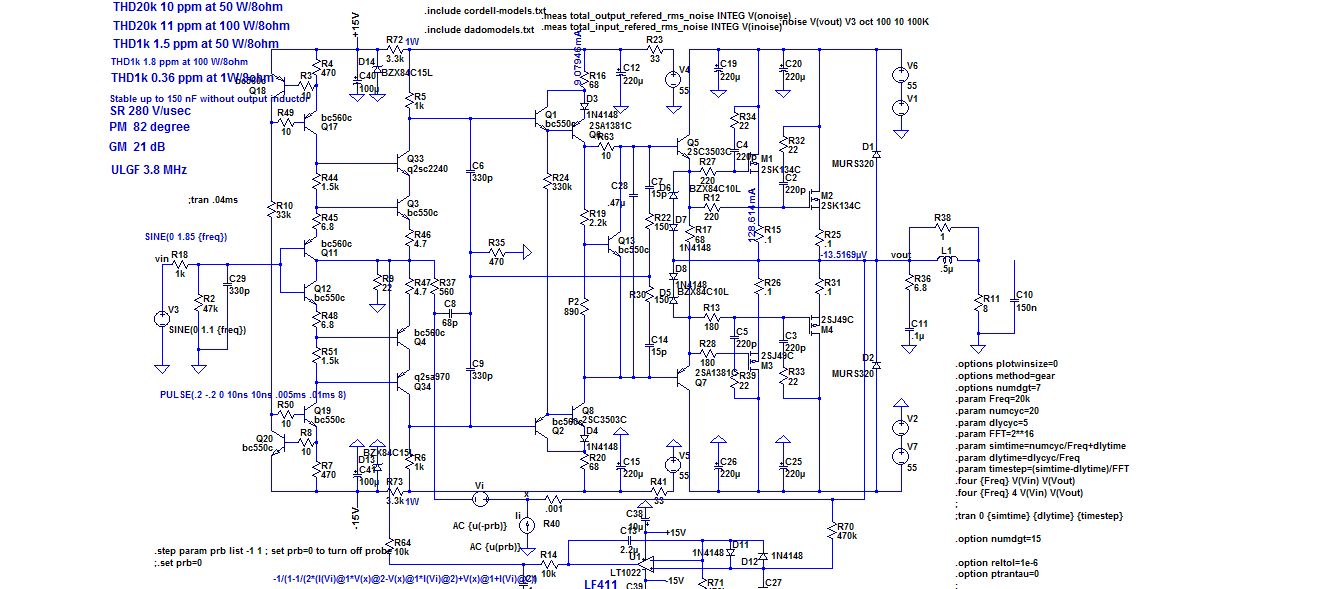

Hi David,
I manipulated the EF protection resistor for the same reason as you did, to reduce power dissipation for better thermal balance, but then it came to my mind that it could be used to better clipping behavior too. By the way in my opinion the way D. Self is using overcurrent protection transistor is not good enough without that EF protection resistor.
I simulated Baxandalls as you suggested and I've got lower distortion (needed to change some resistors value to keep the same bias), and a bit worsen clipping.
I use Cordell's output MOSFET models. I know they are not good enough but I don't have better ones.

... I simulated Baxandalls...lower distortion... and a bit worsen clip...
Yes, it does seem that the increased drop across the transistor improves the distortion and worsens the clip, both for Baxandall and EF enhanced.
Presumably the transistor can be pushed further into saturation, probably that is obvious once you think it out.
I will have a think.

A zener across the C-E of the EF can shunt the Cob and control the power dissipation of the EF at the same time. I saw the use in probably Toni's 2EF amp thread.
Joined 2011
That was a very good tip from wojtek5001. This replaced the VAS protection resistor starting with post #801. For the latest refinement see post #979
The VAS power transistor has been doubled to fulfill SOA requirements due to high VAS current. This variant performs very well and extrem overload simulations showed no SOA violations at all.
Using a bypass diode D4 (schematic from 2stageef post #979) also fixes a blameless VAS typical bad clipping behaviour.
BR, Toni

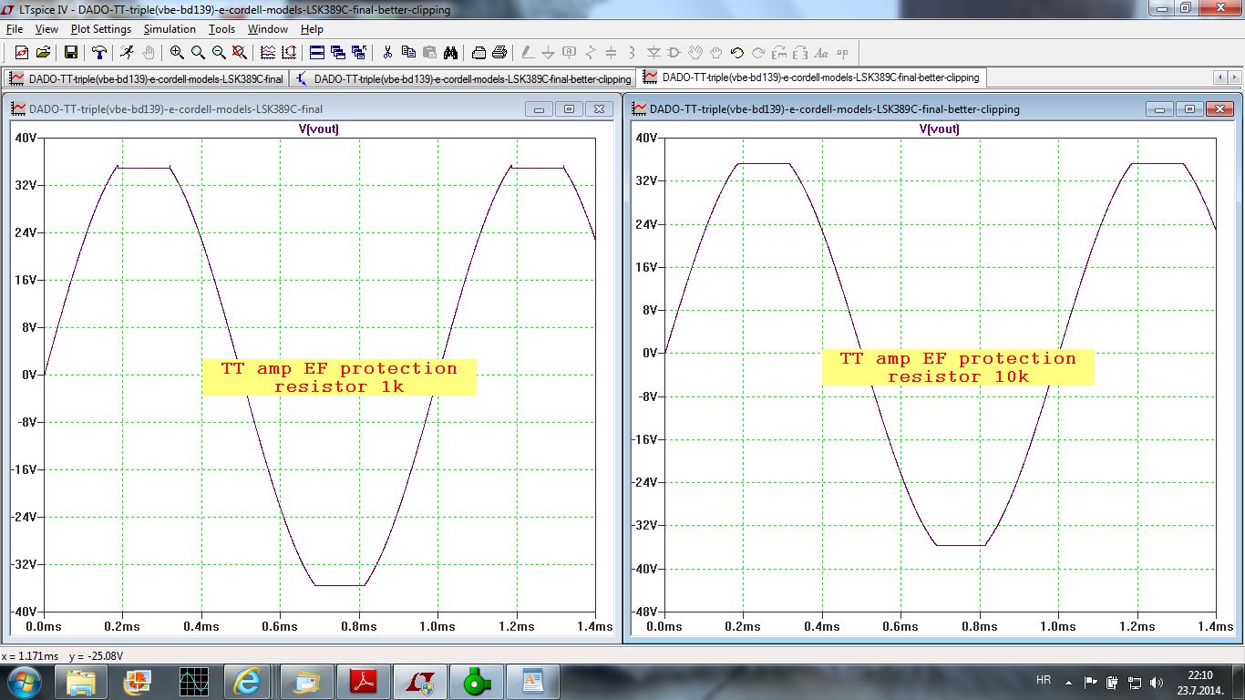

I don't think it's necessary to complicate to much, here is my VFA TT amp where EF protection resistor was increased from 1k to 10k with no increase in distortion and much better clipping behavior, 1k was enough to protect EF and VAS from overload.

AFAIK: simulation has problems to show a correct clipping behaviour as the sim models don't take bjt saturation into account. Testing my amplifier without diode in real life also showed a good clipping behaviour a 1k but not running 20kHz ...
