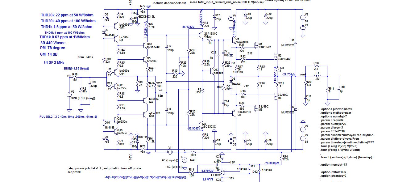

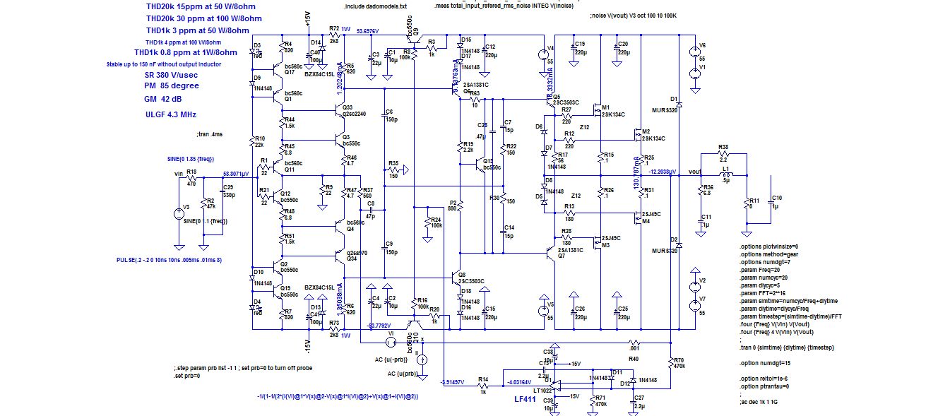

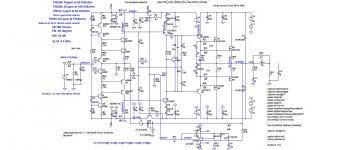

Novel DC servo
I would like to get some comments on this way to implement DC servo. It is connecting via +- capacitance multipliers and do two works in the same time, power filtering and DC servo.
What I know it was not used before.
Damir

Greetings Damir
Nice simple design.
How about trying EF triple but with mosfet outputs.

Hi Manso,
Long time no hear. What do you mean by EF triple but mosfet output? Do you mean bjt predrivers and drivers and mosfet output?
What do you think of may DC servo connection?

Unfortunealy business side is taking up a lot of my time, I prefer the engineering side but it doesnt pay the bills.
Thats it, will provide better THD figures.
Interesting, Id like to take a closer look, asc file pls.

Asc, here.
Hi damir, sorry I just have little time, very busy lately.
I have take a brief look at your DC servo.
your servo will have more than one pole, so there will be probably overshoot, do a transient analysis with the opinion "start dc external voltage at zero volts" and a long stop time like 60 seconds , and maximum time step of 1 second (I think this values will work ) . see the time it takes to the output reach a steady state. and please report back, I am curious.
I have test some DC servo similar to yours in the past with not so good success, unfortunately.
Ok, I have test your circuit, it took 3 minutes to settle to zero volts at output, but no overshoot, the circuit is to slow to be affected by audio signal ( that's a good thing ).
One thing that you may try to improve is the fact that for correct 120mV at amplifier output the servo opamp output was at 4volts.
now that I think about it... the DC servo similar to yours that I test was in a DAC current to voltage converter, the DAC have no capacitors at the output so a slow servo was not a good idea, but in a power amplifier it may work.
DC Servo --- Generally speaking, you do not want to create differential changes on the power supply -- or you need very high psrr if you do have DM conditions. A more sneeky affect is the altering of devices' C with supply changes....... something the models seem to be lacking in showing but will show up on real built circuits as increased distortion.
THx-RNMarsh
THx-RNMarsh
Thanks Sergio,
I am more concerned with 20 V pulse on the output at the power on, it must be the way I generate +- 15 V for the DC servo.

Difference changes provoked by the DC servo on the power supply are very small, only 76 mV in this particular case of simulation. I don't think that is possible to have less difference on real power supply between + and - voltage even without this DC servo.
BR Damir
Which one of the op amps are you using the LF411 or the LT1022?
LF411 is better suited to do DC servo job, but I don't have spice model for it and use LT1022 instead. An opamp with jfet input is good for DC servo.
