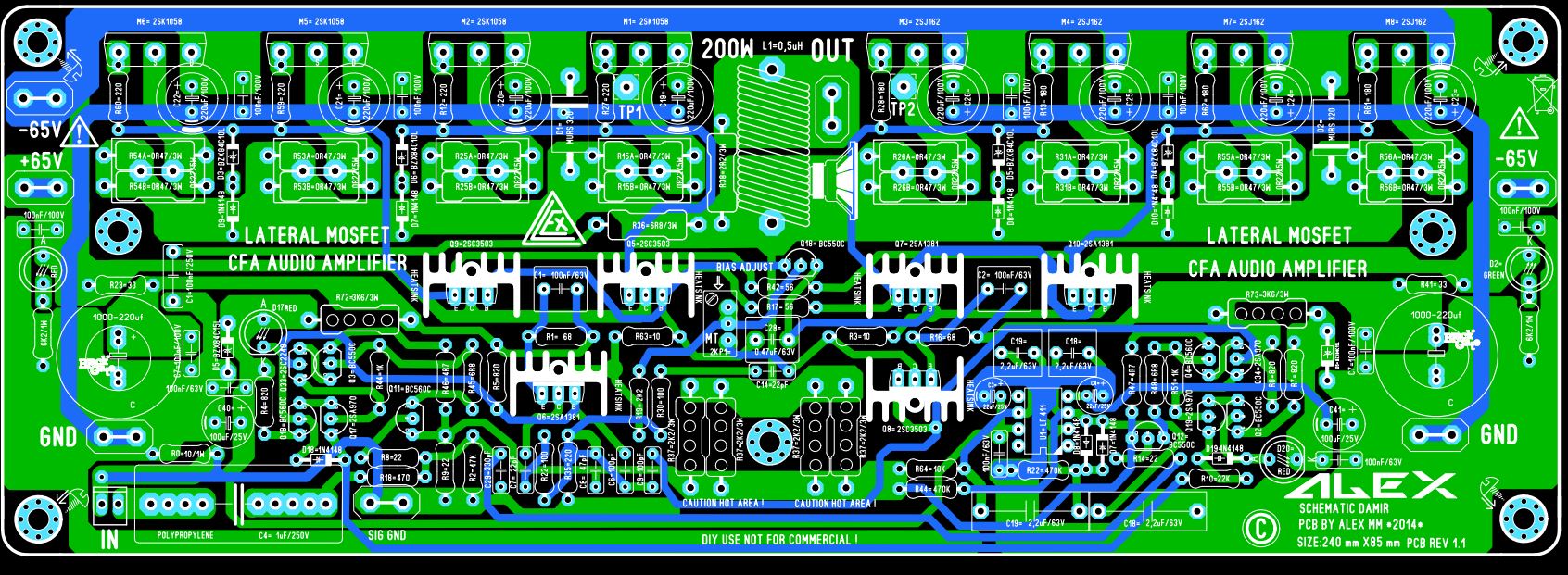

200W MOSFET CFA amp
I think that the C12 and C15 will have to be a little bigger, the 16mm dia. is a little small. I did not find any of that size on Ebay, maybe someone could suggest a source. I have 19mm caps of that spec. but they will fit only if I change the layout, which is very easy and doable there is room to do it.
Also R9 should be of 1W, make a space for bigger resistor.
... Attached is the zip file with two last presented 200W LMOSFET amp and if you find the time to play with it...

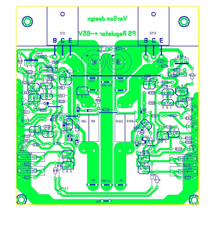

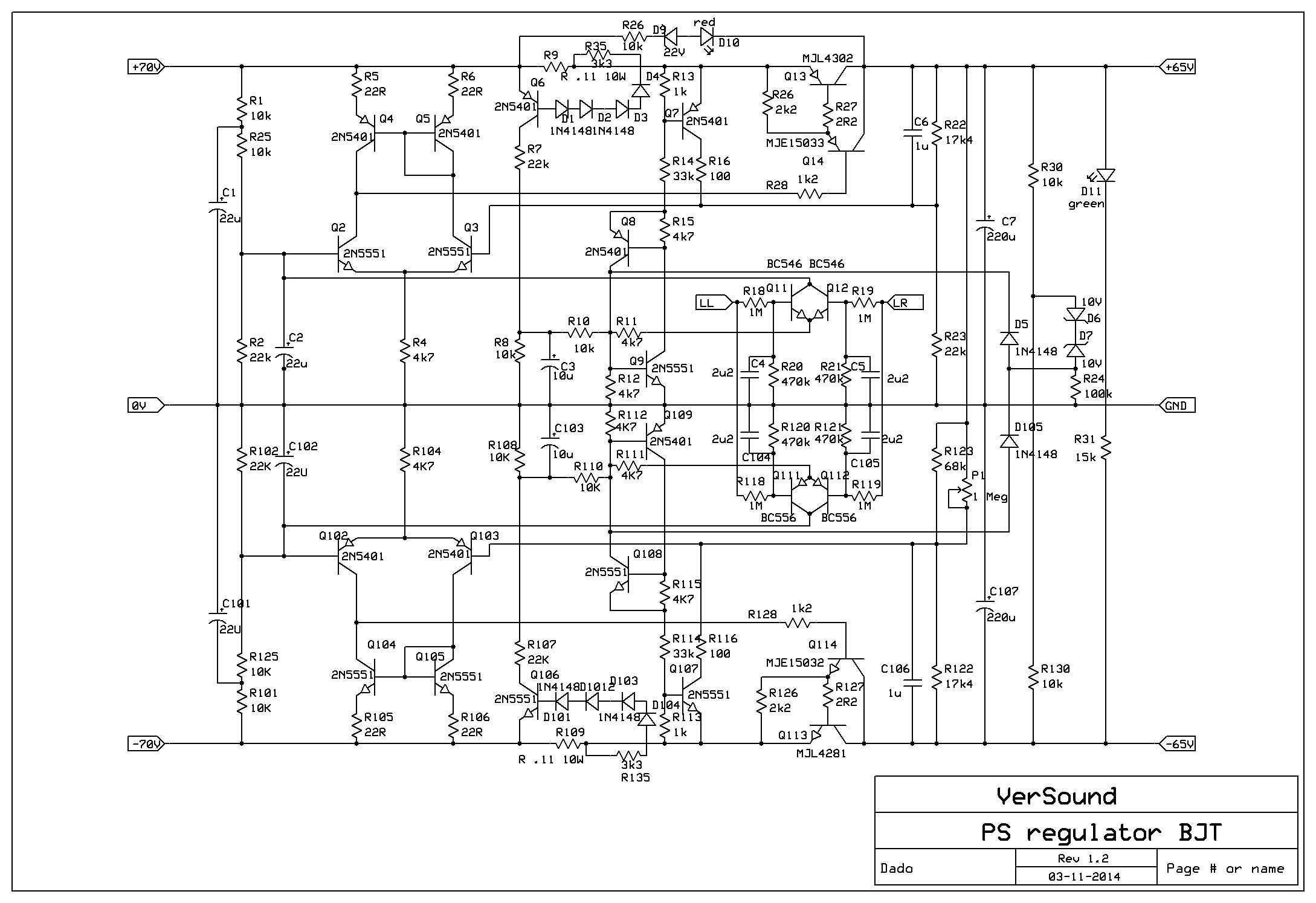

PS regulaor +-65 V schematic and the corresponding layout.
Damir

That you. 5200/1943 are the same as the MJLs shown in your schematic but with 150watt Pd. Yes the TIP transistors have a lower Ft than MJE1500x types, as well as lower gain, but does this matter in the regulator circuit? What is dissipation of the power transistors? Thanks again.
Oh sorry, I meant TIP type transistors, of course you can use 5200/1943.
You know they say an amp is good as its power supply, so I would stay out of TIP transistors, but you can try them. I use similar PS regulator, just with lower voltage, daily in my TT amp and I am very satisfied how it behaves and "sounds".
Damir, thanks for your quick response. I have a few more questions. You are so proficient in publishing circuits at a pace which most of us cannot keep with. So, which of your amps is the best sounding? Are there others out there which sound better and you are trying to match? Regarding the regulator, what is the maximum continuous current draw permissible and can it be used for a Class A amp with steady draw of 3.2Amps per rail? Minimum voltage drop and maximum dissipation? Thanks again.
Sam, I have built some of my amps not all. I still did not build any of my CFAs, this is quite expensive hobby, I am retired and how much I would like to build more amps specially some of those CFA types I can't afford it. I hope someone soon will build some of my CFAs.
The best sounding of my built amps is ThermalTrak amp with TMC. I have designed some simpler "blameless" types too with TMC and variations, but TT amp was may effort to use all, known to me, improvements in a VFA, and I enjoy its sound very much.
You can use this PS regulator for Class A amp, but it was design specially for Class B amps.
Beware that this is +-65 V version, I think way to high for an A class amp.
I will post the PDF file, just need more time to check the layout as in this one I changed some transistors for higher voltage type, from CBE to EBC.
If you want more information go here http://www.diyaudio.com/forums/powe...ply-cap-multiplier-electronic-protection.html where I tried to explain the function.
Damir

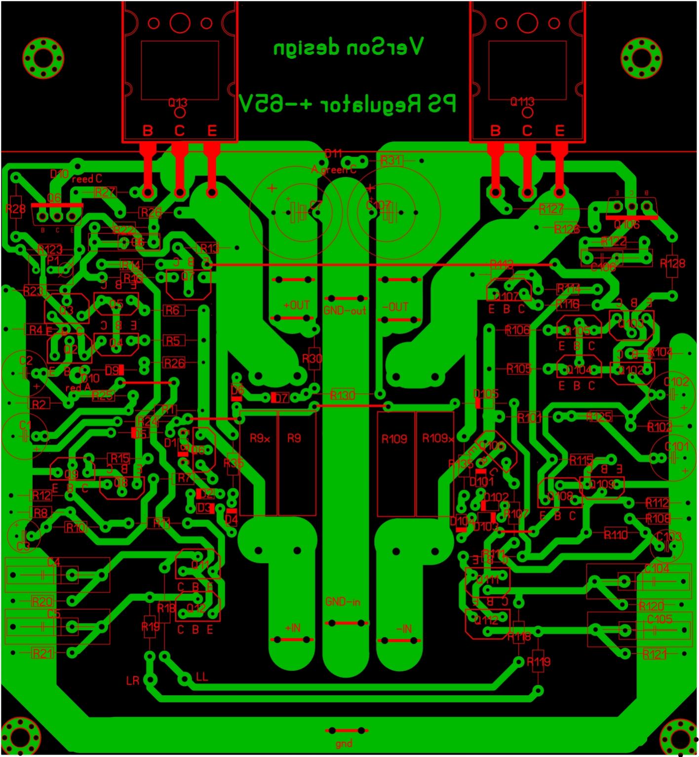

Here is PS regulator +-65V corrected layout, and iron PDFs.
Damir
Is there any interest in a SMALL group buy for this board? I have a quote for about $100 for 5 boards. I can get quotes for larger numbers of boards.
