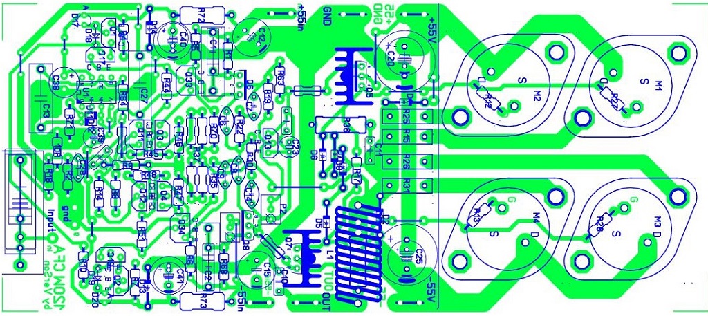

Don't forget to make a space for bigger R9 22R resistor, it should be min 1W or better 2W.
Just like this.. ALL DONE

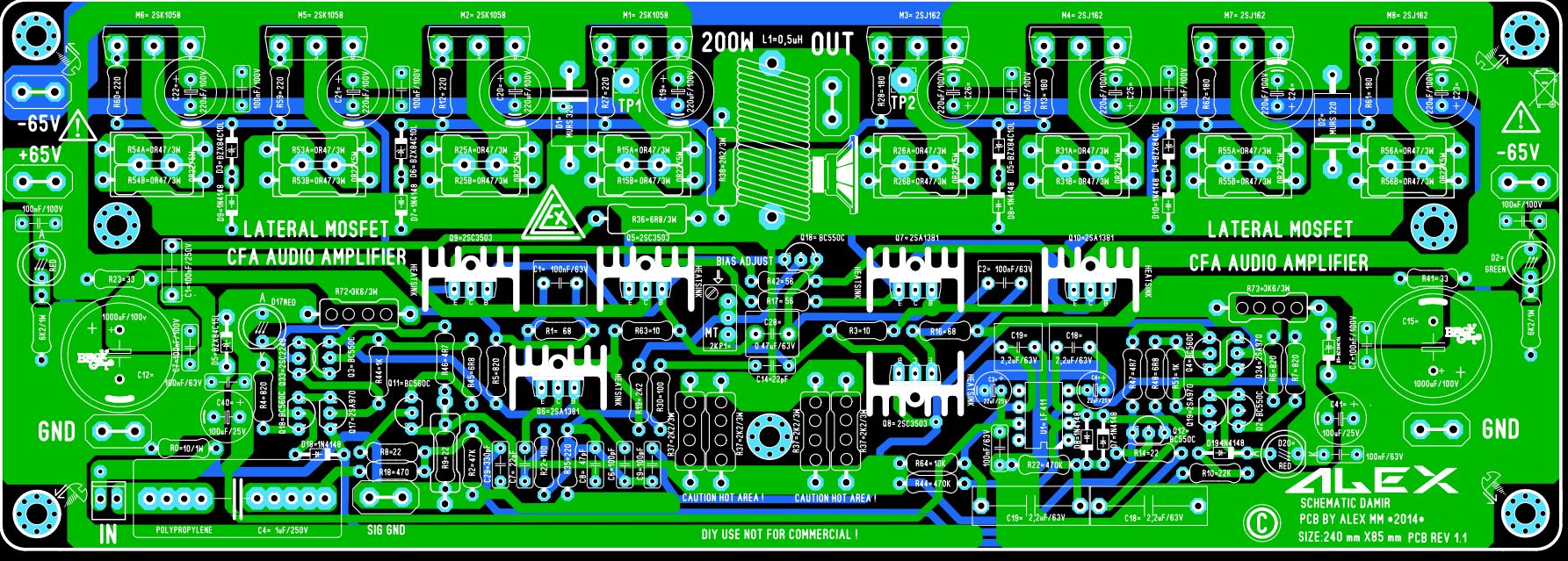

Is there any interest in a SMALL group buy for this board? I have a quote for about $100 for 5 boards. I can get quotes for larger numbers of boards.
Interested
Greetings gabor
Interestedbut wee need more people $20 per PC board plus shipping from US a bit pricy.
Greetings gabor
That is why I posted this. I agree... Now where is my richer Uncle
That sound great, way better than 5PC. Hope more people will join.
Maybe if you start a tread at Group buy, of course at first ask for the designer blessing on that.
Greetings
Damir is all in before I posted this, and would be happy with anything reasonable. So would I.
I think shooting for 25 dollars a pair including ship in the USA is a doable deal.
Time and people will tell.
By the way this is double sided 2 oz. and fully masked. Anyone know of a cheaper source of 240 X85 mm boards please tell me. Open to all input.
$93 at ITEAD Studio 2Layer PCB Larger than 20cm x 20cm for 5 boards + 2 free extras if you say it's open source.

Chris, as this amp was not built yet, could be very useful to have a prototype built first.
I am quite confident that the amp will work as in simulation, but better to start with small quantity first. What do you think about? I would like to build it myself first, but to buy all necessary parts I can't afford in reasonably short time.
Damir
I agree this is the right way,a working prototype is absolutely necessary.Chris, as this amp was not built yet, could be very useful to have a prototype built first.
Damir
I decided to build 120W CFA lateral MOSFET version. I will use the box and power supply from my JLH 80W MOSFET amp, and of course, lateral MOSFETs.
As this is 120W version of 200W amp, if everything vent OK, the 200W version PCB can be ordered with no fear of its function.
I ordered set of the PCB from local producer. I prefer do it here in Zagreb as I can control the process and it is not to expensive.
Damir
Damir

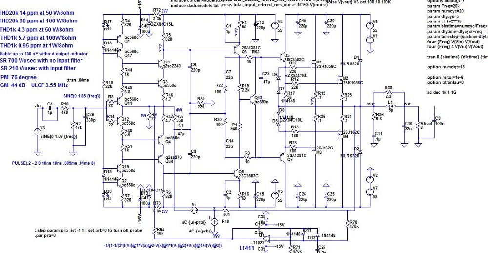

What about the version with EF VAS from post 426, why don't you Use that, it gives very low distortion?
Do you also make a PCB for mosfet in "normal packages" i Think 120W@8 ohm version, 2 pair OPS with bipolar driver??
You are right about EF VAS, THD20k is 7 to 10 dB lover, but harmonic distribution is not so good. Small improvement at 1kHz, and SR is going down, GM is lower.
I will try it after some real tests of simple VAS.
A lot of people here think that distortion is not so important if low enough, and I am going to try the simplest VAS first.
I you meant by normal package, a plastic package, yes I will make a layout for that too, but as I have lateral mosfets in TO3 package I did that first.
What is pssr for this version post 616?
Don't you use cap multiplier any more?
Thanks Again![]()
As this amp is going to use JLH 80W mosfet amp stabilized PS regulator with separate regulation for the OPS and separate for IPS I don't need a cap multiplier here.
After I finish and test this amp I am going to make a layout for this amp but with TO 3P laterals and a cup multiplier will be included between OPS and IPS.
