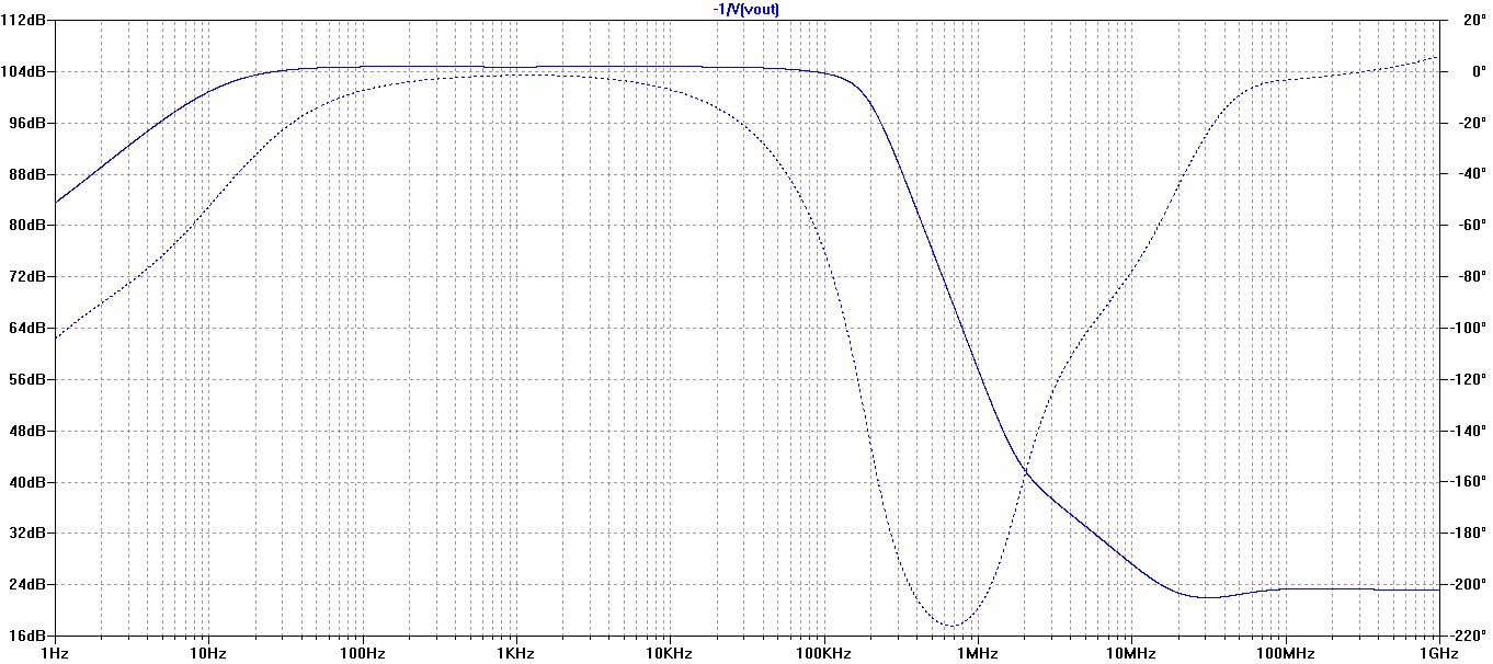

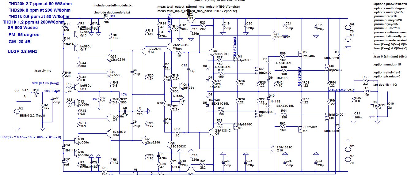

In meantime wile I am waiting for PCB for 120W CFA with lateral MOSFET here is 200W vertical MOSFET CFA.
Quite low distortion, excellent Phase Margin and Gain Margin, Slew Rate 500V/usec, quite simple schematic, what to say more. To good to be true? I hope not and for sure I have to build that one. This OPS is not so expensive as the one with laterals, and does not use DC servo, just trimmer pot instead of fixed VAS emitter resistor.
RC over the VAS resistors decrease distortion (increase the loop gain) at high frequencies.
Damir

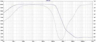

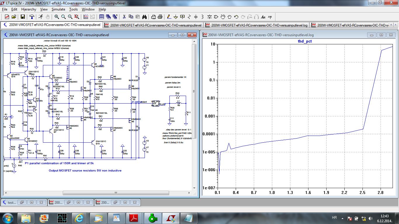

This is my attempt to plot distortion versus output voltage at 1 kHz.
If I look to .four log printout, thd_pct calculation deviate from it a bit and I am not sure way, but anyhow it is here. X axes values shown are the input voltage and if multiplied by gain of 25 it is output voltage.
Damir

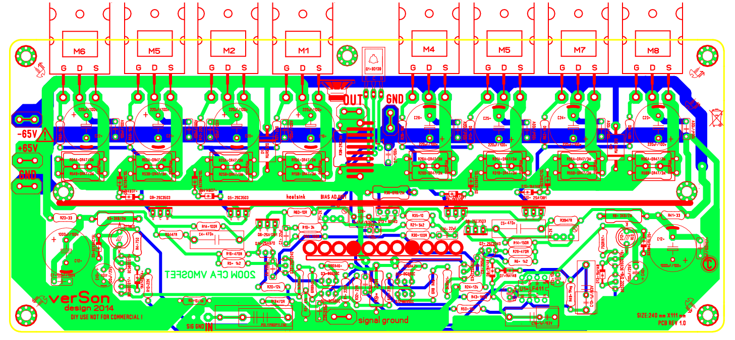

200W CFA VMOSFET
This is the version I am going to build. I have ordered all needed components and now waiting for delivery.
Here is preliminary layout, when all components arrive I will check that all fit, correct what is needed and then order the PCB production.
Damir
Damir
Hi Damir ,very good ,real artwork ,great layout but reverse polarity of all 4 capacitors from drain to pover ground ......also empty space left side .......
Cheers ,Alex
Thanks Alex, I knew I can't make a layout with no faults. I will check and recheck before go to production. Empty space, maybe I can put some spare transistors over there.
Cheers
Damir

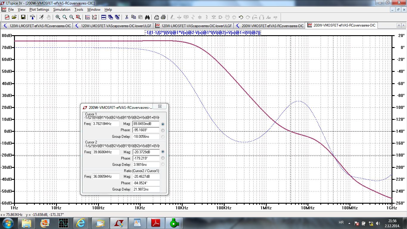

Hi dadod, just for curiosity - why did you change design - Slewrate Fall to 250 instead of
500v/us?

I did not change design, this Slew rate is with input filter connected, internal Slew rate is the same.

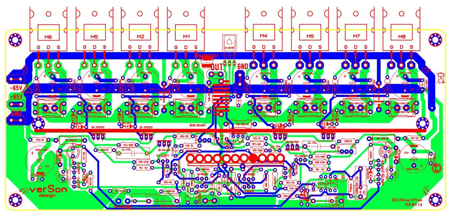

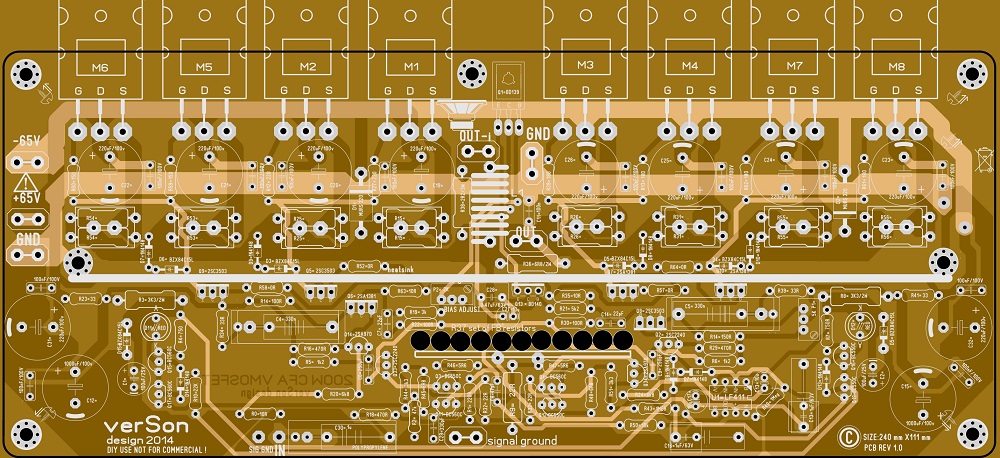

200W CFA VMOSFET
This is the layout of the PCB I am going to order prototype board tomorrow. I have all semiconductors, all elcos, most of resistors and film caps, waiting for some orders to arrive.

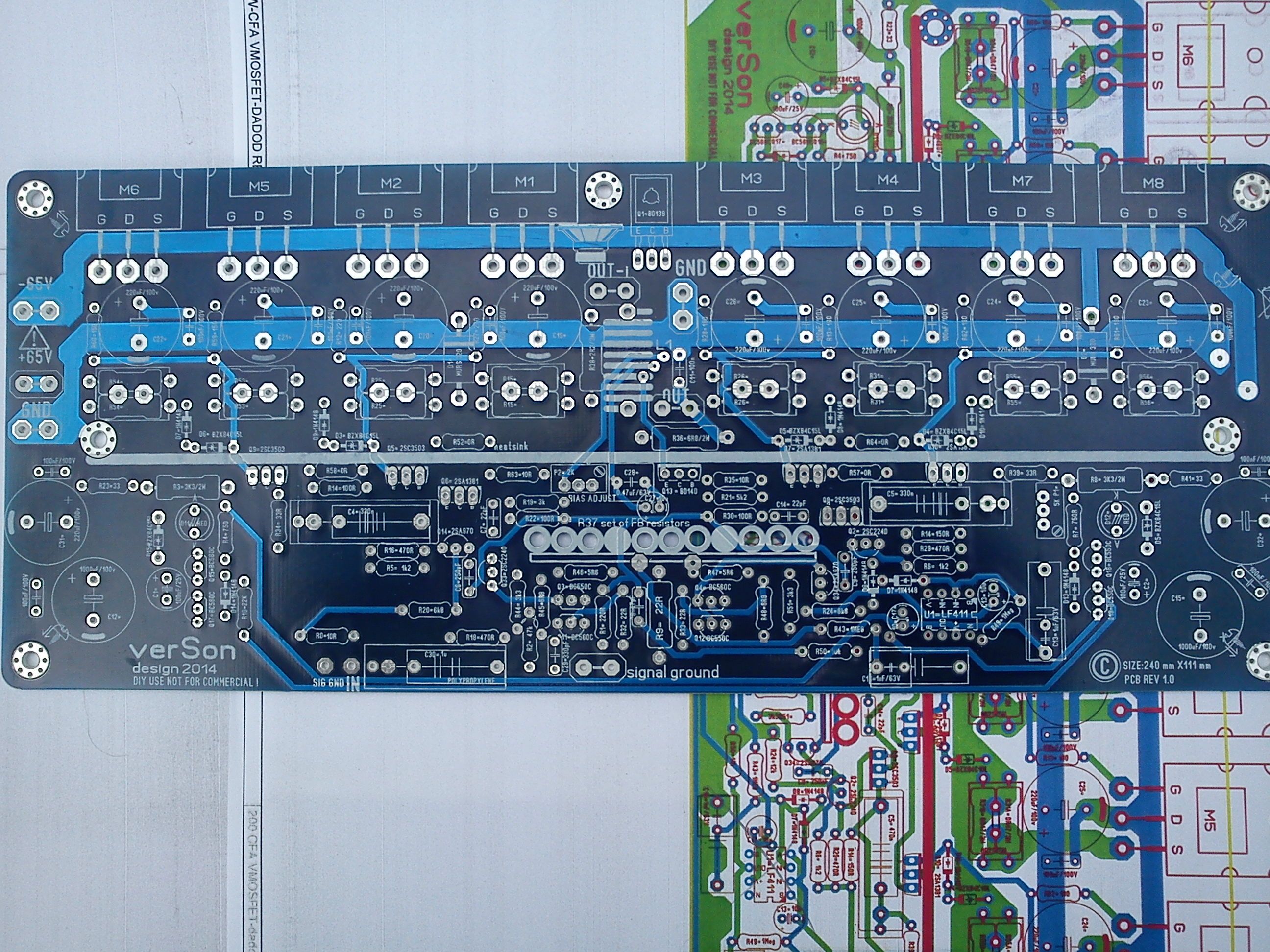

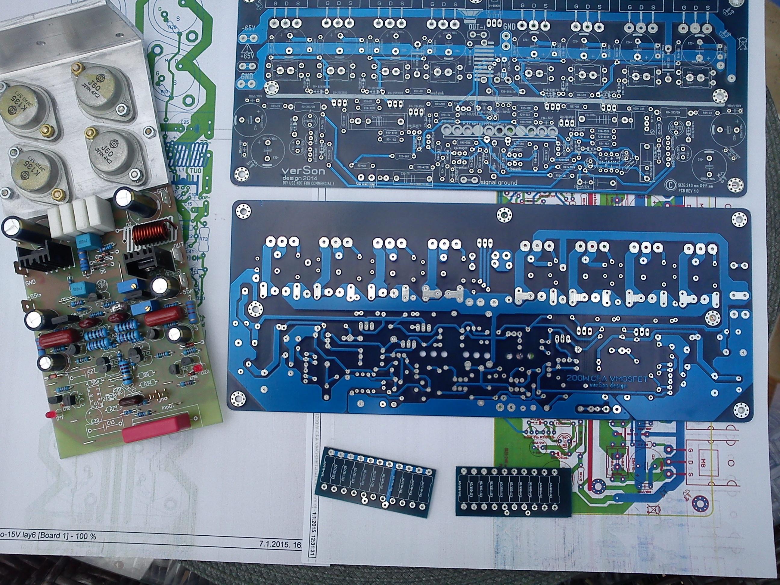

It looks that Christmas and New Year slowed the components delivery as I am still waiting for some to arrive.
Today the PCB for 200W VMOSFET amp is finished and here are the photos and the photos of 120W LMOFET soon to be tested.
Damir
