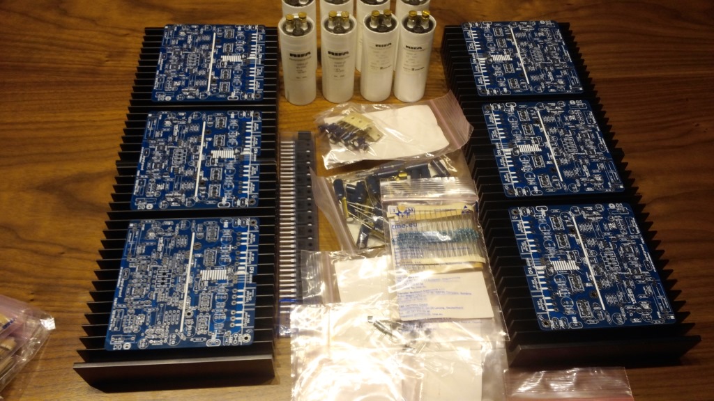

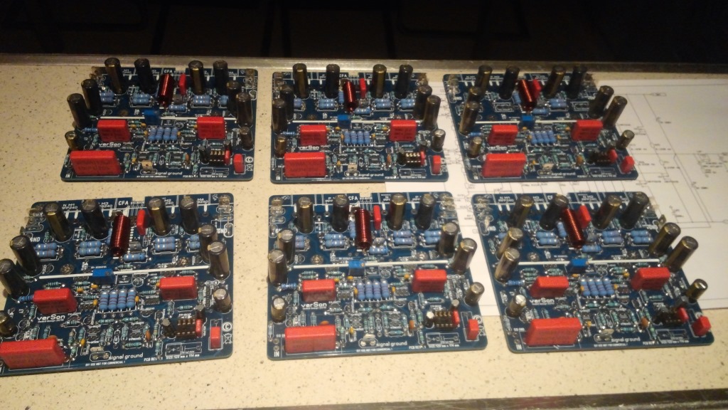

Hi Damir
6 channels before and after assembling.
//Mario

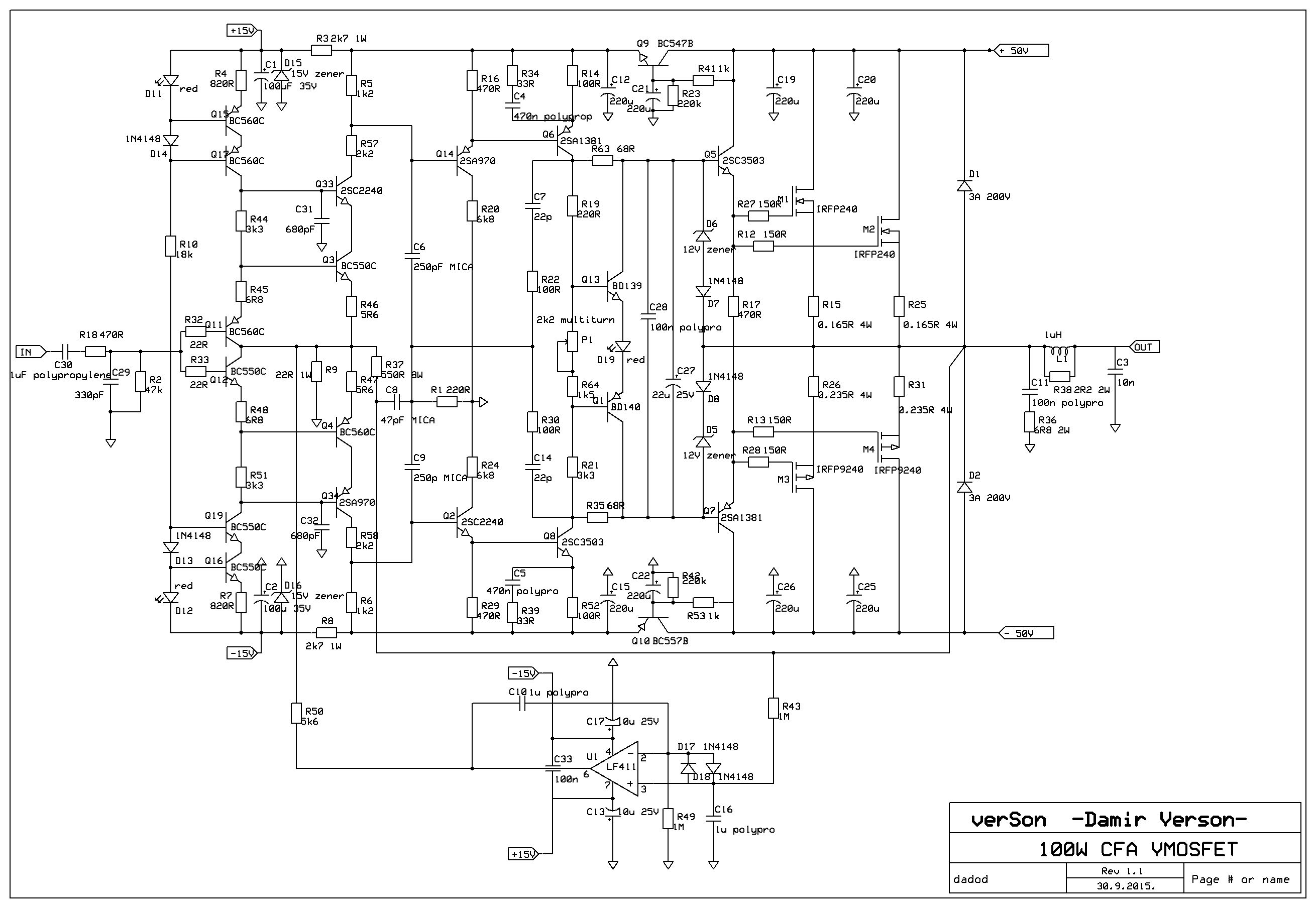

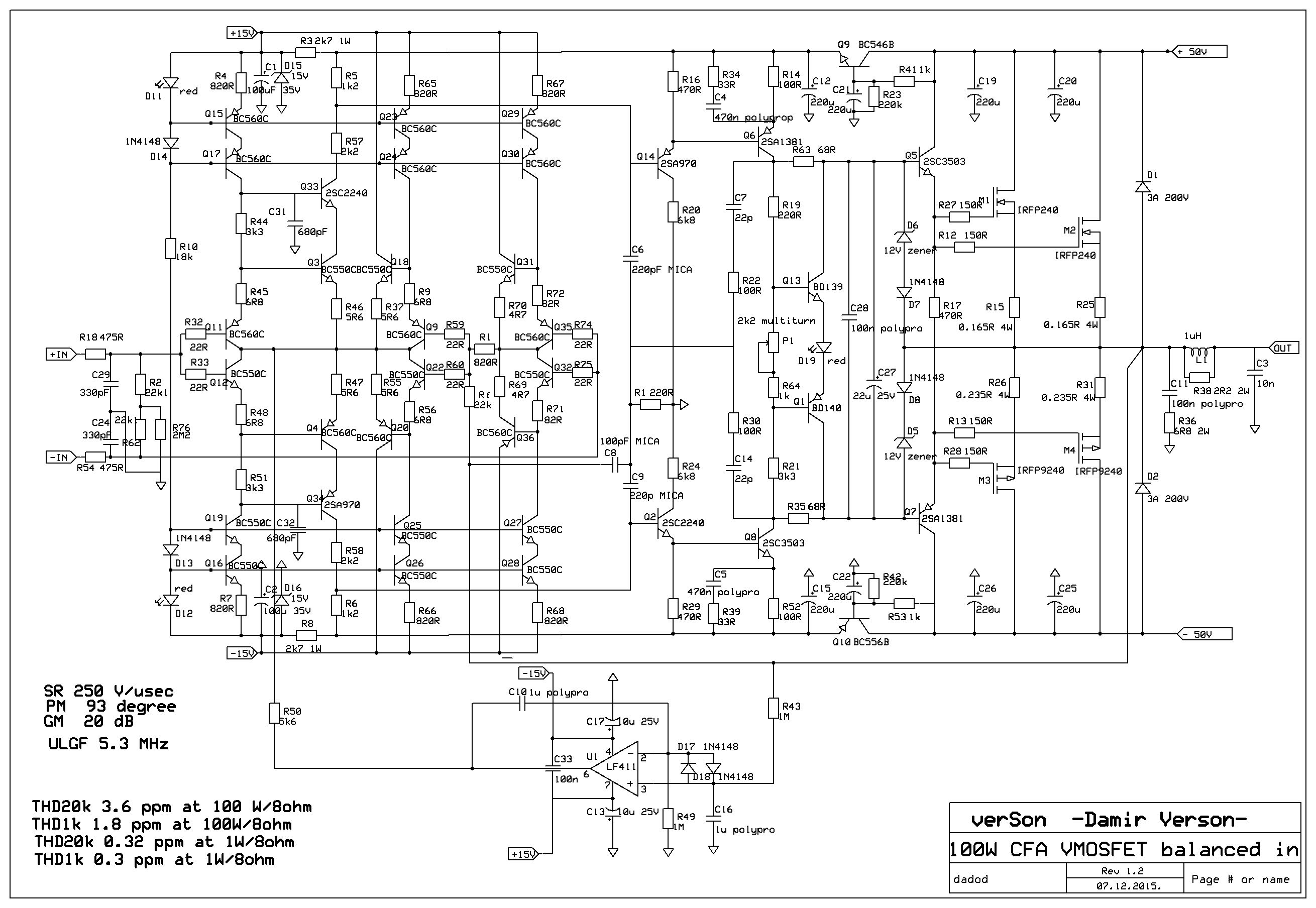

I have found one error in the schematic and the same in the BOM. For the capacitance multipliers (Q9 and Q10) BC546/556 is not good enough, to low Vce. It should be BC546B/BC556B instead.

lovely dadod . can it support a 2ohms load /speaker??
I did not try it to drive 2 ohm load in real life, but simulation shows this will be to much for two output pairs only. This really difficult question, some loudspeakers can dip as low as 2 ohm, but I don't have anything similar to try. This amplifier uses (in my case) PS regulator with overcurrent protection and, probably, will trip it if drove to hard on such load.
A 4ohms capable amplifier must be able to drive a 2r0 resistive test/dummy load.
In my view a 4ohms capable amplifier should be able to drive a lower than 2r0 test load to significant voltage to prove it is not current crippled.
This is not so. This is an amp capable to drive 8 ohm to a bit more than 100 W, and almost double power on 4 ohm, and in some extend 3 ohm.
Your logic is a bit twisted. Let say, this amp can drive 8 ohm and able 4 ohm too. Because it can drive 4 ohm it should be able to drive 2 ohm, and as it is able to drive 2 ohm it should be able to drive 1 ohm, and so on.
What you mean, not current crippled?? This amp has an electronic fuse and thus it is current limited. It is not welding machine.
