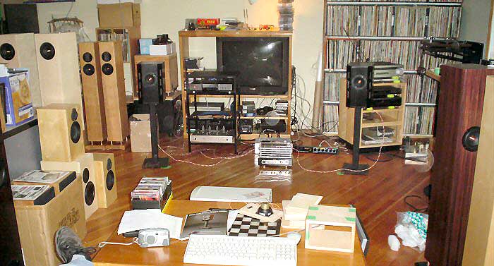

So thank's again to Dave and Ruth for putting us up ( or is that putting up with us?) and feeding the crew while we got to listen our hearts out. I only wish they could have done something about the rain overnight. Interupted an otherwise beautiful night's sleep.
Back to speakers, I've never heard so many different systems using the same driver in my life. We already knew it was a winner but this showed us how versitle that little thing is.

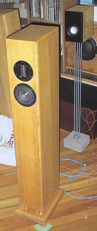

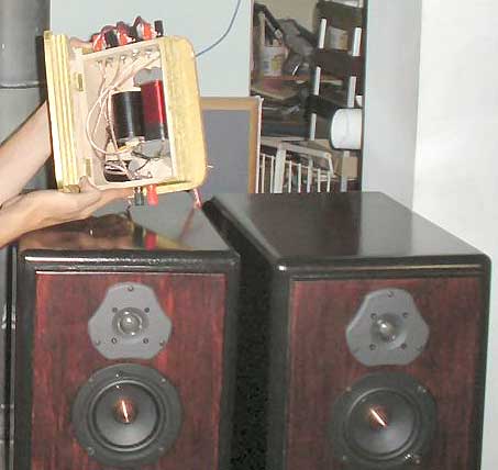

extremis 3-way. This 7" driver can produce bass. Too much IMHO (working in the kitchen, some of the waves were making me somewhat nauseous -- and we had no amps with more than 35 watts. I'm thinking a pair in a 50 litre sealed box would be just about right.

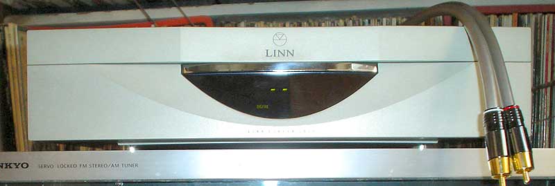

How did my DAC do? Well it didn't get much air time but I was told it sounded good jitter and tone wise but the sound stage was flat and I have to agree. I don't feel so bad because there was also a $20,000+ Linn CD player that got even less air time because the Jolida was so good. The Linn was on loan from a local shop, the fact that no one owns it says a lot.

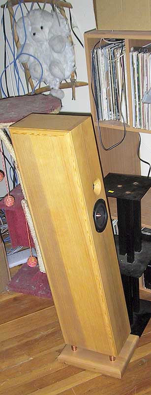

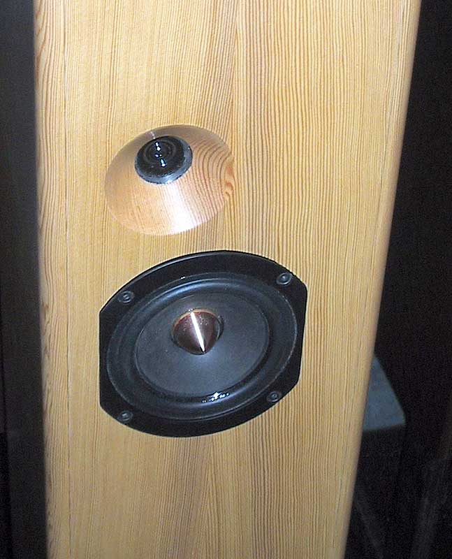

And a set of WR125 bipoles where Scott took my original design (itself based on the Tim Forman TMM) and worked it. They use a waveguide loaded ApexJr tweeter. When 1st played they has 2.2 uF, but that was too low, a switch to 1.7 uF really brought them into focus. The romboid side profile worked out really well and the cosmetic detail with the ST bezel and the solid wood "horn" is stunning. The ApexJr tweeter was an experiment to see how much was really needed up top on the WRs & it turned out REALLY well IMHO. The tweeter adds almost nothing to the cost of the parts (the XO cap is more expensive than the tweeter), so someone who wants a less expensive system than with FR125s, this works.

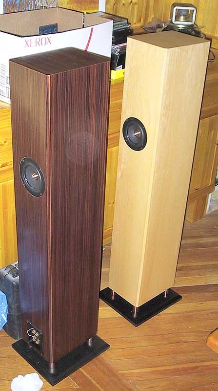

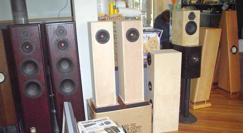

One of the things we did for this event was to build up 2 pair of bipole ML-TLs based on the FR125 (front) & Wr125 (back) in cabinets that are identical except that one is plywood & one is MDF. There is a very clear difference between the 2 -- interpretations of the difference between the 2 depends on who you talk to. I have a clear interpretation, but will save that until others have weighed in (everyone who has a comment on the plywood/MDF please chime in) so that i do nor influence any comments -- i think we will find that in the end choice of material will depend on your personal preferences (Scott thinks solid wood works best -- and his boxes were no slouches (and incrediably pretty).
We tried to keep it secret as to which was which (and i even heard comments that attributed the wrong material to the wrong box -- i assume based on preconceptions of what each should sound like -- but by the end of the shoot-out people knew (one heft of each box was enuff to give it away).
BTW the dark ones are ply, the light MDF.
