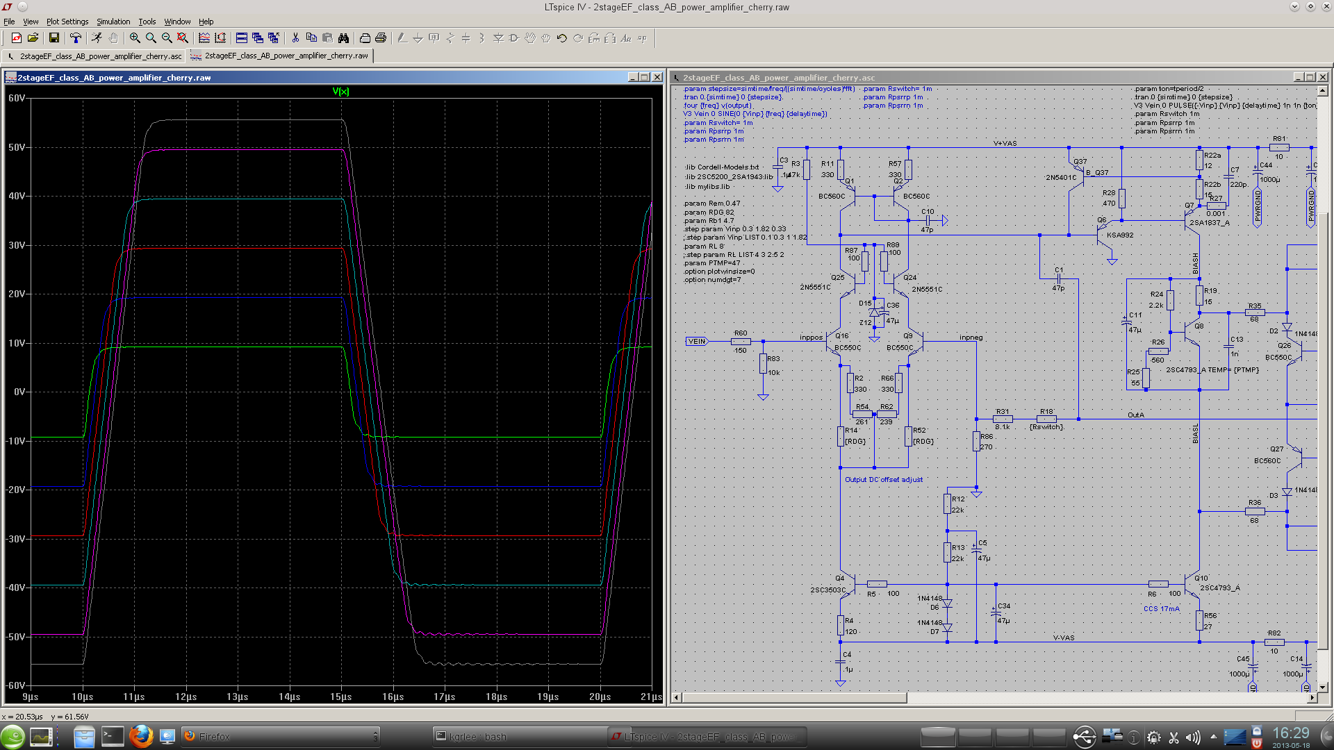

simulation shows some instability running square wave signal tests - see attached picture.

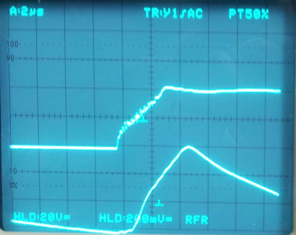

Have tested these values also in real world. First it looked good on doing sinus tests. Have seen some oscillation during tests and tried afterwards square wave signal test.
On increasing the 10kHz square wave signal the amplifier starts to oscillate on rising edge (see attached picture 2).
Maybe you have an idea ...
BR, Toni

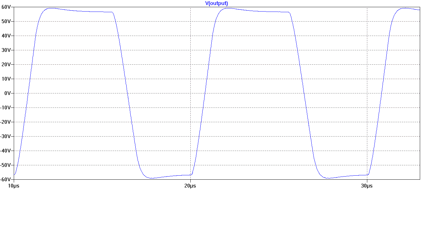

Toni, I've modified my model to try & match the one you show in post #233. I'm not sure about the relevance of full power 100kHz square waves but I get a different shape from what you show.
I'd like to get my model to match yours before doing any more serious work on this.
I've included my .ASC file. Can you post the one you used in #233?
Maybe you have rise/fall time set to zero which smoothes your square wave. LTSpice seems to not accept zero here and replaces rise time by a programming default. I always set rise/fall time to 1n and 10n to see what happens.
V3 Vein 0 PULSE({-Vinp} {Vinp} {delaytime} 1n 1n {ton} {tperiod} {cycles})
Attached my asc file.
BR, Toni
