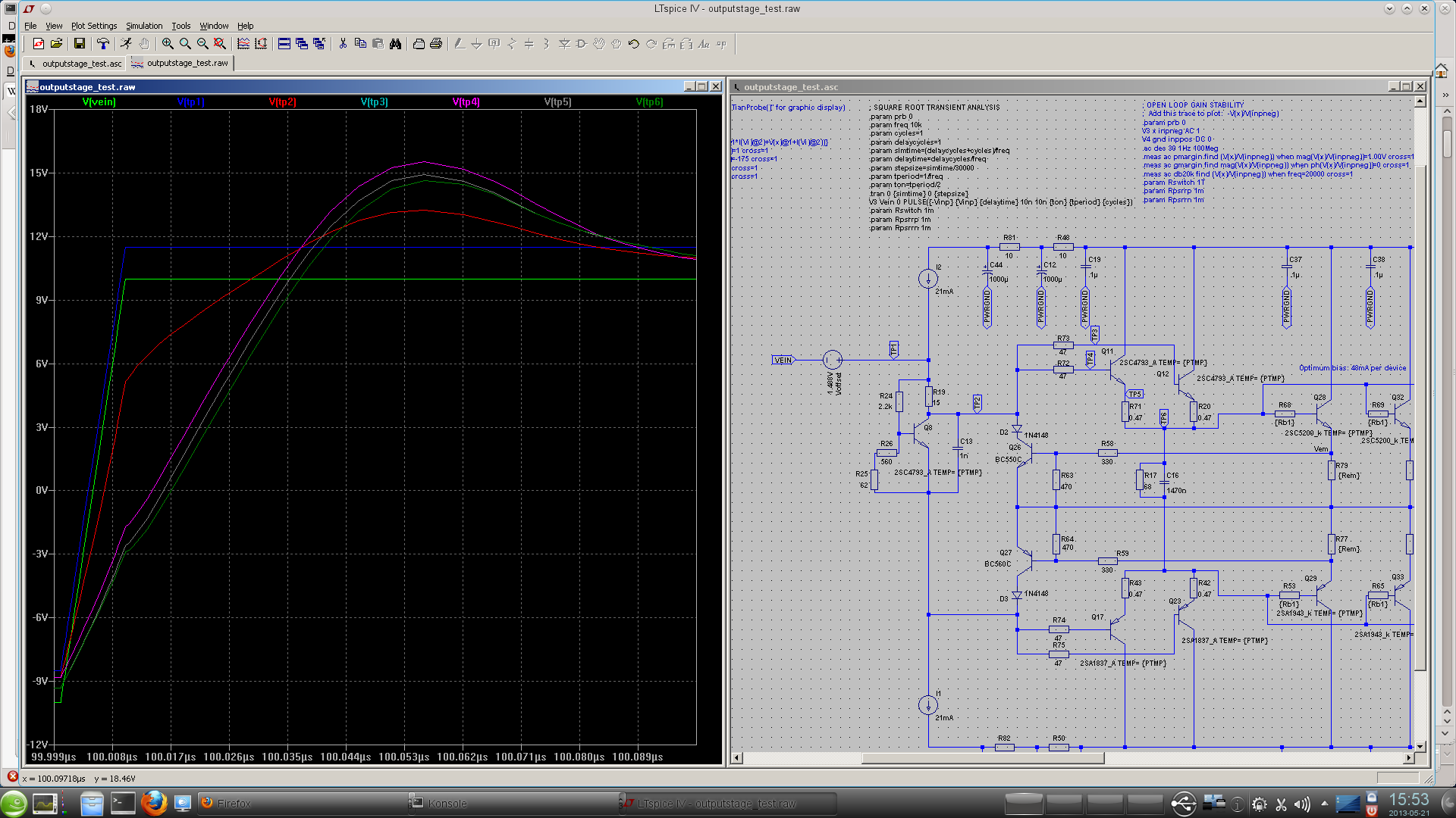

Simulation of output stage with square wave shows a small peak after start of rising edge. This peak may cause beginning of ringing due to output capacitance (= input capacitance of power bjt's)

The 1R (now .47R) driver degeneration acts like a base stopper for the outputs. Combined base stopper impedance for 8 pairs with 4.7R stoppers is .59R, so with a combined driver degeneration of .5R you've doubled this. So changing to .47R decreases the base stopper phase shift significantly. The Re of the drivers at 4mA each is about 1.9R though, which would seem to swamp all of this. Maybe you should increase driver bias? Also, are the resistors used inductive?
I see two possibilities, barring inductive resistors. One is that the base stoppers add phase shift that is not agreeable to the compensation scheme. Some amps complain and others don't. The other possibility is that the resonance is caused by local parasitics and the driver degeneration plays a significant part in this.
Why don't you examine square response in LTSpice? I am currently having problems with high slewrate behavior myself. For instance, on a pulse the driver stage will go into class AB with one driver turning off, and this changes AC behavior completely during the pulse. With 8 pairs of outputs, your drivers are VERY stressed at RF. Have you tried increasing driver bias? I thought it was quite low. Also, the VAS may be turning off at negative pulses and pushing many mA on positive pulses. Both these extremes alter AC behavior dramatically.
You may try ferrite beads instead of stoppers. FB73 ferrites seem (from my limited knowledge) to be a good suggestion; LTSpice has a ferrite component. Consider that base stoppers act like output degeneration of Rstopper/Hfe.

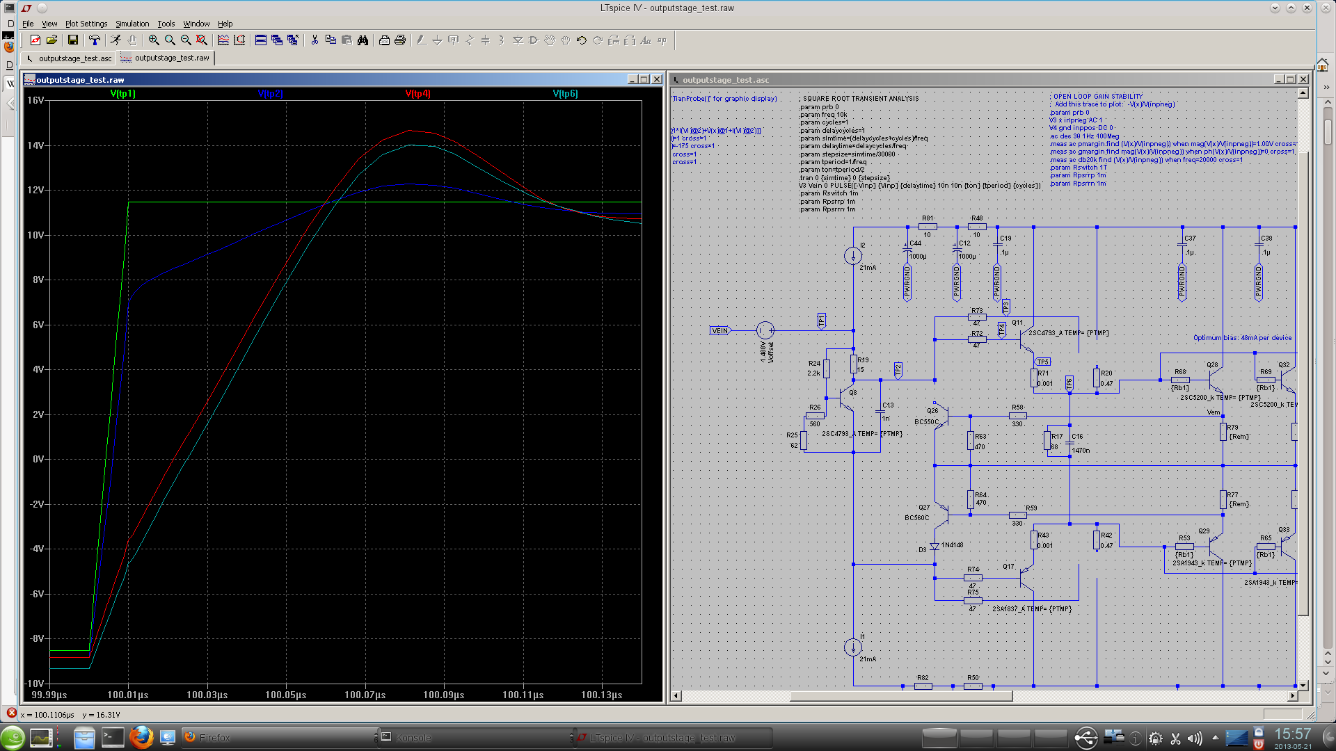

Dear keantoken,
THX. Very good hints for further tests.
Btw doubled the driver bias on reducing R17 from 68R to 33R. Ringing betters significantly! Have to check driver SOA again, but think we are save here.
Btw. all resistors are low inductive metal film 1%.

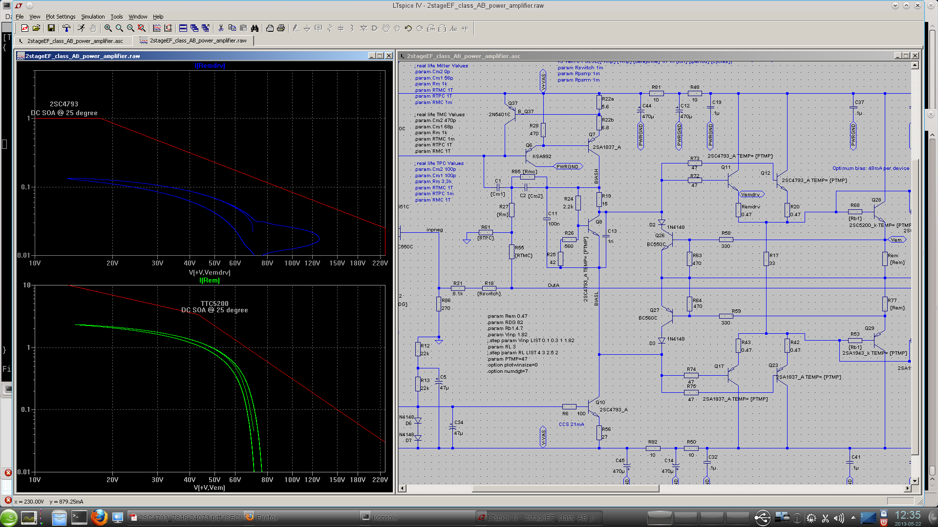

Due to reduction of R17 and higher bias the simulation shows better THD without C16. After rechecking the driver SOA I will remove C16. Maybe this helps.

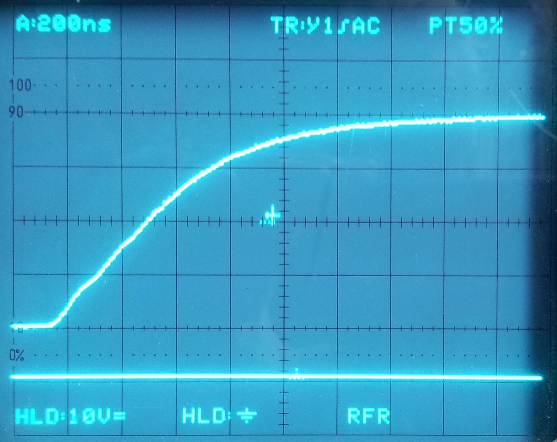

Rising edges still have some ringing. ... back to the roots ...
Using my old development sample I decided to change base resistors of output stages ({Rb1}) from 4.7R to (empirically determined) 18R. Simulation shows a small increase of THD20k of about 0.2 ppm.
But:

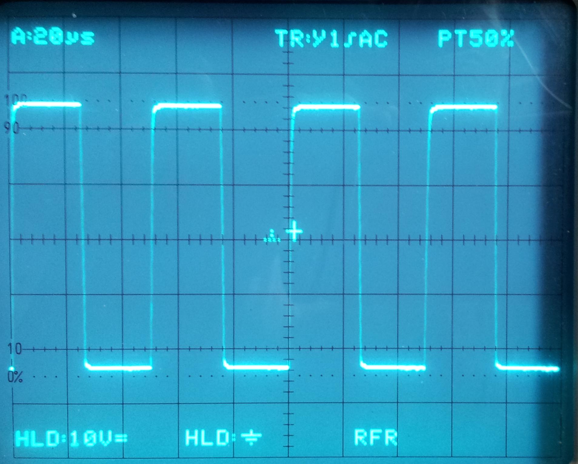

Made new square wave tests - see attached pictures. Significant better. Without load there is now a very clean rising edge and 8R load shows a small but good damped ringing. Also attached a picture of a 20kHz square wave 25V peak2peak@8R. No overshoot, no ringing.
Best performance can be achieved with TMC 68p/470p/1k to 82p/470p/1k.
