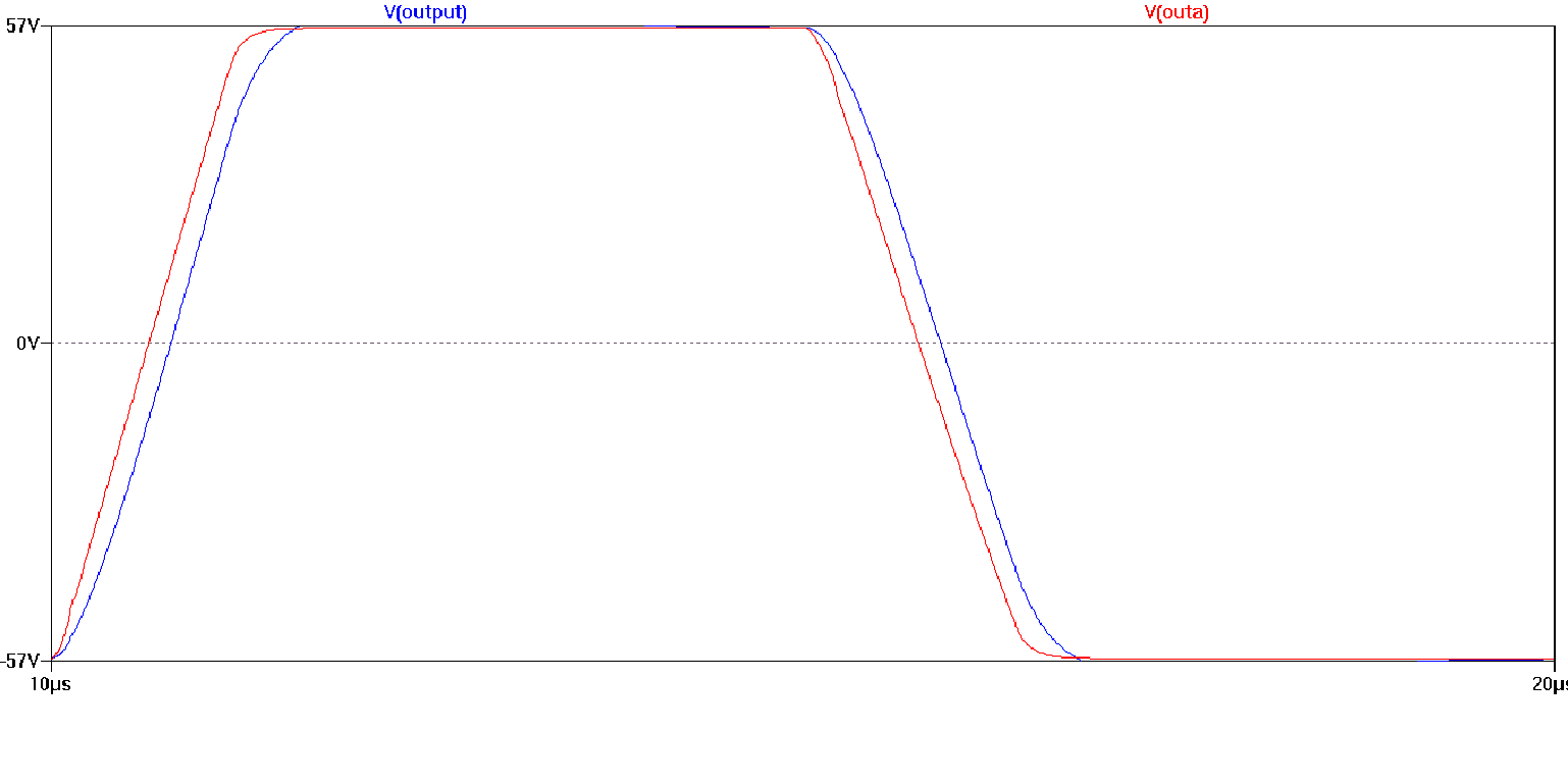

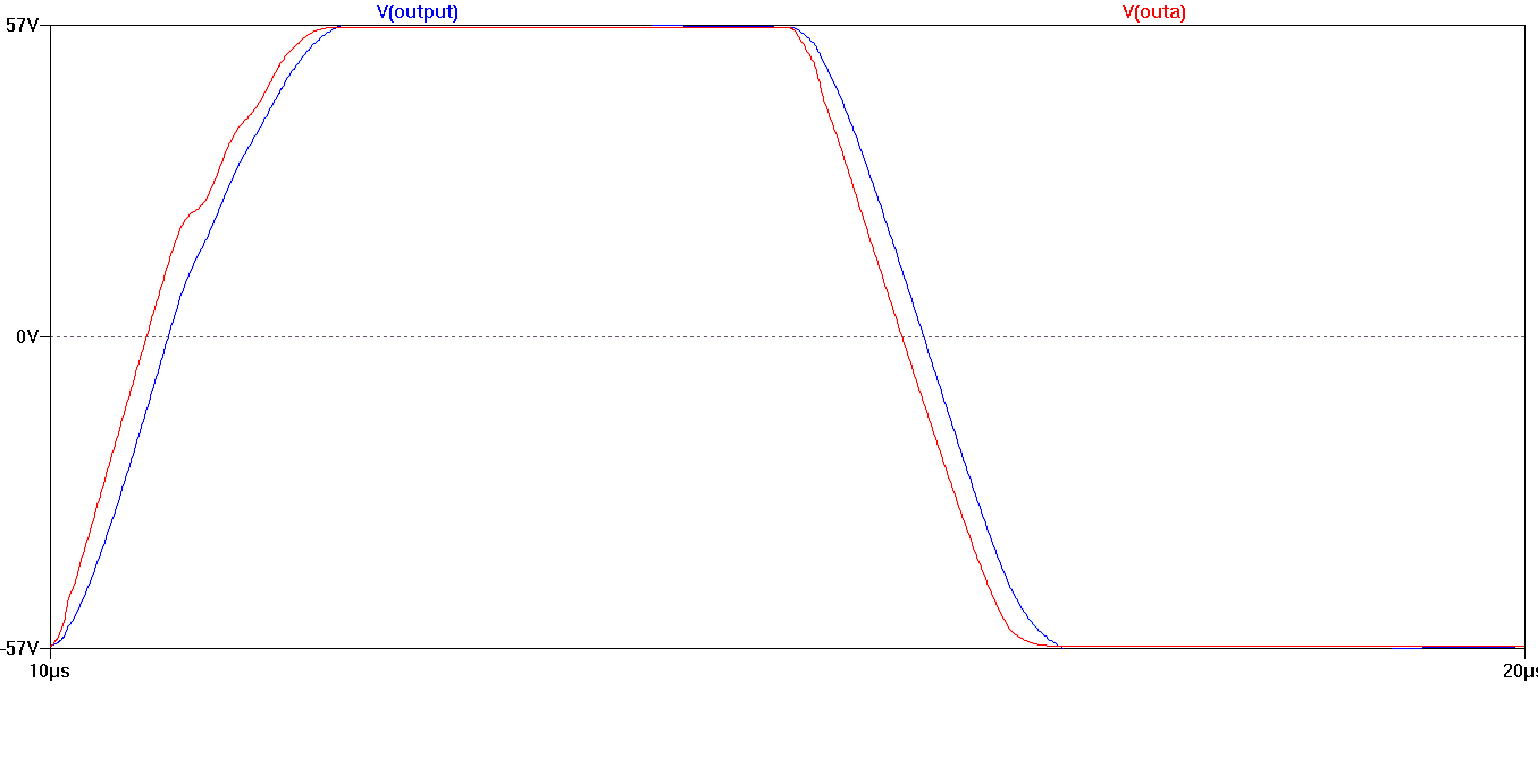

But each case needs to be looked at individually .. in SPICE and also in 'real life'. eg
In #271, I was looking at V(outa) to see some of the stuff that Toni saw in real life. You clearly see the wriggles on the top of the squares with different C16. But I couldn't get the wriggles on the upward slope ...
.. until I looked at V(outa) without C16 on a 8R load. NoC16.gif clearly shows the wriggles on the upward slope. C16-470n+10.gif shows none. Yes I know this isn't what Toni found.
Conclusion: more work to be done but neither 'no C16' or 'C16 470n' are optimum.

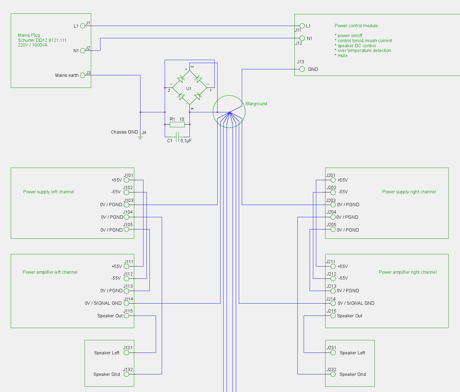

All the amps I've designed & built use (3) ie Starpoint directly to Chassis. So I don't really know what to put in [?].
kgrlee: very nice drawing. It correctly demonstrates my grounding schema. Thanks for the RFI hint.
See my attached picture which explains the [?].
The [?] contains a 35A bridge-rectifier used as antiparallel double diodes and 100nF/10R. In Austria every device with metal case has to be grounded/earthed for safety and you would easly get multiple groundloops. If we can lift the RCA shielding above earth/gnd by 0.7V we can effectively fight the hum. As 2 parallel diodes of this bridge rectifier are capable to drive 70A and peak more as 800A every fuse will be blown by this combination. sajti's recommendation only to use 10R without diodes can be letal - think of a defective toroid transformer where 235V find it's way to PowerGND.
Regarding "two monoblocks in one case": yes, all is doubled. There are two toroids, two power supplies, two amplifiers in one case.

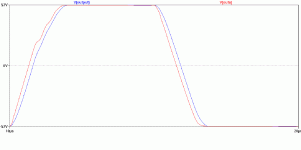

Du.uuh!
56.6Vp @ 8R
On 2EF274-20k.gif, I show 2 cycles of 20kHz at the equivalent level of 0.01% (blue) to give an idea of scale for the residual (red). Ignore the LF stuff.
Thanks for contributing the plots. The residual looks nearly the same as in real life on scope. The higher level at crossover from minus to plus is also viewable. May be one of the effects caused by suckout cap C16 if it's too big? Will try in real life.

But will all of you who have opinions on this subject please post a little pic of how you would do it. It's an important issue which is poorly understood.
'Real life' please but pontificatin' OK if backed up by 'real life' experience :D Here, a pic is definitely worth 1k words.

All conducting cases MUST be connected Directly to Ground for safety. These should be wired individually to the Mains Earth terminal in the plug.
This is what I show as the IEC to Chassis connection marked Class I Safety in #297
This is NOT NEGOTIABLE and leaving it out is illegal in many countries.

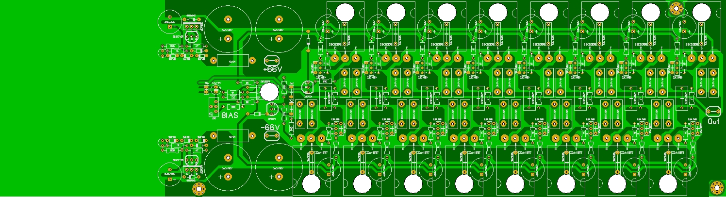

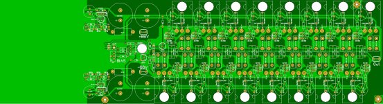

Keep on going to discuss the 2stageEF amplifier so one day an improved schematic/pcb revision will see the real world.

Hi Toni,
I've been watching this thread since you opened it and right from the beginning I thought of building this amp - "geiles Teil", a true beauty with promising sim and real life figures. I'm gonna join the 2 boards to one and will give the idea of discrete darlingtons (2SC3503 + 2SC5359 and their complementaries) a try :)
2 questions since I'm rather unexperienced in designing analogue things:
  • does it make sense to repeat R48/C41 for each of the discretes?
  • would a 10n BE-cap on every driver improve sound/stability?
Coming back to the quote, did you keep track of all the mods you tried out and did you preserve the best results in an up-to-date-best-of-all-schematic?
Thanks in advance and keep going, I'll keep watching :D

Dear Holgi,
thank you for joining this thread!
From time to time the latest simulation has been posted. Maybe in a few days we can present the final revision 2 schematics and pcb boards.
Both boards to join will be a huge pcb.
The decision to make 2 boards conencted by ribbon cable was primarily to be able to place the input stage as near as possible to the input jacks and to keep this pcb as far as possible away from all big currents and powersupply toroids.
The discrete darlington version as well as the mosfet version are only drafts and therefore totally unfinished and needs a lot of simulation work to get all things right. Maybe some day...
BR, Toni
As said, I'll keep watching...
Current idea is to use a 3U 400mm-depth case with side-panel heat sinks. The input stage will be very close to the back panel and have the RCA jack connected via a few cm coax cable. The input stage rails are decoupled using keantoken's rail filter (thanks for this handy little circuit :)), we'll see how this performs. I attached a sneak peek on the current layout state.
BR, Toni
