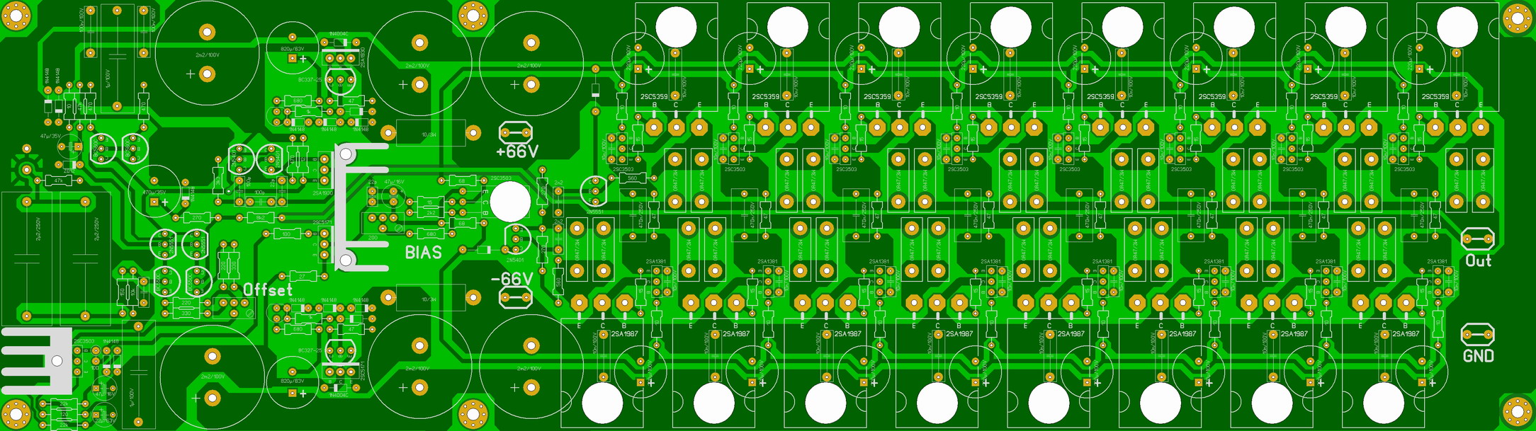

I'm not that into this PCB layout thing as Alex MM or many others here... Anyway, I completed a first shot of what it's gonna look like :)
PCB size is 367x103mm² now, perfectly fitting into the case planned for it :cool:
@Walkalone: I assume you pointed to the ground track on the right side of the PCB? And I will have a look into the M2600 manual, always willing to learn. Thank you.
BR,
Holgi

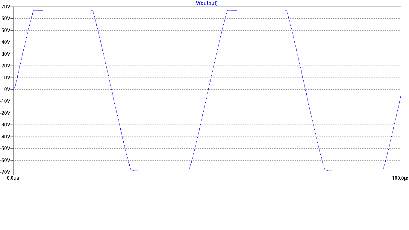

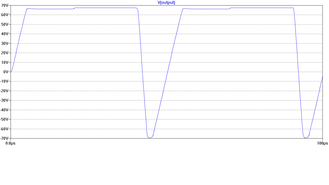

Overload Recovery
Some of you may have guessed that Overload Recovery is one of my pet obsessions. :)
The 'pure Cherry' version I posted in #182 was extensively tested.
Imagine my horror to find the 'pure Cherry' version of Toni's #274 behaved as below ... at least in SPICE world. It takes forever to come out of +ve saturation. 1837_aVAS.gif
Much investigation later, the cause was traced to the 'new' 2sa1837/c4793_a used for main VAS & its CCS load. It appears that when these saturate, Ccb goes to very high values and has to be discharged before the amp comes out of +ve saturation.
Going back to 2sa1930/c5171_d models 'cured' this. These are Harry Dymond's models. Harry has several caveats about his models. 1930_dVAS.gif
Dunno where the 2sa1837/c4793_a models are from but both are in Toni's mylibs.lib
The sim pics are from Toni's #274 TMC .ASC The 'pure Cherry' versions are similar.
Toni, can you see what overload behaviour your amp has in 'real life'?
It would be nice to get the BJT models to reflect something of 'real life' behaviour but I'm not a SPICE model guru :mad:
These are output pics with 20kHz 3.85Vp input
Simulations shows incorrect data at 20kHz. In simulation it looks like it does take veeeery long time to come out of saturation. Not so bad in real life: if you simulate 1kHz overload then you get a plot which looks like real life 20kHz oscilloscope picture. Real life lower frequency overloads are simply truncated sinus waves.
BR, Toni
It may be if the transistor used enters quasi-saturation, because of lower Vce.
Increased current mirror emitter resistors do not alter the transistor Vce if the mirror is balanced, the whole current mirror just sits a bit further from the rails.
Toni's mirror is fairly well balanced so unless I am mistaken, your comment does not apply here.
