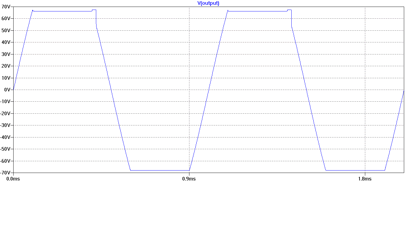

Simulations shows incorrect data at 20kHz. In simulation it looks like it does take veeeery long time to come out of saturation. Not so bad in real life: if you simulate 1kHz overload then you get a plot which looks like real life 20kHz oscilloscope picture. Real life lower frequency overloads are simply truncated sinus waves.
This is #274 amp with 3.85Vp i/p at 1kHz and 8R load. 1837/4793_a used in VAS/CCS for this sim There is a small amount of 'blocking' as it comes out of +ve overload but if this was 20kHz, it would be considered 'mild'.
Toni, please confirm this is what the 20kHz overload looks like.
If you have a 1930/5171 version still around, please take some pics of 20kHz overload if you ever fire it up again. But don't do it just for this. :eek:

I wonder which models are incorrect?
The 'correct' models are those which result in sims. closest to 'real life'.
That's why I asked Toni if he has looked at 20kHz overload on the 1930/5171 versions.
I take with a large pinch of salt, sims showing THD below 1ppm but I really want LTspice to show macro behaviour like overload.
When we get Toni's 'real life' results, may I beg some SPICE guru to modify the 1837/4793 & 1930/5171 models so they at least show some resemblance to 'real life' overload on this simple design?

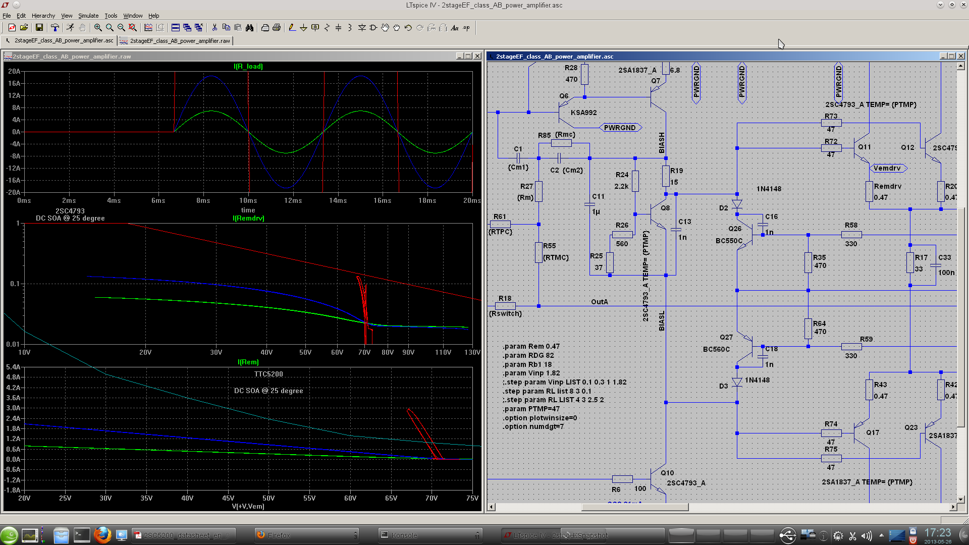

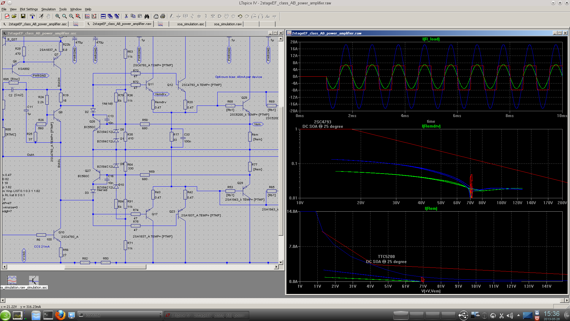

astx, your output transistor protection is very poor indeed. See paper here:
http://www.diyaudio.com/forums/solid-state/235841-michael-kiwanukas-soa-paper.html
Dear michael,
have done many simulations and the results are always the same:
Using single slope or dual slope limiter always increases distortion factor 10 to 100 times. Can you confirm this, that those type of limiters can decrease sound quality?
Attached some 2 screenshots of dual slope test.
A third picture shows the behaviour of the simple current limiter which shows clearly a DC SOA violation but should withstand 10 - 100ms short circuit situations without any problems. The simple protection is distortion neutral - maybe because there is no reference current flowing from/to rails?

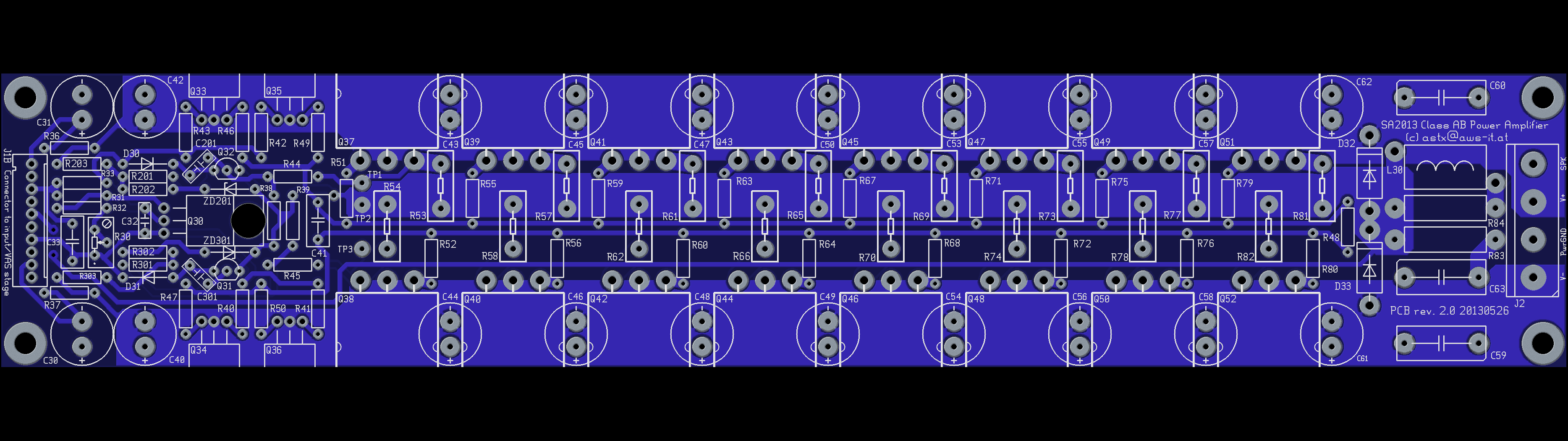

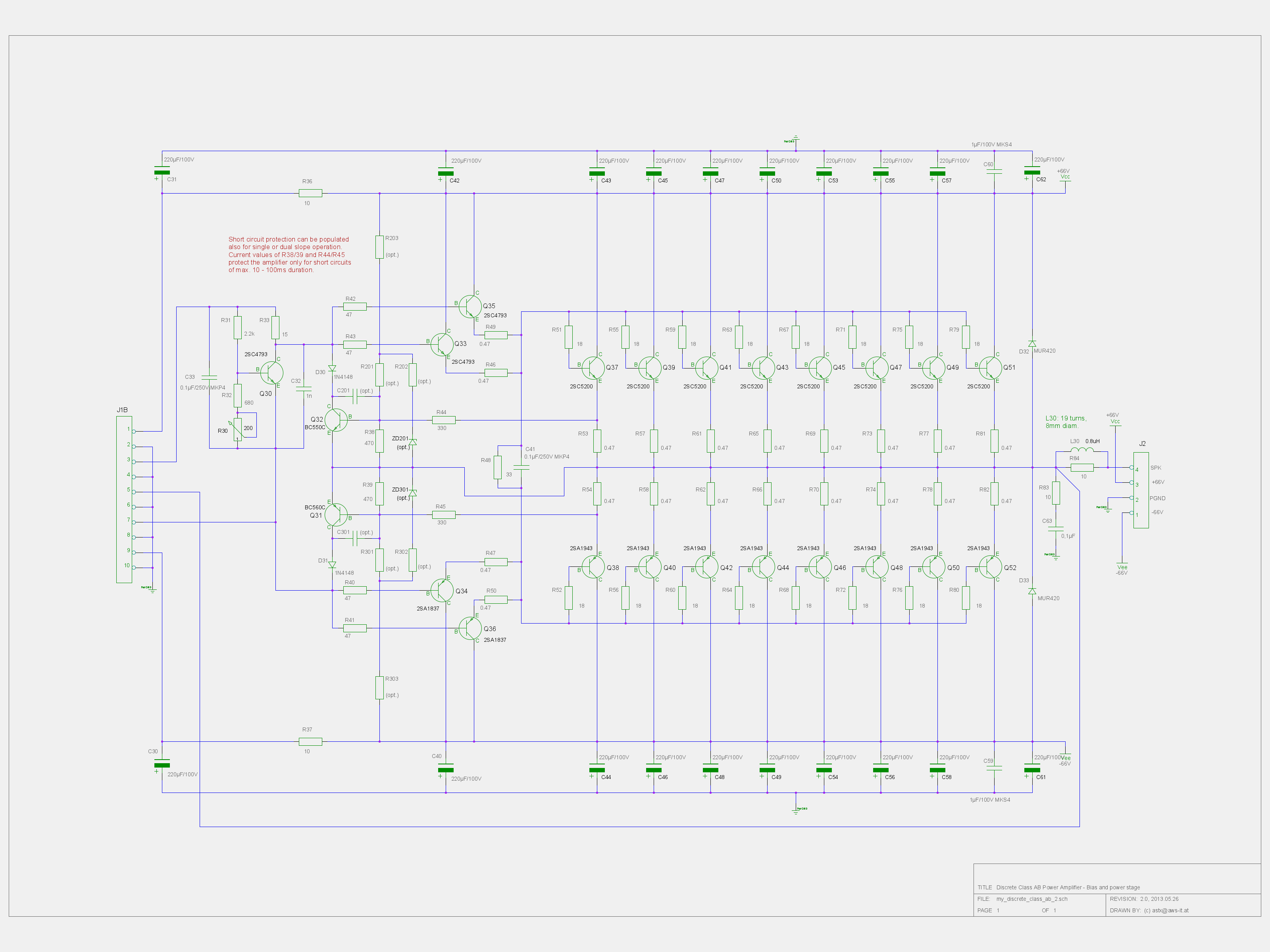

The amplifier pcb will get place holders for different short circuit protection variants so one can decide if best sound quality or best output stage security is desired.
BR, Toni

You clearly haven't read the paper I recommended as carefully as you should. For a start you must never have base-collector capacitors across your potection transistors.
Secondly you should have used base ballast resistors for each of your protection transistors. And what possible reason could you advance for using two zeners in series?
I don't know whether your derivation of component values for your protection circuit are correct, and I have no idea what your worst case design load, given your chosen protection locus, is.
You also need resistance between the stage preceeding the protection circuit and the output stage to facilitate the clamping action of the protection transistors.
I don't know whether you calibrated your simulation model of the protection circuit, so I cannot deduce whether your SOA plots are accurate.
I haven't done THD tests with & without single/double slope limiting but I HAVE done listening tests.
In the early 80's, many big (& small) amps had single or double slope limiting.
The double slope limiters had a sound which we called 'snap crackle pop' limiting cos that was what it sounded like when triggered. (I was really a speaker & Double Blind Listening Test pseudo guru in my previous life :D) This isn't a golden pinnae type observation but something you could induce with the right (evil) speaker and music so anyone could hear it.
My present prejudice is to have only simple current limiting like Toni. BJTs are much more rugged than in the 80's so single/double slope limiting is probably unnecessary today.
.. and nearly as cheap to have another pair of output devices.

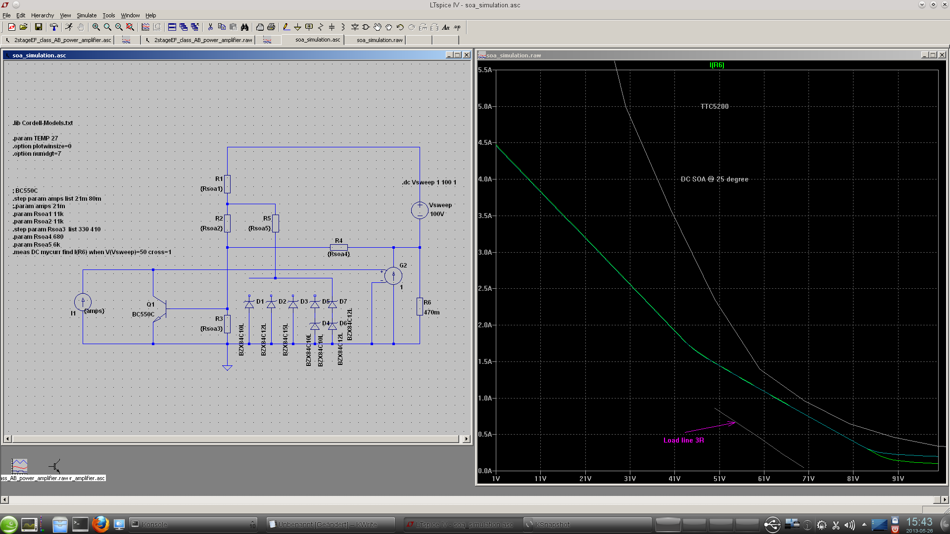

How do you do the SOA plots in the first screen shot?
Sorry if this is an LTSpice newbie question but I want to sim the distributed driver version that you posted.
Best wishes
David
Dear David,
rename file
2stageEF_class_AB_power_amplifier_soa_drv_d2.txt
to
2stageEF_class_AB_power_amplifier_soa_drv_d2.plt
and load it after a simulation of
2stageEF_class_AB_power_amplifier.asc
To add your own SOA curves for a given bjt save a "plt" file and add lines and text. Here an example of the SOA curve of TTC5200/2SC5200 (values are extracted by hand from datasheet).
Line: "A" 3 0 (1,14) (5,14)
Line: "A" 3 0 (5,14) (10,14)
Line: "A" 3 0 (10,14) (14,10)
Line: "A" 3 0 (14,10) (20,7.5)
Line: "A" 3 0 (20,7.5) (30,5)
Line: "A" 3 0 (30,5) (40,3.6)
Line: "A" 3 0 (40,3.6) (50,2.35)
Line: "A" 3 0 (50,2.35) (60,1.4)
Line: "A" 3 0 (60,1.4) (70,0.96)
Line: "A" 3 0 (70,0.96) (80,0.65)
Line: "A" 3 0 (80,0.65) (90,0.46)
Line: "A" 3 0 (90,0.46) (100,0.34)
Line: "A" 3 0 (100,0.34) (200,0.06)
Text: "A" 1 (50,5) ;TTC5200
Text: "A" 1 (50,4) ;DC SOA @ 25 degree
Line coordinates are
to be prepared in the form
  • (VoltageFrom, AmpereFrom) (VoltageTo, AmpereTo)
BR, Toni
