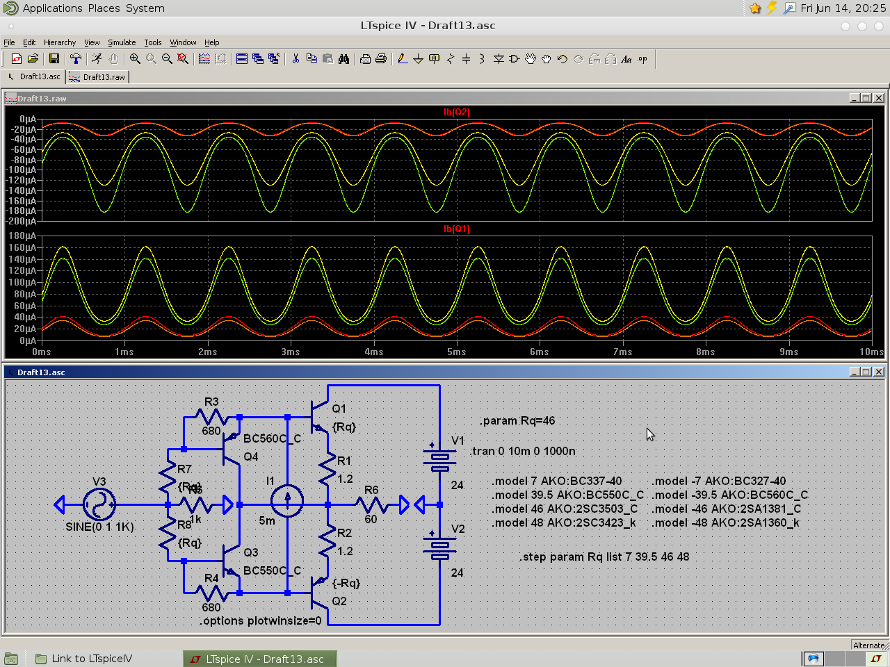

You cannot use .param statements with .model statements unless you make a .subckt, which then means you have to give each transistor its own symbol, and then it won't be selectable in the Rclick menu. So you would have to write the final parameters in the .model statement directly after you finished.
Unless I mistake what you mean by "parametrize".

Frank, (fas42) shows how to swap a zillion devices in one fell swoop as follows.
- give your models numeric names like 970.01 and 970.02
- label the zillion transistors with something like {drivers}
- have a ".param driver=970.01" directive somewhere on your .ASC
- to change them all to 970.02, just change the .param statement
I do this on the discrete-opamp-open-design thread to swap between Cordell, Wurcer & other guru & pseudo-guru models.
Thanks for this. I tried alphanumerics and it didn't work.
Never considered that it would make any difference.
A bit odd really.

You can do something like
.model 100 AKO:2SC5171
To make setting it up less tedious. AKO is an acronym of "A Kind Of". You can use
.param Rbias=100
and assign each model the value of Rbias which maintains the correct operating point across models, so you can do a
.step param Rbias list 96 102 89
For example to step through each set of drivers without being confounded by Iq variance. Of course if you specify the wrong Rbias value LTSpice will complain about not finding the model.

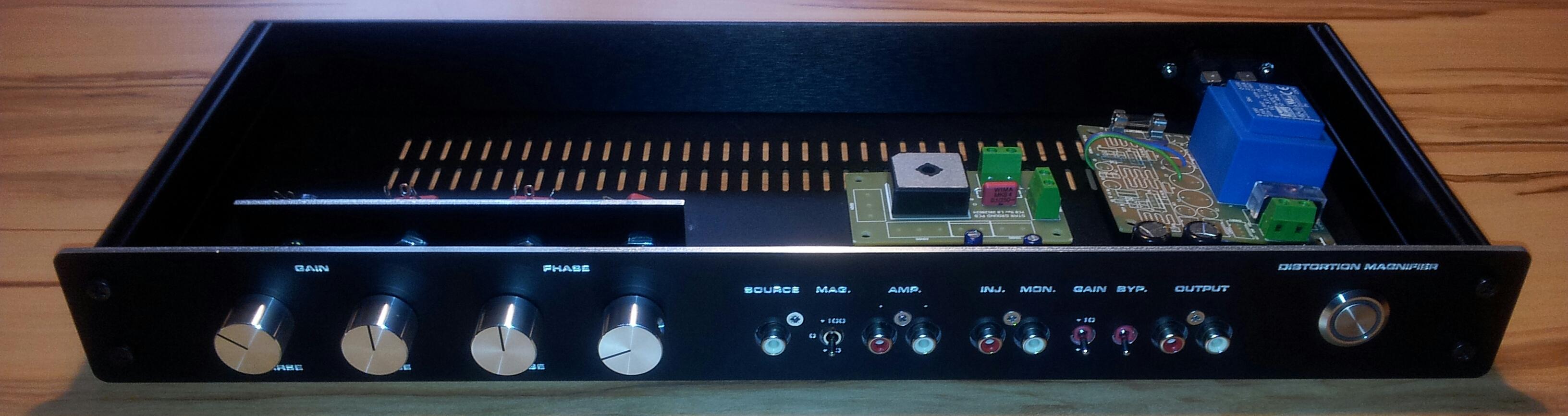

Very interesting discussion the last days. And also a clever spice trick ...
I haven't had very much time during the last 2 weeks to continue with the project but my lab soon will have the distortion magnifier (by Bob Cordell) and we can continue with measurements and fine tuning...
BR, Toni

Could you post a simple example .ASC please?keantoken said:You can do something like
.param Rbias=100
My small brain has problems unnerstaning dis.
