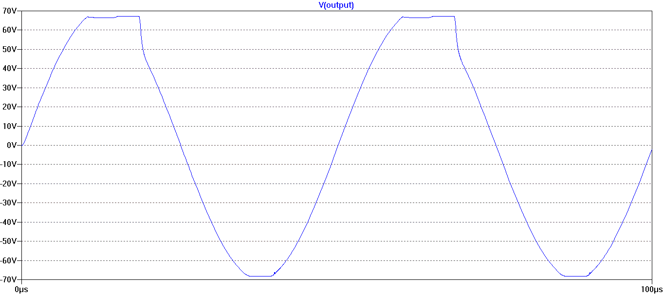

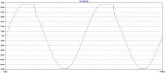

Mr. Zan, I'm playing with your suggestion of making TR=100n on AndyC & Dr.Dymond's models.
It would appear TR=400n matches Toni's results rather better. I enclose Toni's 'real life' pic of 20kHz overload and my sim with 2.285Vp input and TR=400n on 2sa1837/c4793_A.
TR=400n is roughly halfway between AndyC's 1.38u and your 100n
The 2.285Vp is unlikely to be what Toni used as his is a real amp with sagging PS rails. I give this number just for those who might want to replicate my sim.
May this bear with a small brain beg an explanation of TR in words of 1 syllable?
I take it changing TR has only small effect on other parameters.

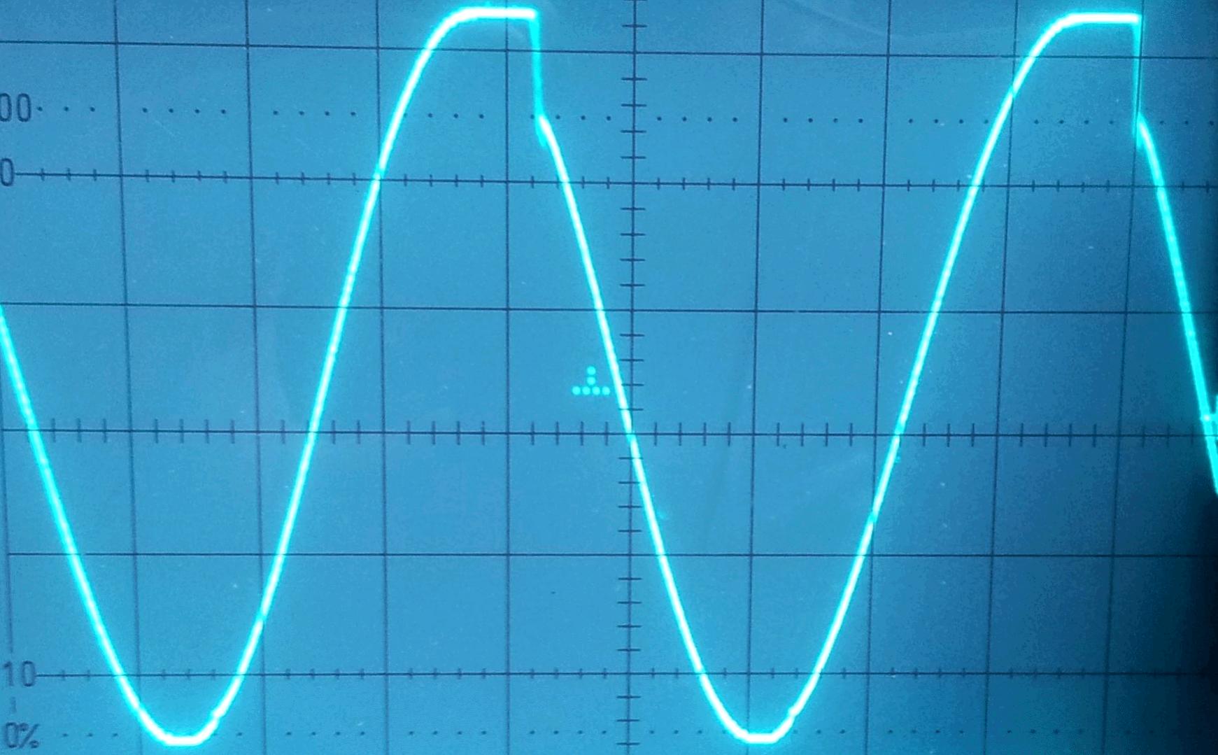

Toni, would you say the 'real life' overload with 2sc5171/1930 is 'better' than 'real life' 2sa1837/c4793

First you are right - overload picture was taken from beginning overload - 2.3V peak may be correct. The power supply is a regulated one with overcurrent protection. I have taken the overload picture before the overcurrent protection has activated - so no sagging of PS rails has influenced the measurement.
The overload behaviour is optically nearly the same using 2SA1930 or 2SA1837 in VAS stage. Can't say which is the better one.
All I know is if we limit the maximum VAS current by increasing R22 up to 27R the overload betters significant - but also the THD is getting worse ...
You have a pretty nice match. 100n was just a start value for the comparison with the real data from Toni.
May this bear with a small brain beg an explanation of TR in words of 1 syllable?I take it changing TR has only small effect on other parameters.
It influences the total effective base to collector capacitance of a BJT, important mainly near saturation.
It controls the "extra" capacitance due to carrier sweep-out that adds to the depletion layer capacitance set by CJC.
Similar to the way the Ft of a transistor dominates the effective capacitance of the BE junction.
So, obviously important as the VAS clips but should have minimal impact on Andy's results to fit all the other parameters, if that is your concern?
Best wishes
David

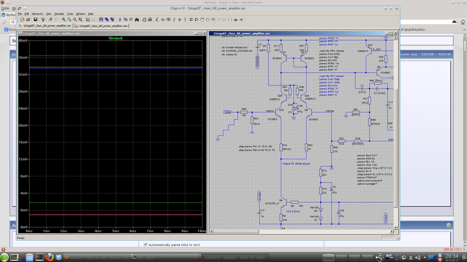

Even in simulation if we use exactly the same resistors and transistors (=best matched) there is a small imbalance/offset of about ~30mV (IMHO caused by base current of Q6 of about 6µA which leads to a small imbalance of CM).
We can tune this away by changing CM resistors or LTP resistors.
Attached simulations shows that tuning of Rin (R83 in sim/ R4 in schematic a few post ago) doesn't help us.
I know that there is minimum one well known person who demands to not use the LTP trimming and instead use a DC servo...
- Setting R14 and R52 to 70.00 we have about 34mV offset.
- Setting R14 to 70.41 and R52 to 70.00 we have tuned the offset nearly to zero.
BR, Toni

LTP trimming ...
Have temporarily removed LTP trimmer and set LTP degeneration resistors to 68R. (with trimmers LTP resistors are about 70R)
Distortion difference THD21k@200W@8R not really significant.
with trimmer:
0.00147 % bw 80kHz
0.00188 % no bw limit
without trimmer:
0.00143 % bw 80kHz
0.00184 % no bw limit
But note:
On the other hand: offset is due to good bjt matching and 1% resistor out of the box 6mV. Do we need any trimming here?

Overload & TR
It makes the sim even closer to 'real life'. They were done with R22a+R22b=27R
What was R22 on the photographed amp?
Thanks for this Toni.First you are right - overload picture was taken from beginning overload - 2.3V peak may be correct. The power supply is a regulated one with overcurrent protection. I have taken the overload picture before the overcurrent protection has activated - so no sagging of PS rails has influenced the measurement.
Toni's results with the 27 ohm VAS emitter resistor make perfect sense.
I used 11 ohms in my estimate so that may explain why it needed some adjustment.

Based on that, I've changed TR to 260n on AndyC's 2sa1837/c4793_A and also Harry Dymond's 2sc1930/5171_d models in my copy of Toni's mylibs.lib"What was R22 on the photographed amp?"
