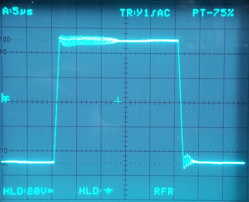

With compensation up to the limit, 100n caps at the rails will cause an amp to oscillate because their resonance changes global phase. 1u+1R snubbers across the rails help with this. These snubbers should go across the OPS rails, because the outputs are the main leakage point for rail resonances.
What is the frequency of the oscillation? This will help us understand the cause.
When you increase or decrease the driver bias, does the oscillation last for a longer or shorter time? This will tell us whether driver recovery is a factor in oscillation. If not, it could be TIS recovery.
The outputstage has not been modified. So if your theory would be correct, why is it not possible to trigger this kind of oscillation with Miller, TPC or TMC compensation? 😉

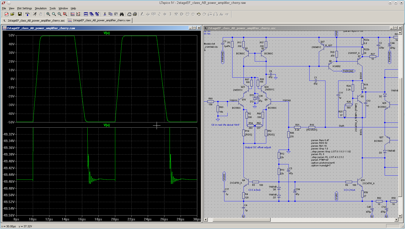

Toni, I don't think this will cure the wonky instability on Square waves but should help. Try the following. You have to do them all
  • C11 (collectors of Q7/10) to 10n
  • C8 (across C8) to 10n
  • remove C16 across R17 33
  • decoupling across R22 VAS emitter resistor becomes 330p+1R
These speedup/suckout capacitors are ONLY for 'pure Cherry'. If you revert to TMC & other stuff, you need different & bigger values.
I don't think the smaller PM & GM are causing the problem but the 'cure' for that is bigger C10 at the CM & C1, the Cherry capacitor. Maybe 100p. I've only done cursory sims of this particular change.

On simulating your cherry variant I have detected some kind of instability during square wave analysis - see attached picture.
I think the ribbon cable is not the problem but I will retest the cherry variant more in detail

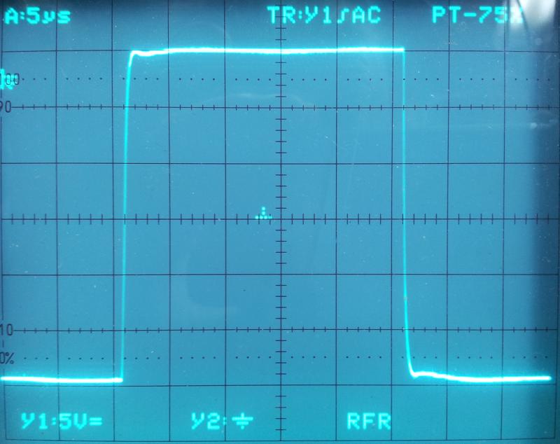

The stability compensation affects each aspect of the amp individually. Different compensation schemes react differently to driver recovery, VAS recovery and so on. Some have adequate phase margin normally but if anything ever saturates, the amp will explode into oscillation and burn a hole through the floor.
Another thing that would help is to look at small-signal square waves with minimal BW limiting on the amp. This will tell us whether Cherry is undersized or whether it is only having difficulties at the extremes.
BW limit on input during testing is defined by 150R/500p - 2.1MHz
The two square wave pictures from post #492 http://www.diyaudio.com/forums/soli...b-power-amp-200w8r-400w4r-10.html#post3534876 are taken at different output levels - do we need some more level steps?

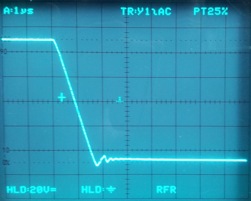

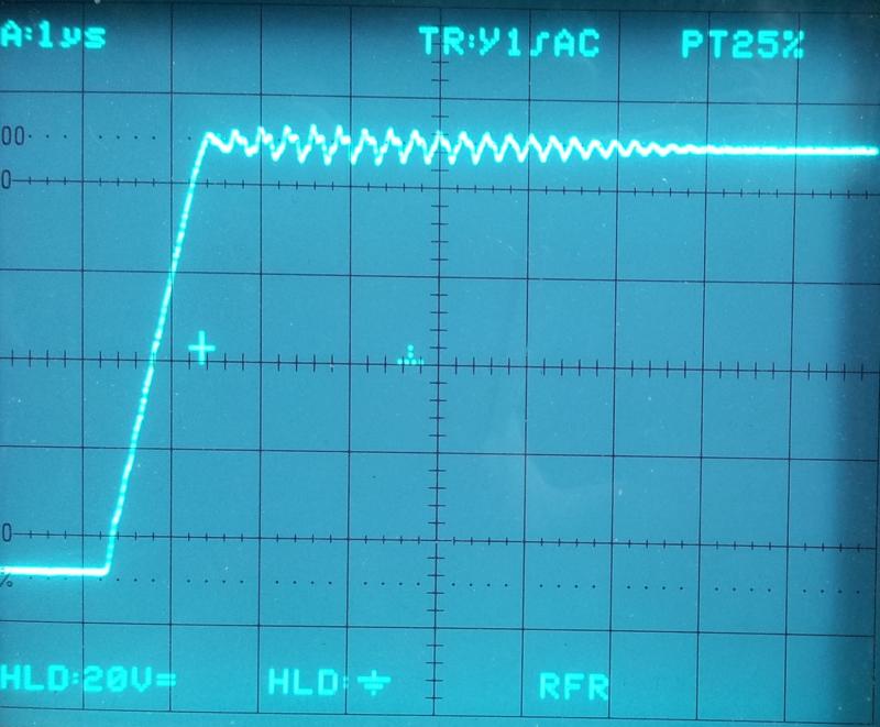

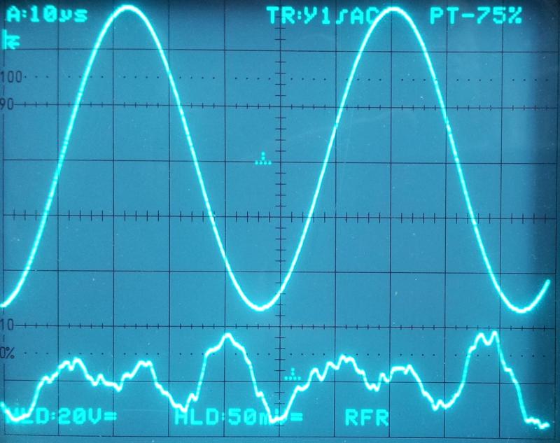

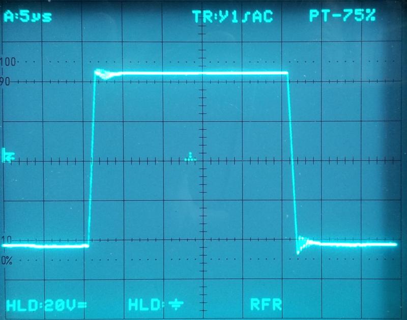

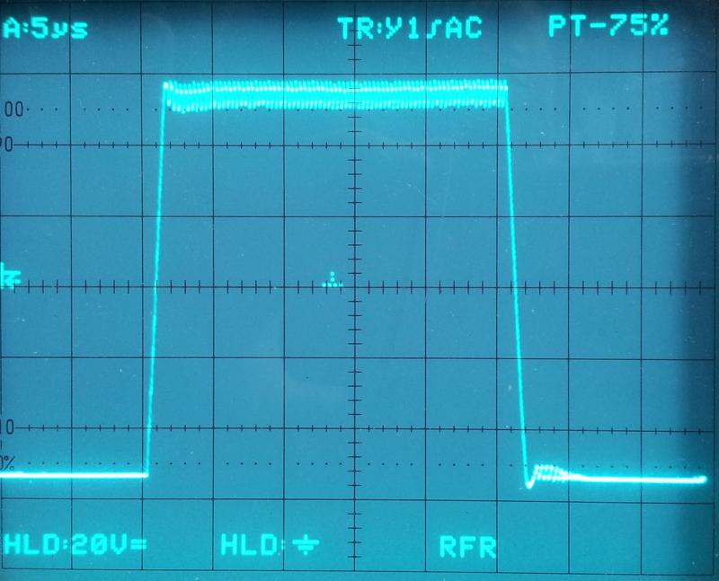

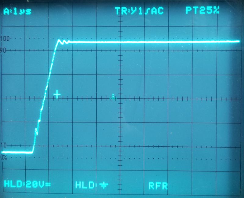

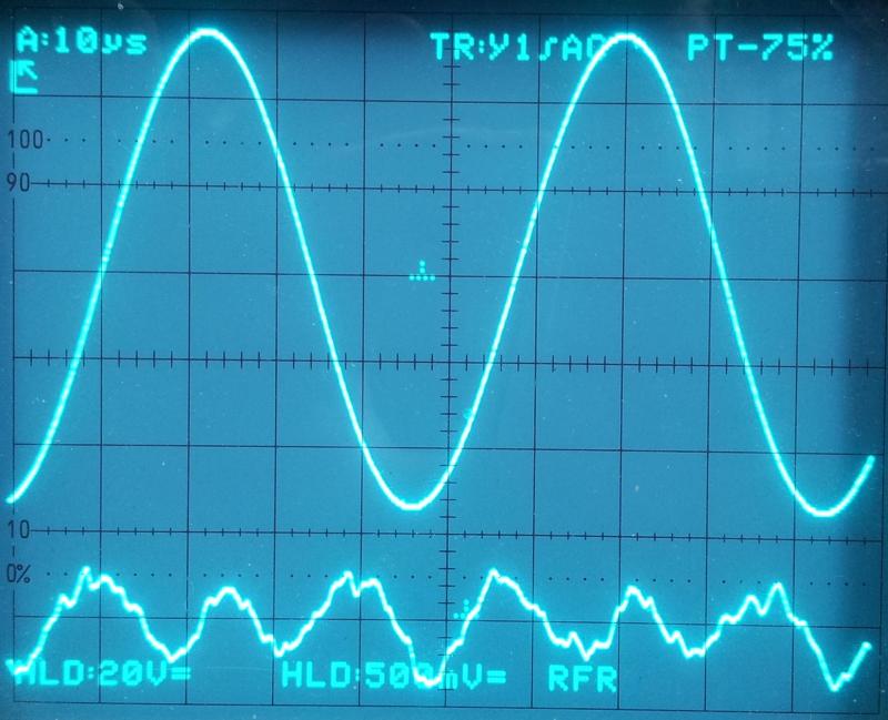

Cherry variant with "long ribbon" cable
"Cherry" (or OIC) with 2 x 47p and 330p/1R. Other mods need some time...
Here some screen shots using long ribbon cable (10 inch).

Cherry variant with "short ribbon" cable
Here some screen shots using short ribbon cable (2 inch).
Note: distortion increased with short ribbon cable (maybe due to less capacitance):
10 inch ribbon cable
0.00187% (bw 80 kHz)
0.00225% (no bw limit)
2 inch ribbon cable
0.00250% (bw 80 kHz)
0.00290% (no bw limit)
BR, Toni
"Cherry" (or OIC) with 2 x 47p and 330p/1R AND suck out cap removed.
Screen shots using long ribbon cable (10 inch).
More stability and less oscillation but now we can see an old known instability again ...
Distortion figure for THD21k@200W@8R
0.00176% (bw 80 kHz)
0.00217% (no bw limit)
