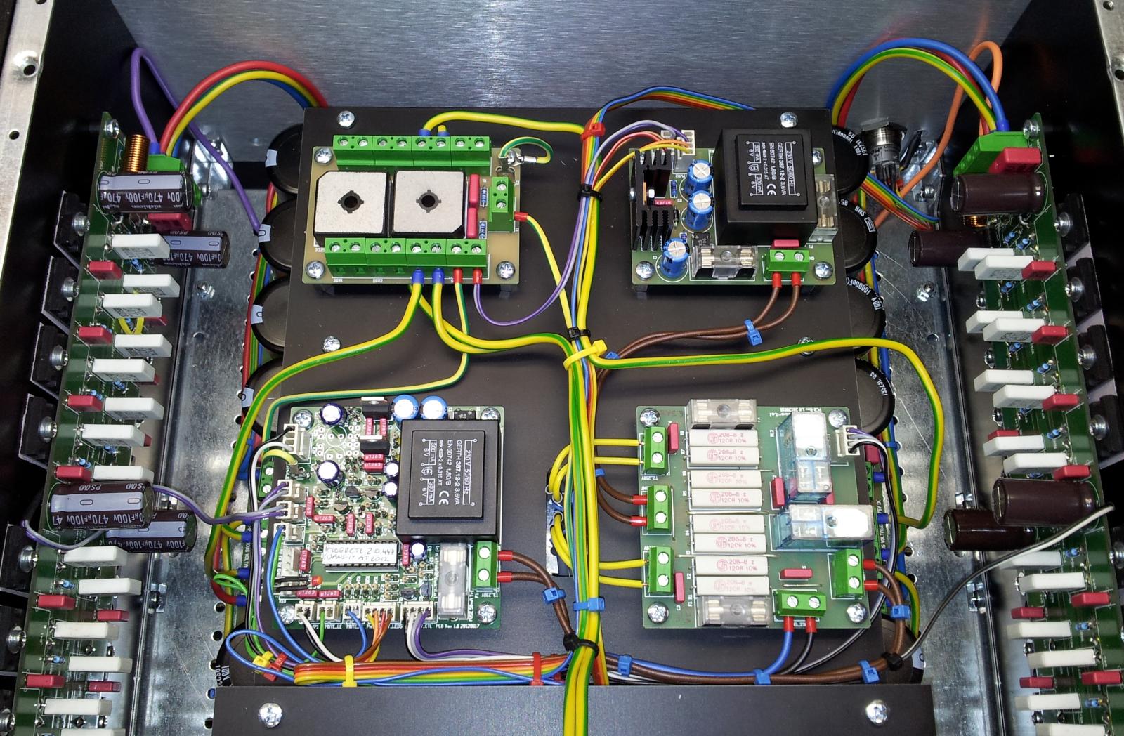

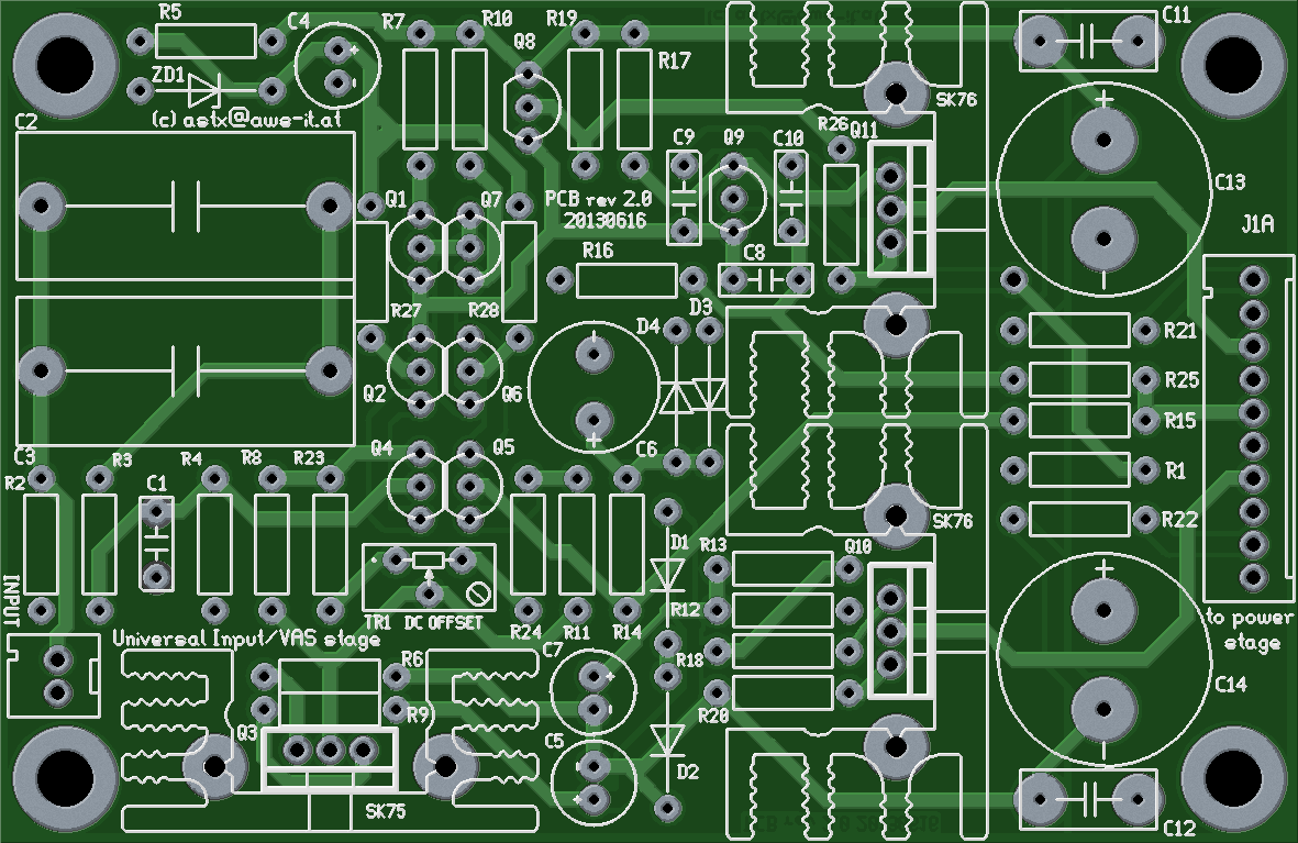

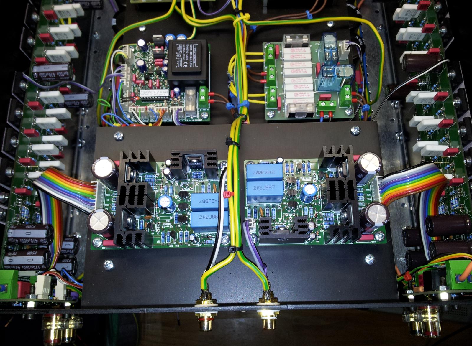

All above measurements are made with Rev 2.0 Input/VAS boards (see attached picture: mounted on top of the amplifier - far away from the toroids).
Grounding is here very important. A strong copper wire is directly soldered to ground connectors of chinch inputs and the other side is connected to left or right star ground.
Second picture shows the dual star ground and all control circuits.
The speaker ground return is NOT connected to the main star ground - it is connected to the power supply star ground. The amplifier output stage positive, negative supply and ground wires are paralled
Amplifier output stage speaker output is separated and routed under the mounting plate to back of amplifier.

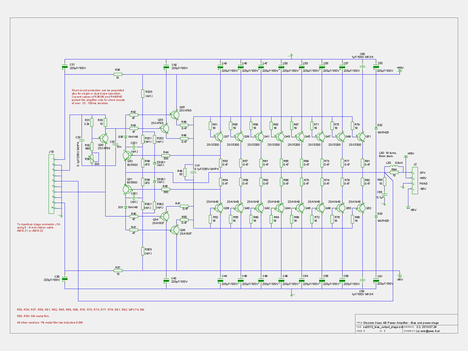

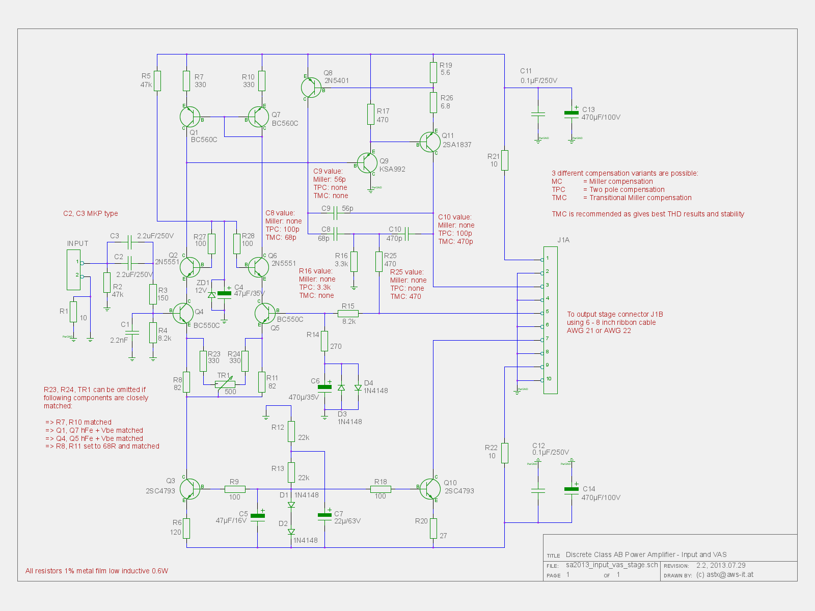

Updated schematics ...
attached updated schematics.
Feel free to use for non commercial DIY projects.
BR, Toni

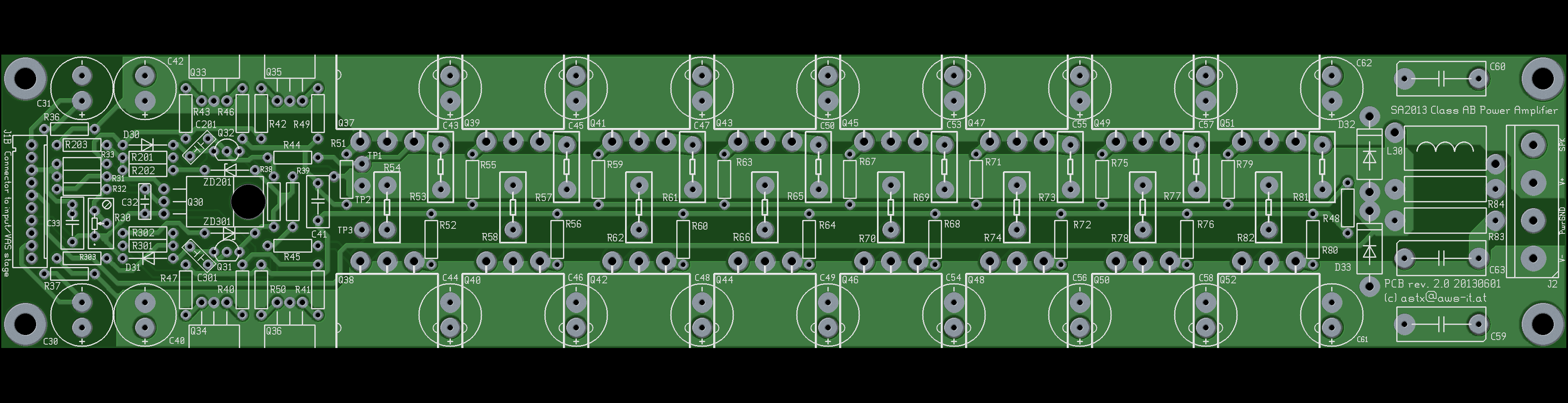

Updated bias output stage pcb
attached updated pcb for bias and output stage.
NOTE: this PCB version is currently untested. I have uploaded it for those who can't wait. You have been warned! 😉
The amplifier is tested using output stage pcb rev 1.0 but using cap, transistor and resistor values from schematic from post #671.
BR, Toni
Reactions: Toaster79
I don't see it well, but I think you are missing the thermal spokes in the pads embedded in your planes. Having those makes soldering a lot easier.
My pcb software doesn't make thermals very well so I have decided to omit them as I do not have any problems with soldering (of course your solder iron should be temperature controlled with > 80W heating). 😉
