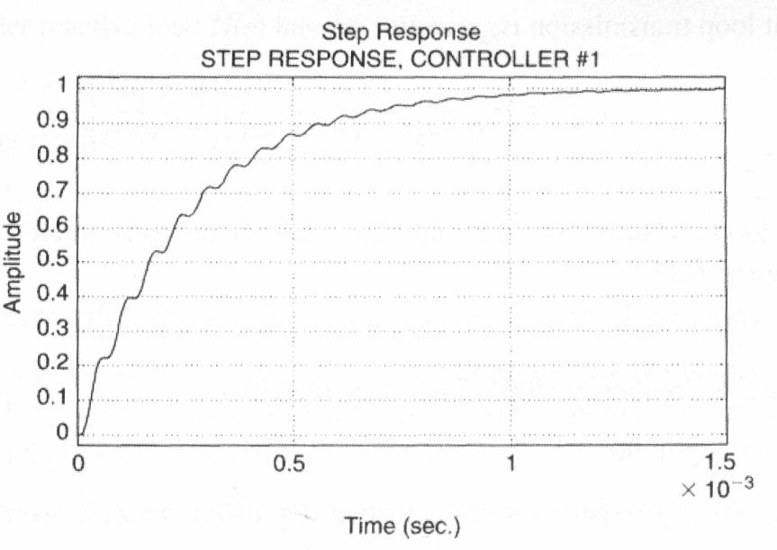

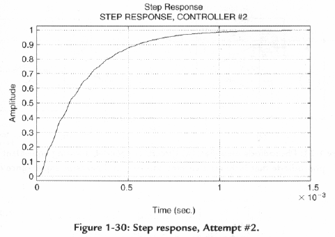

Have found some interesting facts behind the mystery from upper post. The gain margin of the amplifier was a bit low at that time of development. I have simulated the old asc file and found 7.5 db gain margin corresponding to the oscilloscope screen shot. Attached you can find two graphs from p24/p25 of the book "Analog Circuits / World Class Design" from Robert A. Pease which shows the same "wiggles" at about 7 db gain margin and no "wiggles" at > 10db gain margin.
As you know I have changed the base stopper resistors of the power bjt's from 4.7R to 18R which changed the gain margin from 7.5db to > 10db.

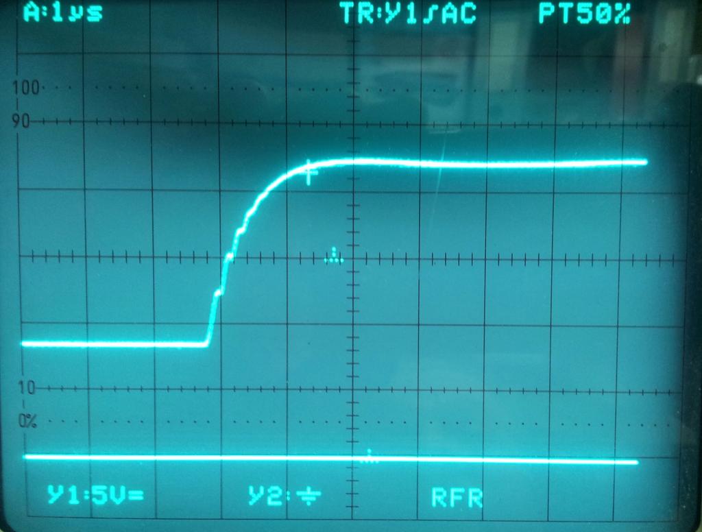

Amp is stable and working fine with TMC. There is only one thing where I can't find the reason why there is this sort of ringing on rising and falling edge. Frequency is about 5-6 MHz.
Anyone has seen this before? Any Ideas where to start "debugging".
Simulation with square root shows some small signs of the same effect...

I say that this is something that's important to remember for the future, and thank you for bringing it to our attention. Many know that low phase margin will cause overshoot and ringing in a step response, it's handy to also know that low gain margin can cause these "wobbles" in the rising edge of the step response.

thx. I also thought 6db gain margin is enough to get a stable system. Btw. both graphs from Pease's book have had a good phase margin of about 85 degrees.
SA2013 amplifier was working stable at those days with those 7.5 gm but a bit nervous working on high power square wave transients...

Depends what you mean by stable. Strictly speaking, your amp with low gain margin was stable. Yes, there were wobbles on the edges of transients, but the output continued to follow the input and there was no sustained oscillation of any kind.
The desire with amplifiers is to ensure stability under all reasonable operating conditions. When testing transients into resistive loads and overshoots or wobbles are seen, the fear is that the low phase and/or gain margins may mean that potentially "harsher" operating conditions may push the amplifier into full-blown instability. IMHO, "smooth" transient response is not necessary per se for audio power amplifiers.

Agree! Amplifier should work stable from 0 degree to 40 degree room temperature as well as with every complex speaker loads. Hence we need more headroom also for gain margin.
