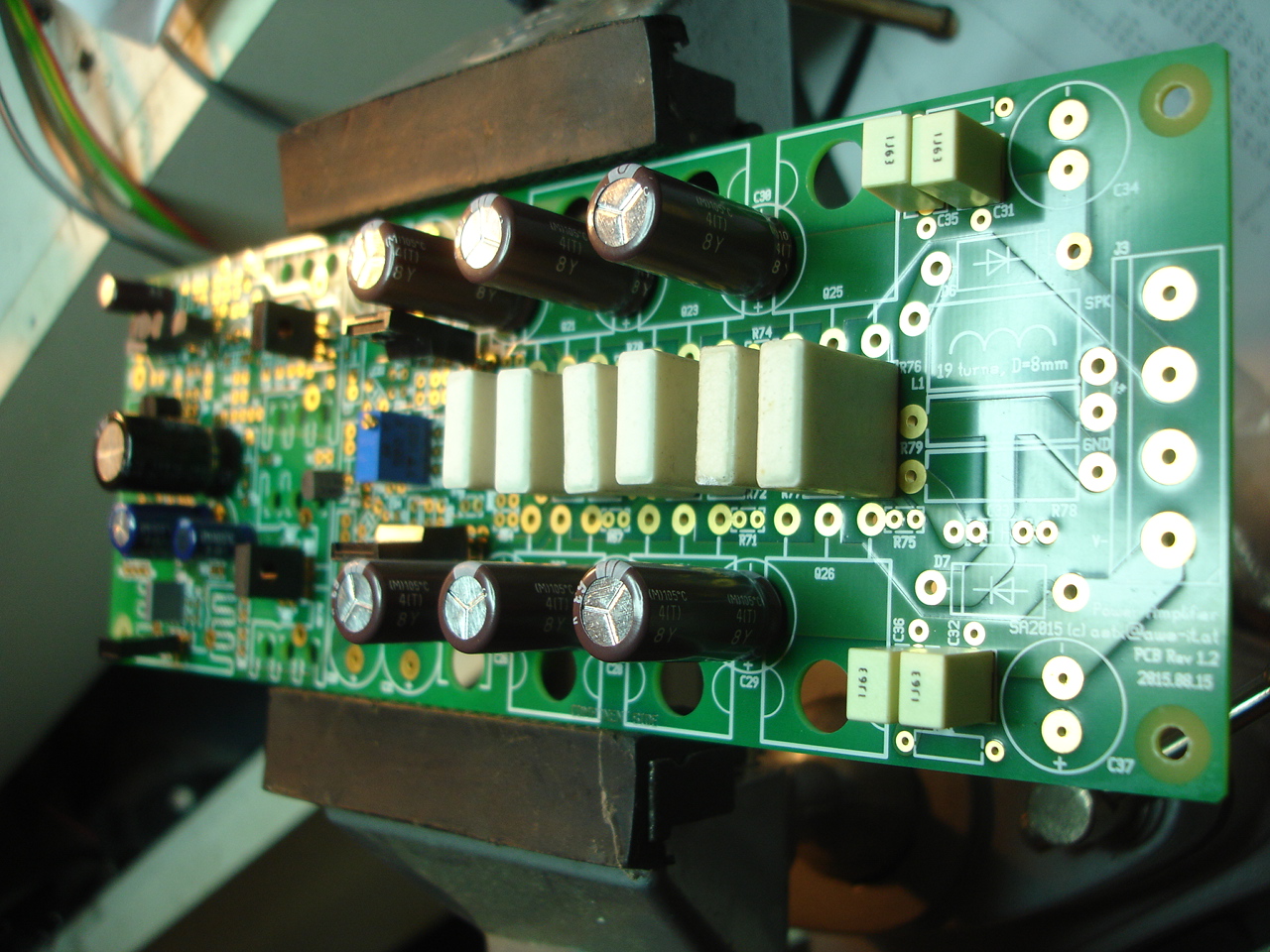

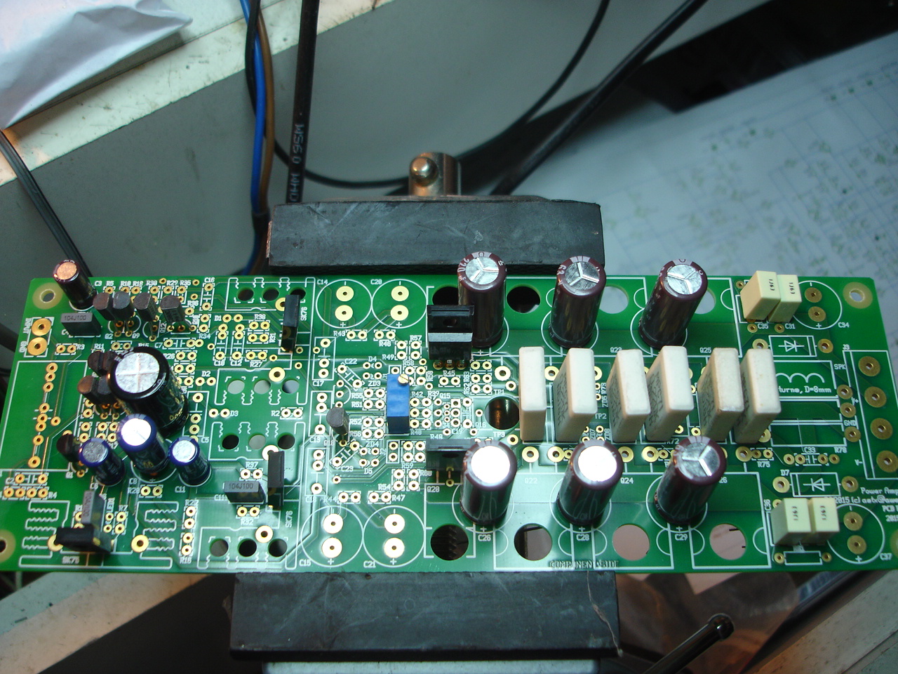

A new travel began:)
No solder anything yet,just try to see what i have on hand now......many missing parts ,some other not what exactly recommended:(

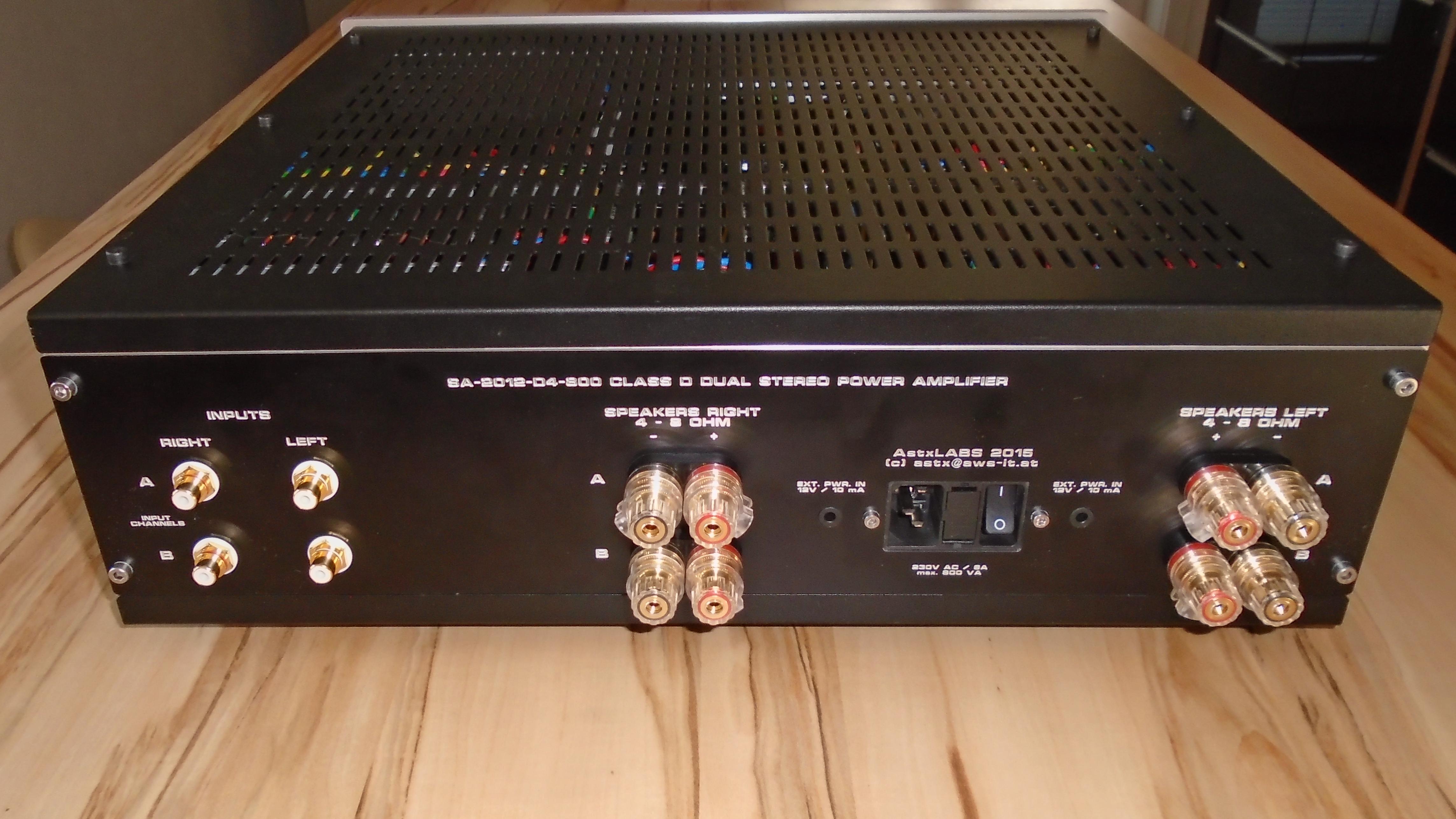

This is the back panel electronics including speaker relais for the 4 channel MOSFET power amplifier...
4 channel back panel ... sorry for the bad picture quality - better images will follow. Very similar to the 4 channel back panel which I designed for my class d amplifier...

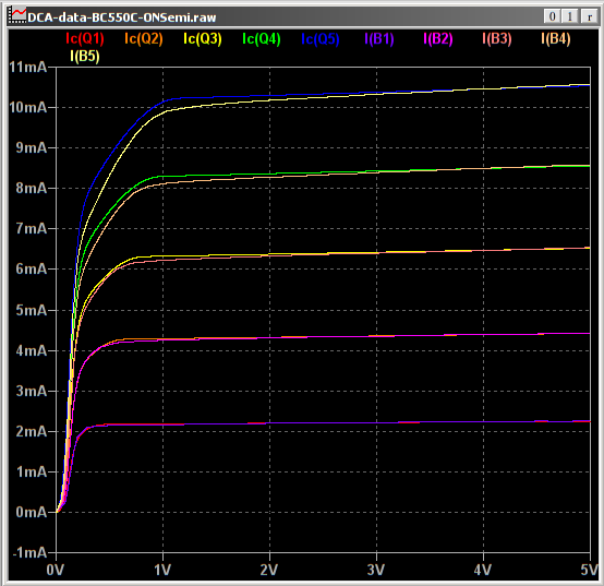

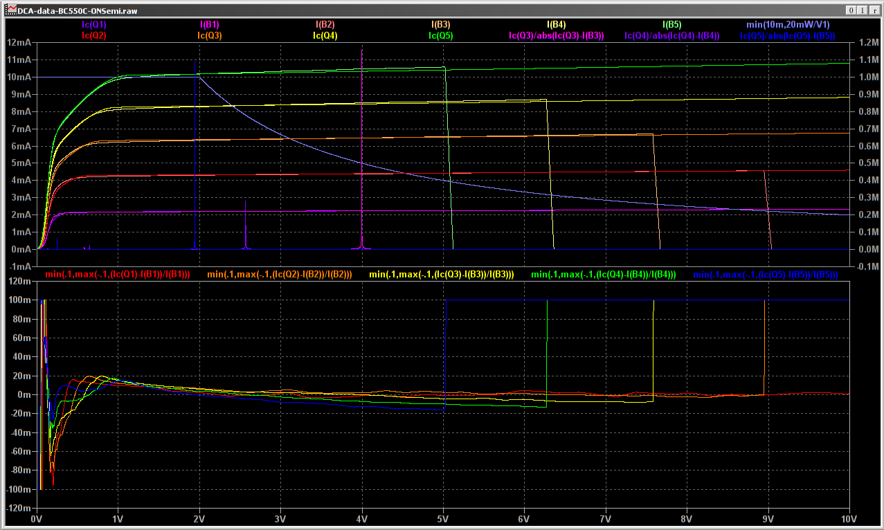

250 data points in 1 minute means about 240mS testing period. Based on the Siemens thermal response data, after 3 datapoints or so the thermal drift should be mostly over. This means that if I draw a constant power curve on the VI plane, the intersections of it with Ic should be very close in temperature. Based on this information I've estimated the model fit differently this time.
The bottom graph shows the model error as a fraction of Ic. So even with thermal drift, the model can match the data to 2% from 0.5V and up. Much closer at the equal temperature points.
The model seems to suggest that there is a 10mV or so DC offset in the data. The data itself shows about 3mV at Ic=0, but 10mV helps the model fit for some reason.

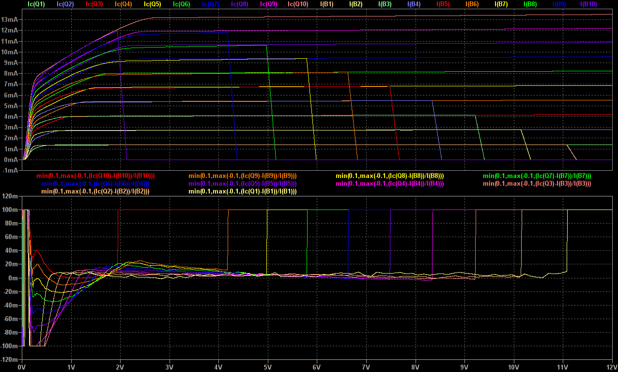

250 data points in 1 minute means about 240mS testing period....
Just checked with scope: DCA75pro seems to take every 10ms one sample with a test duration of about 2 - 5 µs. A 250 sample test cycle (50 samples per trace , 5 traces) takes about 34 seconds. A 1000 samples (100 samples per trace, 10 traces) test cycle takes about 105 seconds. Sampling stops if Ic is 12mA.
Due to the very short measurement time and the relatively long cooling time the device temperature changes should be minimized.
The sampling starts with low Vce and highest Ib and ends with highest Vce and lowest Ib. The traces are stepped using constant Ib current. The lowest Ib current which can be selected is 4 µA.
Unfortunately the measurement device is unable to measure Vbe during Ic/Vce sweep.
Also have a look at the DCA75pro internal test circuit. Should I continue to fetch data?
BR, Toni
