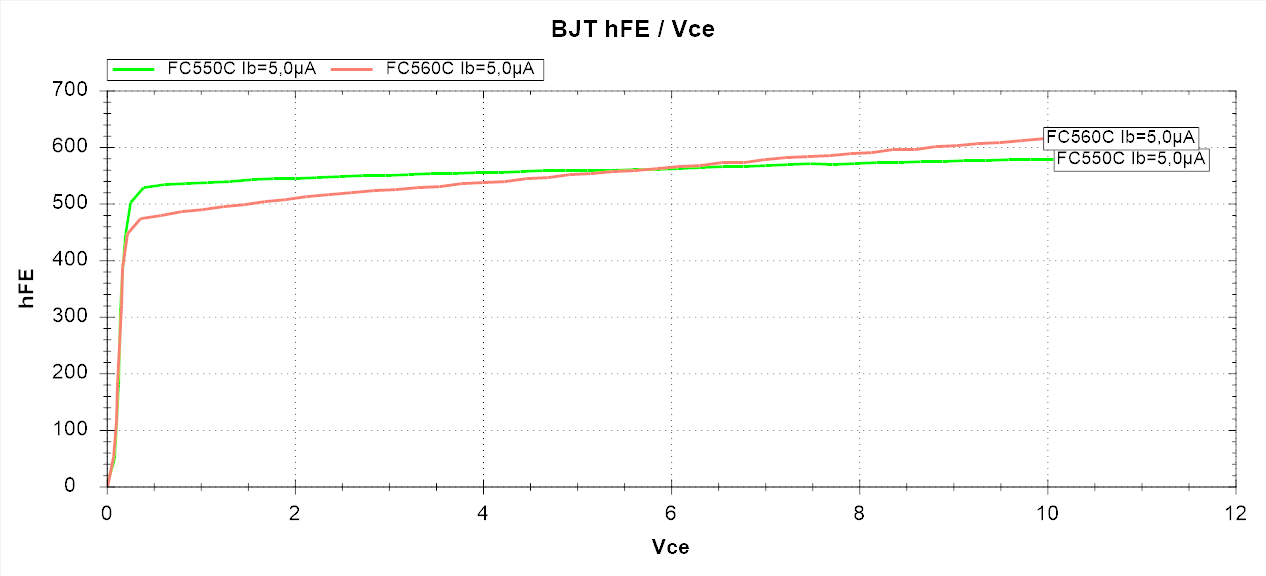

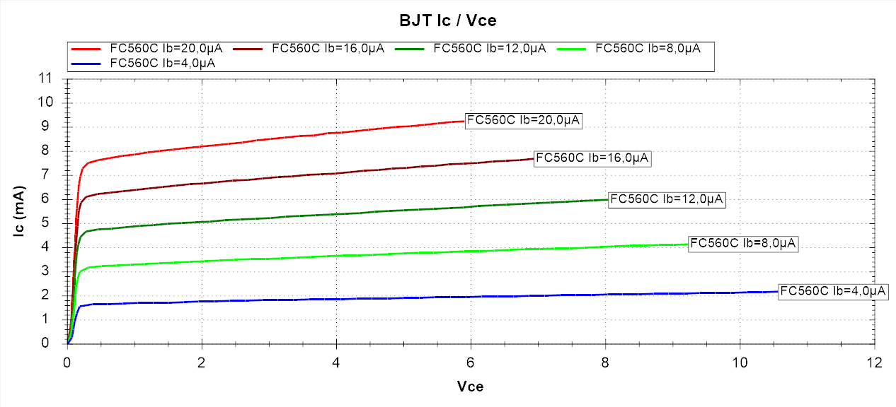

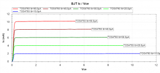

My Fairchild BC560C have Bf=780 at 14.6Vce but 600 at 7.6Vce. Think about it, Vaf is the voltage at which Bf doubles (About 23 for this transistor). Transistors with a low Early voltage will have a Bf that rises greatly at high Vce. This is not shown in the datasheet, surprisingly.
I have done some checking and it seems my Vaf test rig really is reporting Vaf correctly. Have you guys measured Bf at say 40Vce? Because it should be very high.

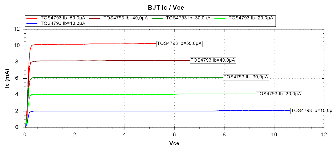

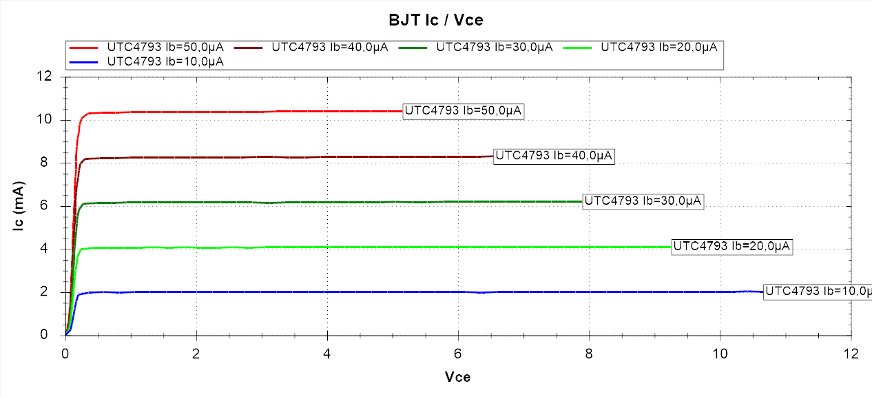

See attached data files. This is, what the DCA75pro software allows to export. Have data converted from dos2unix.Great to see curves! Can you upload the raw curve data so I can determine Vaf?
One thing left to test is Ft. Cbe might be the same but Ft can still be lower. And they may get slow at high currents.
Unfortunately DCA75pro isn't able to test Ft...
Thx for sharing!Here is the updated model library, there were some Vaf errors but not where I expected them to be...
BR, Toni

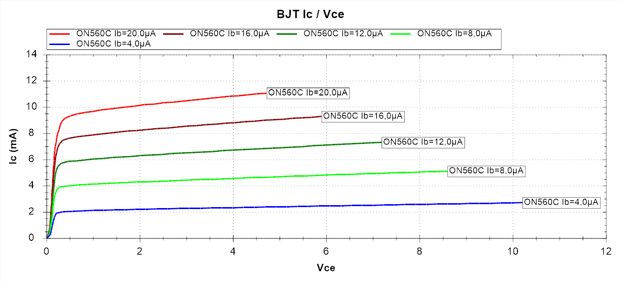

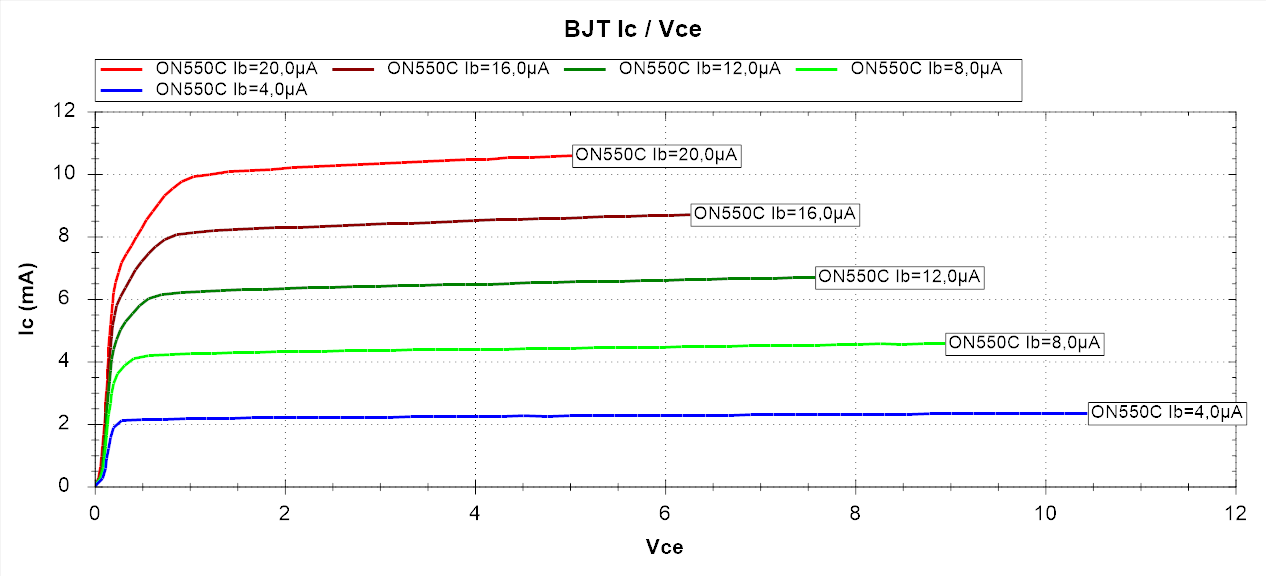

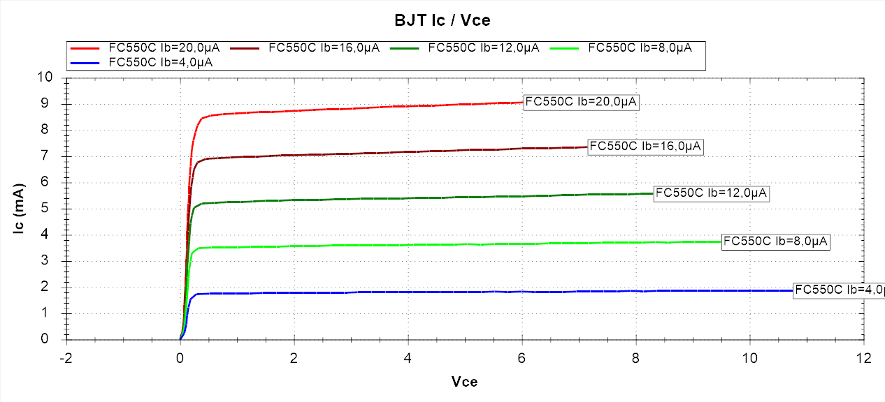

... does this mean you can use that data for your needs? If so then I will provide you the data for the other 3 parts. Maybe also extra data for the different BC5x0C variants I have (Fairchild, Onsemi)That data shows a Vaf of ~906. It's so high that it's difficult to detect at all with the range of voltages in the test. It also suggests that Andy_C's models need some major revision.
That file only has data for one transistor.
BR, Toni
... may take some time ... have a look later!That would be very helpful.
... some more data ...That would be very helpful.

Think about it, Vaf is the voltage at which Bf doubles .................
Bf doubles from what value to what value when 906Volts is applied where?That data shows a Vaf of ~906...........
If you imagine Vcesat doesn't exist, then a transistor with Vaf=20 and Bf=300 at 0Vce will have an Hfe of 600 at 20Vce. You can see in the Fairchild BC560C charts that if the slope continues to about 30V Hfe will have doubled.
Obviously if Vaf is 900 and Bvceo is 180V, you can't operate the transistor outside of it's voltage range, but you know that Hfe will change only about 20% across it's voltage range.
In most datasheets Hfe is measured at 1Vce-5Vce, so it's close enough to 0 that the relationship is still pretty close.

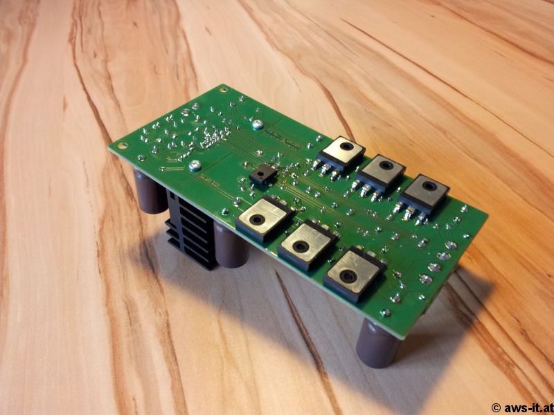

Hi Tony,
Lots of $ invested in this hobby. Even going for the premium 200V devices, planning on some high rail voltages?
I used the alf16n(P)16W (one pair) with the LME49830, set the bias at 150mA, needed more HS for bias higher. it was opc latfet amp, with a few mods. Put them in a old sansui G-7500 and a Pioneer SX-1050 PS. I can pump it into the 120W range. Works, sounds great and measures okay, fast at 600ns rise/ 650ns fall times, no ringing.

Hi Tony,
Jup - here we call it Euro.
Currently no real plan to use higher rail voltages. Maybe a bridged / balanced high power variant of SA2014-circuits delivering 1000W@8R for my 3-way active crossover mono block tower amplifier...
What you don't know - there exists also a SA2012 - a high power LME49830 MOSFET based 4 channel amplifier which I made 2012. Capable to drive 190W@8R continuous using 3pairs IRFP240/IRFP9240. Sounds very good and is my fallback, if SA2014 will produce holy smoke ...
