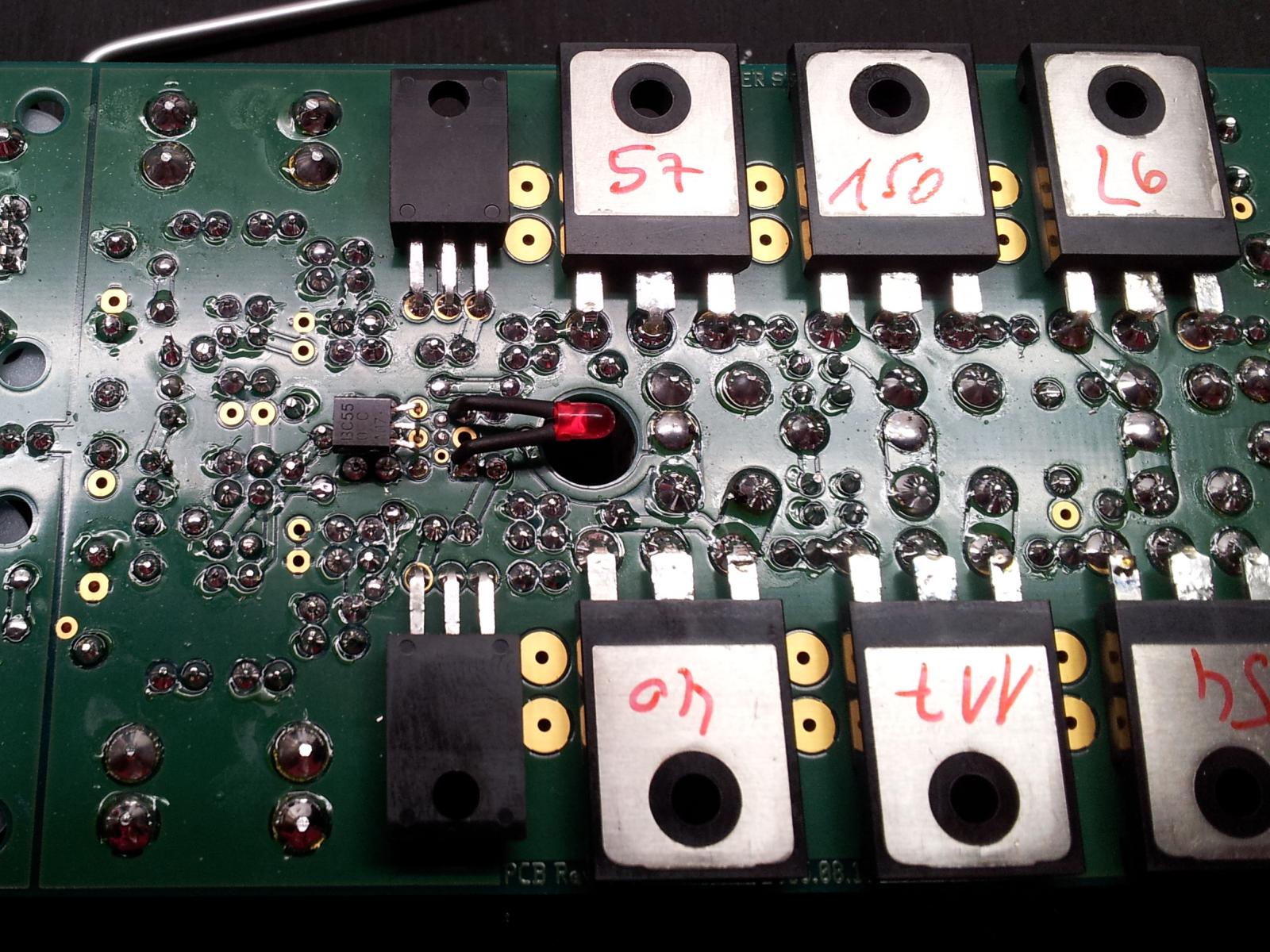

  • left: test-mount the transistors and solder them
  • right: temperature sensor mounting detail
BR, Toni

... ready for take off ...
4 channels finished.
3 channels where working out of the box, the 4th has had 1st CCS LED reversed - took me 15 minutes to repair... 🙂
THD quick test shows that all 4 channels have nearly same low values.🙂

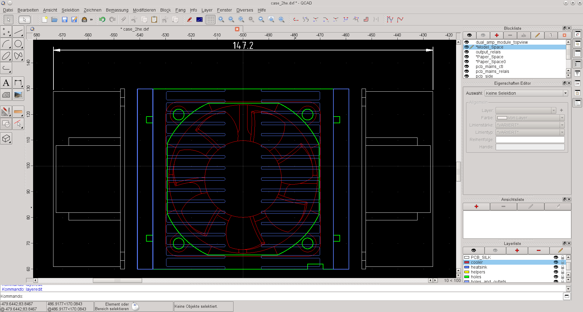

Nice bulid. My only observation, is that You can reduce the noise, and increase the airflow if You keep some distance between the fan and the heatsink. Generally 5-10mm is enough.
Sajti
Sajti
Dear Sajti,
THX! Maybe you are right for the most standard fan's...
This is a flow optimized ultra low noise fan (8.2 dbA). I have done some noise checks before designing the fan holder. The current distance fan to heatsink is about 3 mm.
Attached a cad front view of the fan/heatsink unit.
BR, Toni
