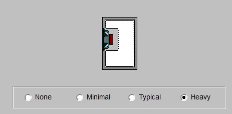

50L would be a dream. But can you tell me a little more about the stuffing?

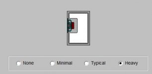

This is the image from Bassbox that shows what they call Heavy Stuffing, filling pretty much the entire box with fill of some kind. This has the effect of increasing the apparent volume that the driver sees. So if you want to use a smaller box fill the inside of it and it will behave as a larger box.
Troels Graveson estimated about 25% extra apparent volume in the tests he did. I ran some impedance tests myself on various stuffing schemes in my line array cabinets and relatively low density fibreglass with a layer of felt on top worked better than any combination of other materials that I tried. Polyester stuffing will work for the volume but I prefer the low density fibreglass myself.
I have attached a pdf Printout from Jeff Bagby's woofer Designer. for the 12BR70 You can see that the standard Vab is 139 litres but at 50 litres with a lot of stuffing Qa = 10 the Q is 0.77 and with a Linkwitz Transform you can be flat with an F3 of 30 Hz at 100dB and not exceed xmax or power rating.

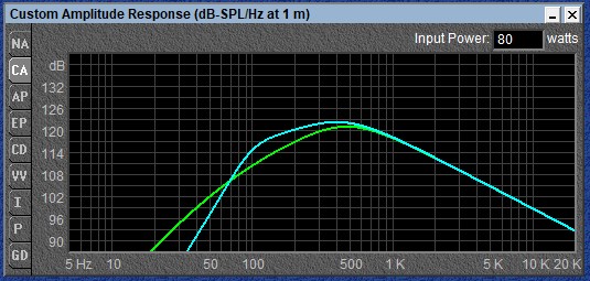

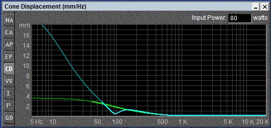

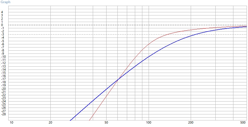

The 12PE32 seems to work OK in a closed box to me. This is vented in blue vs closed in green. EQ to flatten the response still leaves enough output to match your 4 subs and a 12dB electrical crossover would give 24dB acoustic at about 80Hz to match your subs from eyeballing the graph. They both want a similar volume around 15 to 16 litres net so you could try both by stuffing the port or making the port removable and adding a cover plate.

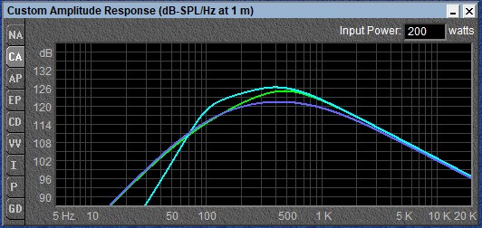

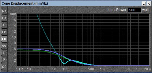

Faital 12FH320 gives similar response but has much more xmax, still not exceeding xmax at 200W input in a closed box Purple trace.

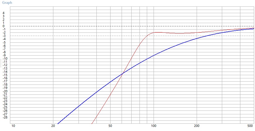

I simulated the driver with 30L and tuned to 85hz (recommendation from B&C). The blue line is the closed box in 30L. The difference looks pretty big just from looking. I know what happens in my room but still... The second is 15L in both boxes like you simulated and the difference is not that big. What do you think? Is 15L better to match the subs?
I would prefer to EQ as little as possible. The 12PE32 is set because it works perfect in horns for a later upgrade. And it has nice specs like the low mms which might be helpful for the mids. Low xmax is the price to pay.

How much is the max spl at xmax the driver can acheive whith the Linkwitz transform please?
110 db ? 120? 105 ?
30L gives a non flat bass response from a higher Q, I think sealed will be much easier to integrate with the subs and the difference is not huge but with low xmax the extra bump might be worthwhile.
