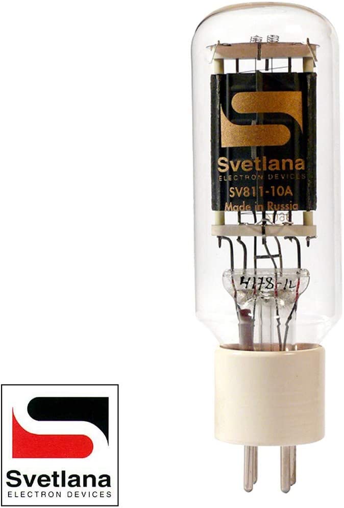

SV811-10, gives you a mu of 10 for the output, a DHT that was designed specifically for audio. There are NOS examples still out there on ePay etc. If you don't insist on max possible power output and are prepared for 800V of B+ you don't need A2, you can get decent output in A1.
I've heard it in A2 driven via IT with a high gm IDHT driver (6C45P) at 300B kinds of voltages and it sounded just fine.
I had all kinds of good tubes at one time, which I stupidly sold because I wasn't using them at the time. Like quite a few EL50, 4654, and indeed some SV811-10. I'm not keen on building with voltages much higher than 300v, something I avoid. But you're absolutely right to bring it up as an option. 211 likewise.
