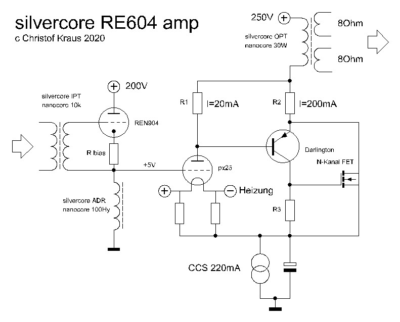

Andy,
As you have moved on from a dht driving a dht, and have considered op amps, have you considered other hybrid topologies?
Check out the Silvercore blog
Der silvercore “Collectors Choice” | silvercore Blog
They write "JC Morrison, Dave Broskie and Frank Blöhbaum invented it at the same time, the principle of the “Supertriode” or the “NeoHybrid” circuit"
I'm sure Ale would be able to help with the design.
