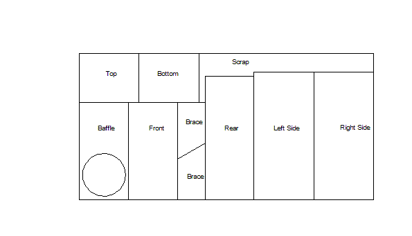

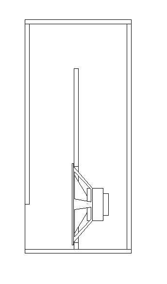

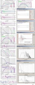

and btw, the hole in the baffle needs to be at least one inch from the edge right ?

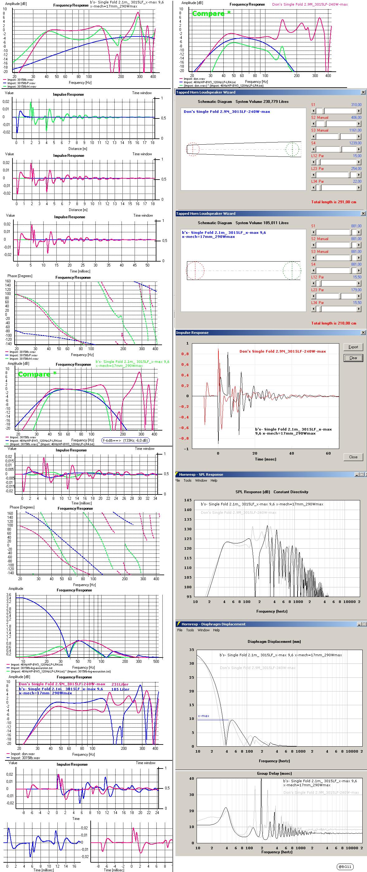

wonder how would one of the 18 faital pro woofers stack up in this design?

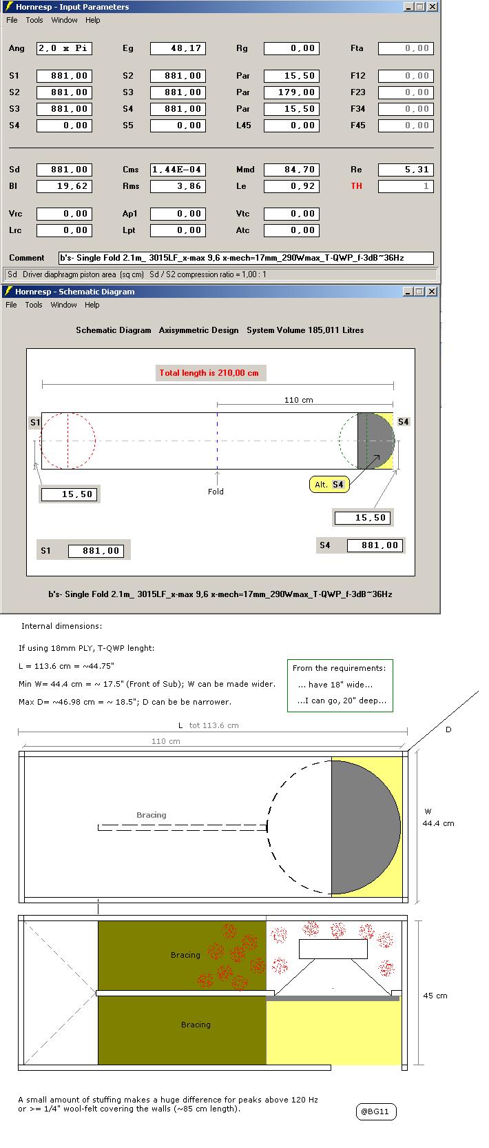

18" Faital Pro drivers are to large to fit.. but if other dimensions are used:
b
@maxx....not really a matter of liking B&c or 18sound....it was just that i noticed the faital pro's were approx same price here in usa as the kappalite 15lf...so i was just figuring 18" vs 15" @pretty much same sensitivity would yeild a louder box

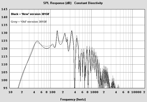

...thanks bjorno for the data , i suck @horn response

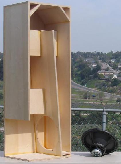

- 3015lf TH @ 35-40hz but only 20" deep help
