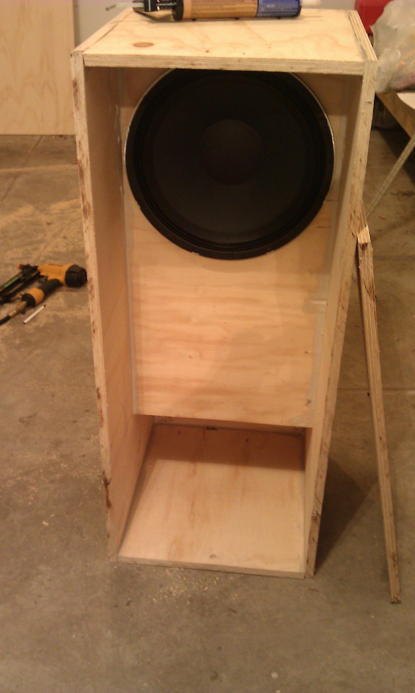

You should throw away the hyphen; it looks ungainly.Yes, It's that simple, This week I'm gluing a very similar sized box (T-QWP) using the same driver for a friend to be used in his recording/mixing studio.

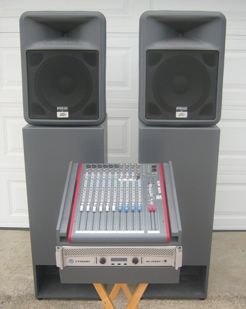

My PA is:
Alan Heath Zed 14 (mixer)
Crown xti 2000 (amp)
2 Peavey PR12 (for tops)
2 Bjorno subs (as listed in this thread)
The xti is set to cross-over at 100Hz, with the Bass Boosted 5 dB and
HiPassed at 30Hz and the tops cut at 16 KHz.
I chose not to use the ss15 because I really wanted 32 Hz and was willing
to accept loosing 3dB of power to get it. In retrospect, that's a high price
to pay for 5 semitones of bass.
Everyone loves the sound!!!

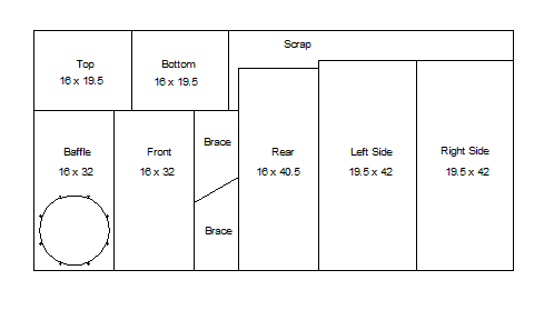

Don what plans are those , ohhh i see noe, you posted a plan and a cut listMy PA is:

those look very easy to make for a wood newbie
can you post some measurements out from your prototypes ?
do you paintes them with duratex ? they look PRO !!!! and you matched the color of the Pr12
so i think i dont need more than Pr12s and a pair of the subs

Plans? Post 23
Measurements? Compared to SS15, down 3dB
Paint? Latex House Paint ... Duratex would be much better. House Paint
looks good, but needs retouching after only 3 months.
Power? 200W into each top and 400W into each sub yeilds 125dB/1 meter
measured as 105dB/10 meters. The Subs are louder than the tops.
Braces? I didn't use them and it still works well.

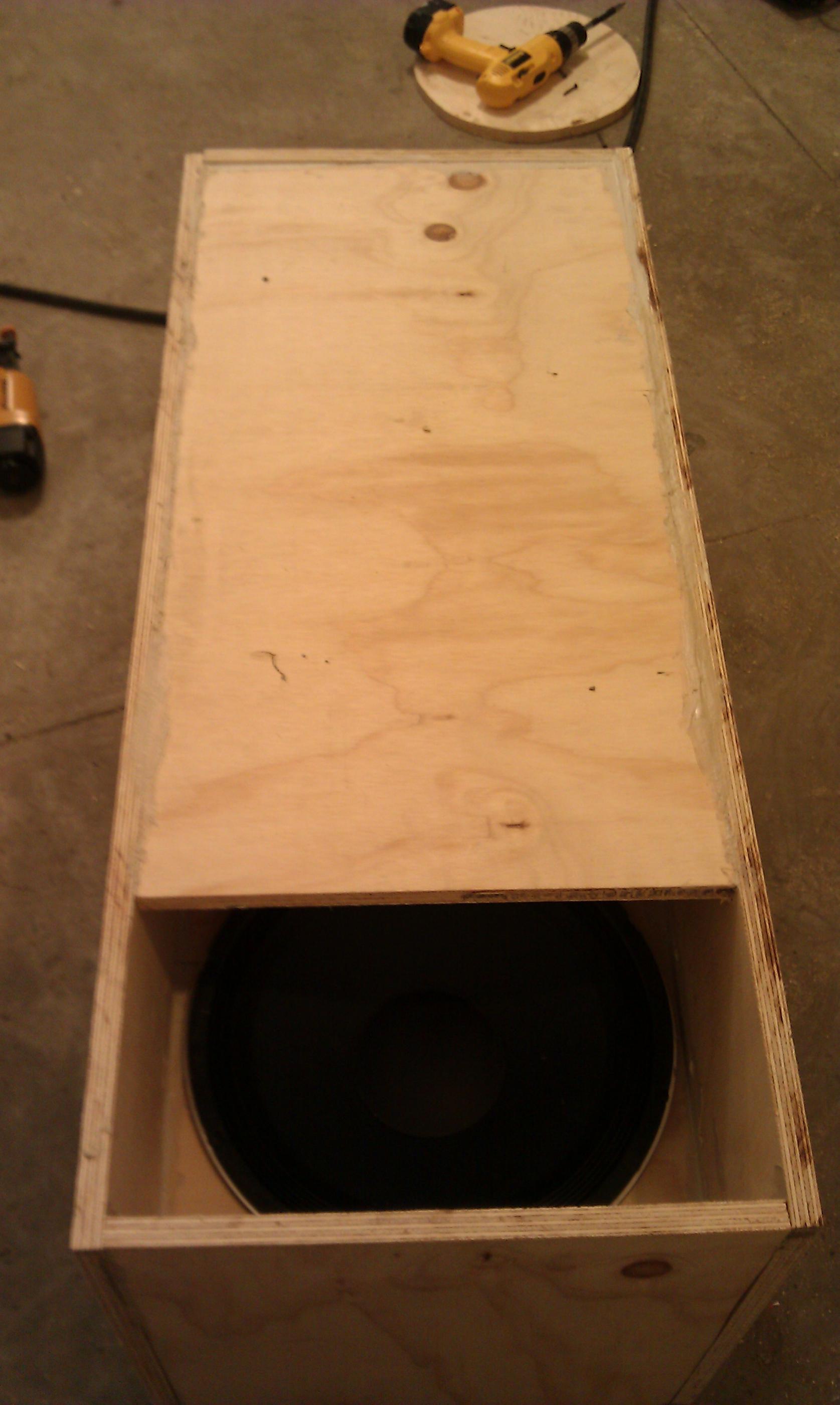

how the box will work if you remove the front panel
if you can see the front panel covers half of the woofer if you see the box
facing you
does that thing makes some kind of reflections ?
or is part of the waveguide for the tapped horn thing ?
also i see 2 braces on the cut sheet diagram you made
where are those braces needs to be installed
