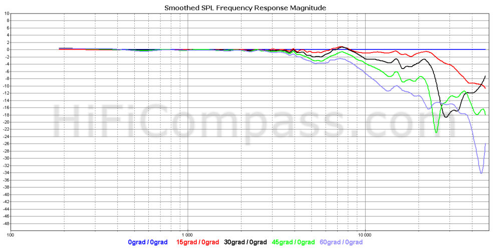

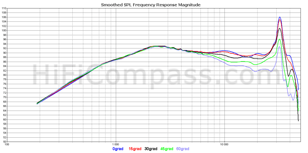

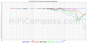

I'd advice you to study different tweeters, measurements and off axis curves.Those drivers are different from the ATC you will find less xmax, and a higher fs around 450h,
Z, vs the ATC's 300 ish.
As for tweeter the dome shape might make more difference then the 21mm vs 1" actually.
For the tweeter dome shapes, do you find a better ones with better shape and larger diameter than Scanspeak D2104/71200?
You will find that the dispersion is not reliant on diameter alone is all.
Look at the attached ones below from Hificompass.
You can see the 1" T25 (with al/mg diaphragm though), has a wider dispersion and better behaved off axis all the way up, vs the 2104.

A small tweeter gives wider dispersion not better dispersion. Better dispersion in a technical sense is more like smoothly controlling the variation in beam width with frequency to get as close as possible to a neutral timbre in use in a room. Of course better dispersion in an audiophile sense may, quite reasonably, mean whatever sounds good to me which may well be a rapid move to wide dispersion at high frequencies.
