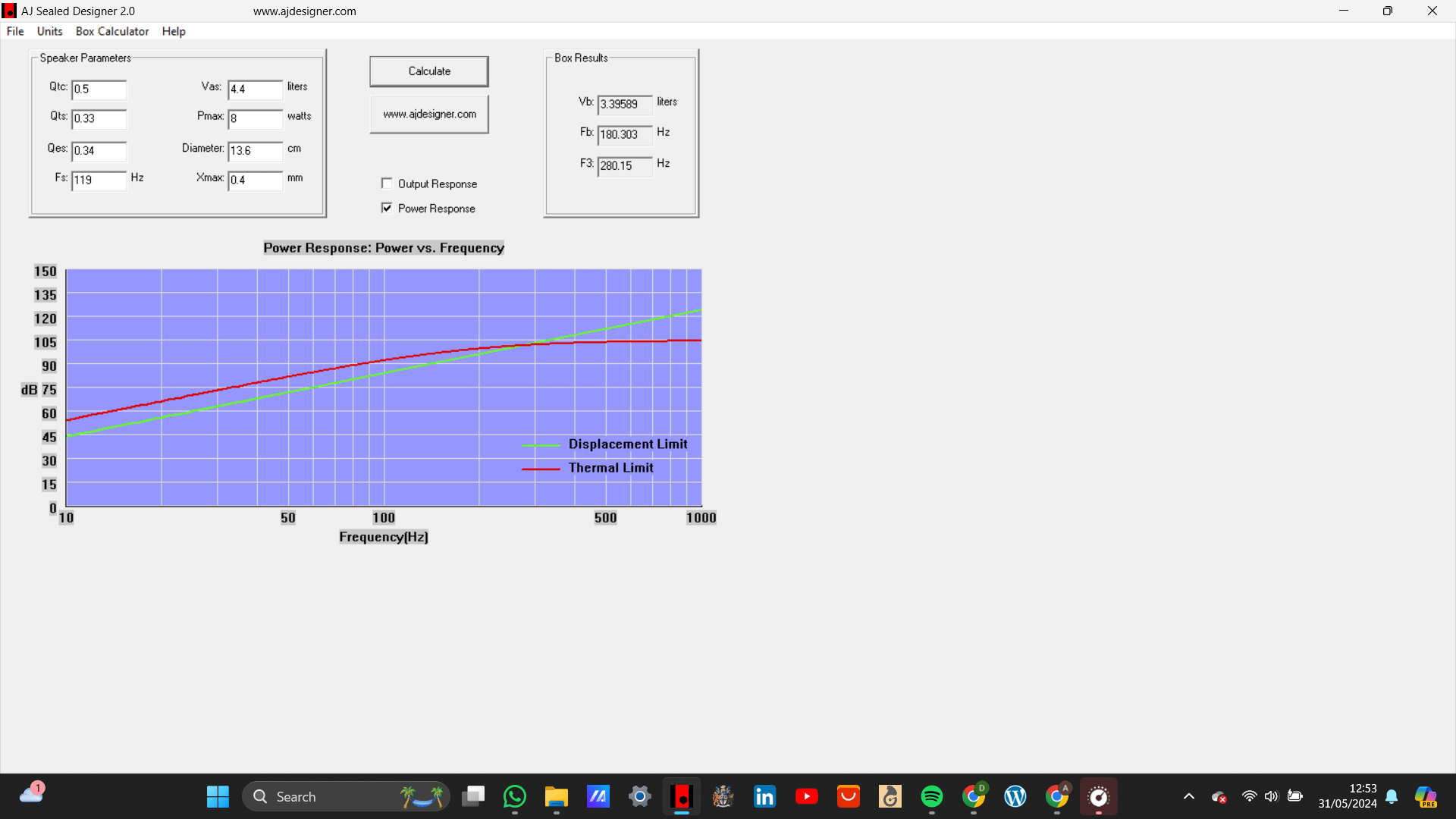

Oooops, I was just told I missed out a sim on my PDF here is the missing "4th Sim" showing a single driver holding 103 dB @ 1 m with 8 watts which is just 4% (!!) of its AES rated continuous power. A pair in room will hold 106 dB at one meter with vanishing low distortion.
Crucially the cone movement is just +/_ 0.4 mm... Less than 14% of its Xmax!
This demonstrates the advantages of "a good big one Vs a good small one".
I believe minimising cone travel & input power to achieve a given SPL (106 dB in room is very loud!) are mission critical for realistic sound reproduction.
All forms of linear, non linear and thermal distortion (power compression) are minimised or eliminated and the most offensive of all distortions, Time Domain distortion is drastically reduced.
When choosing any driver I would urge you to carefully compare two key points:
(1) How much cone travel does it require to meet your target SPL in room over the frequency band its covering?
(2) How much power does it require to meet your target SPL in room over the frequency band its covering?
Remember point source SPL reduces by 6dB per doubling of distance so 106 dB at 1m = 100 dB at 2 m and just 94 dB at 4 m listening position.
