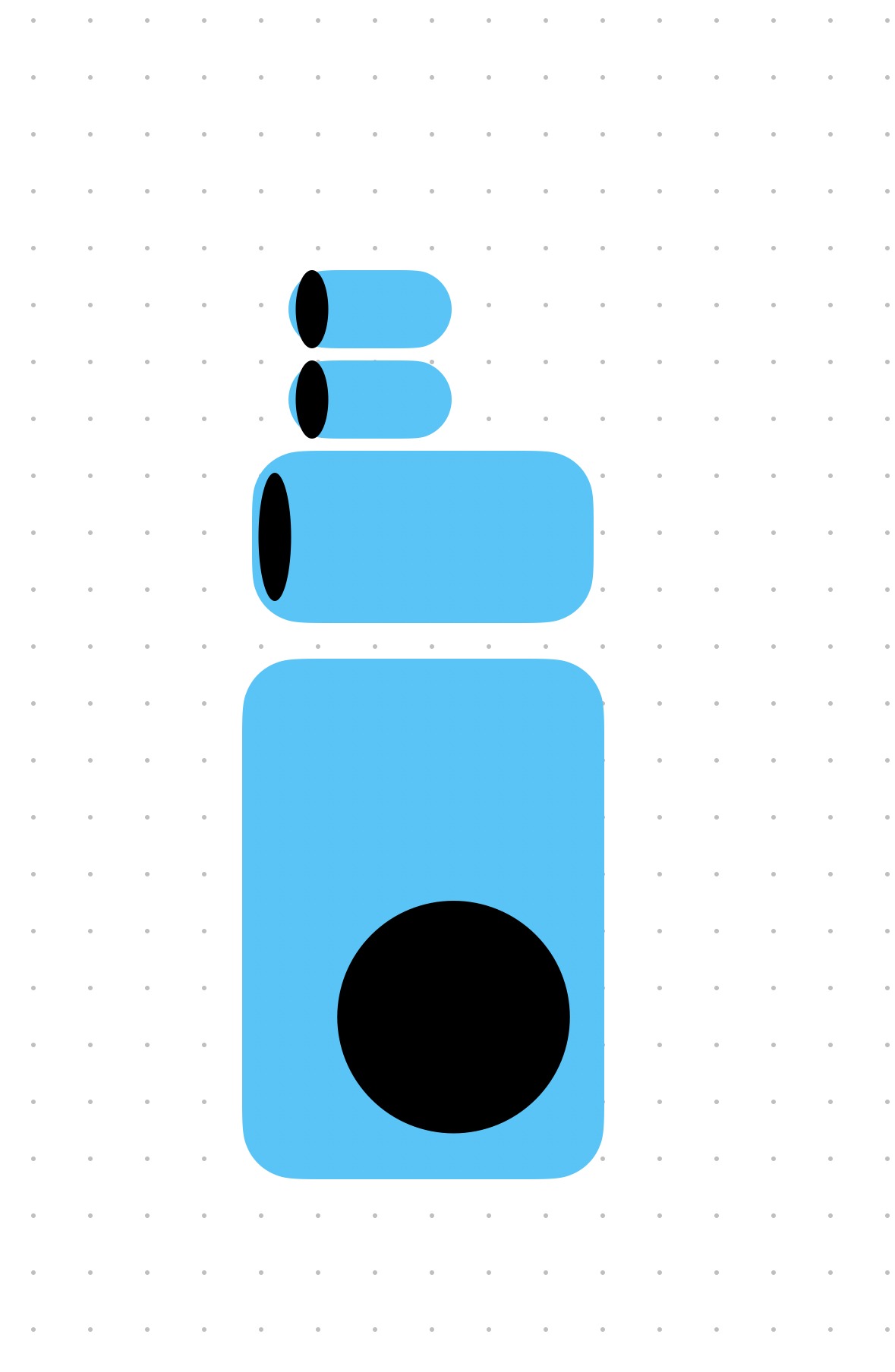

Looking at the high level design this is a narrow baffle tower with two or more 8 inch woofers, an upper mid dome and a dome tweeter.
There are a few decisions that need to be accepted here. If you plan to use 8 inch woofer then yes the Satori dome mid is necessary for a 3-4 khertz crossover to the tweeter.
When ready your side firing bass module will cover frequencies below 100 hertz. This will be actively crossed over to the main module.
The main loudspeaker will then become a full frequency range mid bass system.

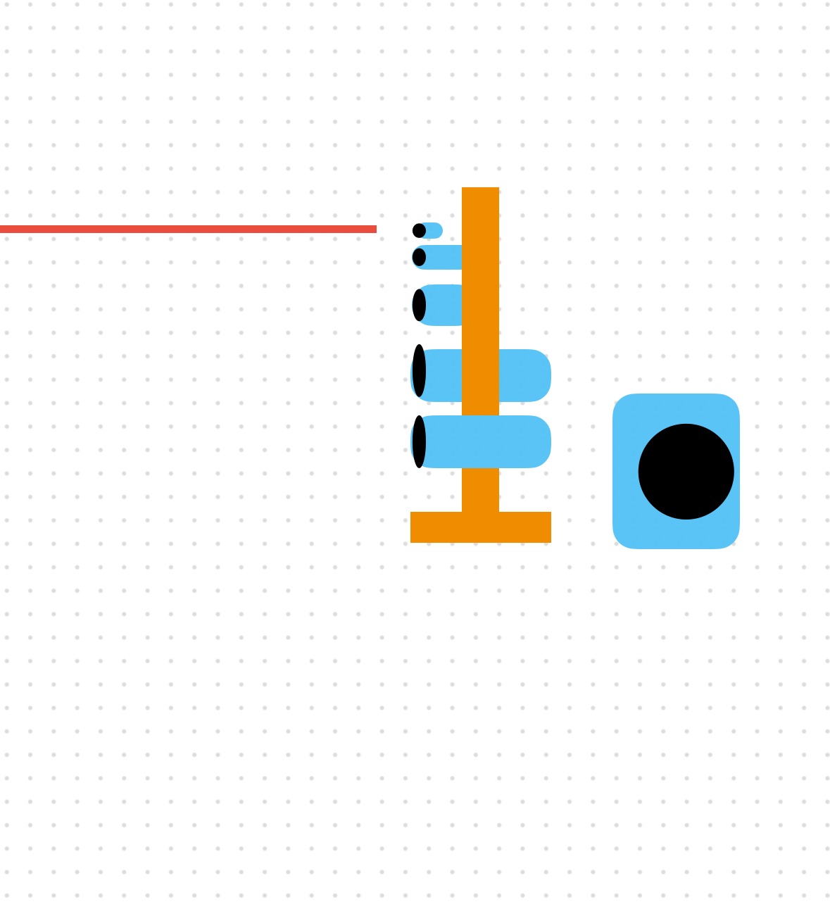

If you accept this path the group can go to work on it . It might look like this
29 mm Satori tweeter 4000 -20,000
2 1/2 Satori mid 800-4000 hertz
8 inch mid bass 80 - 800 hertz
13 inch side firing woofer
It would certainly be an interesting exercise and probably more cost effective.

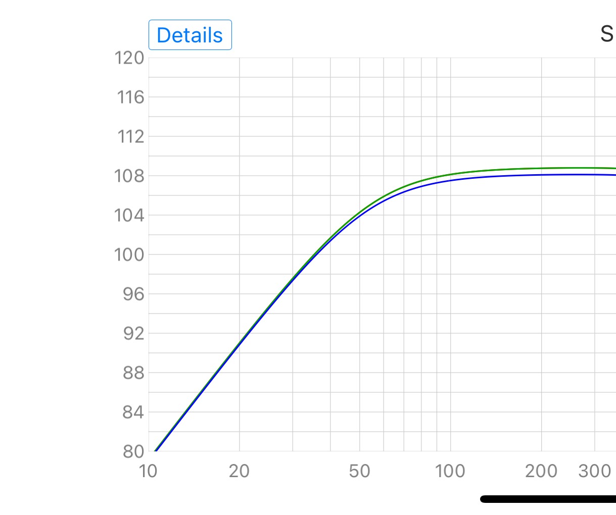

I'd say it's a subwoofer though it's not an ELF design, and would be a next project whose time line is quite apart from this project.

The 'bass' module covers down to some trade-off frequency(between volume and subjective performance/quality), below which will be covered by the SVS for now, and later by the side-firing subwoofer module.

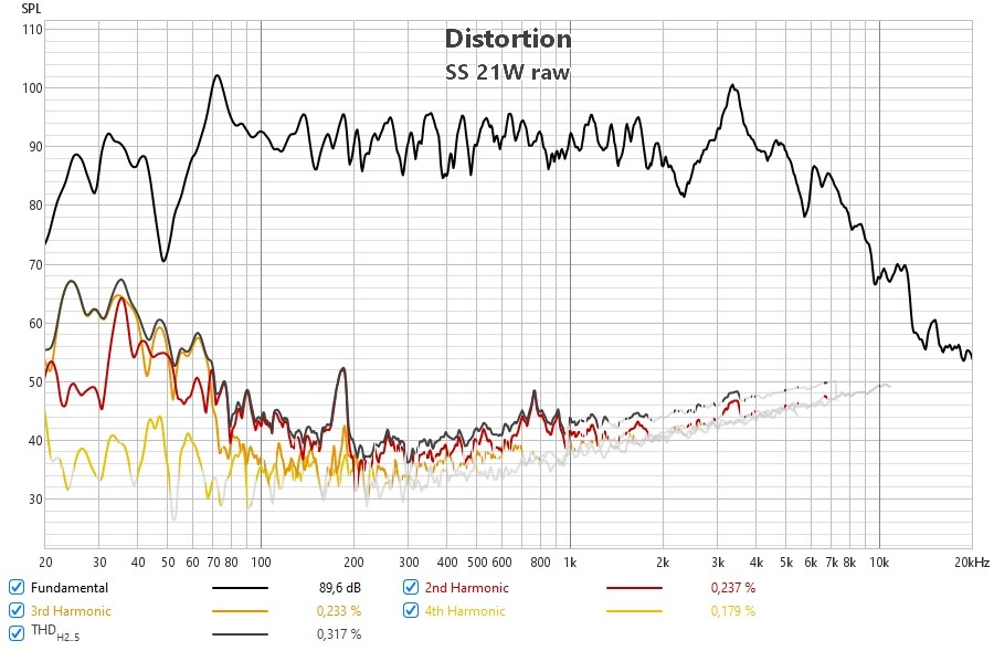

I can't answer or comment on others, but I was trying to get an idea what kind of volume or dimension for the bass box, so this is a welcomed, but also alarming number. Using with the SVS or future pass subwoofer module, I was also leaning toward a sealed enclosure. Is this volume for sealed or vented?
I guess it can be a bit taller, but that is almost twice as deep as mine right now. In order to leave some room for 15" side-firing subwoofer behind it, I guess it can't be much deeper than current 340mm(13.5"?)...
I am willing to compromise on the lowest bass to reduce the volume. But half of me is drooling on this 4-way one being as complete in itself as possible. Hard choice to make.

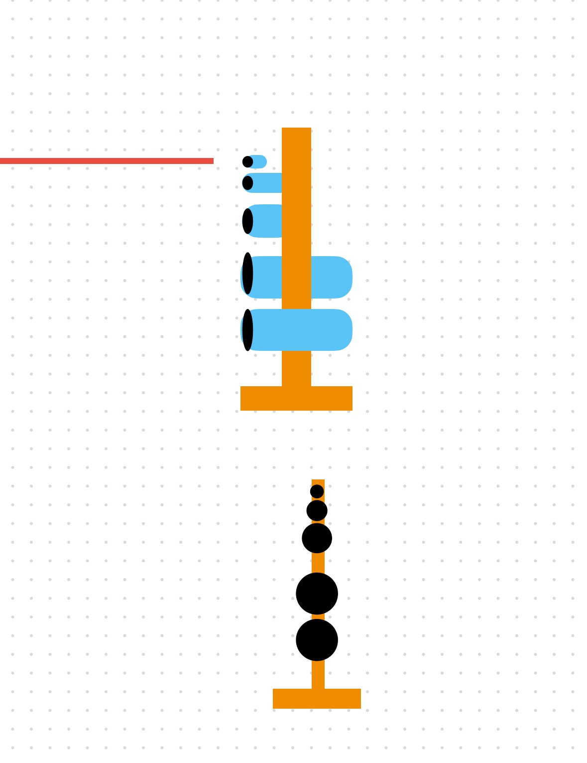

So, what I thought I have been saying here is:
21mm Scanspeak tweeter above 4000 ~ 5000
60mm Satori midhigh from (700 ~ 850) to (4000 ~ 5000)
170mm Scanspeak midbass from (150 ~ 250) to (700 ~ 850)
200mm x2 or x4, or 170mm x4 woofers from (40 ~ 70) to (150 ~ 250)
330mm SVS subwoofer below (40 ~ 70)

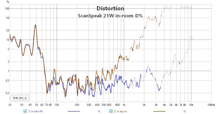

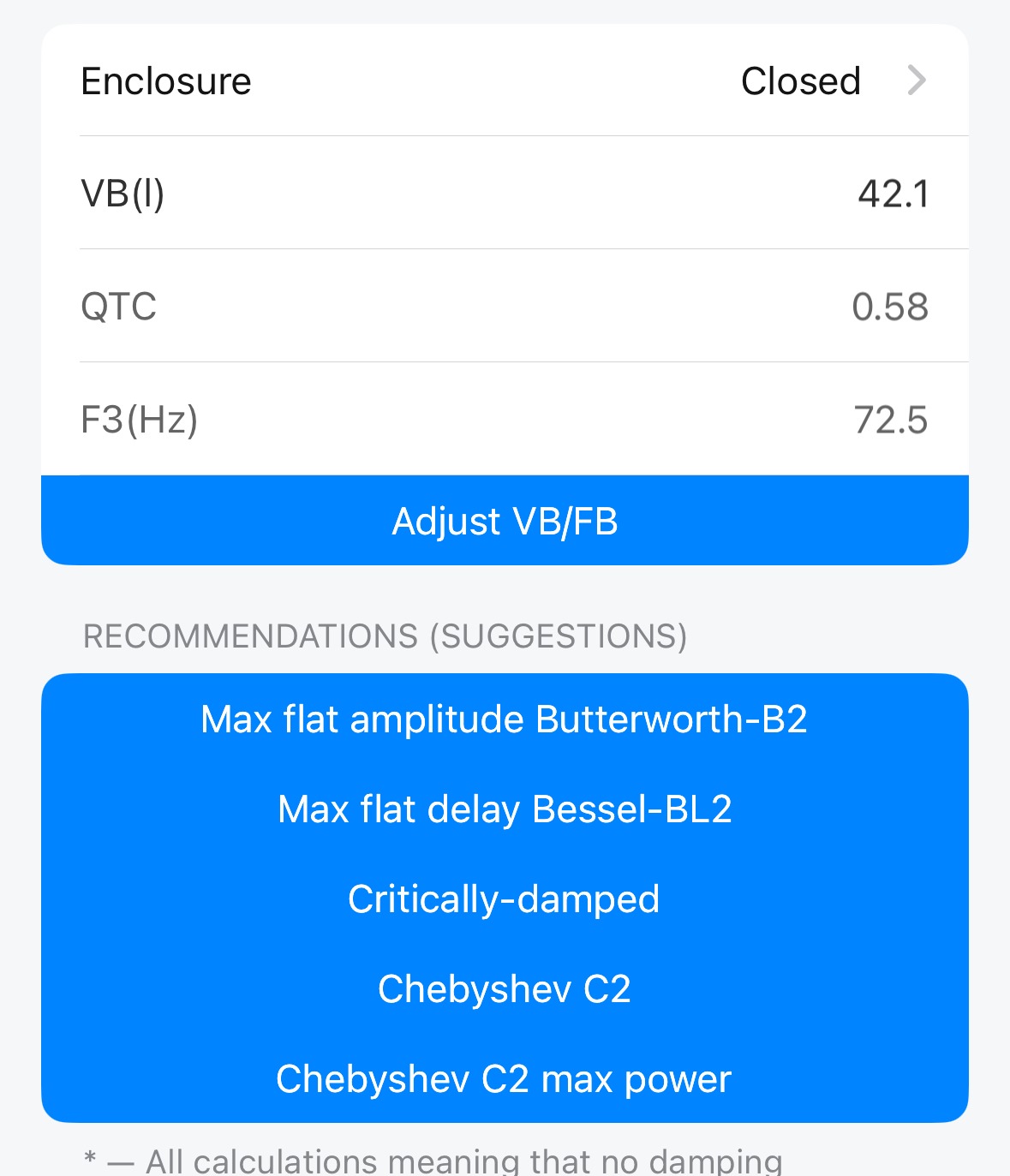

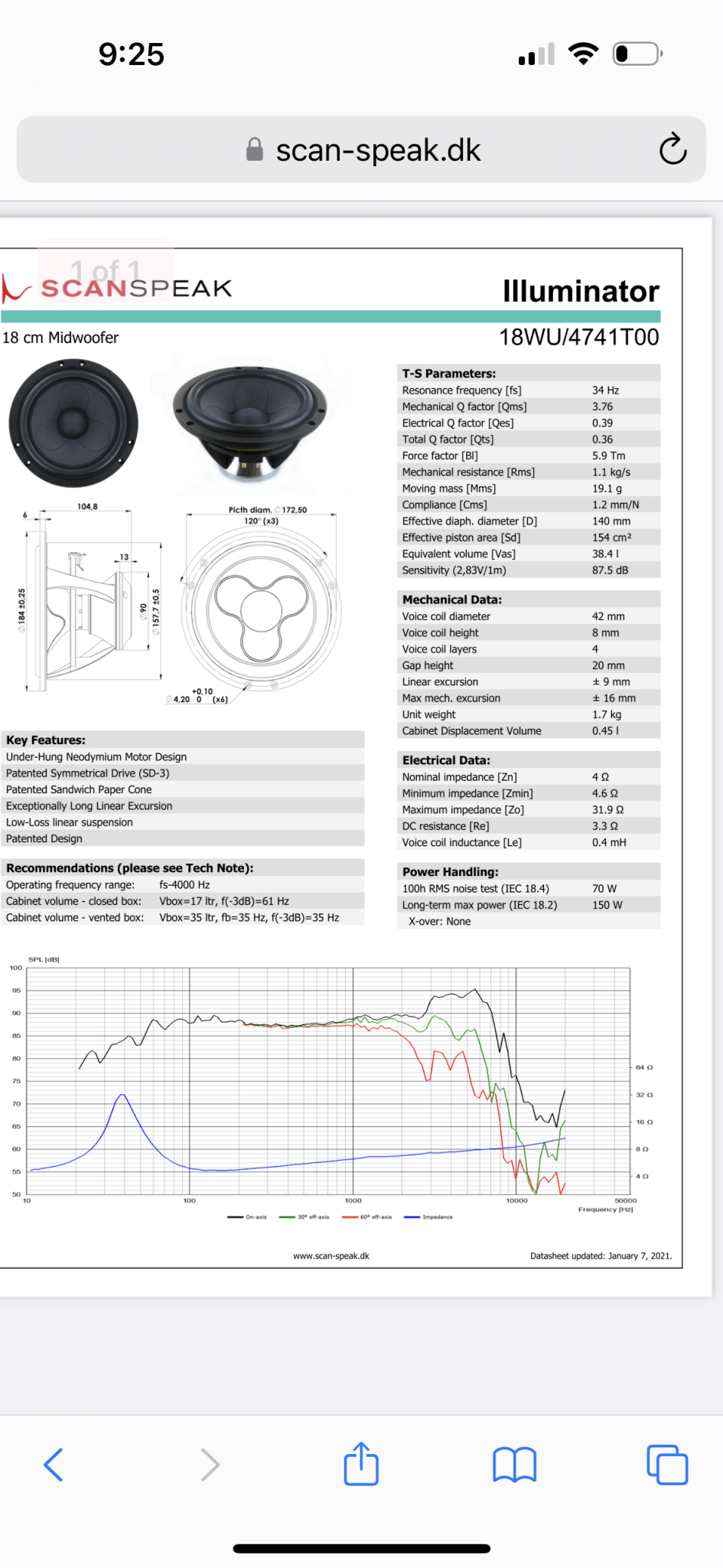

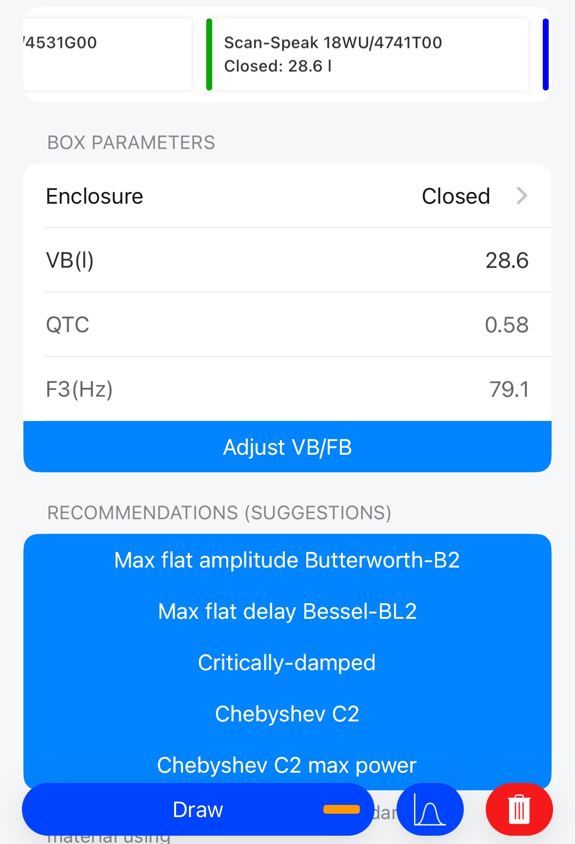

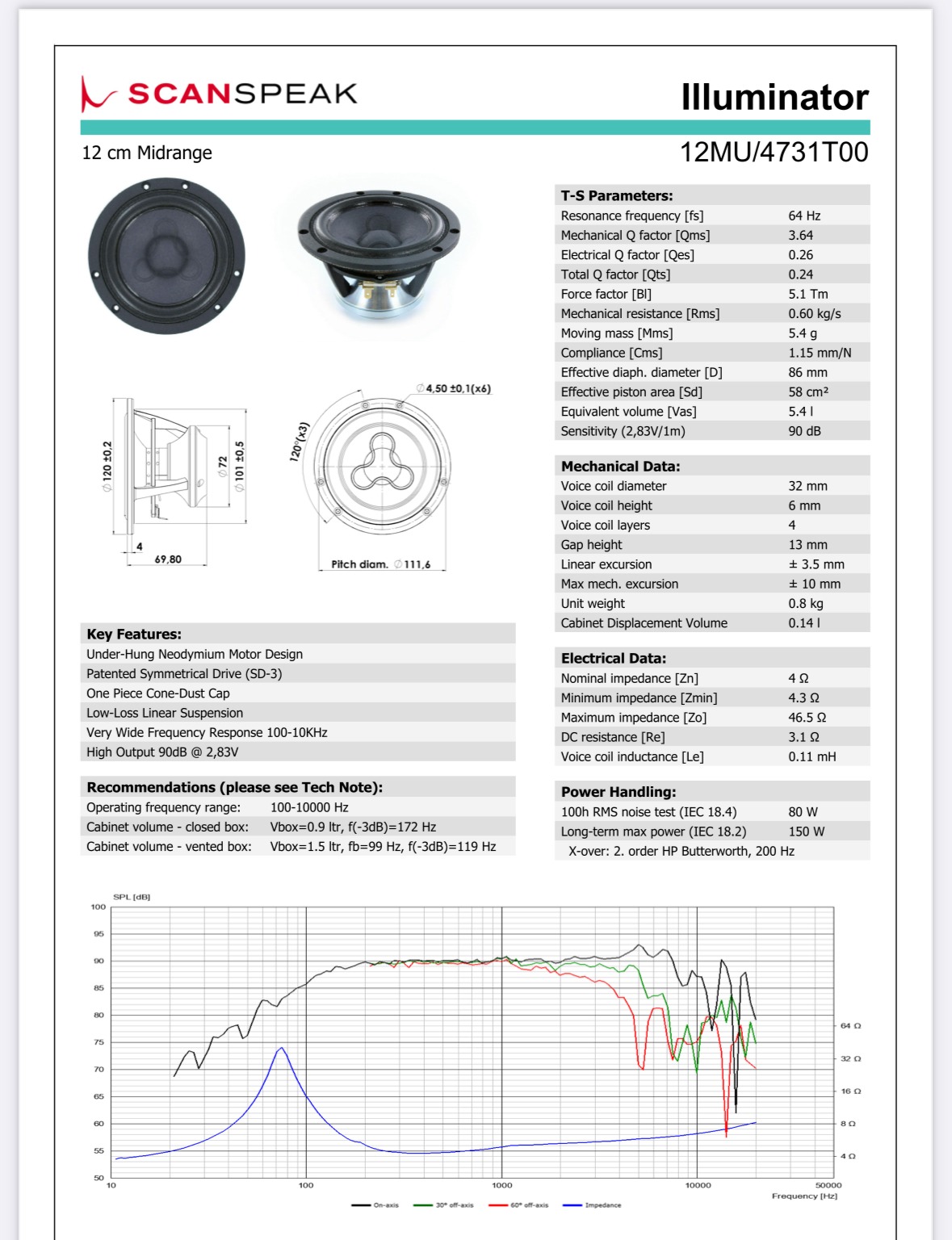

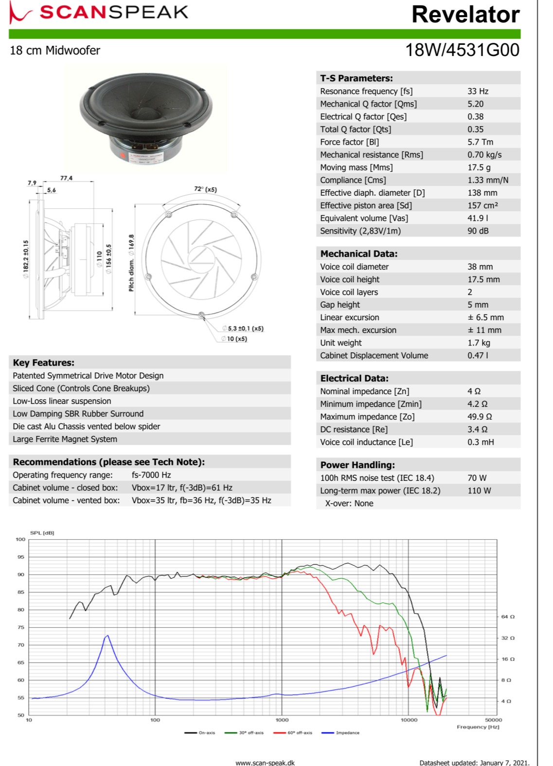

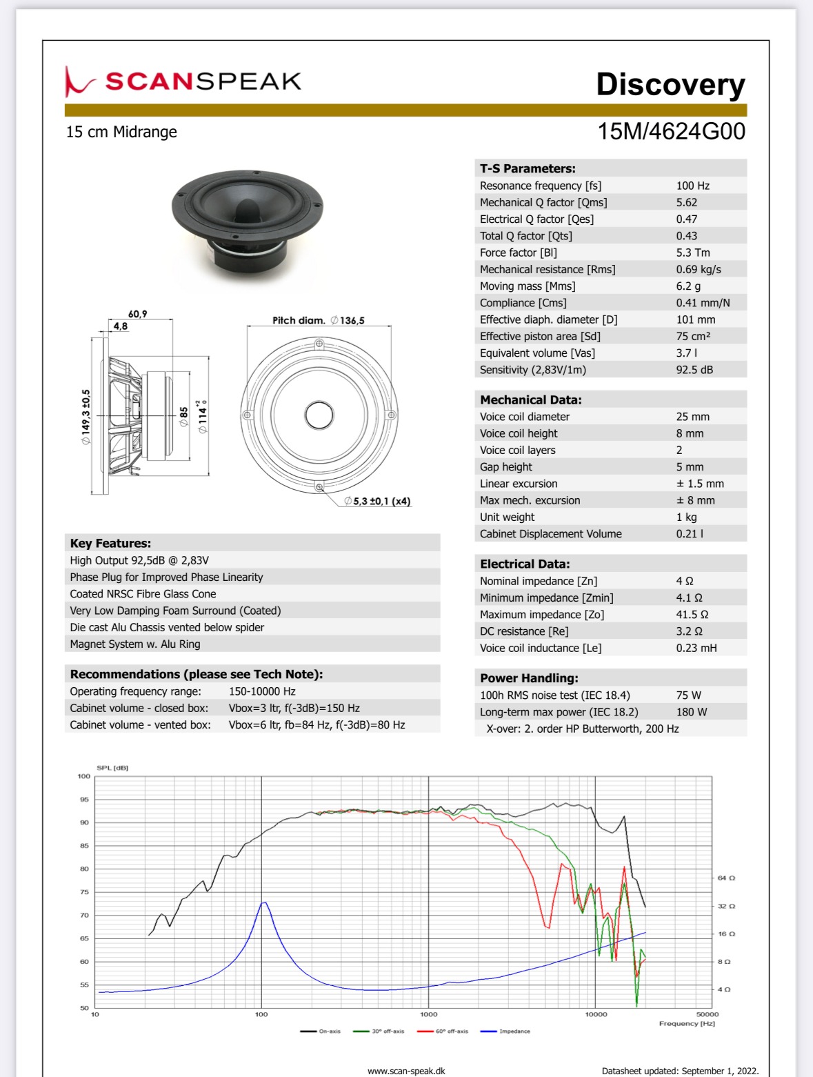

About the mid woofer l found Scan speak have quite a good range of mid woofers.
The lower the crossover point the more linear Xmax you need.
There are two potential candidates

If this is the case then you have a variety of mid range drivers in the Scan range to select from.
Because you are breaking up the low to upper mid range into different bands the rules on baffle step are not 100% certain. This is where you loudspeaker design simulator will be very useful.
In terms of mid range drivers it might be worth looking at the 12M or the 15M models. You can place it further up near the 60mm dome away from any reflective interference from the mid bass driver. The wavelength at the 250 hertz crossover is over one metre so you can place it near the Sartori dome.
My thoughts in a sketch
If this is what you had in mind cool.
You have lots of smart people here to offer insights into how to organise it all.
Remember this is diy and you’re going to have to get hands on with your tools. That is the fun part!
Edit l have attached the dual mid bass sketch. Dave Wilson is looking down at your project.

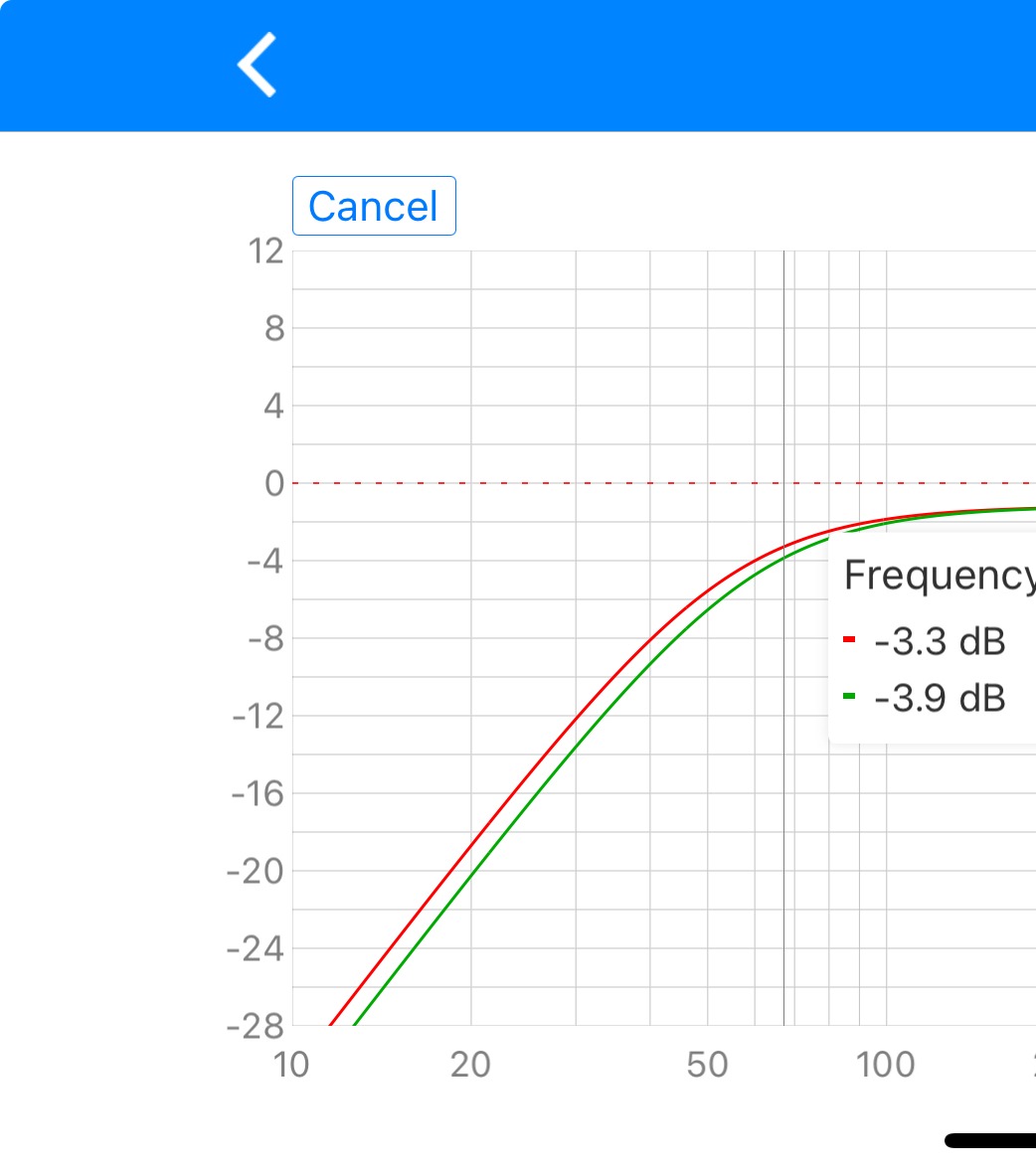

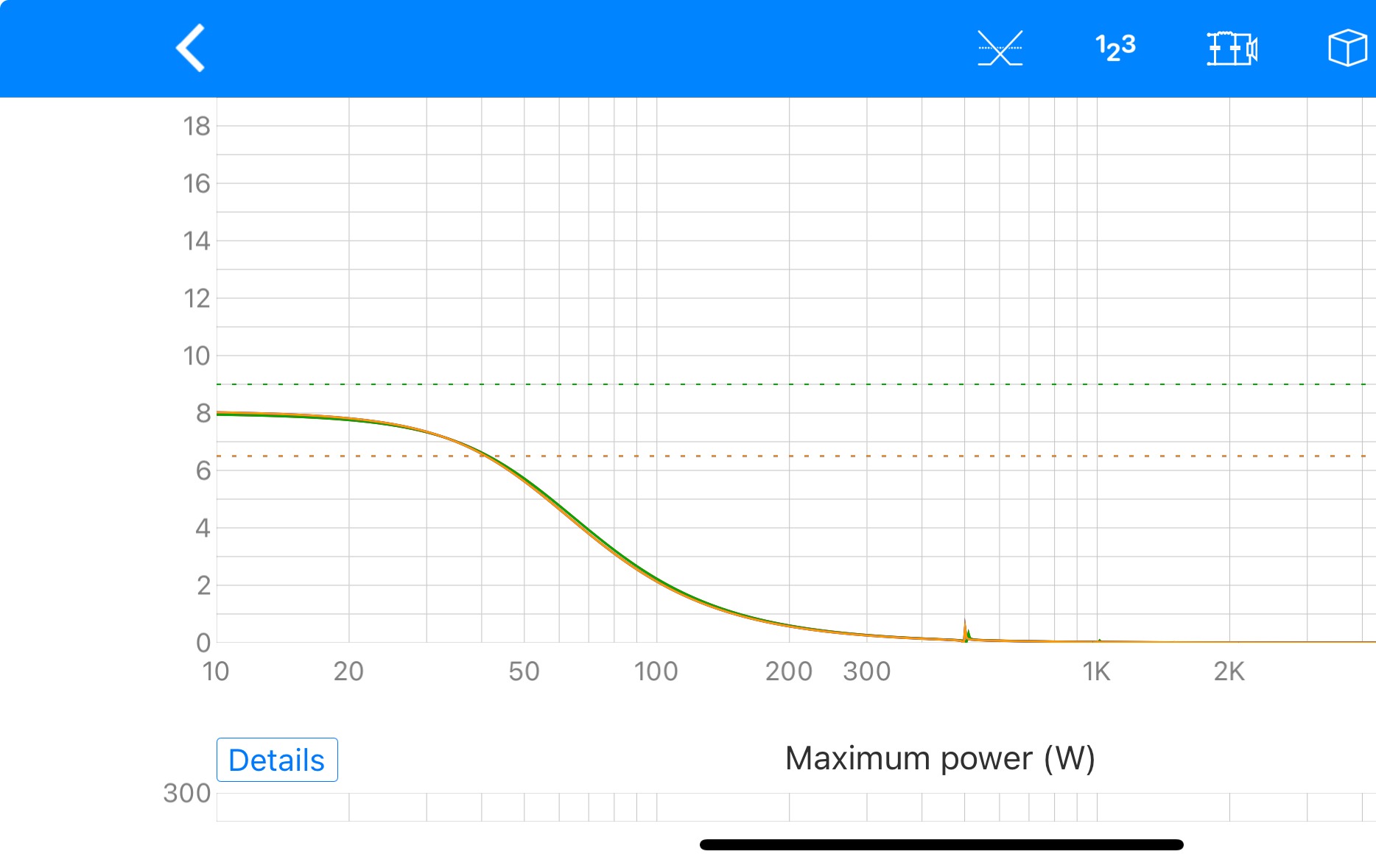

I had a look at the simulator for both the ScanSpeak mid bass woofers. The illuminator is the preferred driver as two of these only occupies 28L in a sealed enclosure. The Revalator 40L for a pair of drivers. . It also has a larger linear Xmax of 9mm. No doubt it costs more than the Revalator. The sensitivity is about 90 db for each of the models.
They are both rated at 4 ohm impedance. Depending on the baffle step simulation you might be able to run these is series electrical connection.
Either way with two woofers the output will increase by +3 db but the cone excursion will reduce to 1/4 of a single driver. If you can swing it get four of these babies because it will be cleaner subjectively.
Looking back at your driver line up you have a single Scan speak 170mm driver from 250-800 hertz.
Technically you may get a better integration with with of the 15M or 12M pure midrange drivers in my attachments . It’s simply that they are smaller and have lower mass cone than the 170mm driver.. The Satori 60mm dome has a low mass diaphragm so think about that. You can also place it closer to the mid dome.
All these points add up to a smoother more seamless transition at 800 hertz.

1. Probably not more but better. It seems to go low enough, and measurement shows -6dB around 20 - 25Hz. But subjectively, the big Scanspeak woofer(actually same size of 13") seems to sound more natural and open.
However, I leave this bass to the next project of side-firing passive subwoofer module to place behind the woofer.
Yep. After seeing advices from Alex and others, side-firing passive stereo subwoofers sound good to me. I was thinking of 13"/15" Scanspeak woofers, and some 15" professional woofers like JBL, Eminence, etc, as well as Volt 12" or 15". The big WAF advantage is that the big "ugly" drivers can be kept out of sight by its placement/orientation and the grill! 😉
