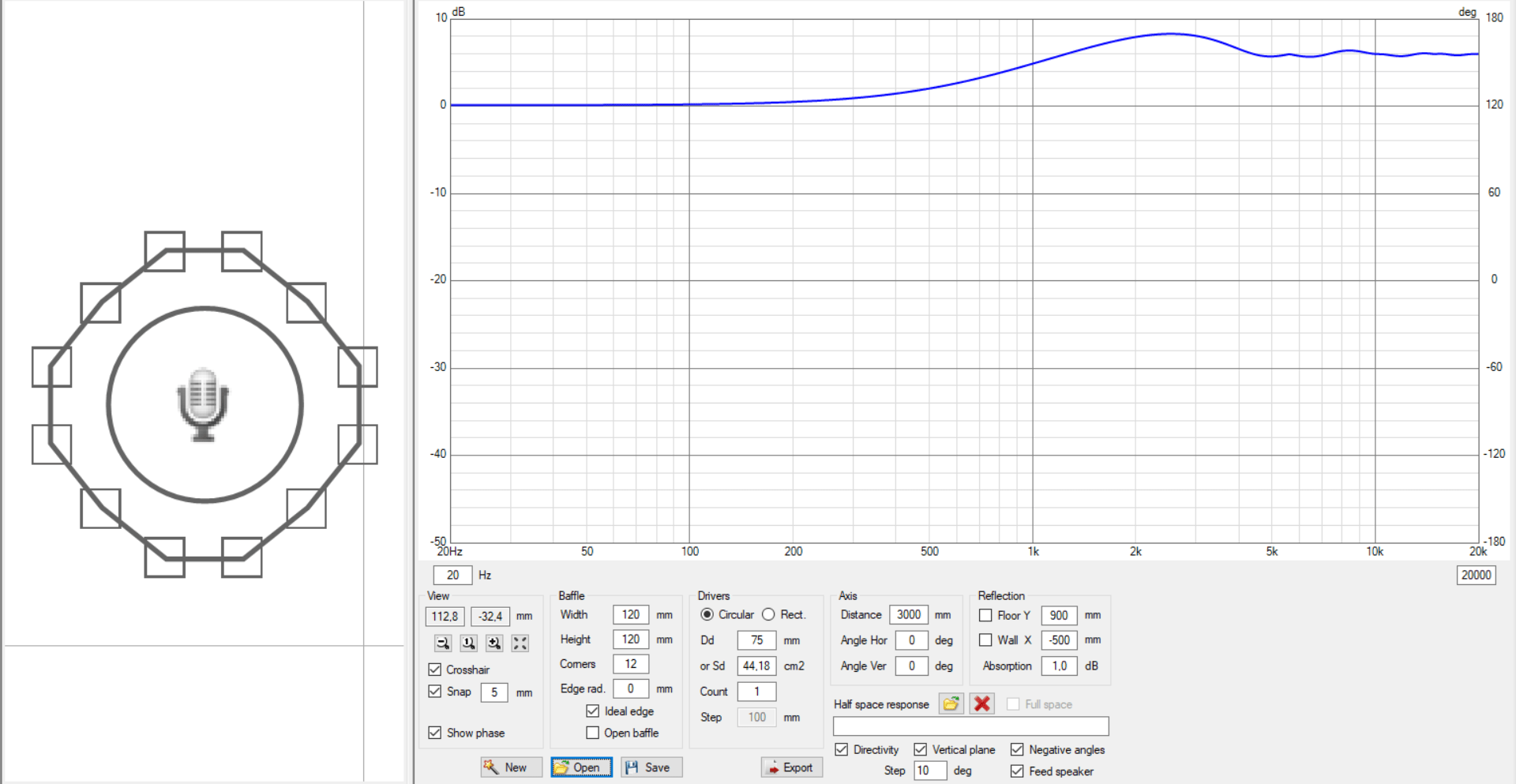

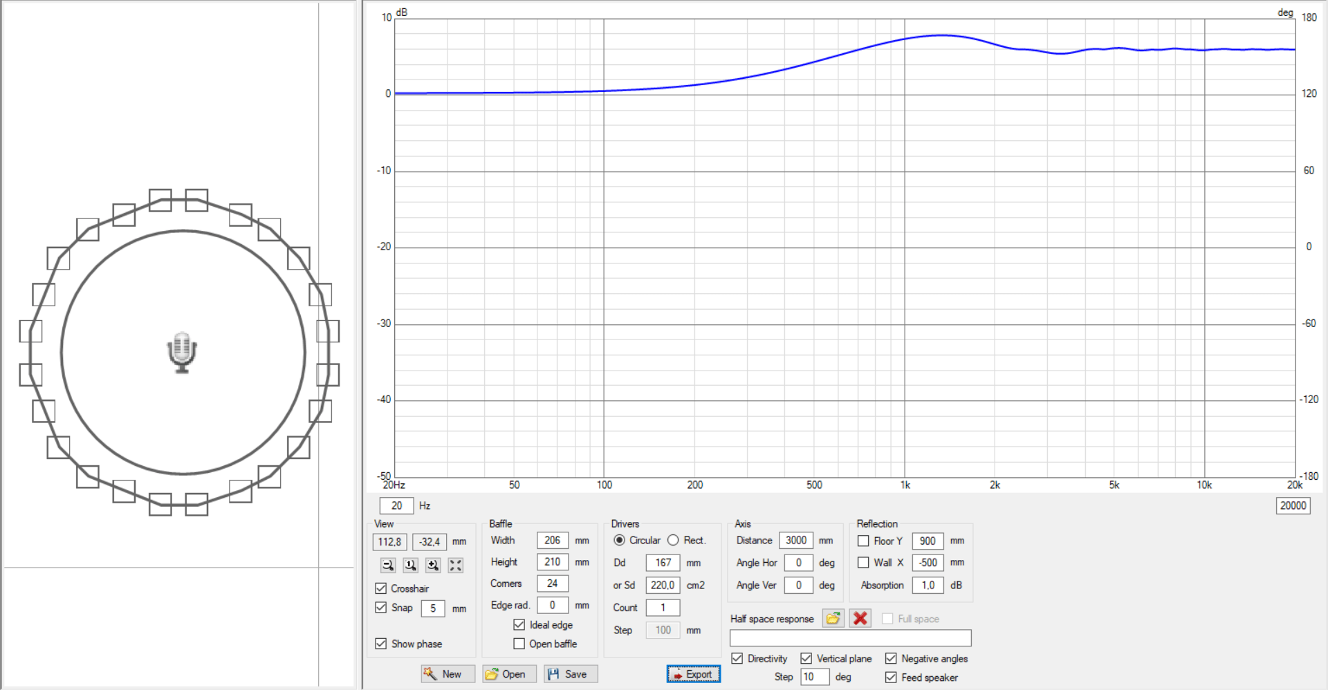

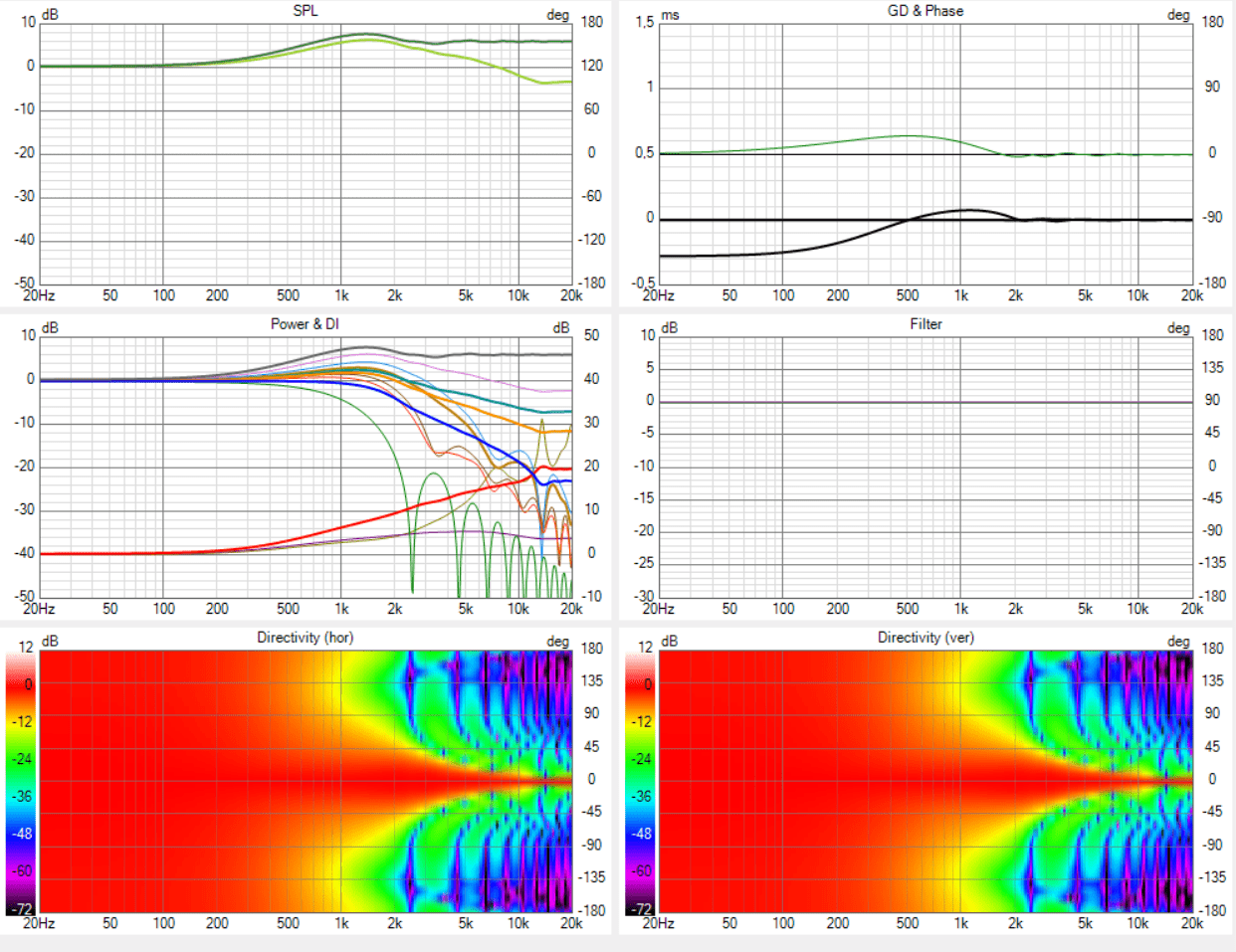

You can't make the baffle shape a figure-of-8 to approximate the front of a neighbouring cylinder? It would seem an odd restriction if not.

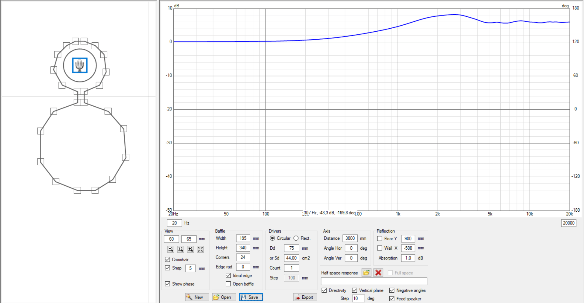

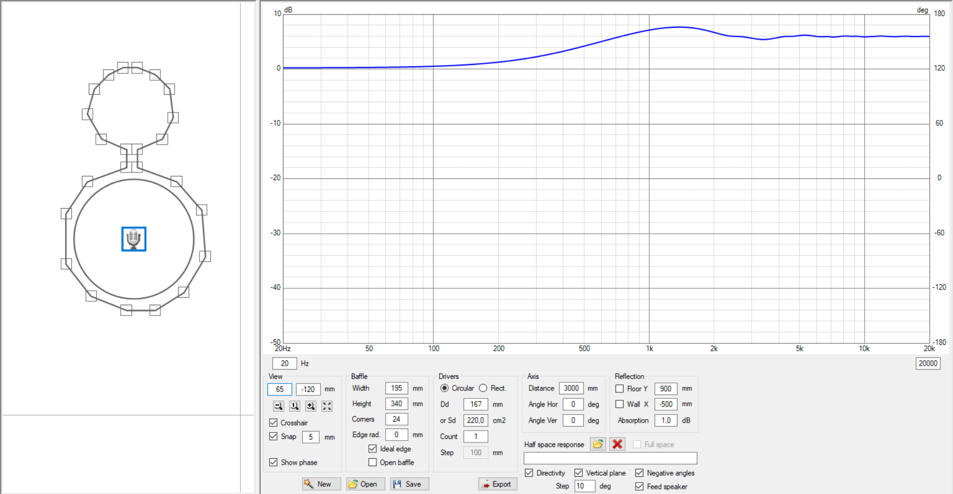

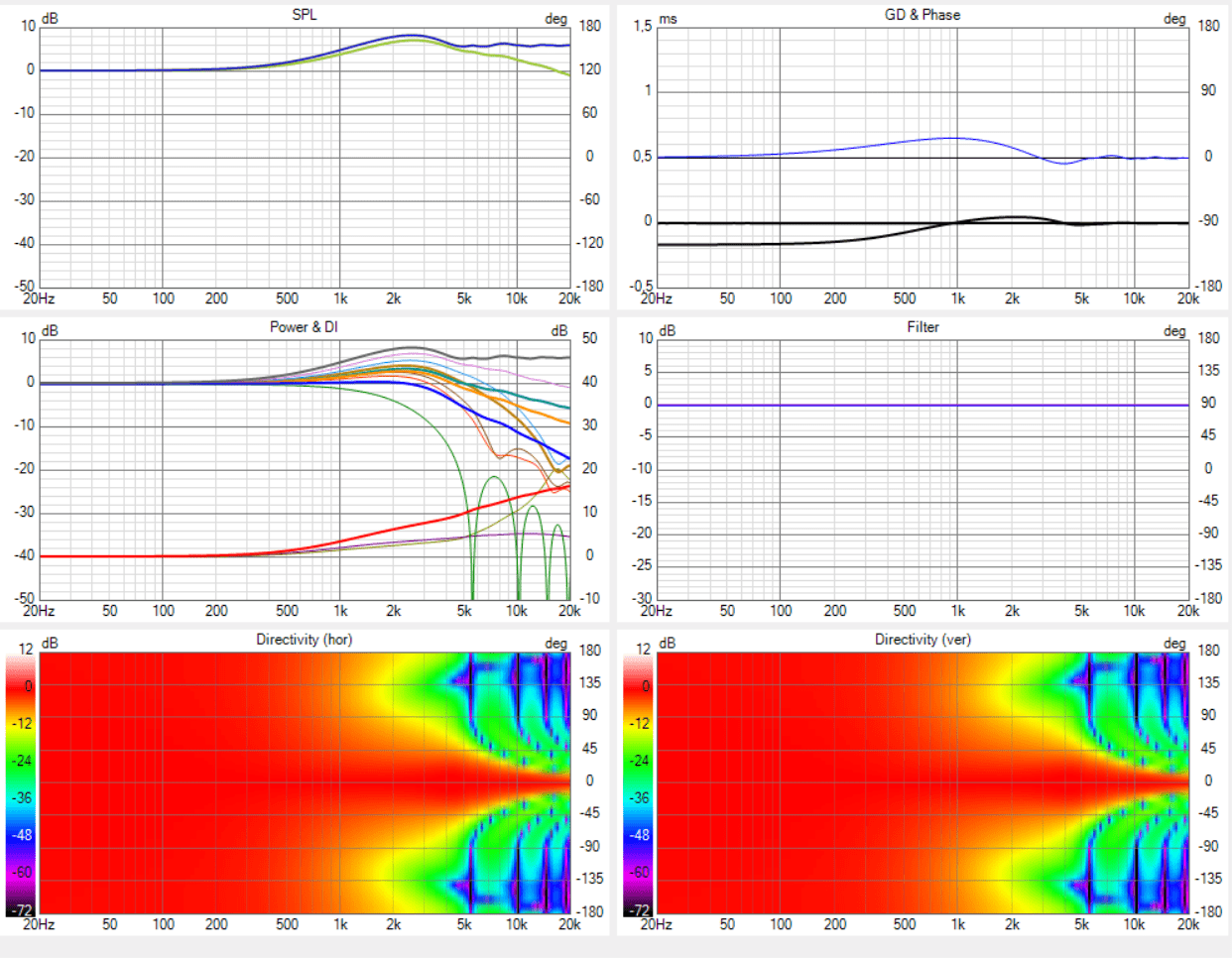

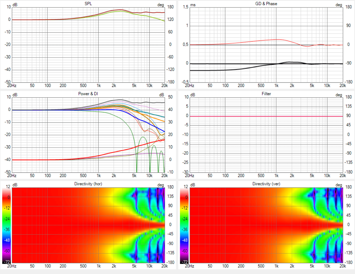

Hi, here quick sims with figure of eight baffle:This you could do yeah. In reality you could space them out a bit, not touching each other which likely reduces the interference because if the first edge diffracts, there is bit less amplitude left to diffract again, also the furthest edge (bottom of woofer, thinking sound that starts from mid), would be quite far and be quite short compared to "sound bubble" size so minor effect compared to the first edge diffraction effects.
Here how they look in diffraction sim, stand alone and then in figure of eight

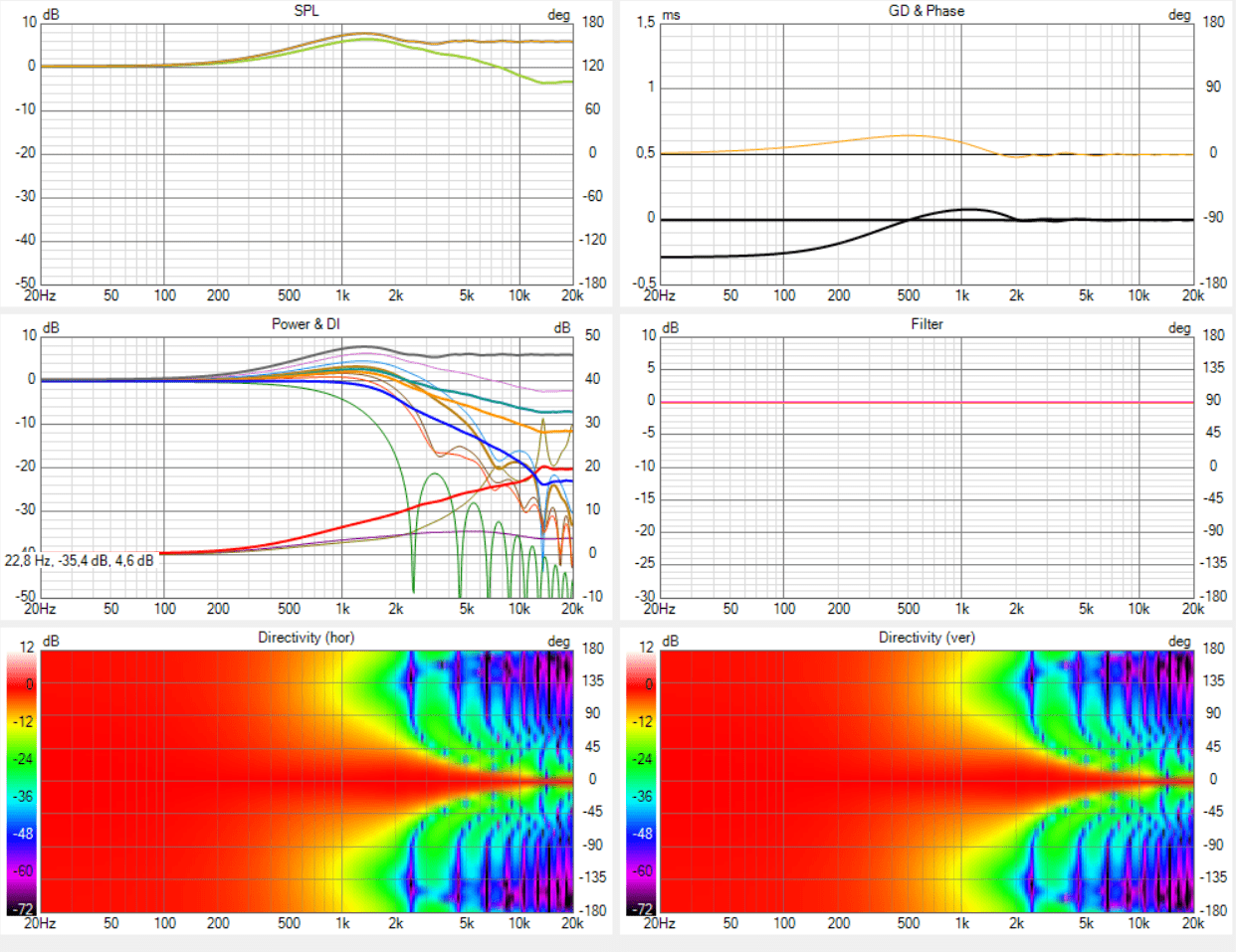

Here exported graphs, should be in same order as above images.

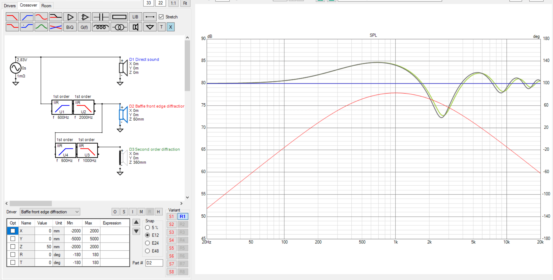

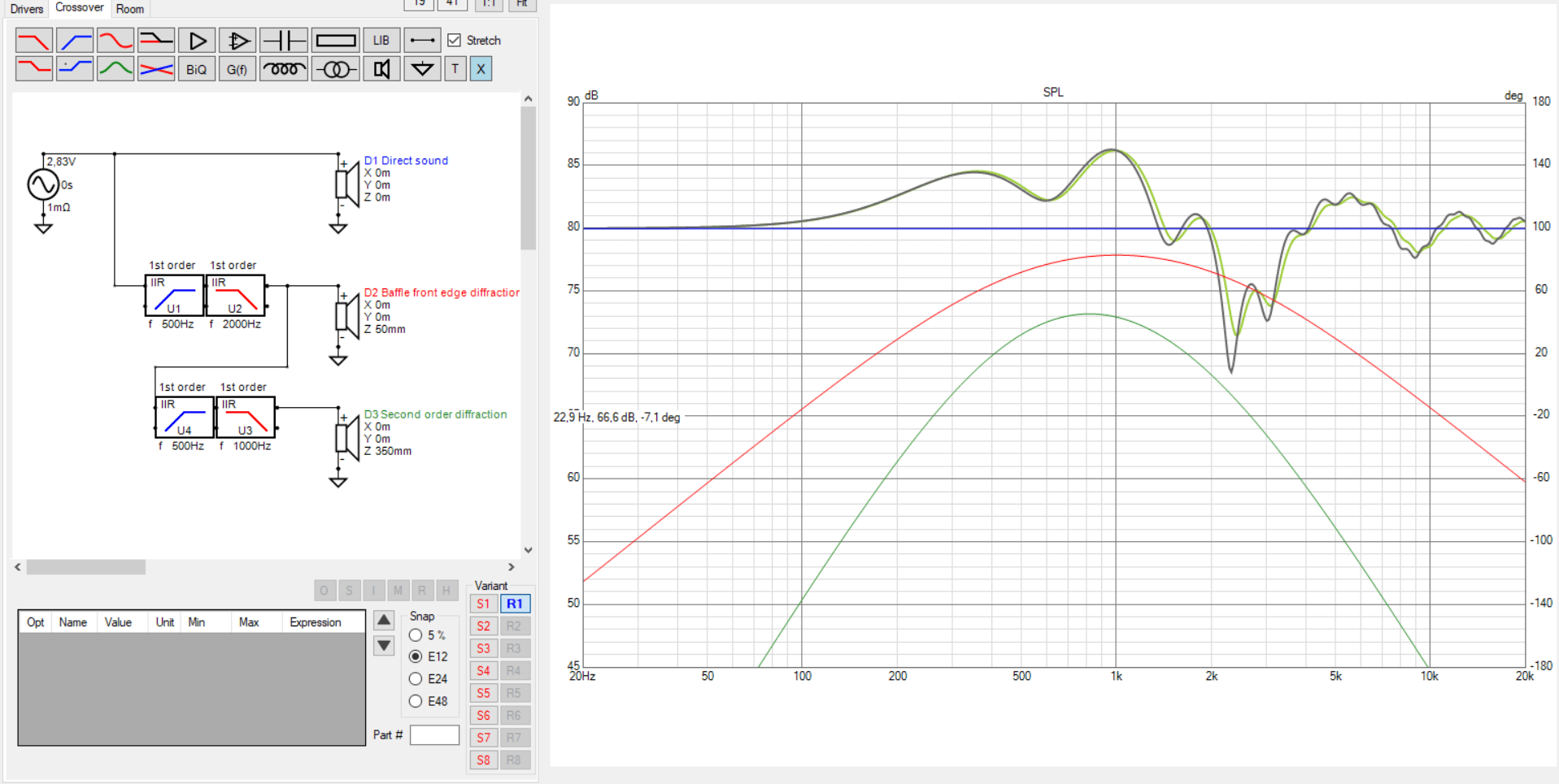

As seen effect of adjacent transducer structure (pipe) is minor at least here in this simple simulation, and I suspect BEM would also show kind of minor effects as long as both are on same plane so that there is no path for specular reflections to reach listener.
Any second or higher order diffractions, like those from back of the structure or from neighbouring structure, just makes ripple that rides over the response that happens due to the direct sound and front edge of the baffle that is immediately beside the transducer encompassing it. This is because sound does superposition, the louder the interfering sound source is the more significant the effect. Two perfectly coherent and equal SPL signals can make +6db constructive interference and in theory cancel perfectly in between, but if either is louder it would dominate the response, while the other makes some ripple to it. Hence we see significant effect of the baffle edge diffraction from the immediate surroundings of the transducer because there the SPL is loudest, but soon after the first edge the SPL already drops and anything beyond has less and less effect just due to less SPL.
As computed in brain in previous example, a woofer "enclosure" below freestanding mid enclosure makes very little difference in response of the mid, because it does not encompass the mid driver but only very small portion of mid sound encounters the woofer structure. The neighbouring structure does not encompass the mid transducer as the mid enclosure itself, which the mid sound would fully encounter. Thus, the immediate surroundings of any transducer makes most of the effects, dominates the interference / pattern, and anything second order effects just ride on top, make minor ripple on top of it.
edit.
here simple ballpark demonstration that any first order effect makes most difference in response, while second order or higher order effects just make ripple on top of it. Crude simplified emulation of ideal direct sound with flat frequency response, then secondary sound with limited bandwidth arriving bit later, rough emulation of front edge diffraction, which makes quite big interference pattern with direct sound. And then the second order effect, like another rough emulation of diffraction from back of the box, just ripples it, doesn't dramatically alter what the first edge already did, a lessor effect on graphs.
Make no mistake, I think the second order effect might be the more audible one due to how auditory system works! I'm not an expert and these are difficult to listen to so just a hunch. But, if ones goal for system response is to get within say +-1db target through the whole bandwidth, it is most important to fix the first order effects because those make most difference! Immediate surroundings of a transducer is the most important thing to get right acoustically.

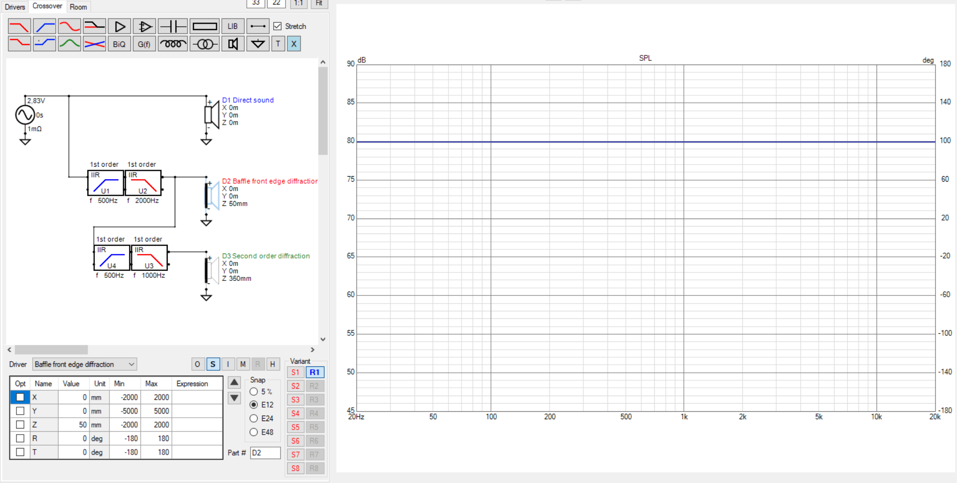

Can you expand on what this means and whether Mark's speaker has a wide beamwidth on a narrow/small baffle like the OP's or is a stack of horns (a fairly common configuration for a 5 way). The difference is relevant to the perceived sound.
What the OP is proposing is going to introduce some pretty noticeable sound effects due to the steep changes in radiation pattern with frequency. It can be compensated for to some extent by raising and lowering the on-axis response to counter the relatively wide and narrow beam widths but this is rare. I am only aware of B&W taking the approach. Anyone? Other wide bandwidth speakers and particularly the ones that do well in listening tests have smooth radiation patterns created by blending the differing radiation patterns with the crossover. FIR filters can do this noticeably better than analogue filters although the filter design isn't straightforward.
The OP can of course try steep filters, hear what the sound like and then implement a crossover with shallower slopes so long as the drivers he chooses are suitable (there was some discussion earlier about filler drivers). Given the absence of speakers with steep crossover slopes on the market this is likely a good way to hear/learn why. Perhaps he will like the effect and keep the steep slopes but I think it unlikely. All part of the fun of the hobby.

As Krivium said, the speakers are fairly large conical MEHs. So all 4 main-speaker driver sections are in one 90x60 degree horn.Can you expand on what this means and whether Mark's speaker has a wide beamwidth on a narrow/small baffle like the OP's or is a stack of horns (a fairly common configuration for a 5 way). The difference is relevant to the perceived sound.
Ime, radiation pattern vs freq is a function of the acoustic design, the physical design, and that design pretty much mandates where the electrical crossovers should be placed for smoothest polar response.
I've found it much easier to crossover right at that optimal acoustical target, with steep rather than shallow xovers.
Drivers still need to be selected fairly carefully for sufficient overlap, but it is so much easier to tie together drivers where they maintain fully complementary acoustic summation thru xover region.....again, at the optimal frequency dictated by the acoustic design.
So I guess i'm saying...i see steep working no matter what the acoustic design. Just start with a good acoustic design!!
Hope that all made sense.
