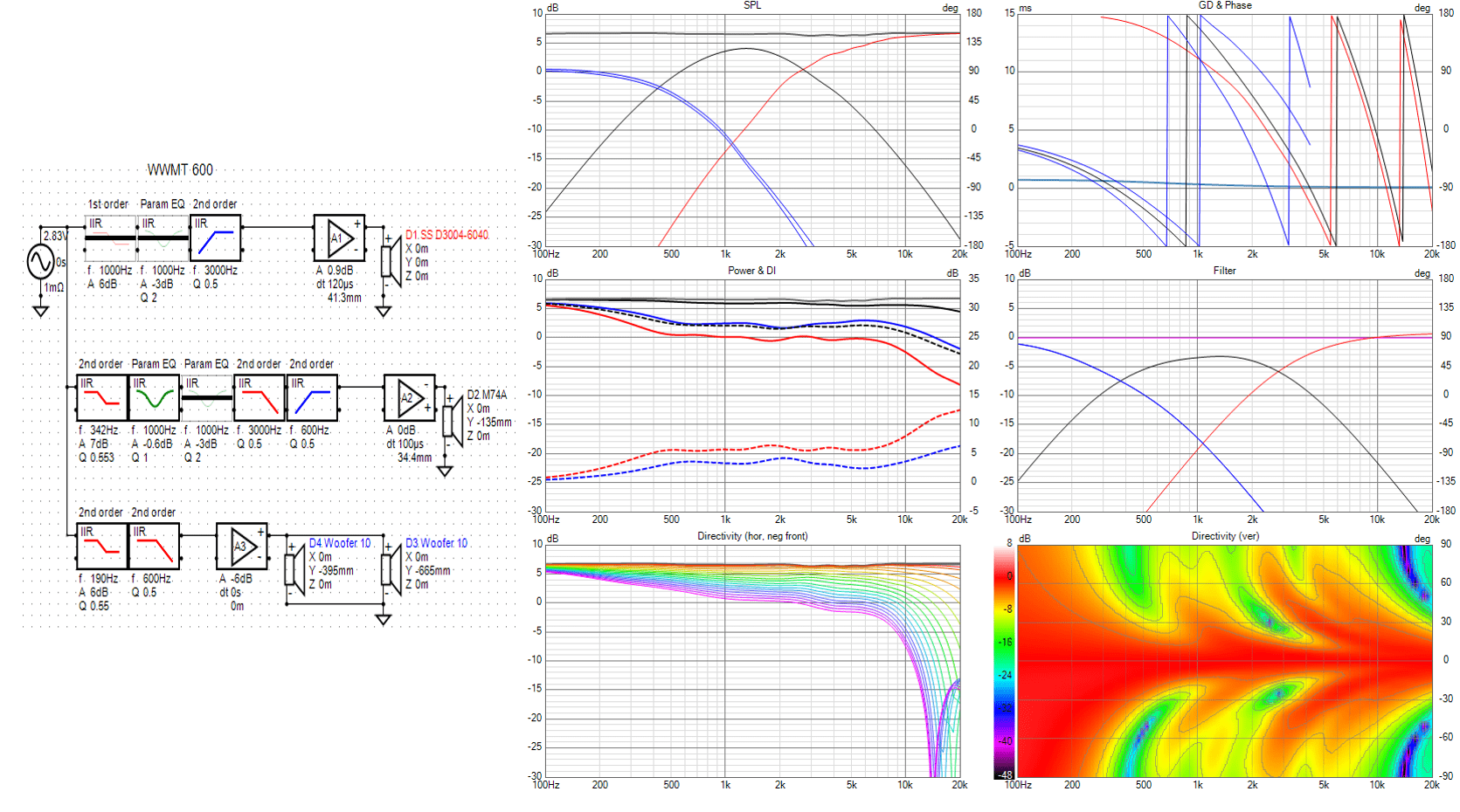

My impression is that on the 12cm tube the global dispersion goes from very wide below 1000 hertz to a constant 90 degrees above 1000 hertz very quickly.
Is this correct? If yes then Houston that is a real problem because of the sudden shift in dispersion even after normalised response will cause a huge shift in reflected sound in the pass band.
Yes, you can read that form directivity index (DI) graph, which goes from ~0 to ~10db within the passband in the minimal baffle example. DI is the red line on center left image on the sixpack(s) I posted. Same information is basically visible on the normalized polar maps, and also readable from relationship of axial sound and power response, which together make the DI.
This is the reason why I wrote the two yield very different systems, the increase in DI is not at same bandwidth due to different size baffle. Coverage doesn't jump quickly but is smooth slope all the way which is not a problem itself, and which would happen with all systems that are not embedded into a wall at some frequency bandwidth and slope. Directivity on low bass is ~0 due to very long wavelength no matter the system, to ~10db+ for 20kHz due to very short wavelength, beaming of tweeter for any available tweeters (waveguides can widen response a bit on the top as well). For this reason the DI always increases somehow.
Sudden shifts in directivity happen with poorly implemented multiway systems where bigger transducer beams and crossover happens at frequency where the small one is still ~omni. When DI of these two are too different and it would make a jump in directivity through crossover.
Reasoning from these, if mid is on minimal baffle and DI goes from 0 to high within pass band, the tweeter should also have high DI at crossover = waveguide, and the woofer should also have low DI = narrow baffle as well. IF woofer was on big baffle, it could narrow and mid widen at crossover, which means DI won't match and jerk in directivity, same if there is dome tweeter without waveguide.

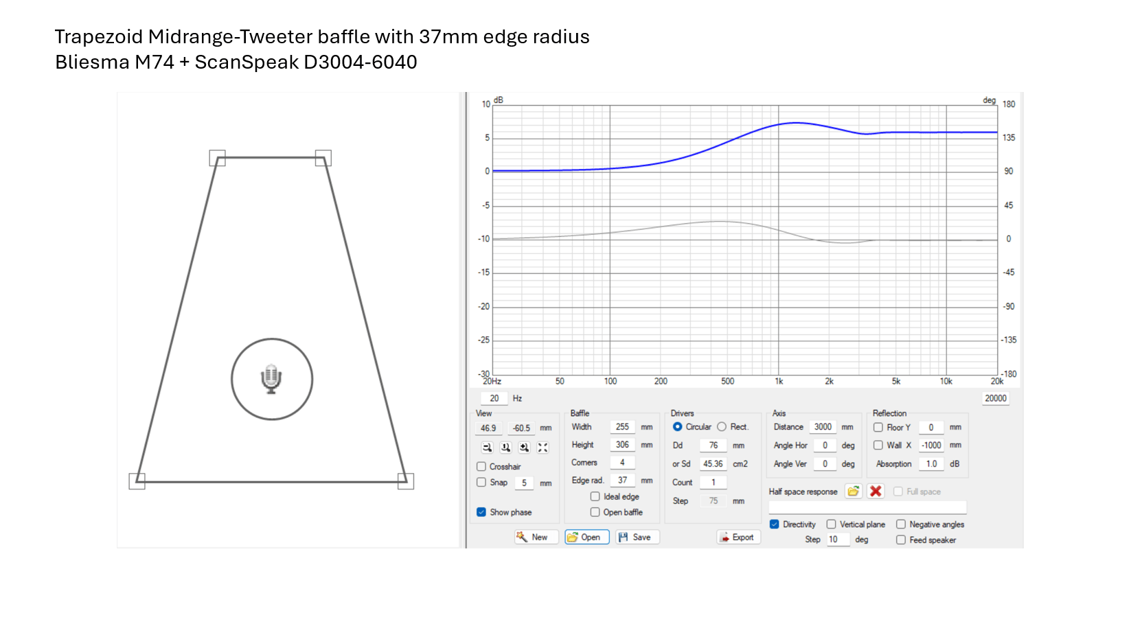

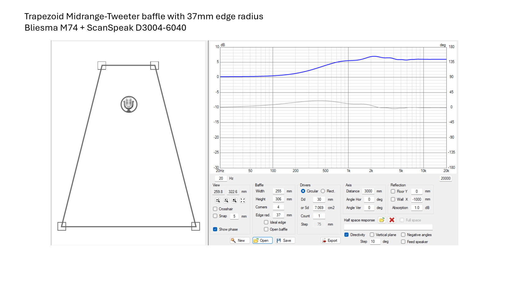

Here is an example of what can be done with VituixCad diffraction tool. I have been experimenting with sims of the Bliesma M74 driver with a small frame tweeter such as ScanSpeak D3004-6040, which has a flange diameter of 62 mm.
I found that a small trapezoid baffle worked well, a baffle just large enough for the two drivers and a 37 mm radius edge all around. The tweeter does not use a waveguide, but the baffle radius begins where the flange ends. This sim uses 2 x 10” woofers which would have a separate cabinet. Crossovers are 600 and 3k.
The DI is flat from 400 to 8k, +/- 1 dB. Of course this is a simulation using flat disk pistons, and real drivers will have a slightly different radiation pattern, but I have found this kind of preliminary simulation to be very helpful in the early stages of the design. It greatly reduces the risk of design flaw. These kinds of flaws, baffle shape and driver spacing, are not really fixable after the speaker is built. Generally, an entirely new cabinet has to be built.
I have not tried to simulate circular baffles for the midrange and tweeter (cylindrical mounting). My intuitive expectation is that it should be fairly similar to my trapezoid.
My main point here is that simulating in advance reduces our risk of unfixable design flaws. If we base our designs on intuition or “gut feel”, there is a higher risk of getting a poor result.

Yes, it is not hard to simulate a circular baffle shape. We can do one for the tweeter, and one for the mid, and combine the two in simulation.
What diameter, and what is the edge radius? A sharp edge we can model as a 1 mm radius. A gentle rounded edge can be modelled with as much radius as the tooling allows. For me that is 37 mm max.
@tmuikku has made the argument that a sharp edge radius is acceptable on the mid driver, as long as the circular baffle is no larger than the driver. For the Bliesma M74 that would be 121 mm diameter. For the SB Satori MD60N, that would be 130 mm diameter.
For the tweeter, I recommend as much edge radius as possible.

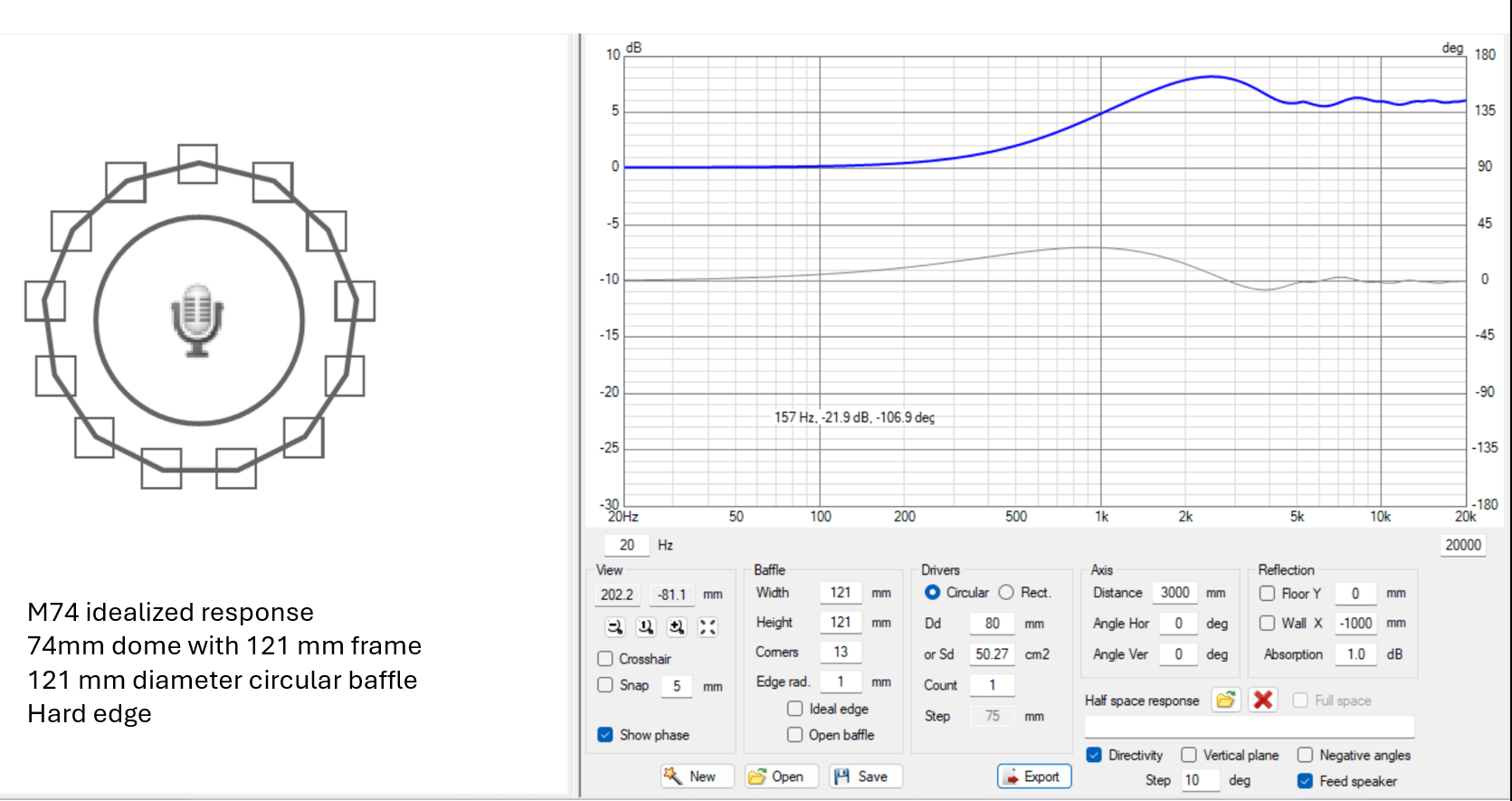

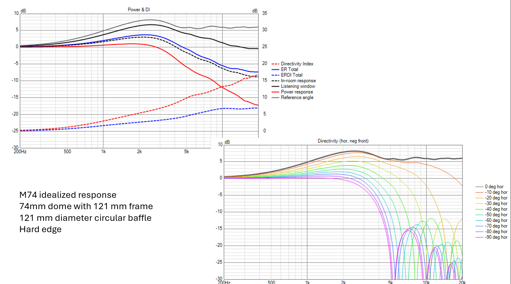

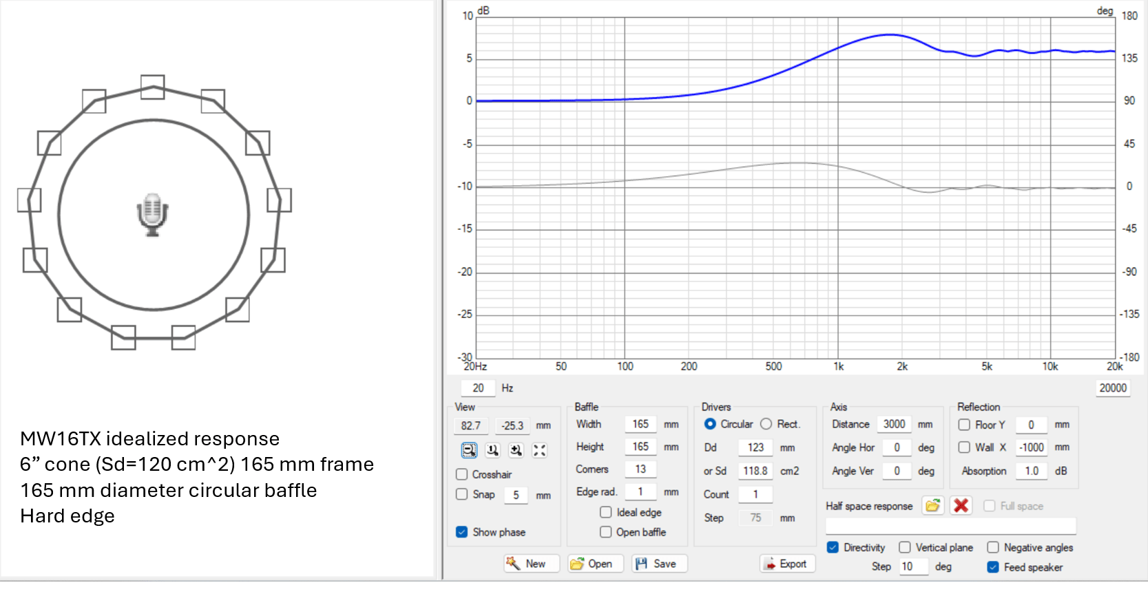

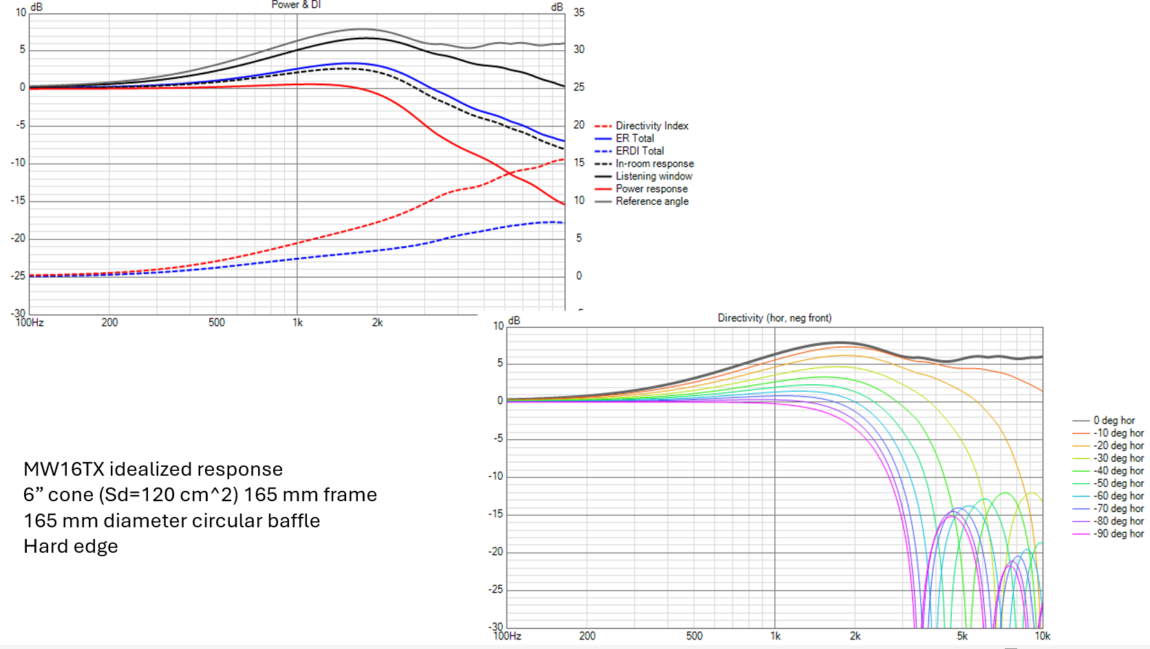

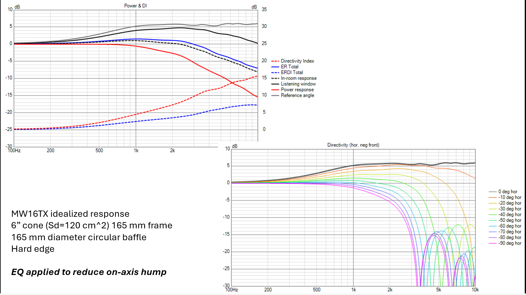

For the 74mm dome, I assumed a flange size of 121 mm, and assumed the baffle is the same size circle as the flange, and the radius edge is a hard edge. Although the voice coil is 74mm, the radiating surface is closer to 80mm considering the Sd of 50 cm^2. I plotted a frequency range from 200 - 20k.
A 13 sided polygon is a good approximation of a circle. Actually anything with more than 8 sides is a good approximation, but 13 sides looks more like a circle.
For the 6" cone driver, I used the physical dimensions of the Satori MW16TX driver. The Sd is 119 cm^2 and the frame size is 165mm. I assumed a circular baffle of the same size and a hard radius edge. I plotted a frequency range of 100 - 10k.
In both cases, there is an on-axis hump in the response, but this is not manifested as a hump in DI... the DI smoothly increases over the range. I applied a gentle EQ to both cases to flatten them out a bit. This helps visualize how the driver might be used in a system.

That's great. Cool.
The rounded edge certainly makes a different
I am wondering now how the overall curves will look if a low pass shelf filter is applied to correct (normalises the baffle step?
In practise I would expect the baffle area of the woofers to provide some loading below 1000 hertz.

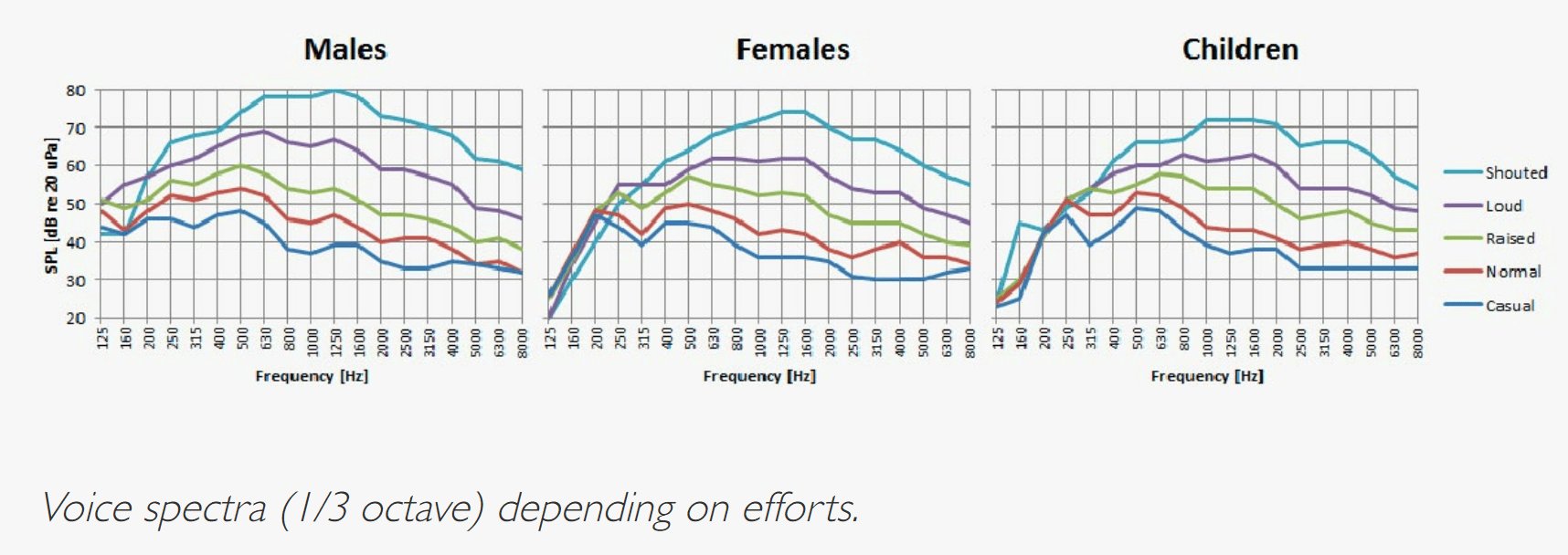

Human voice fundamentals are 200-2000Hz, but harmonics and noises spread to 4000hz, with much lower spl.
Thank you for your advice. Since I was planning to cross midhigh and tweeter at 4kHz, and now am thinking of 4.5~5kHz, I guess I can equate the voice source to be just midhigh+midbass and the tweeter as a harmonics generator....

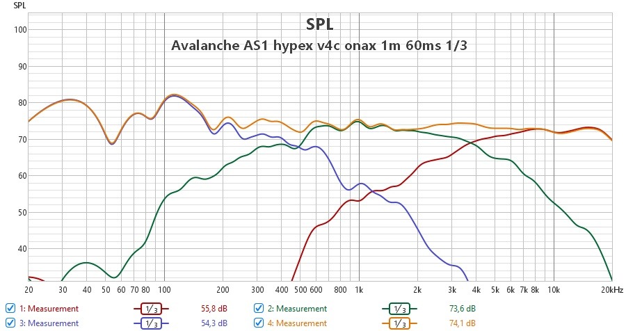

Many are happy cross at 400 and 2500Hz. LR2 gives smooth 180 deg phase change but LR4 turns 360deg and in narrower band.

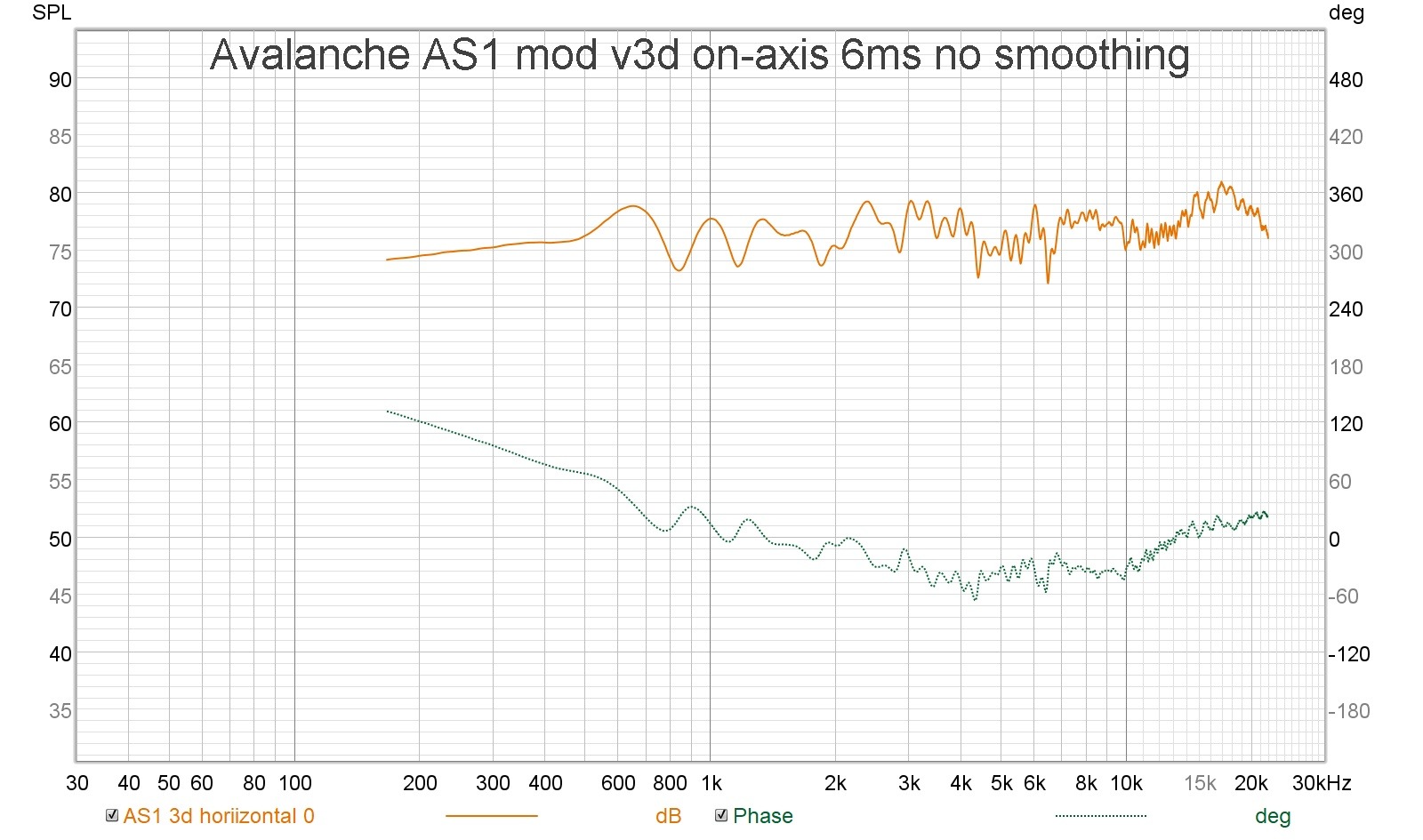

My modded Avalanche active uses LR2 and 4"mid - only moderate eq was needed with Audax HM100Z0. CTC is 12cm (5")
View attachment 1326405 View attachment 1326406 View attachment 1326407
My FIR crossover slope would be 100+dB/oct, so hopefully I can avoid or mitigate some problems with this. It's even easier at such high frequency, consuming less computing resource.
