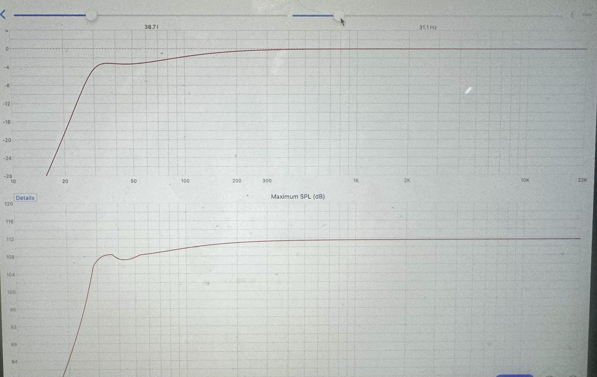

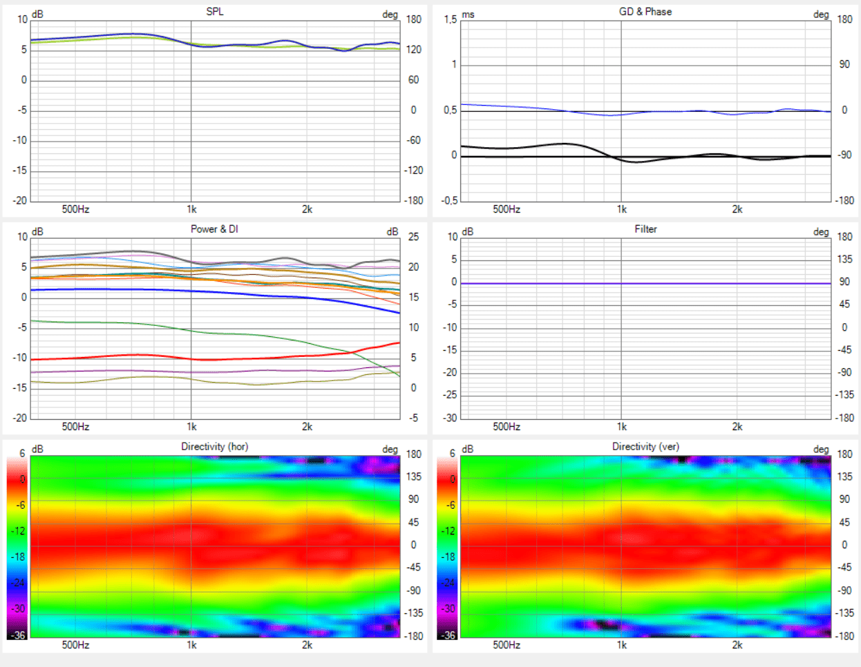

FirstlyThank you for your clear points and explanation here. One that really hit me hard was 'Is it best practice to have the human voice (mid range) spread a 26 inch length?'. I tried hard to think of some ways to mitigate the issue you pointed out, and here are 3 I came up with:
- Use D2004/6020 tweeter whose motor assembly diameter is 55mm. I ditched it earlier due to its dip around 15kHz(I think), but I guess that's something DSP can correct. Will reducing one distance from 80mm to 55mm help appreciably?
- Raise the crossover frequency from 4000Hz to 4500 ~ 5500Hz, so there is less voice component produced by the tweeter. Satori can support that band on axis, but 30-degree response seems to struggle a bit past 5000Hz. How much do you think it can be of help?
- Use the 5" illuminator midbass to reduce another CTC distance. This may call for 4x 7" instead of 2x 8"....
Pls excuse my blathering on and on like a thread hogger.
I think what you are suggesting is correct in principle. But at the risk of upsetting the lateral imaging and soundstage. This is because on axis accounts for only 50-60% of what you hear.
The 5 inch mid bass will work but this may have limited sensitivity and output over a broad 260-4000 range.
The Satori could be placed about the tweeter with the aim of a more coherent point source. I do feel it’s fraught with complexity and hidden problems unfortunately.

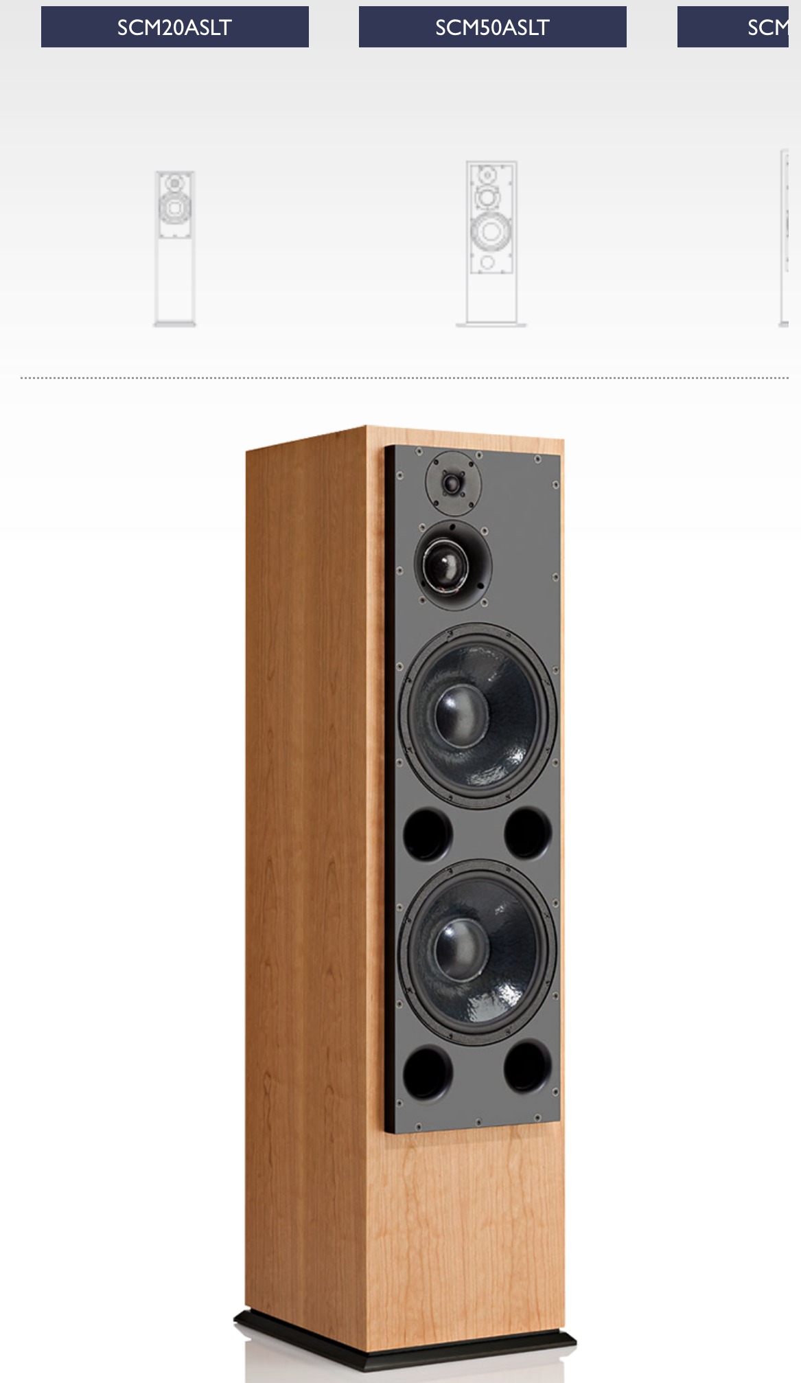

I honestly feel you will be rewarded with simplifying the mid - hf section using a highly capable broad range mid or mid bass driver and a good tweeter. Keep it simple. You can always mess with wave guides or AMT later in f you wish.
It’s more over about your overall driver strategy as others here are outlining. Some great posts made.
The compromise is either splitting up the mid range into two bands for more focused driver optimisation or using a single driver for 400- 3000-4000.

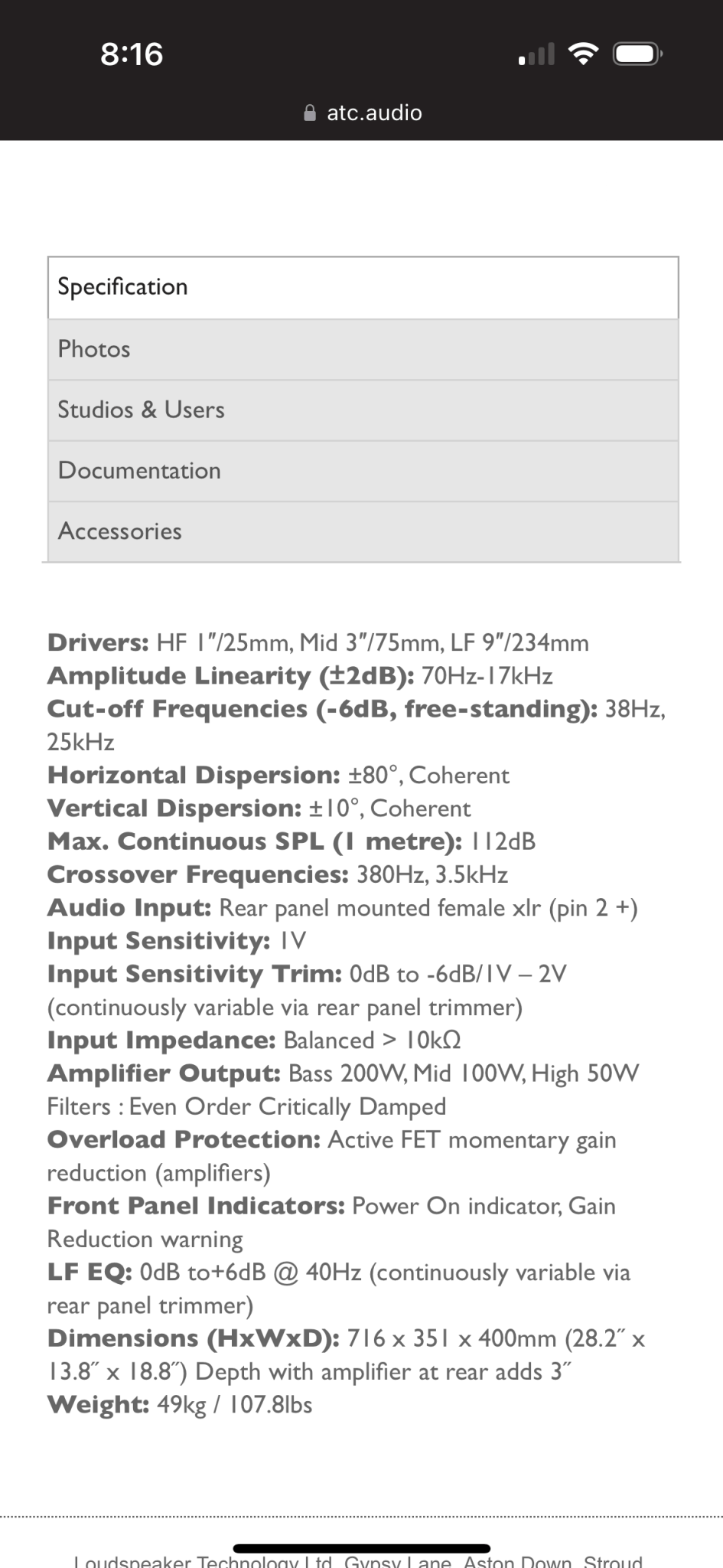

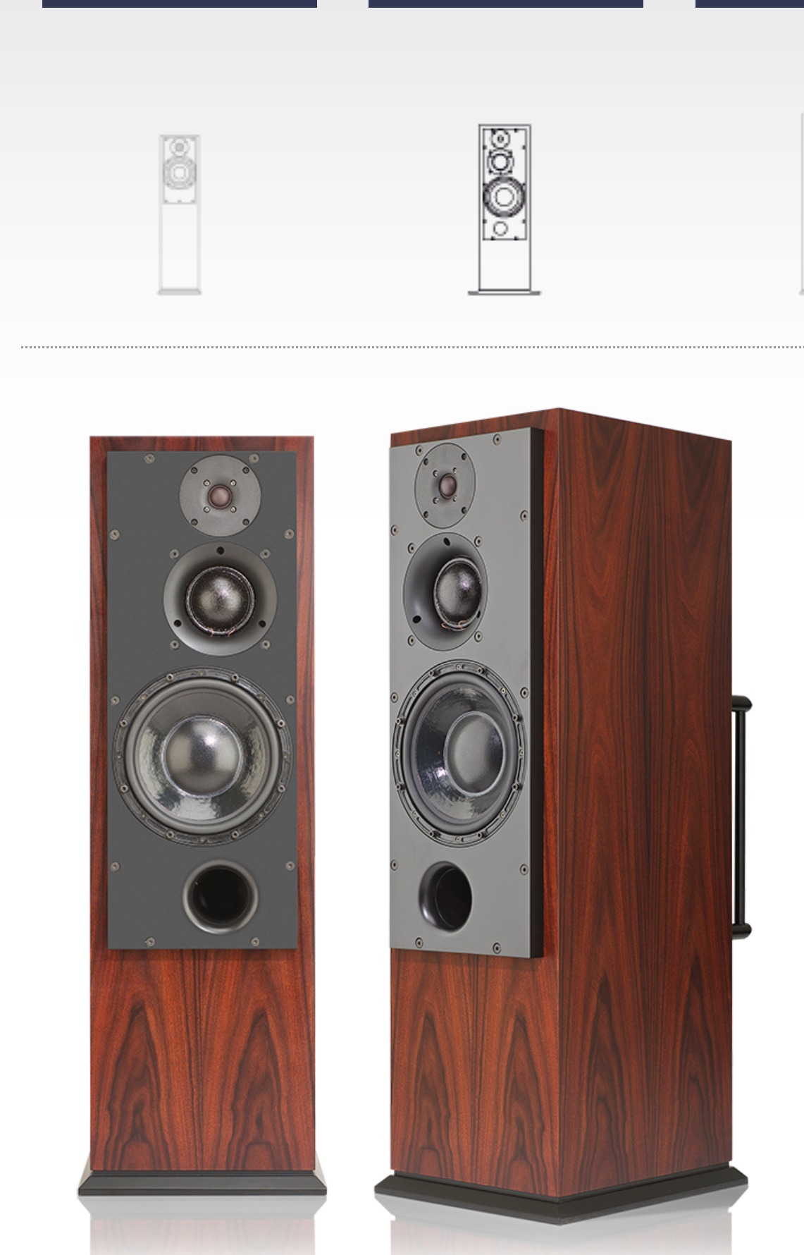

You have mentioned the ATC dome. If you can find one great. Problems solved.
Given your prior system l think better means a system that can create more scale and let you further into your music emotionally.
That points to more dynamic driver combinations covering the mud and hf.
The key is using the best wide band mid driver or mid bass driver you can find.

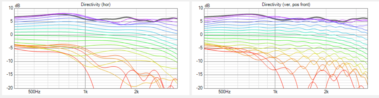

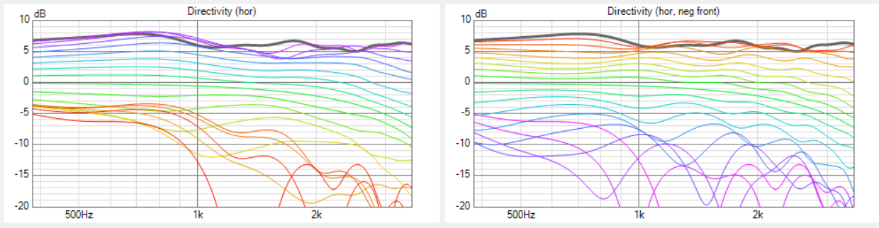

- Use the 5" illuminator midbass to reduce another CTC distance. This may call for 4x 7" instead of 2x 8".... daM

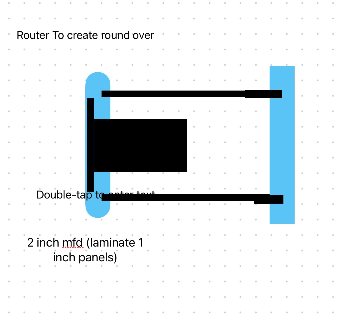

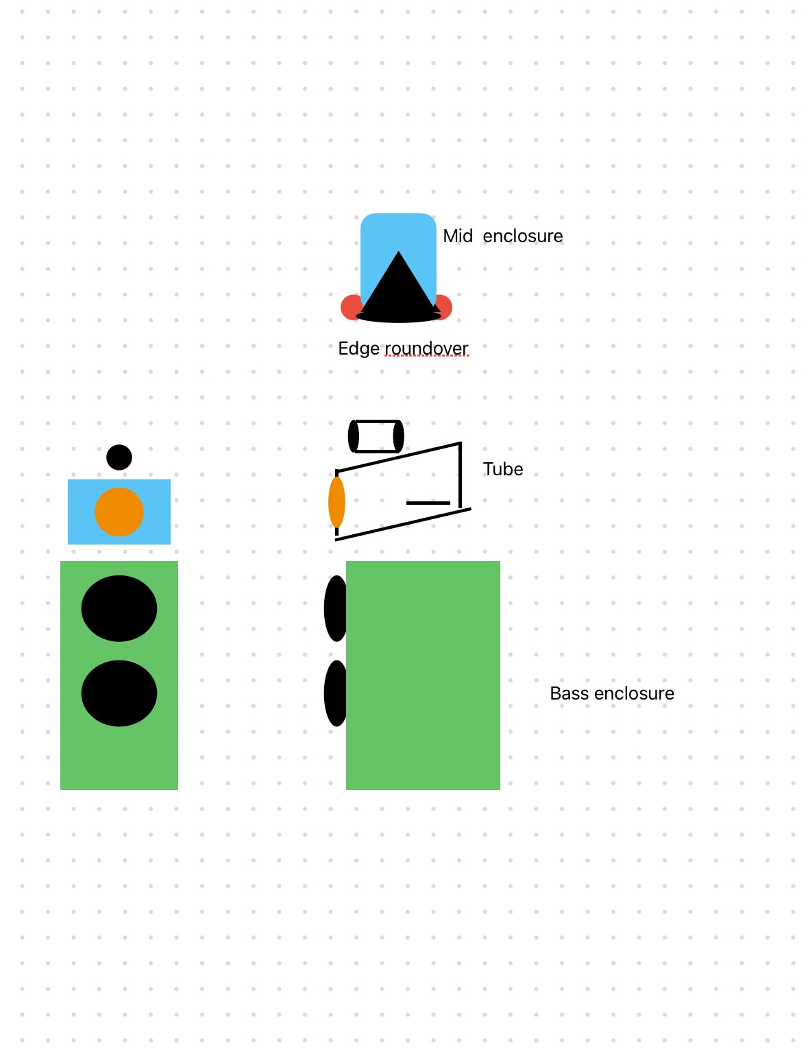

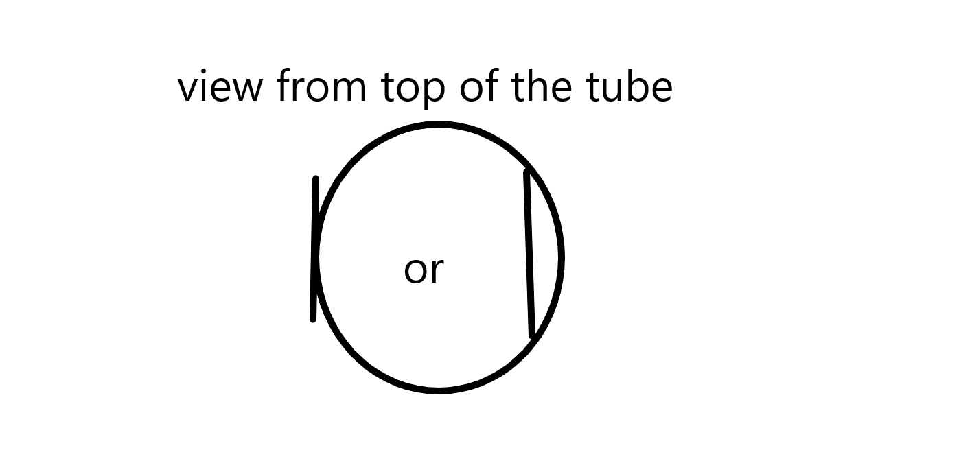

Does this sketch make sense? I think the implementation is fairly straightforward.
A sono tube say 10 inch diameter tube and mdf or ply end caps. Router out a grove for the tube in the end caps to slide the tub into and router a curve on the cap. Then router the driver cut out. 35cm deep gives out 17L.
I am sure some diy friends can help you out with the woofer(s) enclosure.
Instead of two drivers covering the mid use a mid with more grunt and pick out a matching tweeter with similar sensitivity
Because the Bileisma 29mm tweeters can cut at 1300 this opens up more possibilities for a mid bass or mid driver. It has 3 mm X max.
All the impact comes from well over the floor delivering a more open tactile presentation.
On the acoustics the wider driver diameter & baffle will let your mid bass/ mid driver go down lower which is what you want.

Attatching a mid driver to a tube with rather small diameter is challenging... The driver's frame is flat, you know...
An experienced Cad designer could model a specific piece for cnc or 3d printer, glued to the tube perhaps? But anyway there will be edge discrepancies that cause diffractions in mid's range.
With amateur carpenter skill and tools the task is enormous.

I believe l have previously fabricated this approach to a midrange enclosure using a cardboard tube. My suggestion is to try out the technique and see how it goes.
The actual baffle can be any shape.
Other enclosure shapes including wedge would work equally well.
A sufficiently wide round over 2-3 inches) is quite satisfactory.
A Jasper circle jig and router can successfully be used to fabricate the front and rear panels.

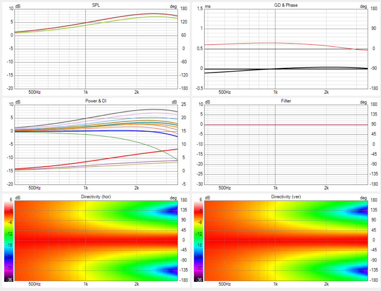

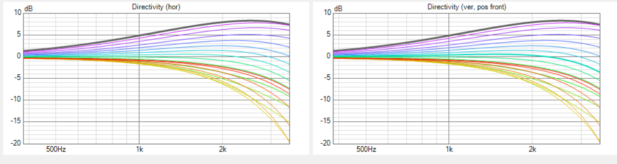

Depends on wavelengthA sufficiently wide round over 2-3 inches) is quite satisfactory.
If that is a tweeter on the image, with typical 4" flange around the dome, then any roundover would make better performance than sharp edge there, yeah then the lip like that might better the sound a bit.

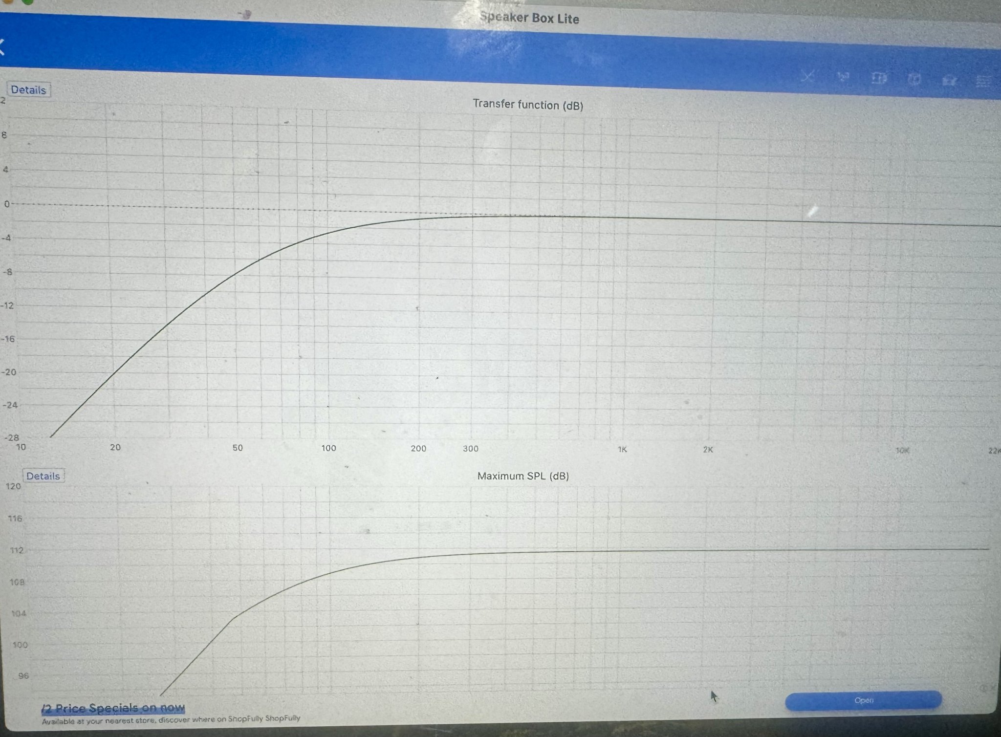

My suggestion on the drivers above will require some further research. Given the approach taken my B&W and Wilson Audio l believe the acoustic solution to be solid.
I also believe the suggestions made will increase the probability of successful performance outcome to reduced complexity and unknown acoustics of more complicated solutions such as adding a fill in driver from 800-4000 hertz.
Simple is as a rule a better way with anything in diy audio.
The bass section can be configured as a SBB or BB4 which had the port tuned to the free air resonance of the driver. The identical driver can be placed in a separate sealed critically damped enclosure.
I have owned a system using Scan speak woofers successfully used with the above approach in a highly revered commercial design. A f3 of 30 hertz would not be difficult to obtain in the above configuration without undue bass augmentation near room boundaries.
