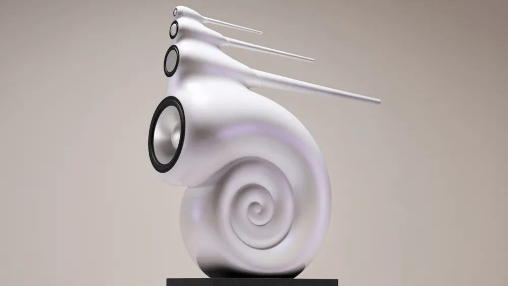

B&W Nautilus speaker and Vivid Giyas (from same designer) utilize smart shape both in- and outside. Only problem is round transsection.
https://www.bowerswilkins.com/en-us/product/loudspeakers/nautilus-series/nautilus/150016.html
I am trying to copycat some of the design aspects of this guy.

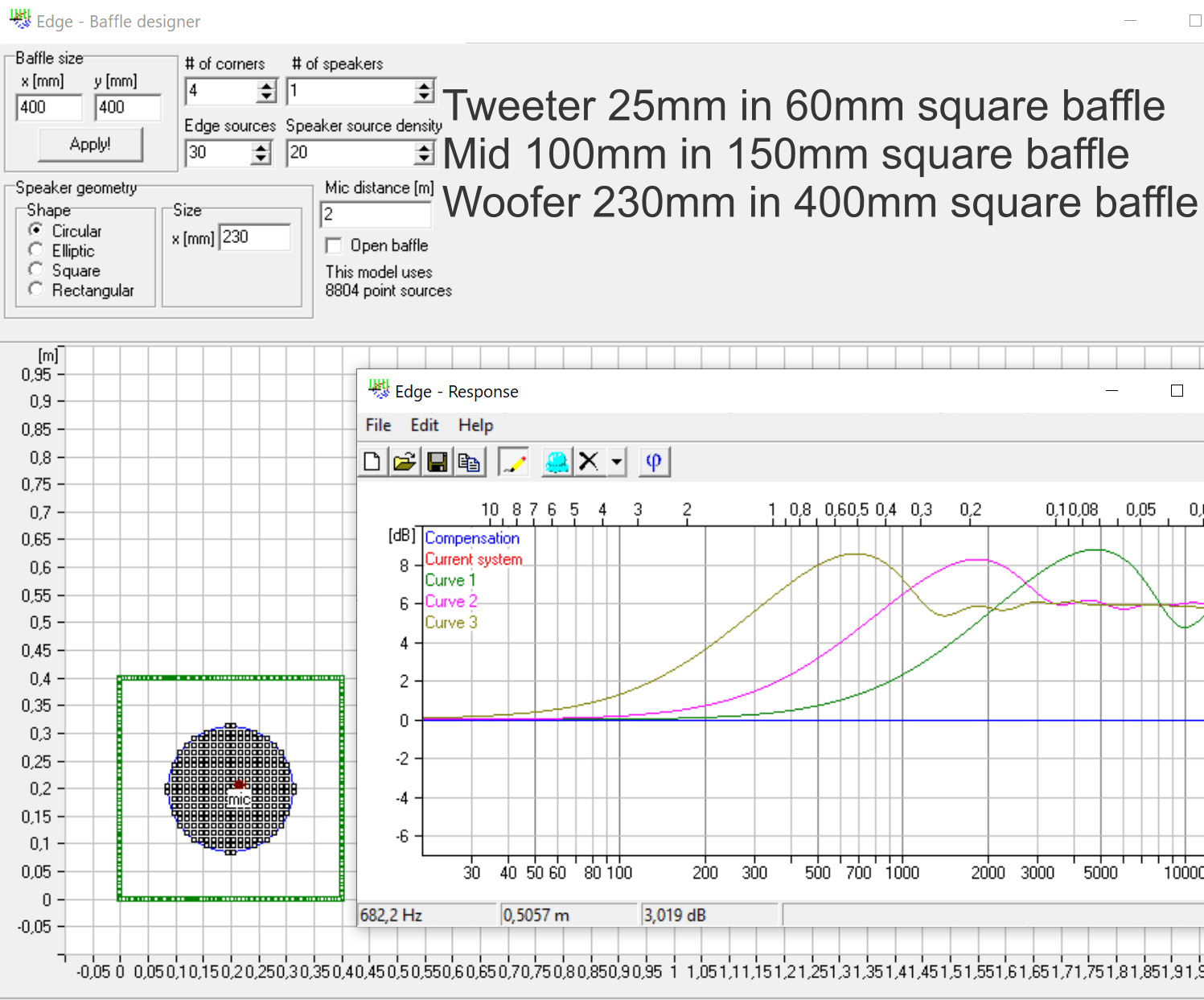

How to make a 3-4 way speaker without edge diffration problems? (below 10kHz) With wide and smooth directivity.
Simple - use minimal square or whatever shape baffles! This is the idea behind B&W Nautilus and alike speakers. Multiway dipoles use same idea but with narrower radiation because of 90deg null.
But stacking these boxes and using "normal" crossover slopes will create more interferences...
Axial response simulation with the Edge

^anything small compared to transducer size works fine, square or round almost same. Sealed back gives wide coverage pattern system though. Tweeter on big waveguide and then big MID and woofer wpould make DI higher, while still keeping edge diffraction issues at bay. Like OB, select which works toward the goal.

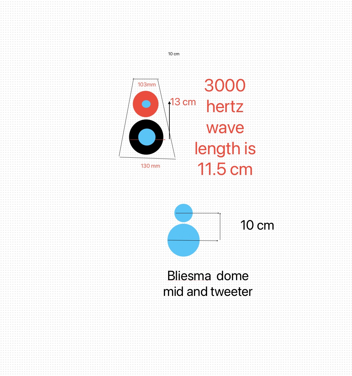

You would be better of with a Bilisma mid dome and their 25mm tweeter. The front plate of the tweeter is only 68mm.
Their 3” dome front plate is 121 mm
Think about a 4 inch cone upper mid!

The driver centre distance @ 3000 hertz crossover is very important from the imaging and point source perspective.
I bought this up because while diffraction is important for the distance between drivers on the crossover. Steep active filters can help minimise destructive lobes in the vertical plane but a good design engineers out the problem before it can happen.

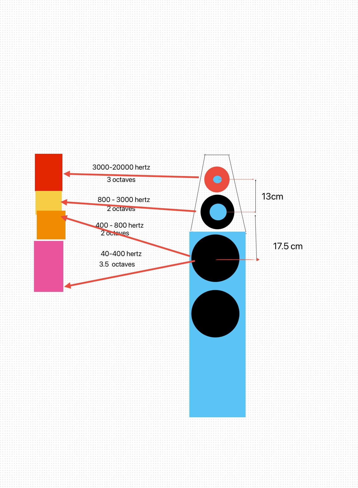

The first decision is to determine the acoustic design point. Generally this is on axis with the tweeter. However there is a trade off where this practice places the mid upper midrange driver below the listening height of say 93cm at 80cm.
What is the impact?
The upper mid driver is now off axis and the distance to this driver is greater to the listener position than the tweeter. Assuming the 8” or 6 1/ 2 “ mid bass driver is below upper mid range this places it at least 27cm below the tweeter acoustic centre. The distance to the listener is even further than the upper mid dome.
Looking at this from the spread of the driver pass bands the lower mid is operating up to 800 hertz while the tweeter is operating from 3000 hertz or possibly 3800 hertz.
You realise the SB 60mm mid dome with the 130mm front plate is a fill in driver from
800 hertz to 3000 hertz.
How does this play out on creating a seemless translation of harmonic overtones?
If you listen in the far field say 5 metres it might not impact on coherency or driver integration but at 2.5 metres l would be questioning the length of this mid range high frequency array.
So what are your options?
You could place the lower mid range driver above the tweeter. You could also increase the width of the upper midrange driver from say 400 to 3000 hertz. The effect of this is that the entire mid range is now cover by one driver.
The lower mid range driver is removed or is now operating as a bass driver from 40 to 400 hertz.
The question is what trade are you going to live with?
I believe these trade offs should be considered and a decision made before looking at diffraction.

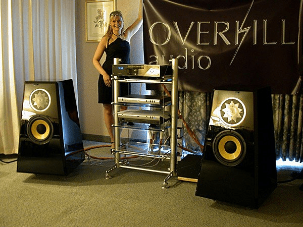

Back in 2003 I heard a DEQX active system, I think it was the first high end DEQX system?
The trapezoid cabinet time aligned the drivers physically and eliminated the "cliff edge" baffle step with the tapered width.
This reduced the DSP load on the DEQX which was used for crossover and Eq'ing. Worth mentioning the cabinet weight - 97Kg each! There was a lot of tech explanation in the brochure relating to the cabinet being 1,000 times heavier than the moving mass of the drivers... I can tell you those speakers had incredible transient / bass mid ... Drums were giggle out loud real!

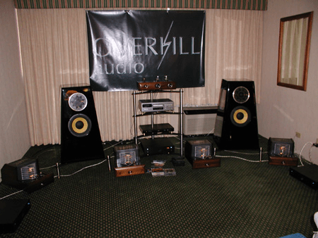

"Overkill Audio showed their Ovation speakers and electronics designed for them by deHavilland. The room also used cables from Crystal Cable, as well as equipment from DEQX and Equi=Tech. The sound in this room was very powerful and... firm. Like rock-solid in its ability to move sound through the air. Really quite stellar this is by far the best I have heard the Manger driver sound."

I got the idea from the Overkill brochure and it has consistently proven to be a good one. Its not always practical even in DIY, and very rarely in commercial designs but the goal is to minimise cabinet rocking or even "walking" in extreme cases. I have posted about this recently maybe back in this thread?
Edit, I posted about this on another thread, hope this makes sense... The Overkill brochure had graphs and accelerometer data and actual baffle / cabinet movement readings so it was all understandable and logical. I lost the brochure years ago so hope my version makes sense!

Thank you very much for bringing this up. I looked at the picture of the Satori, and it appears that the front ring could be removed by unscrewing 3 in the back side. That would still leave the diameter of the rest of the driver at 114mm. Practical minimum diameter of the cylinder is probably 120mm, so about 2x of the diaphragm diameter. How bad is the baffle's effect if it's 120mm wide, in the band from 700~ 5000Hz?
Similar thing could be done for D2104 to reduce it to 75 ~ 80mm. It is still over 3x of the diaphragm. Covering over 4000 ~ 5000Hz, how bad is it? Sorry that the simulator doesn't seem to work well on Mac...
The crossover is probably over 4000Hz. Does this change anything?
It’s a double edge sword with some quirks.
Yes it above 2000 hertz and 3000 hertz which 2 way systems struggle with.
But at 4000 hertz wavelength is 1/2 that of 2000 hertz. Its 86mm.
Technically when the distance of the diaphragm centres are greater than the wavelength of the crossover some issues start to surface in the practice implementation.
This principally effects the vertical axis polar response at the listening position and the global horizontal polar response.
In detail
Ideally want the diaphragm centres one wavelength or less at the crossover point to avoid irregularities in the vertical polar response. A sharper crossover slope reduces the irregularities and an FIR crossover is good. But the drivers occupy still different locations. This means they both can’t be on axis to the listening position.
This creeps into your minimum listening distance for system coherence. That is why l referred to having an adjustment of the angle on both the upper mid and the tweeter.
When you design the network you will normally use the tweeter as the design point or on axis listener position. So finding that needs some physical adjustment and is best done by tilting the mid high frequency array.
Horizontally global polar response.
Matching the off axis polars is also important. My suggestion is to initially run a series of measurements at 5 degree intervals on an IEC baffle (scaled to this frequency range with both drivers mounted one above the other.
Measure each individually. Then compare the off axis curves. You want the 0-30 degree to line up and the 30-50 degree to be reasonably close past the crossover point.
This will give you a baseline to validate your drivers are going to work properly with your proposed crossover points. What happens on your actual baffles is in the lap of the gods.
This is about the imaging of the system.
You don’t want pits or bumps in the polar response around the crossover region.
As l keep saying it’s about the overtones being uninterrupted.
The loudspeakers job is to translate with a minimum of errors. A multi way system is about greater precision but the implementation unless done skill fully can bring it all undone.
You can’t predetermine everything in advance but you can predict where the accidents (the errors) will likely occur because you made some informed decisions.
