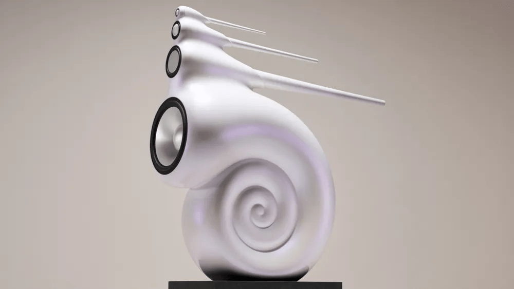

B&W Nautilus speaker and Vivid Giyas (from same designer) utilize smart shape both in- and outside. Only problem is round transsection.

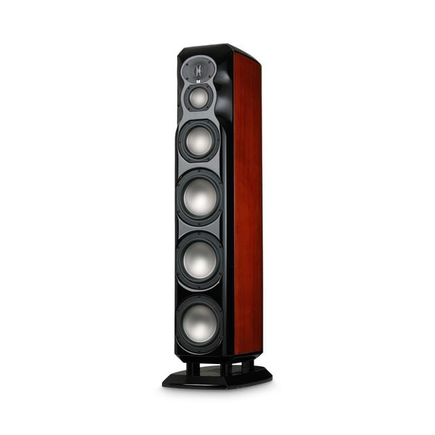

WRT baffle shape you can see that on the Revel Salon 2 where it is blended to reduce diffraction and a more uniform polar response.

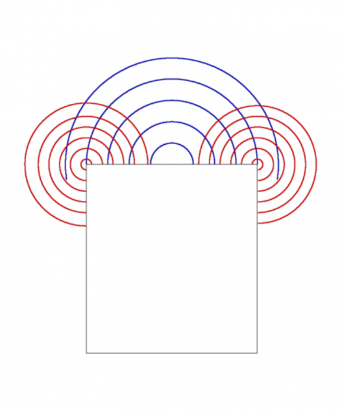

Defining diffraction as something that looks worse? .. Diffraction isn't always unintended, in fact it should be planned wherever it is predicted, and recognised to be unavoidable.Well there is a paradox, I look at diffraction as destructive as in nulls and peaks. Any geometry that gives you a smooth on axis and polar I would think reduces diffraction. I guess it's you point of view?
Not to forget that even after polar response has been considered, timing and related spatial issues remain.
If they start out perfectly, although that's never true in practice but you can still have it be 'significantly' the case. Nothing will change over time since the waves simply pass and don't come back.. unless there is reflection from the end of the pipe, although that won't be at the same level and it could still be significantly planar.I wonder if the plane waves would remain planar in practice?
A transmission line enclosure or voigt pipe might be a common example of it being exploited. Only the first mode is of importance and higher order energy might unfortunately be wasted. In a regular cabinet it is trivial to just damp everything, but in a transmission line damping is used to control the primary mode, not eliminate it. It's just fortunate that stuffing can pull double duty on higher modes, or unfortunate if you consider that a designer might not wish to concern themselves with all this.
Baffle edge diffraction widens horizontal directivity by creating secondary source(s), which cause interferences. Because net radiated energy is constant, on-axial spl drops and off-axis spl increases, or vice versa.
Because a loudspeaker uses wide bandwidth/wavelength, we see wiggles in spl response and uneven directivity spectrogram.

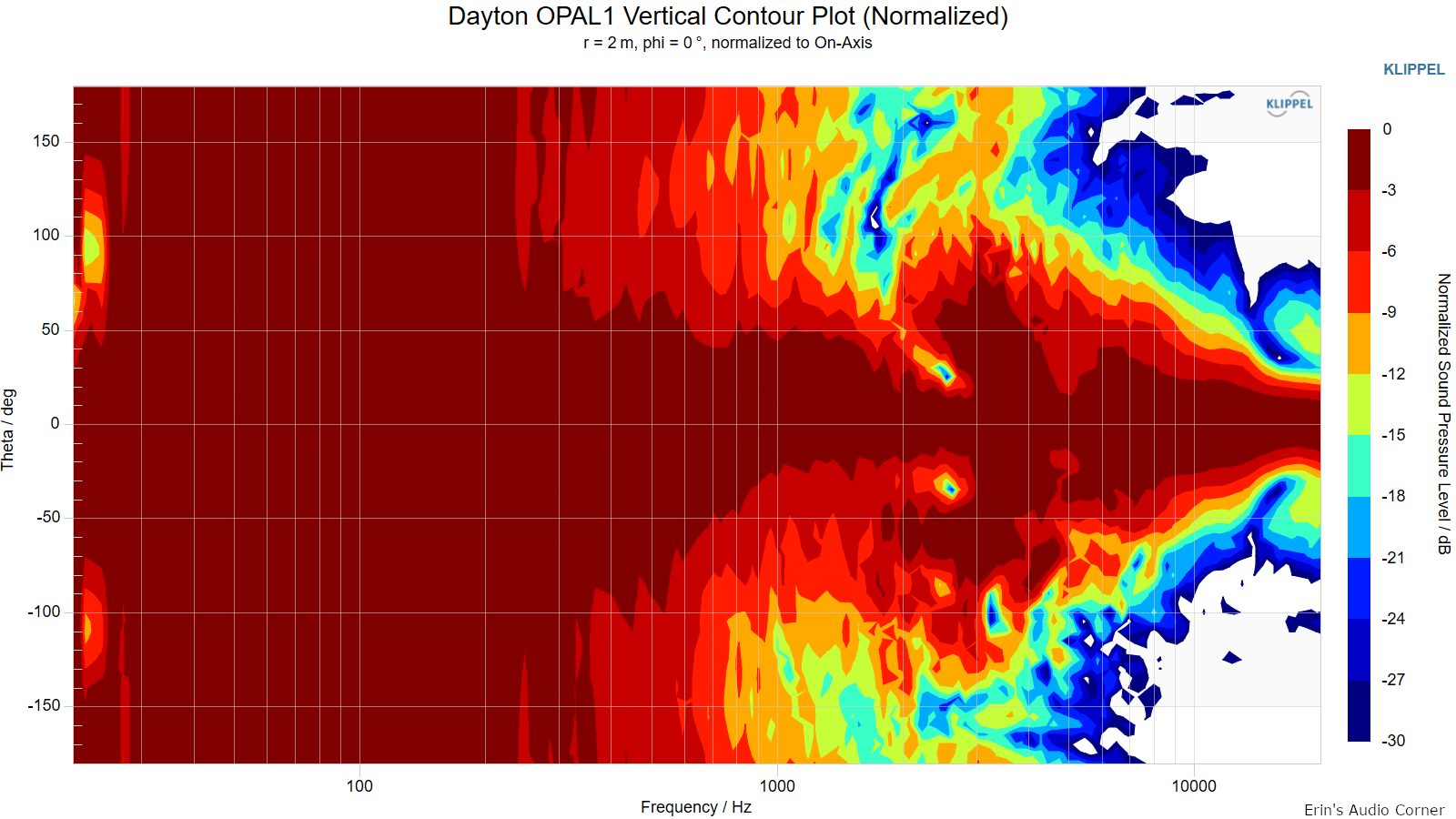

https://www.erinsaudiocorner.com/loudspeakers/dayton_opal1/

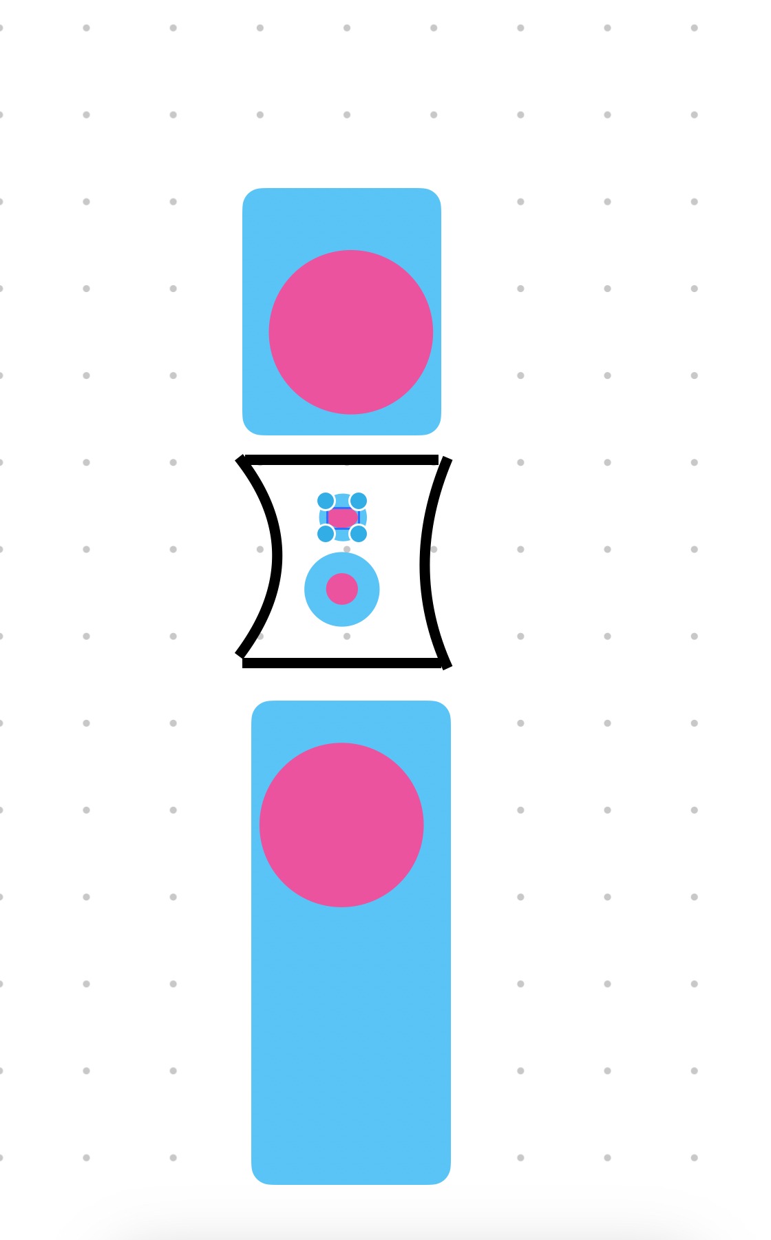

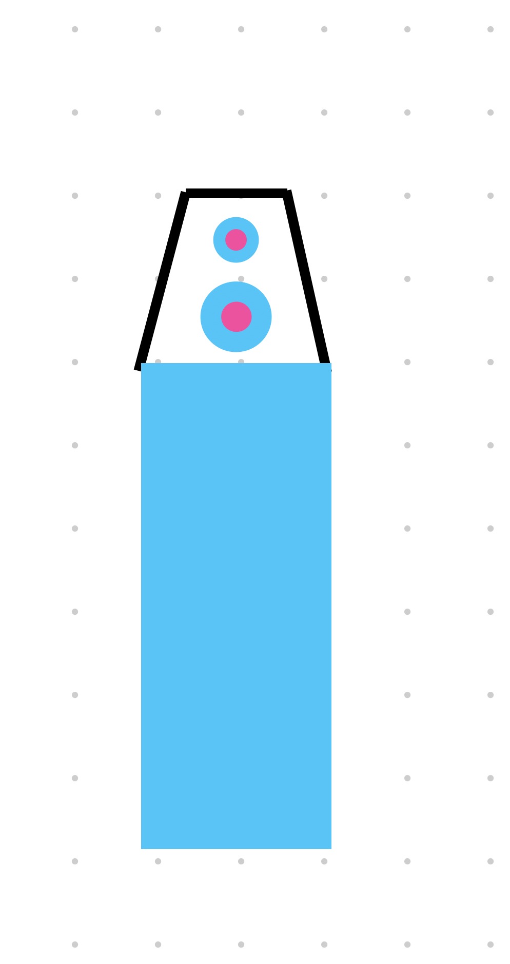

I am planning on the tapered cavity, but it could be rectangular cross-section inside or some other shape, I am realizing.
