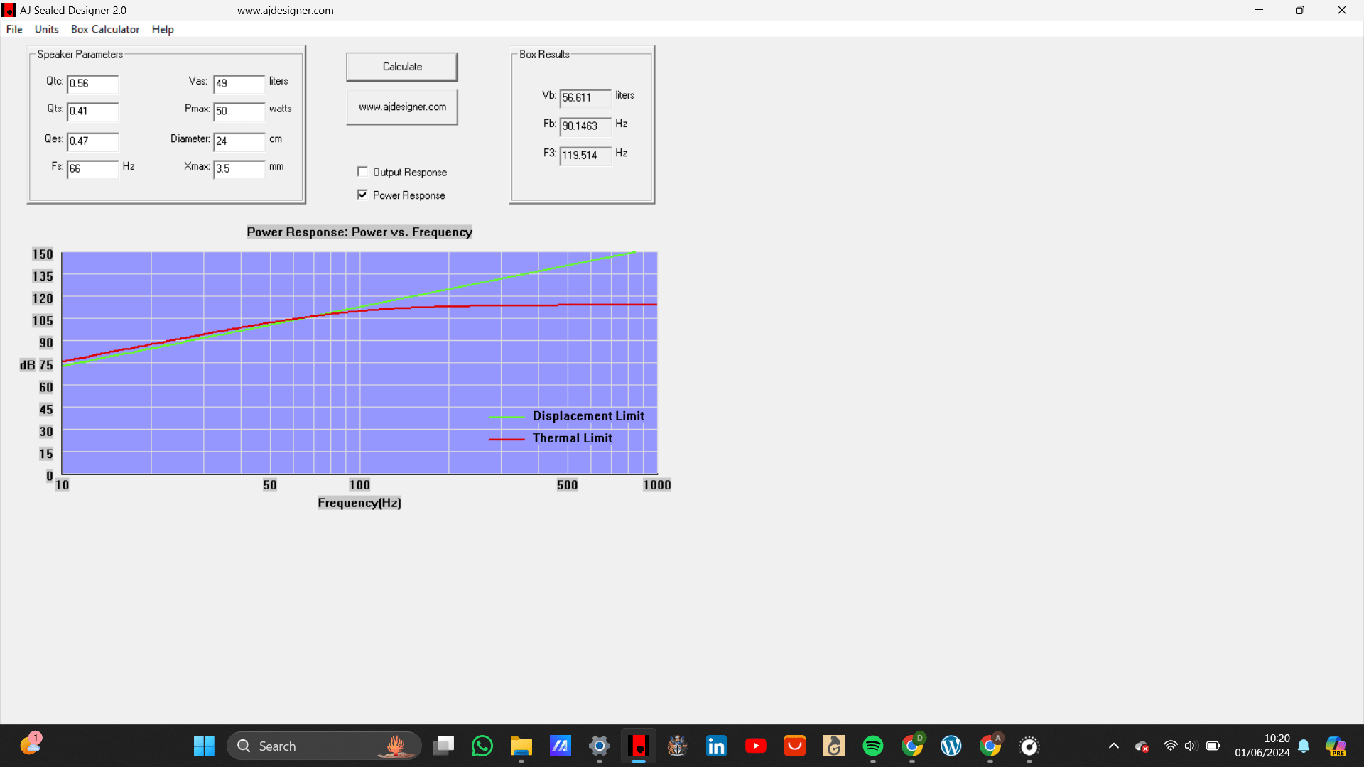

Going for tall and slim look (wish I could!) and allowing around 15 liters cabinet volume per bass/mid you could stack 4 of these lovely 8 inch drivers https://www.eighteensound.it/en/products/lf-driver/8-0/16/8nmb420 giving you around 60 liters internal volume (15 liters per driver)
External cabinet dimensions assuming 18 mm plywood (dark stained stranded bamboo ply would look and sound amazing!) would be around 24 cm wide, 90 cm tall and 33 cm deep.

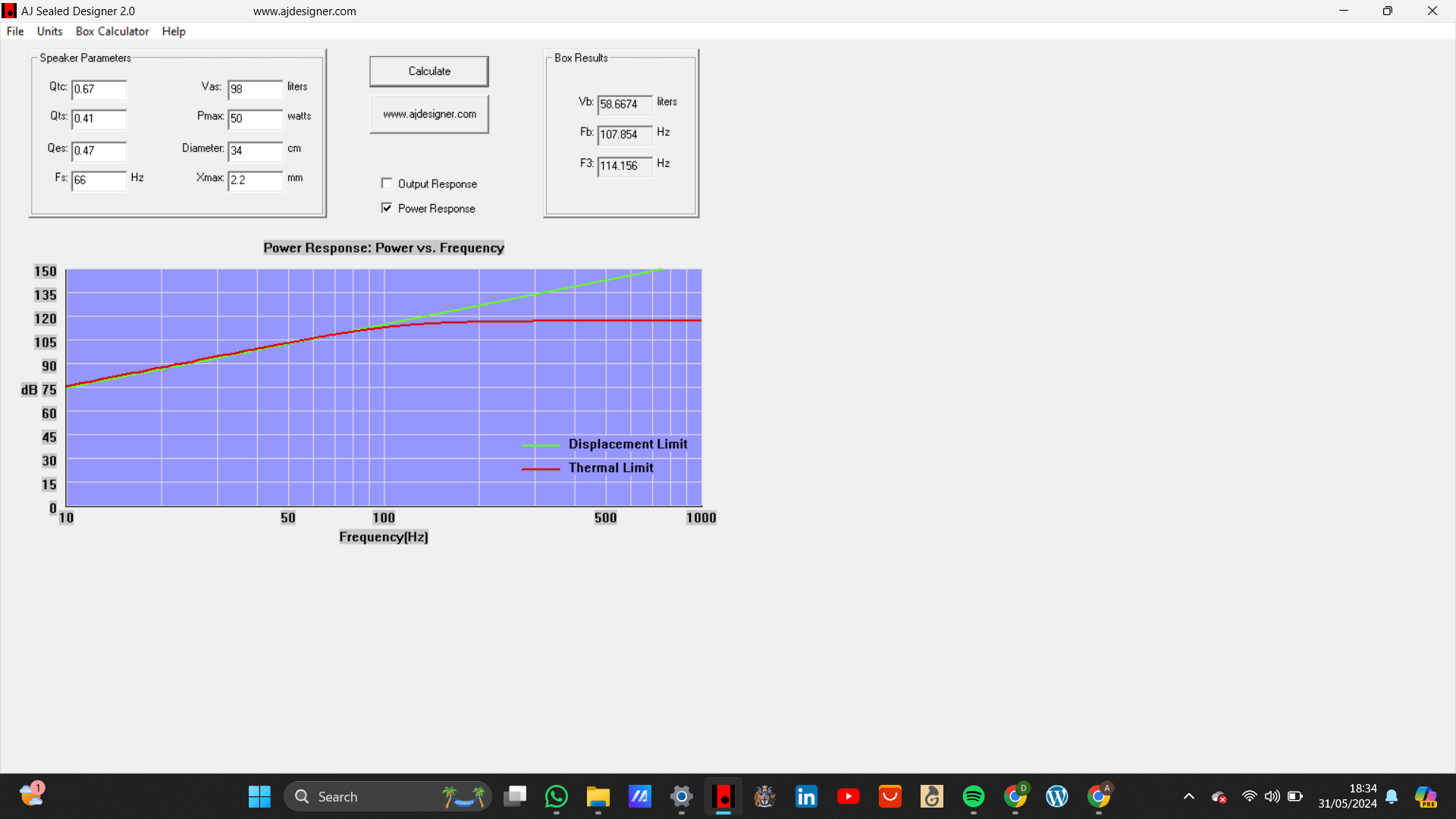

Sim for 4 drivers per cabinet in under 60 liters. Just 50 watts input holds 106 dB at 60 Hz (so a pair of cabinets hold 109 dB) and never exceeds 2.2 mm cone travel, its under 1 mm even at 100 dB in room.
This will allow an easy crossover to your SVS sub.
Also they are sweet all the way up to about 2 KHz although most 8 inch in a narrow baffle will be better crossed over to a mid between 800 Hz to 1,200 Hz.
Add tweeter to taste!
PS If you want to just use two 8 inch per side just take 3dB off per cabinet for the same power input. Also the cone travel will obviously double to reach the same SPL.

Thank you for the simulation you did for me. I am not familiar with plywood enclosures. How would you compare it against MDF?
I believe my current speaker's bass volume is 70 liter with a 10" woofer. 30 liter for 2 8" is significantly smaller. Crossover with the sub at 60Hz sounds good. A dumb question: What happens if it's a little larger? Just under-damped?
Re making the enclosure volume bigger, yes that reduces the Qtc (total system Q) ie it decreases the damping effect of the sealed air volume on the driver.
Again loads of interesting threads on the best Q... The general conclusion is that 0.5 to 0.7 is optimal. Personally I like to get as close to 0.5 as possible.
With all active /DSP sealed box designs the entire process start to finish is actually very simple, you really only have three variables:

I have added another sim ( I lam a SIM geek!) showing two 8 inch drivers with a Q of 0.56 which = 56.6 liters (coincidence... I think not!
I would still urge you to use 4 eight inch per side as you instantly half all distortion plus get the benefit of a pseudo line array (true line array must be over 90% of floor to ceiling height) bass system ie You will eliminate floor bounce, plus get much more even dispersion (this shows as reduction of peaks / troughs when measuring) and longer "throw" into your room.
