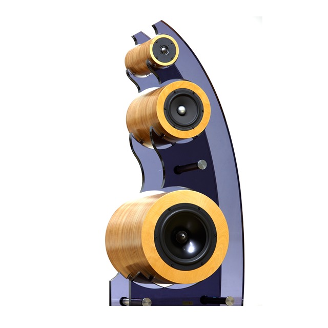

Instead of these fancy, difficult-to-make shapes, I am dreaming of something like below. But this must be still very difficult for me to make. I just want smaller ones in those tubular shape. Due to the size, woofers in that form factor is practically impossible(to even place somewhere), and I'd just go with a mildly fancy-shaped box. Obviously not the frame which must be irrelevant to acoustics.
Sharp edges near the drivers will cause significant diffraction leading to bumps and dips in the response. It is unlikely to be a good idea if you are interested in high fidelity which requires the radiation pattern of adjacent drivers to blend smoothly. On the other hand perhaps it will sound good and make a good audiophile speaker (the production chaps in the videos earlier had 15 dB bumps and dips in the upper midrange of their speaker and it sounded extraordinarily good apparently) or perhaps it will sound poor. It is hard to say.

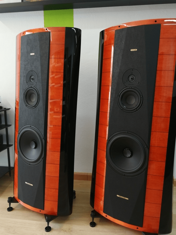

The Sonus Faber Strad you mentioned is a perfect example of a well executed wide baffle. I only heard them once, and they sounded so nice.
Another wide baffle speaker that I was quite familiar with back in the 1980s was the Boston Acoustics A400. An affordable speaker (for a large 3-way with 2x8 woofers), I thought it sounded better than anything else in its price range.
So yes, wide baffles can be quite excellent, the only real downside is the challenge in positioning them.
I ran a WAF test by showing her both JBL 4344 and Sonus Faber Stradivari. "Too big" for JBL, and "I'd rather take the other" for Sonus Faber.... lol
