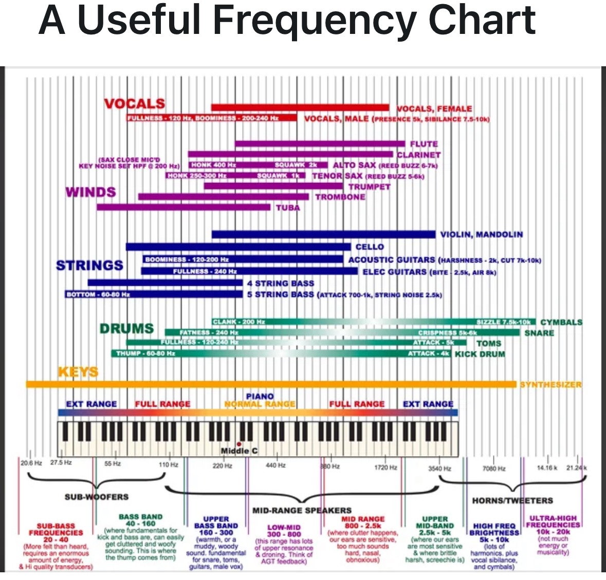

My own take on getting what you need out of a system is that it must translate as closely possible to the original recording.
This means minimal destructive errors (ref Earl Geddes) to what we decode as human.
Geddes in his presentations says the human ear is non Linear in several ways. Its non linear as most of us know in amplitude- loudness versus frequency.
But the ear is also non linear in detecting different distortion harmonics. Add to this the ear is more sensitive to distortion at low levels ( as l understand it ). High order harmonics of distortion also attract sensitivity.
There can be a tendency to confuse what highs are?
Above be 10,000 hertz or 3000-10000 hertz. It depends on what you think certain overtones actually are as a frequency. All musical instruments have overtones that often start with a fundamental in the lower midrange.
I think this is where coherence of a multi way system is impossible. Poor hand overs from one driver to the next are bad if you want those overtones to be coherent.
On that point a narrow face plate or no face plate tweeter right next to the dome mid is likely going to solve a lot of the practical versus performance criteria. It will act like a point source as far as coherence goes.
I used to have a system with that design and it was really insightful (Legend Acoustics Kantu 5) The mid was a 4 inch Aerogel cone driver. The dual woofers were 6.5 inch from Scan.
Looking the chart l personally find l am sensitive to the resolution or blurring over overtones above 8000 hertz. If the overtones are not crystal clear l can pick it out instantly and l am 64.
But recording engineers call this region “Air”.
I am just mentioning this but there is quite a lot in it.
Without air the music would be like a blanket over the loudspeaker.

The above statements are quite misleading….and as a recording/mix engineer I cringe when people apply reference standard to recordings when no reference of destructive tones or forces exist…..none. There is no reference….listen to what sounds good…..create what sounds pleasing…..rinse….repeat.
I guess l went off topic. Anything to do with modern recordings is full of contradictions and controversy theses days.
Obviously if an artist decides to record a performance and artistically modify it with the engineer the only way to compare the translations is in the studio and the control room.
In a concert hall or a large studio at Abby Road studios a simple mic set up with minimal processing may be appropriate.
The tenant of what are the fundermentals of musical instruments and the range of overtones is relevant to associating frequency response with what is subjectively heard.
I do think Earl Geddes research is well founded on how specifically the human ear works.
In this presentation Geddes does allude to a discuss some myths and interesting unknowns about our hearing. I don’t have bookmarks on this presentation

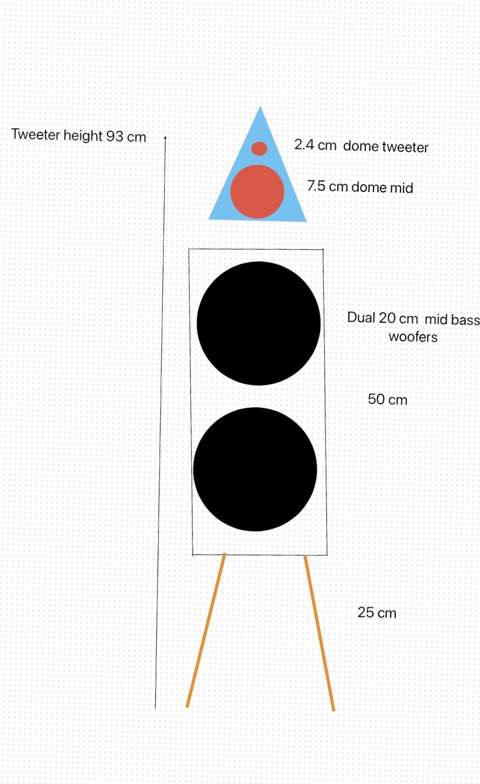

Based on some of the discussions this is my conceptual view of the proposed design.
There are a number of considerations not the least WAF.
What I want to do is a floorstander bass module and 3 cylindrical modules for midbass, midhigh and tweeter. I want to be able to swap a module(== driver(s) == a way). I might look into plastic pipes and/or 3-D printing options for those.

I think the best approach is to first re appraise how your others drivers will work in with your proposed loudspeaker. Is it dsp or passive, what power amps are you planning.
The thing is it has work work on a functional level.
Do the low bass and the mid bass first.
Will the SVS sub work with your low woofers or mid bass woofers?
What is the operating range of your proposed woofers ? What is their efficiency or sensitivity?
Will the enclosure be sealed or bass reflex?
The dynamic characteristics of the SVS sub need to match your woofers.
Once you have what settled the choices of the mid dome are more defined
JH> Yes, I am planning to use my SVS below some point for all the channel in the system. It will be a 5.1-channel system after all.
JH> I haven't started thinking about it yet. Scanspeak and Volt are candidates, though it's wide open to others. Though I prefer pulp cones, I am curious about harder materials. I am planning a sealed one, as SVS will fill the lacking low bass and it is also a sealed box.
JH> Not sure what you mean exactly or how I can do that. We will have a lot of chat on this, too.
It's unfortunate that most of these are gone from the market. Dayton one looks surprisingly good on paper for its price. Actually, it sounds too good to be true at the price, to an audiophile spoiled by price tags of those 'audiophile' drivers.Beyma MC115.
Dynaudio MD142. Older MD-76's.
Wharfedale Evo 4 domes can be bought as spares.
Dayton RS52 2".
Volt's 753, is also available in E version(8ohm), and the 752.
Scanspeak D8404, just hampered by the ridicilous price.
Legatia L3 (car audio) dome midrange, has a rated xmax of 6mm and 113hz fs.
Ciare HM 500 2".
Morel used to have the MDM-75.
Adam audio has the DCH 4" dome/cone hybrid, not sure about availability.
Etc.
Does anyone have measurements for the Wharfedale drivers? Legatia seems just as expensive as the Volt or ATC, surprised to see such price in car audio market(I know nothing about it, of course). I also excluded Ciare as its dome material is not textile. Maybe next time.
I listened to the 8404 in my DIY friend's new project, and it's very good, probably better than ATC, but waaaaayyyy too expensive. I will never afford such $$$$ drivers in my whole life. The 2 professional digital audio gears I want to buy for this project cost just a little more than 1 driver, lol.
It’s a shame some drivers are either NA or priced out of the market. I am hearing noises that Be might be replaced by Textreme once fabrication techniques are refined. Some compression driver manufacturers are testing diaphragm alternatives to BE. Eminence has a novel textreme diaphragm compression driver.
- 4-way instead of 3-way?
