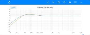

Looking at your room the idea of a sealed bass driver with 12 db octave slope might work close to the wall.

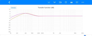

Typical near a room wall a boundary effect occurs between 3-6 db on the bass below 100 hertz.
The can be simulated with a shelf EQ filter.
The beauty of a sealed woofer is it can self equalise to a much lower F3 in - room frequency without the typical bass hump of a bass reflex system.

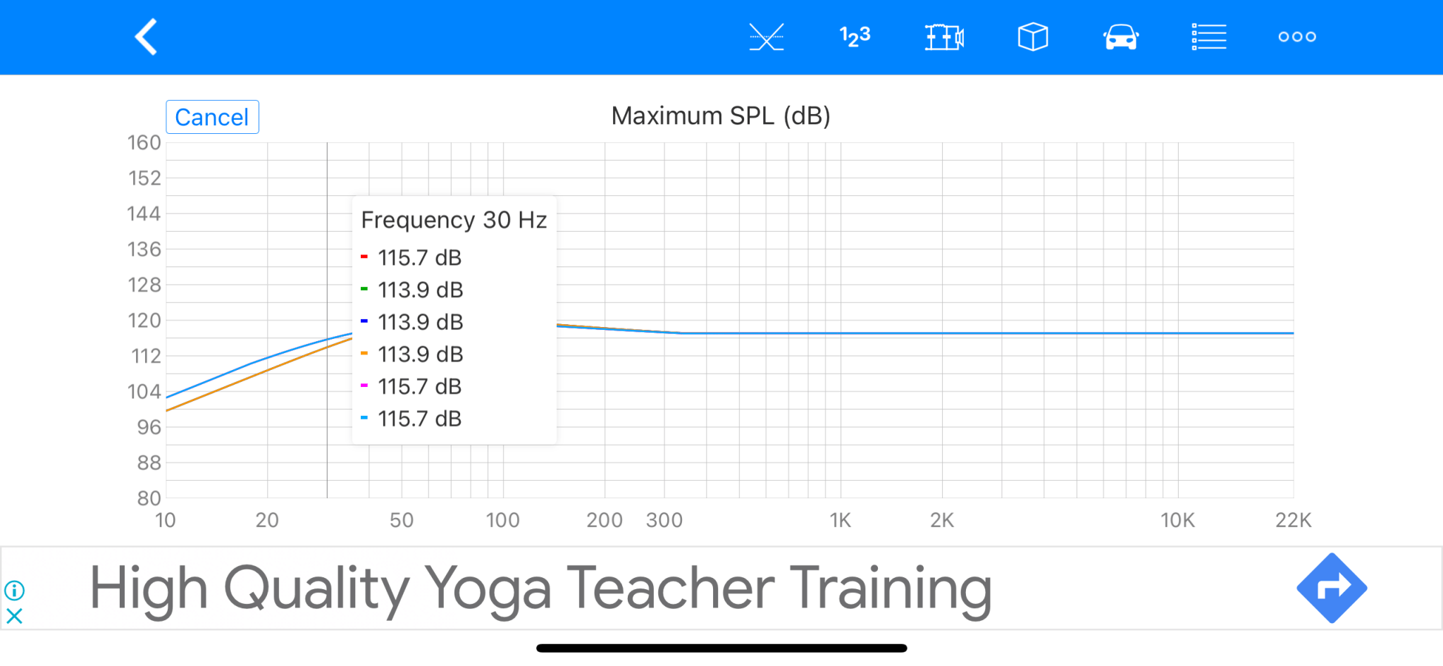

This is a simulation using an Acoustic Elegance
It’s a massive driver.

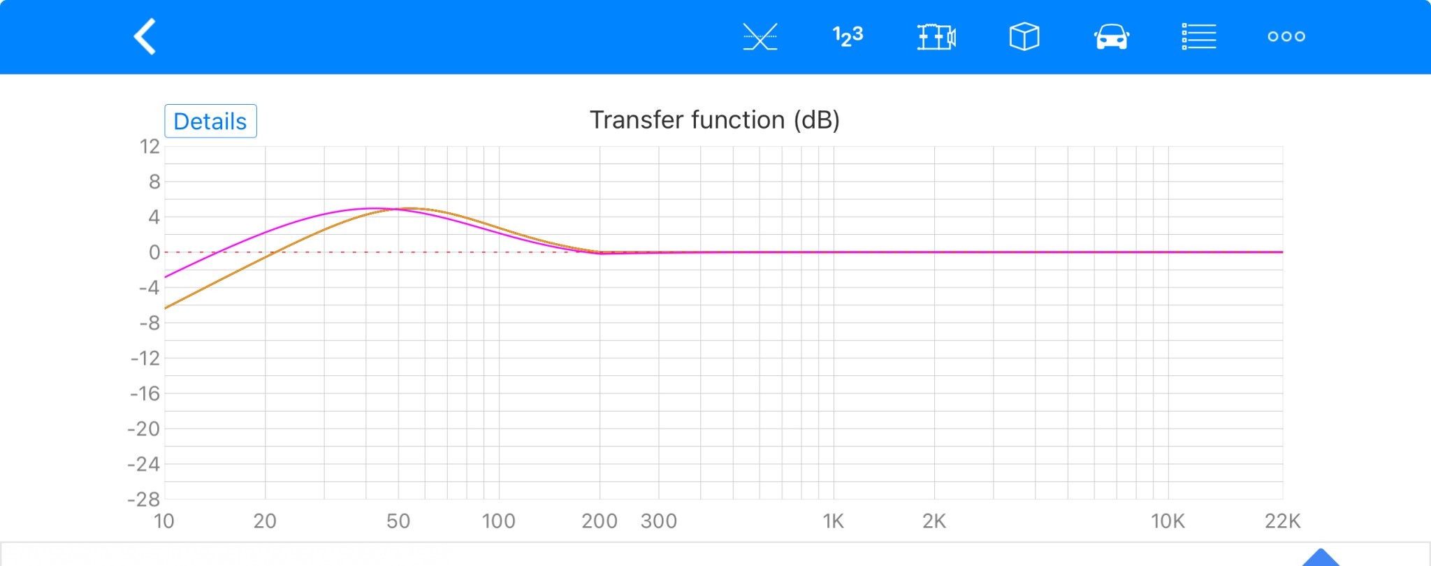

I have simulated a +3 Db shelf at 100 hertz and a +6 db shelf at 100 hertz. The effect of pushing the enclosure near the wall in other worlds.
Or turns out really nice.
A Q of 0.7 is 25 L
A bezel Q of 0577 is 50 L
You would only need one 10 inch woofer in 25 W x 21 D x 50 cm H enclosure.
The maximum in room bass output is 115 db at 30 hertz.

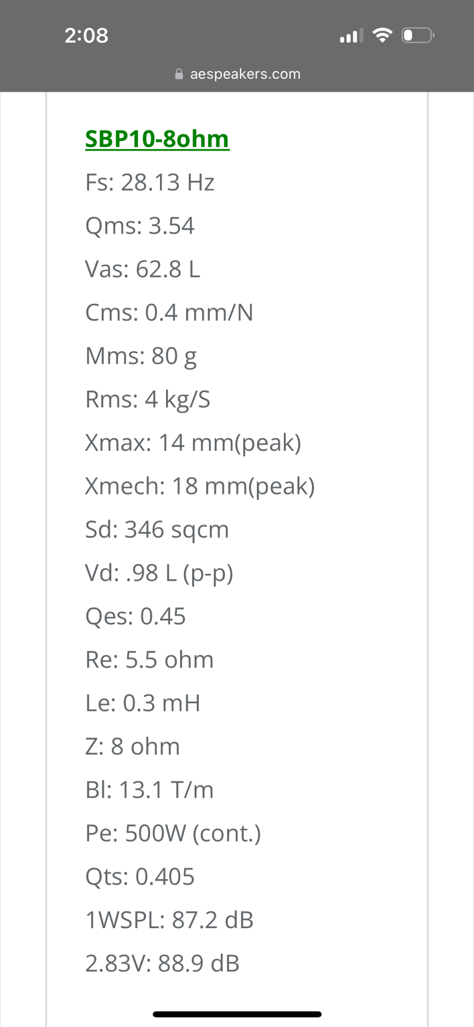

SBP10
The x max is 14 mm.It’s a massive driver.

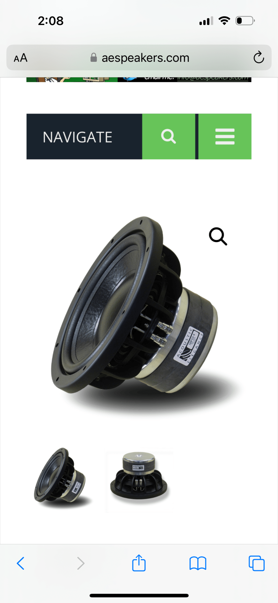

Where l am coming from with the 10 inch AE woofer is its capable of being a foundation for musical lows. If you rely on the SVS for say 50 hertz and below there might be continuity issues to a hifi mid base driver.
Given the AE works in a sealed acoustic suspension enclosure and will cover up to at least 500 hertz you might not need a mid bass driver.

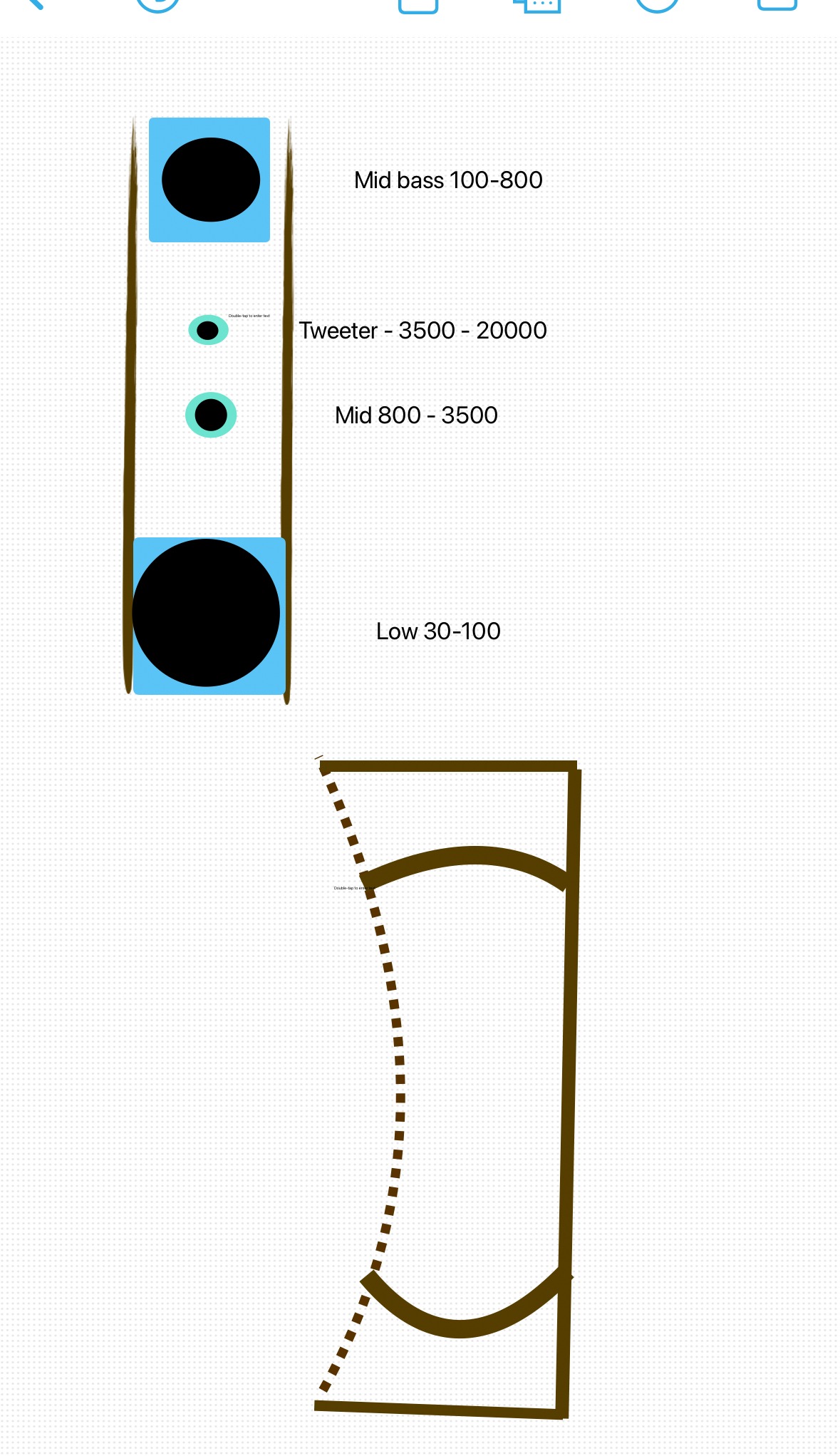

Alternatively is to place the bass (low woofer) close to the floor as shown in my sketch. This will enable all the output of the driver to reflect rather than diffract giving a linear response too 100 hertz or so.
It’s the Alison design idea. You will obtain much smoother bass without any downside with this approach.
Some hi end designs with weird triffid alien shaped enclosureshapes use this approach to fool the laws of physics when it comes to acoustics.
The mid bass lower mid driver then takes over. Placing it well up off the floor outside the wave length of floor cancellation with give a smooth response.
You could use numerous drivers for this task from 100-150 hertz to 3,500 hertz .
The styling l have depicted is like the Avantguard design that is framed on each side by a curved plywood side panels

SBP10 looks great, except being a bit peaky in the FR of interest, and the price. DSP should be able to flatten the peak, but price, especially used double config seems quite more than I would spend. For the side-firing woofer module, more affordable 13~15" ones seem better. Any suggestion? Please also advise me on the idea of side-firing subwoofer module.

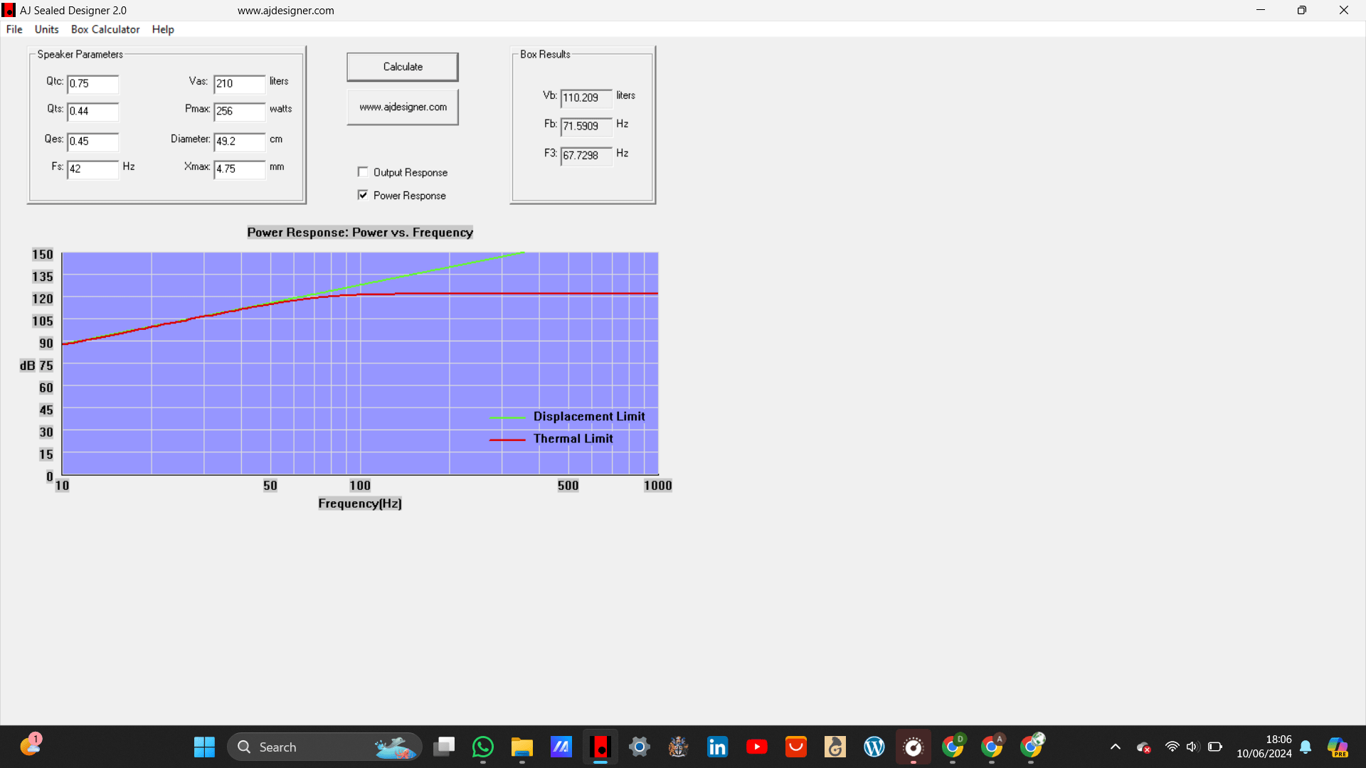

Ok, good news and bad news on the Beyma 15 LX60 Mk 2...
Good news: An opposing pair per cabinet will deliver superb results with a Q of 0.75. Personally I would use 0.65 with this set up but that needs 178 liters, but I like wider baffles.
Bad news: Your bass cabinet will need to be tall and deep if you restrict the front width to around 22cm (internal) ie WHD of 22cm by 82cm by 65cm = 111 liters.
If this is too big a single driver per cabinet will still produce 106dB at 30 Hz with 256 watts and 4.75 cone travel when you have two cabinets.... Then add at least 3dB room/boundary gain and you have more than enough SPL for room shaking performance and still staying well within the drivers thermal and XMax limits.

A mid bass driver is a driver that typically has an extended mid range and less low bass. It can be any diameter.Wow, this, and the other post below that I can't quote yet, gives me a lot to think about. It seems that you call the double 8" woofers midbass, as 8" is the usual diameter for professional midbass drivers. I am planning on the 4-way standalone first, using with SVS in the beginning, and build a side-firing subwoofer module(non-ELF) later if all the situations permit. Since it is double woofer config already just for my gut feeling and WAF, it seems to address a bit of baffle step issue, right? If you meant to use 1 or 2 10" for tall/narrow woofer module, I am afraid WAF prohibits it...
For your suggestion of midbass on top of tweeter and woofer down at bottom, how about T-MH-MB-W-W layout with 1 woofer on the top and one down the bottom? Tuning the bass for corner placement should also be evaluated, but it seems easy to test when the cabinet is complete.
For bass an 8 inch woofer has real limitations unless it has a long Xmax. Such drivers exist but have high mass cones and have limited bandwidth.
In my outline the SP10 would only be used up to 100-150 hertz. It may cost more but these are truely hi end drivers that deliver. Long Xmas is necessary in a seal enclosure. Do not used a low Q bass reflex woofer as a sealed enclosure. It will have significantly limited output. You need a long throw long VC, low FS and a Q of 0.4 or above or it won't work properly as a hifi woofer
Visation also make an excellent range of woofers designed for sealed enclosures
https://www.visaton.de/en/products/drivers/woofers/tiw-250-xs-8-ohm
https://www.visaton.de/en/products/drivers/woofers/tiw-300-8-ohm
The idea of a woofer on each side looks cool but is unnecessary. You only need one good one.
You could try T-MH-MB-W-W as a modular approach and work it out at prototype phase. Have a look at the Wilson designs on their layouts.

I am afraid there is a confusion. I also prefer heavy bass module, but still in reasoable weight for 2 8" woofers. Since this bass module is smaller than or similar to the size of my current one, 50 ~ 60kg seems appropriate.
BTW, what I meant for 2 woofers bottom and top was, one woofer on the top part of the bass module and one at the bottom to mitigate the baffle step issue. So, after the stacking, the layout will be still tweeter - midhigh - midbass - bass module. I read it again and realized that it could be interpreted as woofer A - tweeter - midhigh - midbass - woofer B...

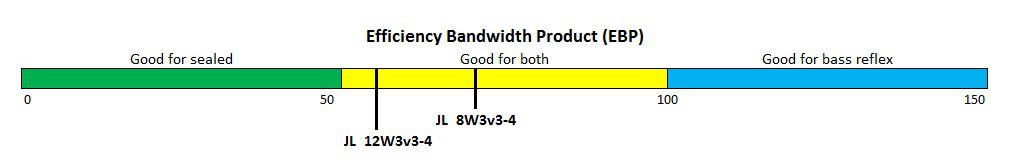

Here is an explanation of the suitability of a woofer for either a bass reflex or sealed enclosure or one or the other.
"To find out which enclosure is best suited for your woofer, you need to calculate the Efficiency Bandwidth Product (EBP). Simply divide Fs / Qes and if you get a number between 50 and 100, the woofer is suitable for either one (lower than 50 is best for sealed and higher than 100 is best for bass reflex)."
https://audiojudgement.com/sealed-v...d out which enclosure,is best for bass reflex).
On the driver motor if a sealed enclosure is going to deliver lows with appreciable authority (not just small signal) it needs to be long throw. Otherwise when compared to an equivalent size bass reflex system (with the help of the port output) the sealed system will have significantly less low frequency capability. This is about the displacement to move the air load behind and in front of the cone with low distortion. Once the linear region of the BL is exceeded harmonic distortion increases quickly. 2nd order H2 diction is bad for bass notes.
The 10 inch AE woofer I referred to above has a 14 mm peak Max. The Xmech is 18mm peak while the Vc is rated at 500 watts. VB 25L
Allowing for just 3 db of room boundary reinforcement the single SDP10 VB 25L QTC 0.71
116 db at 50 hertz
114 db at 40 hertz
111 db at 30 hertz

The Beyma 15LX60V2. xmax 9 mm, fs 42 hertz, VAS 105, Q's 0.44. VB 95L QTC 0.71
122 db at 50 hertz
119 db at 40 hertz
115 db at 30 hertz
116 db at 50 hertz
114 db at 40 hertz
111 db at 30 hertz
122 db at 50 hertz
119 db at 40 hertz
115 db at 30 hertz
