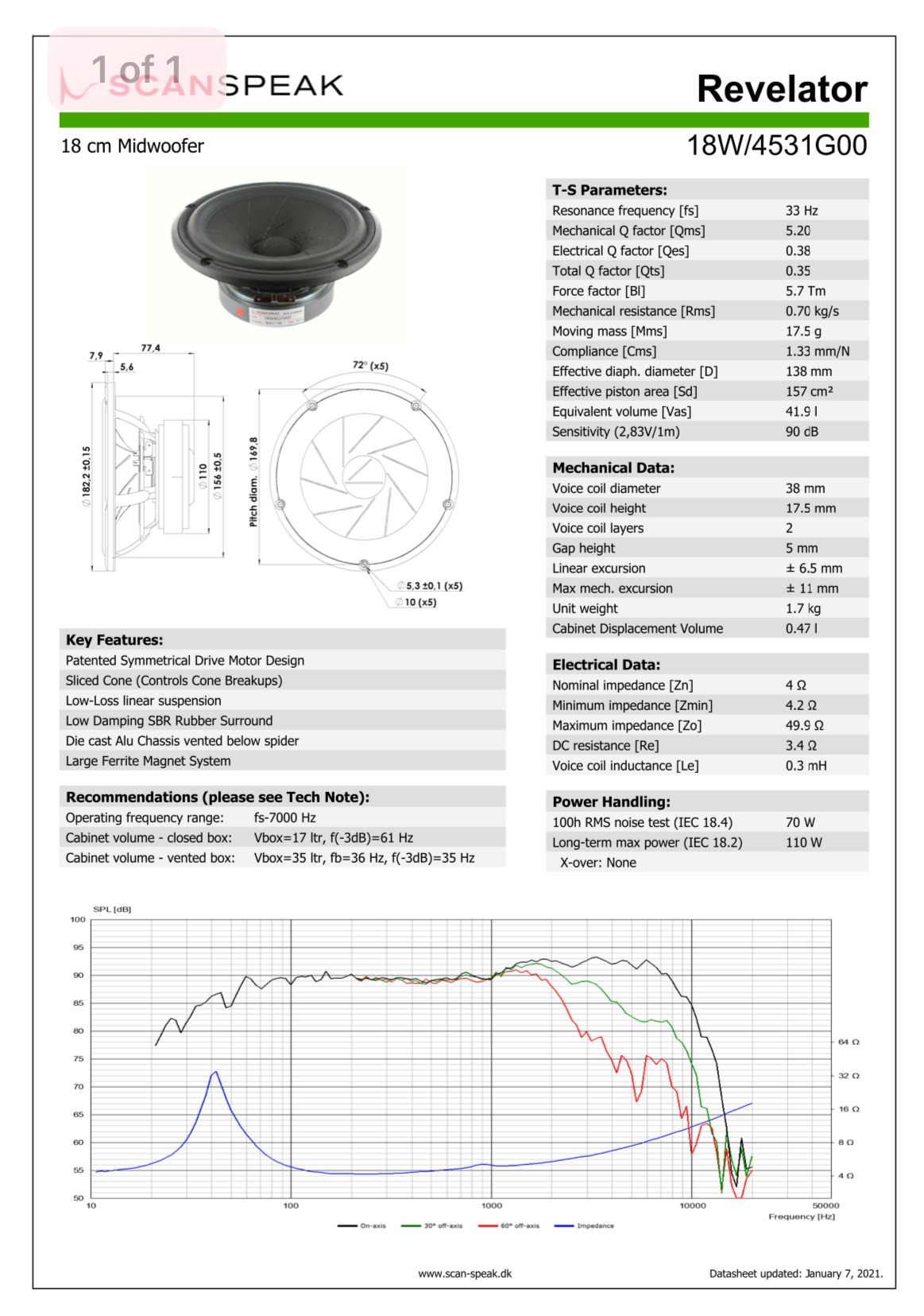

Probably nothing. Smooth. Refer to the sealed box f3.One question for the illuminator 7" midbass: Its Fs/Qes is over 90, so obviously designed for bass reflex applications. What happens if I put it in a sealed enclosure(cylindrical)? What are the issues with this approach?

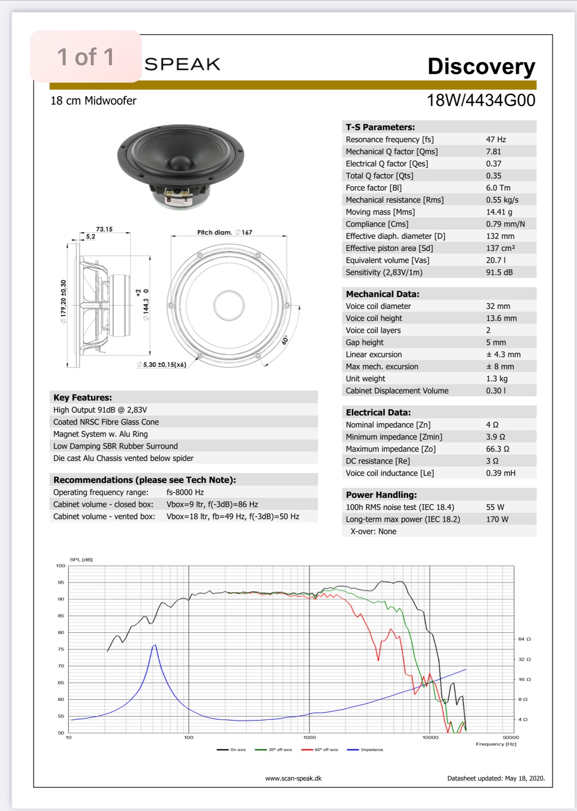

My advice is to look 89-91 sensitivity and a 32-38 mm VC with +-4 mm or more X max.
I have attached a few similar drivers. Some have different cone materials like the 4434 version which is fibre glass. These cones tend to be stiff and light weight delivering punch and snap. Paper has a thicker sound.
Because of those subjective differences you need to carry over that into your dome mid.
I would place paper with a silk dome mid and the fibre glass with an aluminium or titanium dome mid and tweeter.
A crash snare overtones need to sound coherent and smoothly blended.
If you prefer a live sound with snap and crack, free of thickness then the later is likely your preferred choice.
But it you prefer a more forgiving, damped and thicker transient attack then the former might be your ticket .
